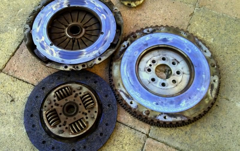

This was the state of my daily flywheel I took of the Pug last time I had the box off:
So I bead blasted it but you can still see the uneven area's from the carbide hot spots:
And then I decided to skim it slightly and got a little carried away:
Just slightly.
