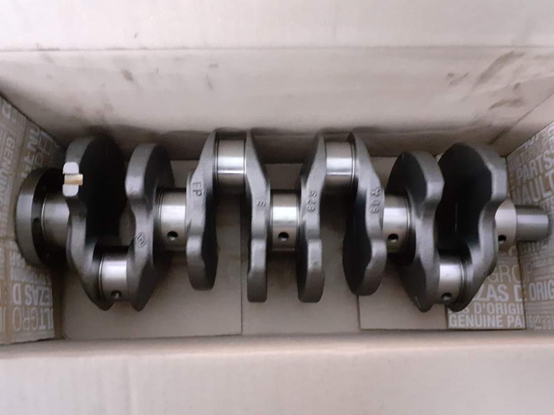

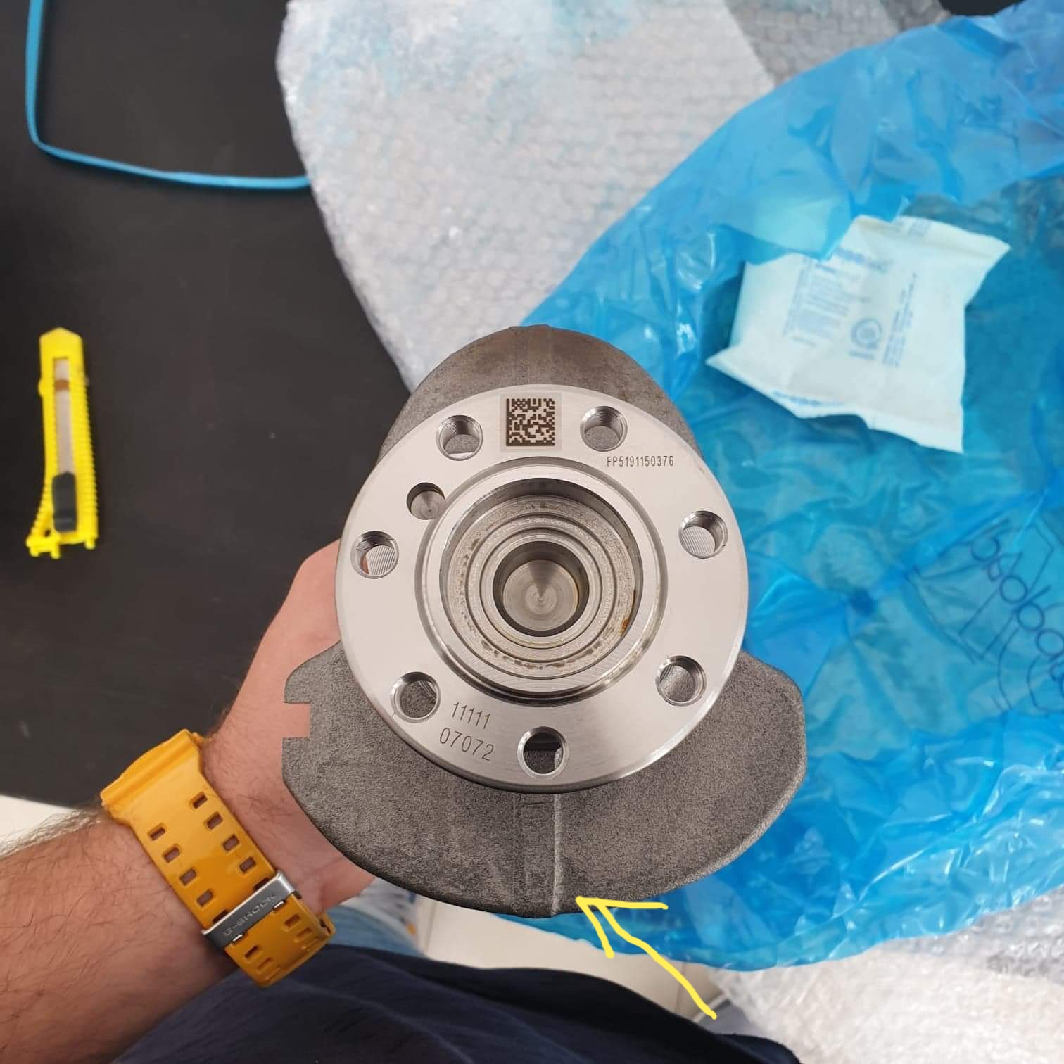

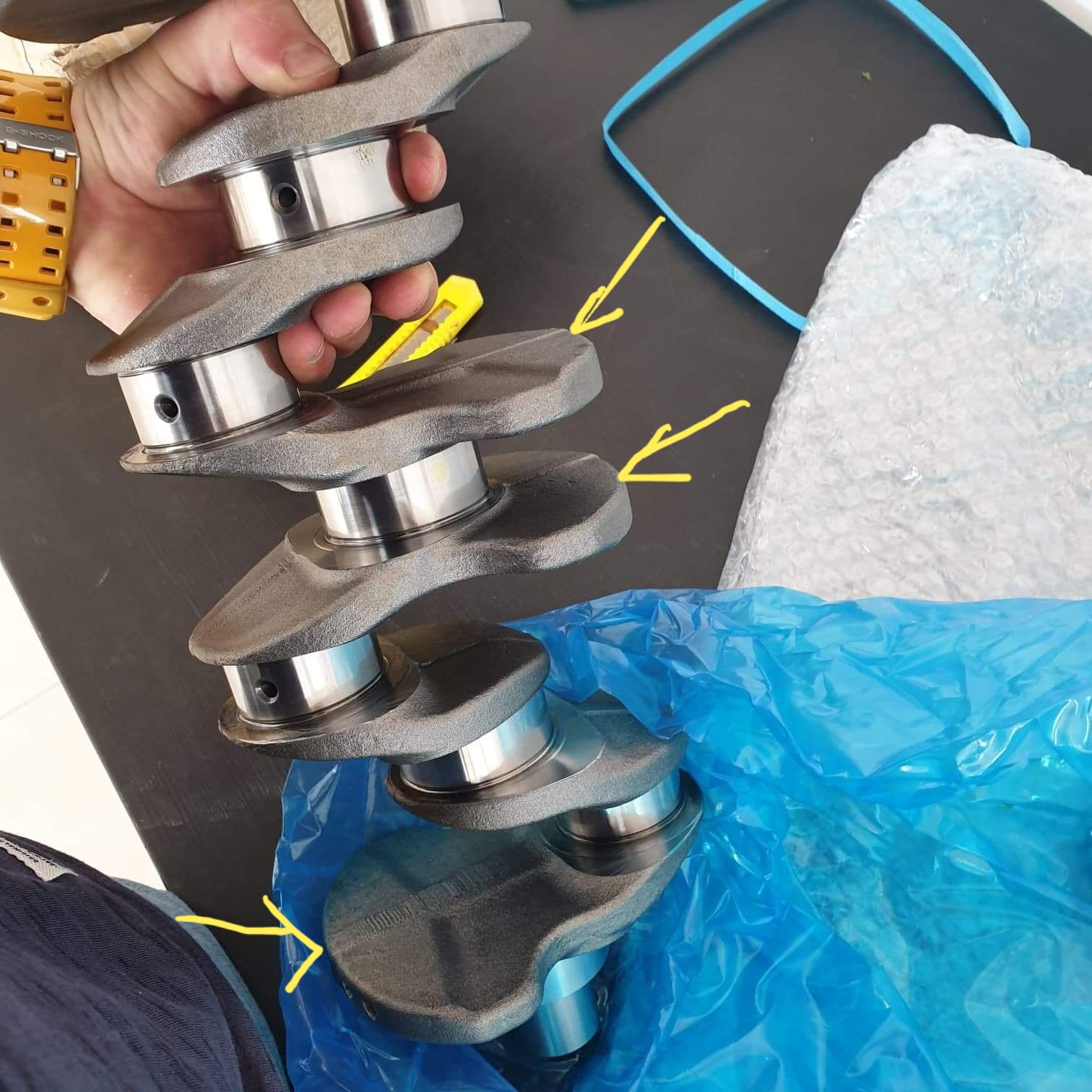

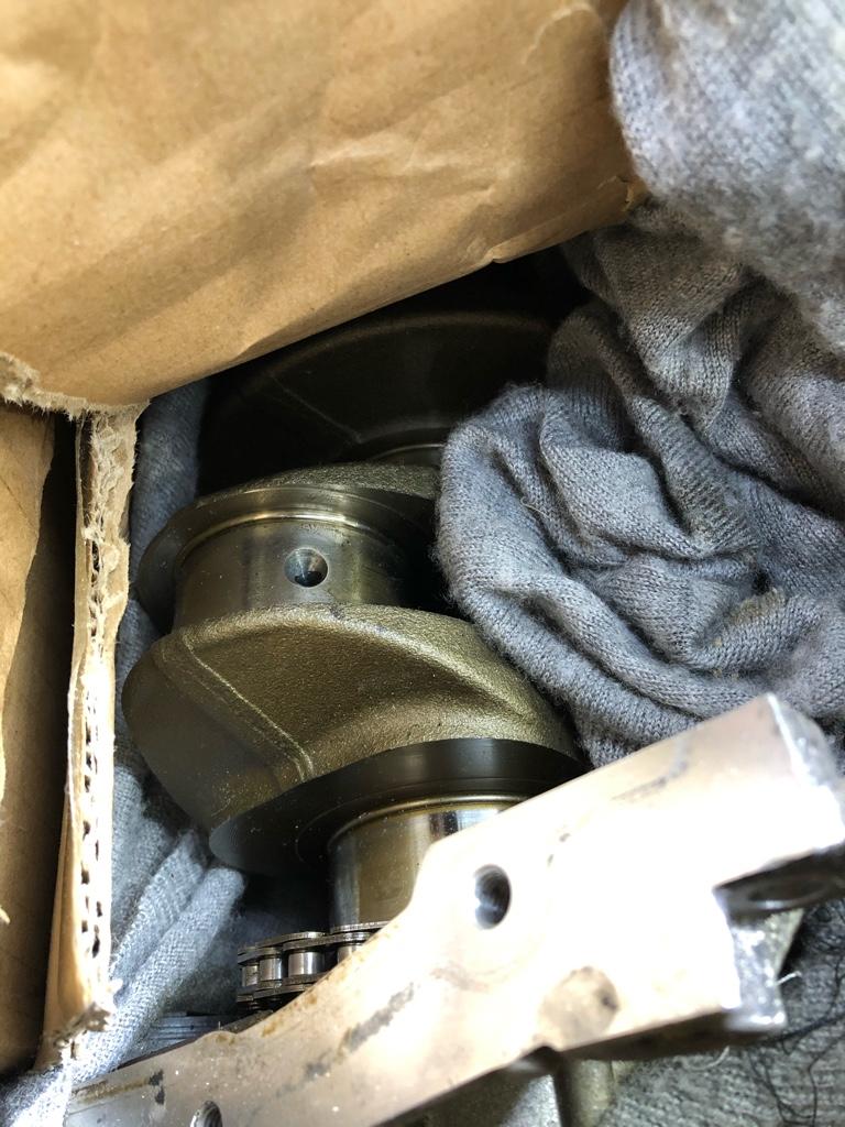

Then I took some pics of the new OE crank that is listed for my 182 which is this one:
Well this to me looks forged as well.
What do you think?

But are they cast or not? This new replacement one looks forged..

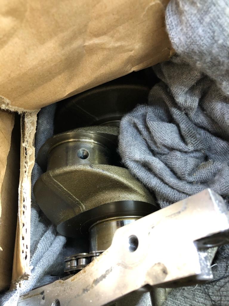

I can confirm that my 197 crank that I have looks forged as per your earlier picture.
Here it is:

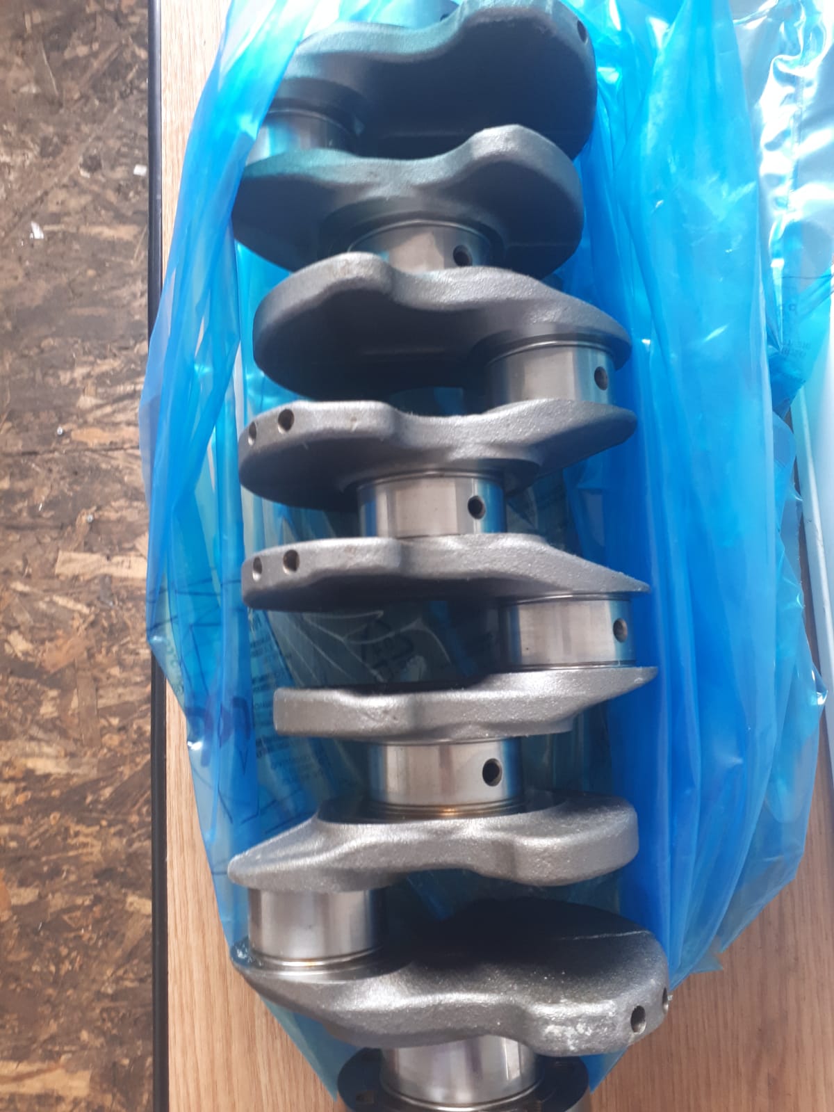

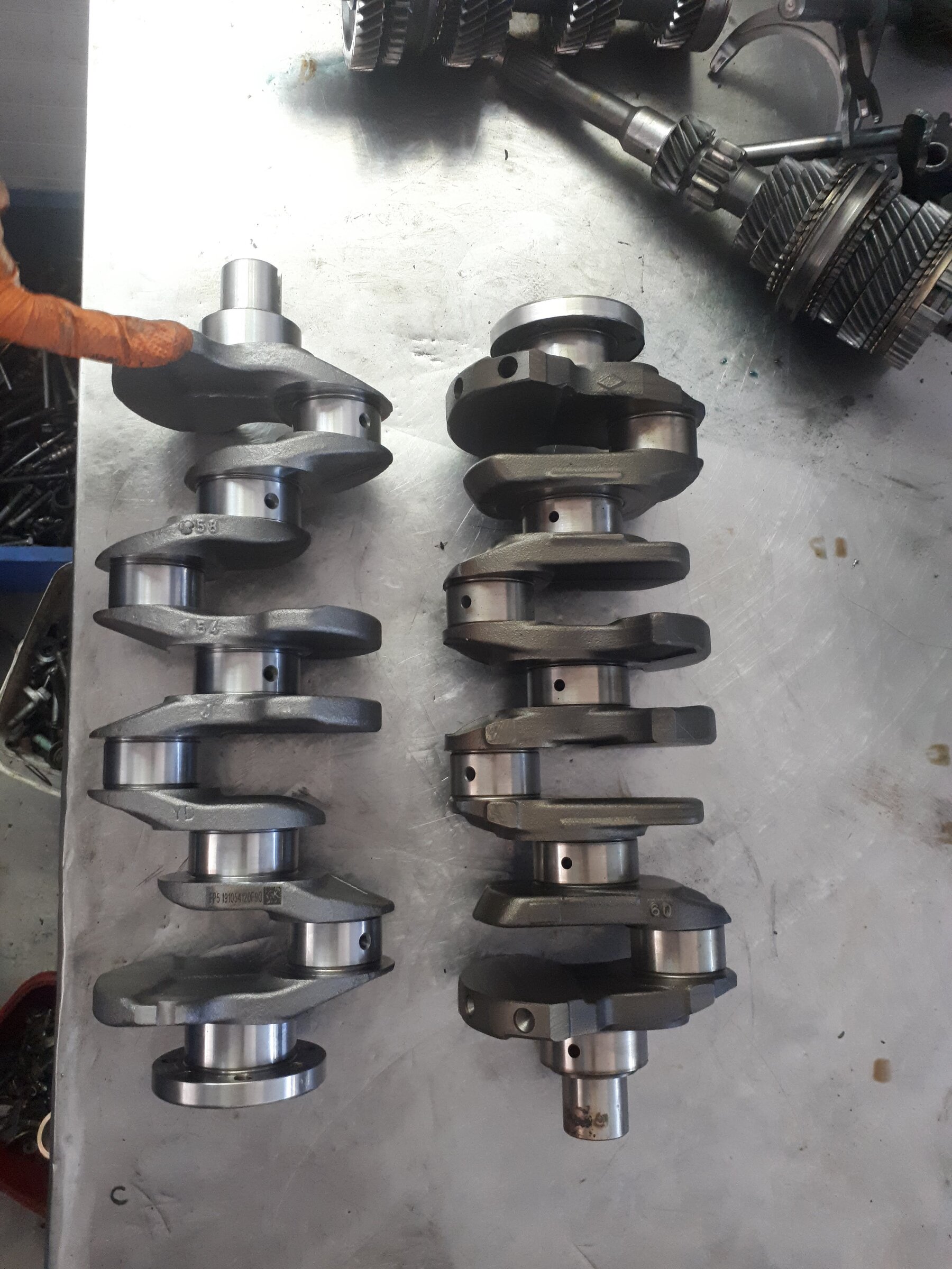

Left new crank design right my OE crank. Notice the counterweights.
And the 197 crank above which is very similar and the main reason for wanting it. Looks stronger too (it's also heavier)

Can't see any balancing marks on the new crank (left of your top picture). I have read that sometimes new cranks supplied on their own sometimes are not balanced, however this was more for tank stuff.
I would agree here that the replacement does not look anything like the original or 197, if it's lighter AND the counter weights are smaller I would have a few questions and would for sure what to have the rotating assembly balanced.

The best crank to use is the early ph1 crank. It’s the heaviest out of the lot and looks to be forged.
That new one in your picture is the ph2 172 crank. I’d toss that in the bin as it’s not even any use as a paperweight.

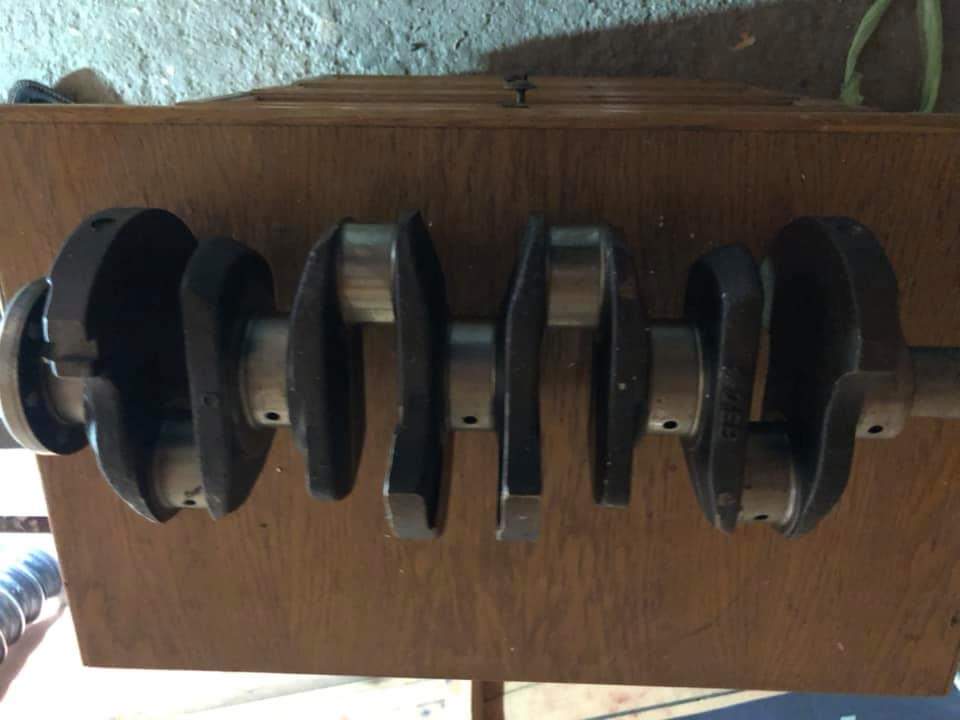

ok that's not encouraging at all :(( I have a ph1 172 crank from a friend but the builder says the 1st choice should always be a new crank, you can't really see defects in the metal in older items.
that above is the ph1 used crank. if i'd be 100 percent sure it has no hidden flaws i'd get it in an instant
