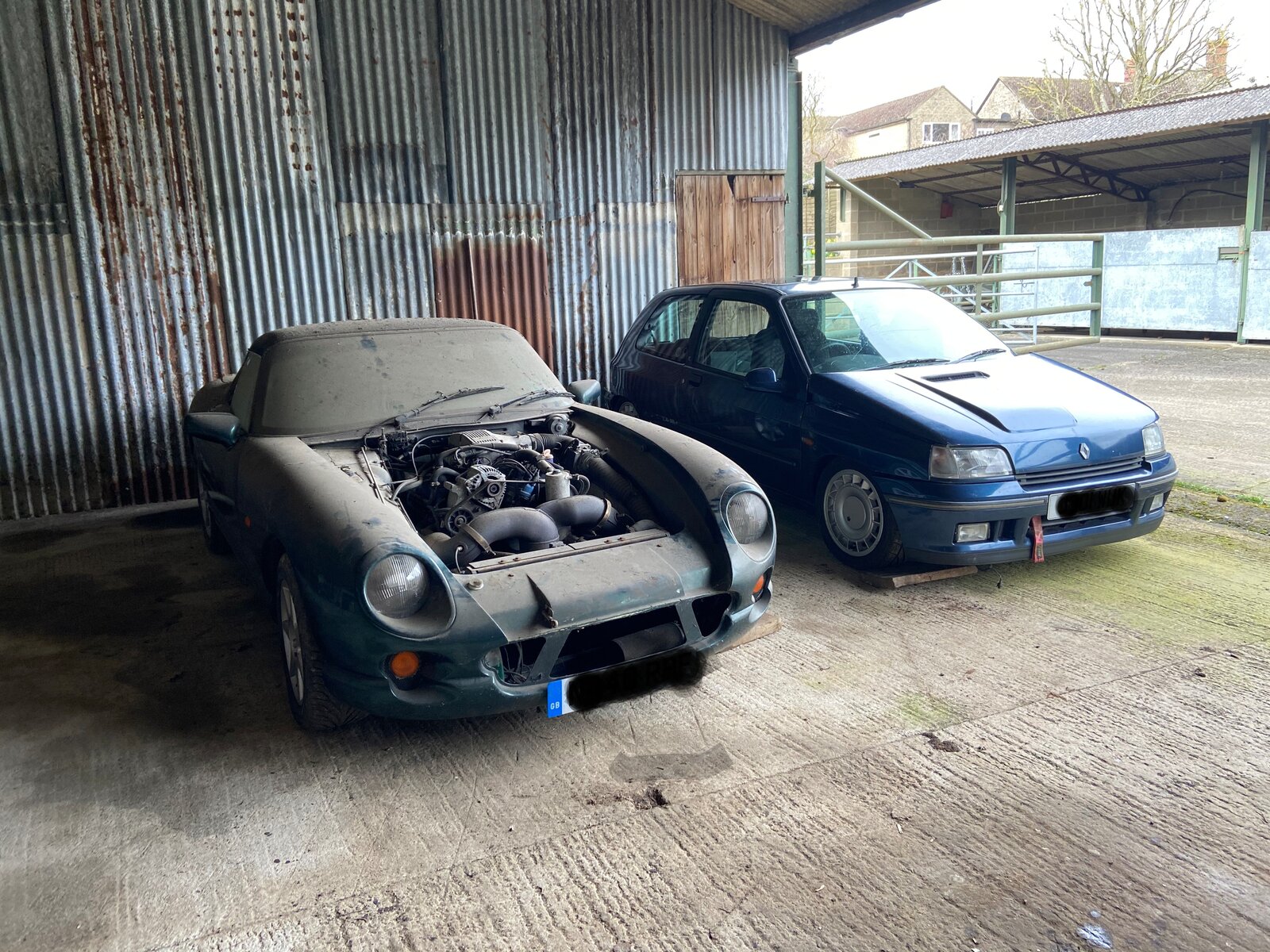

I've just picked up another Ph1 16v and the seller said the engine has been swapped. Suggesting though that it was swapped to a F7R.
Are there any physical differences visible from the outside of the engine to tell the F7P and F7R apart?
