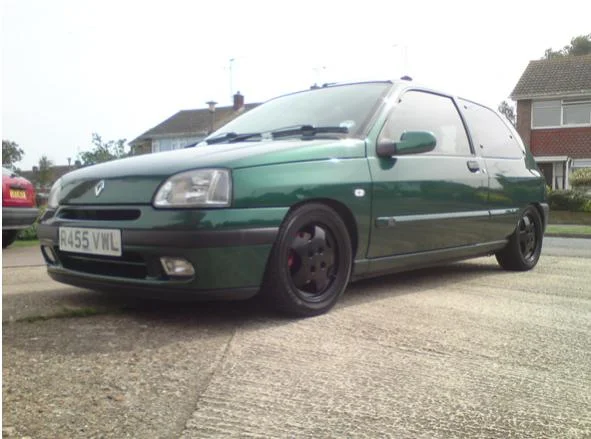

ATM I have Gaz coilovers that are for the 1.4 Fitment ONLY. Can I run JC5 box WITHOUT William/Valver suspension, lower arms, driveshafts and keep my current track width?
If anyone could clear that up would be much appreciated :)
Plans are F7R, JC5, Williams Brakes up front, Williams Wheels (black or gold?) 195/45/15 Toyo proxes or Yokohamas
Over time the F7R will be upgraded but want to start with a decent one putting out roughly the 150 it came out the factory with?

So can I completly keep my track width and driveshafts and put them into the JC5?

Chip, Will that Widen my track? My coilovers are designed for my current set up with the 1.4 stuff... And I want to keep the track the same, Just williams wheels and bigger brakes, thats pretty much it, Want a sleeper that looks just like a 1.4 with 150+Bhp ;)

Yes it would widen your track, and if you then just use a set of camber bolts you can bring the camber back to correct.

I have already had to machine the holes on the coilovers, Will my current driveshafts fit in the JC5? Will they be strong enough or just twist because i think they're hollow? Can i get shorter ones made up? Expensive? :/

shafts will fit, Renault has used thin and thick shafts, you'll have to look which you have. although 19 16v uses thin ones to so they'll be fine i guess...
