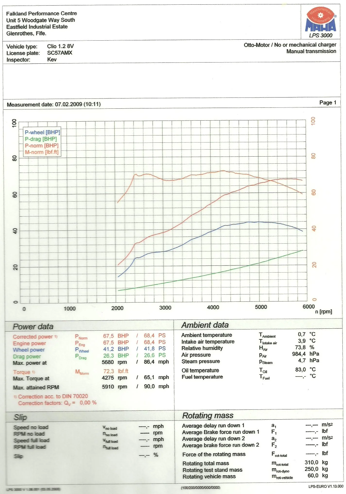

Run1: Corrected Engine Power: 67.5
Wheel Power: 41.2
mods: Sebring backbox, K&N replacement filter.

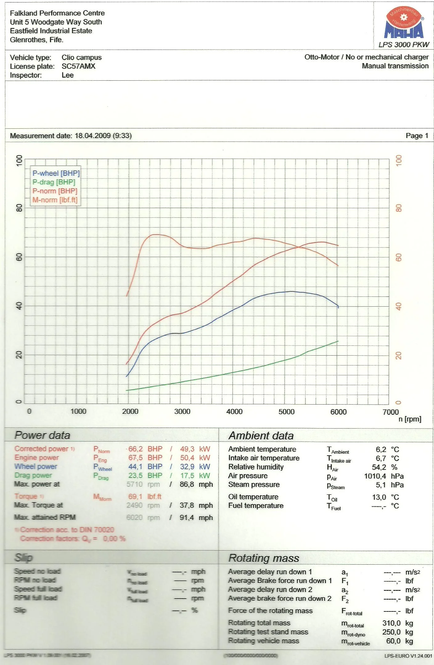

Run1: Corrected Engine Power: 66.2
Wheel Power: 44.1
mods: Sebring backbox, Decat, Pipercross IK (which was setup badly, behind the radiator).

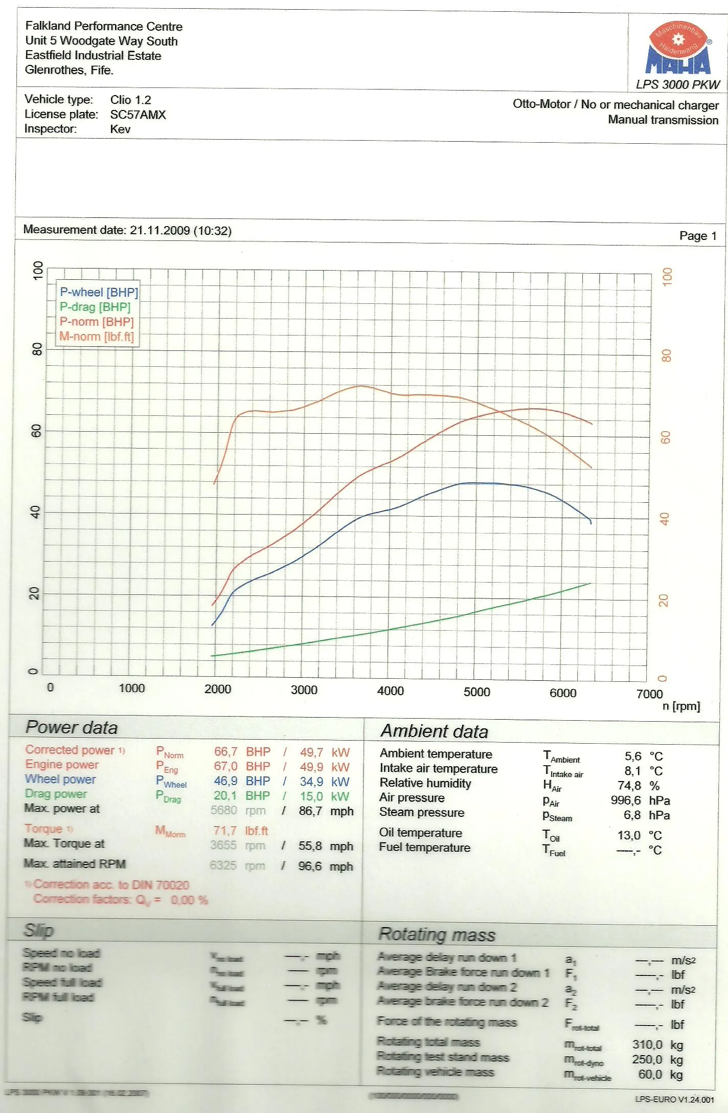

Run1: Corrected Engine Power: 66.7
Wheel Power: 46.9
mods: K-tec Stealth, Decat, Enclosed IK with CAF.
I'm attaching the graphs also.
Not that I really care, just thought I would share. ;)
