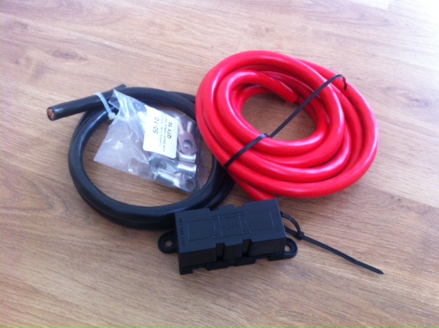

Had a delivery this morning
Just need to order a battery tray/holder
Going to put the standard battery behind the passenger seat. Decided against a lightweight battery as I hardly use the car.
Would rather spend the money elsewhere

What size cable did you go for bud?
  RenaultSport 172
I went for 50mm2 as per the thread you were commenting on in the interior section. It's massive but seems good quality.
Got the 10mm terminals to match
  Williams 2
How are you connecting the terminals to the battery cable mate?
I've got cable and terminals, not sure best way to fix them together, my crimping pliers aren't big enough!
  RenaultSport 172
Not sure yet. Was just gonna crimp them but I haven't had a chance to look at it yet. I want to get rid of the sound deadening under the passenger seat before I move the battery behind there

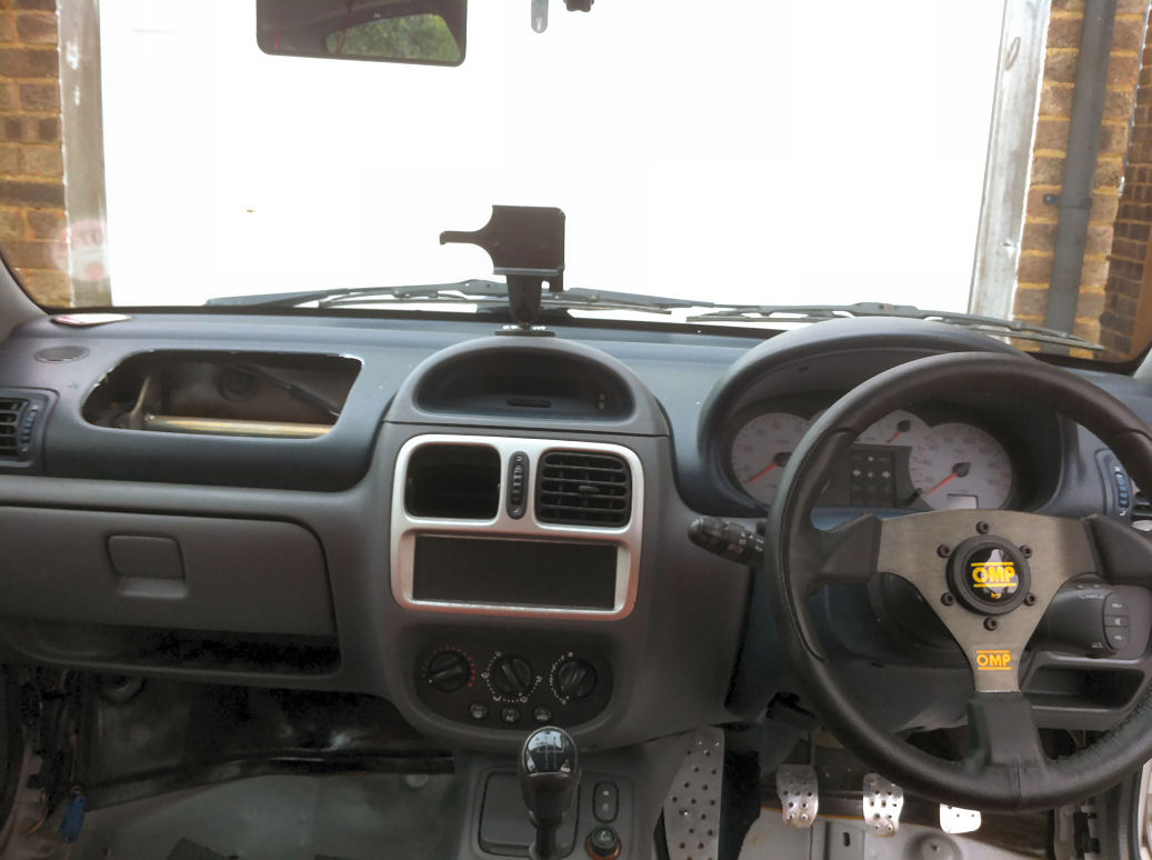

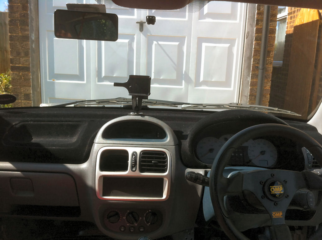

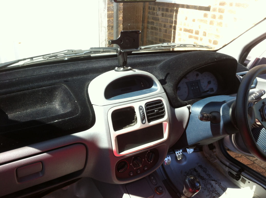

Finally got some time to play about with my clio today:

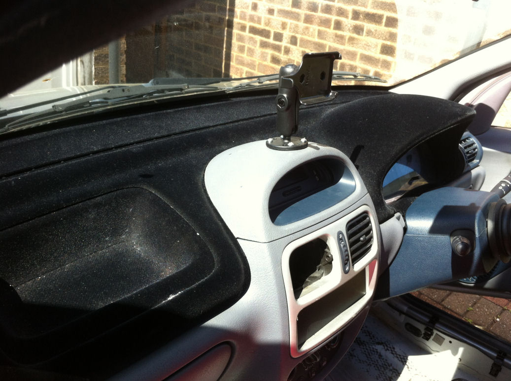

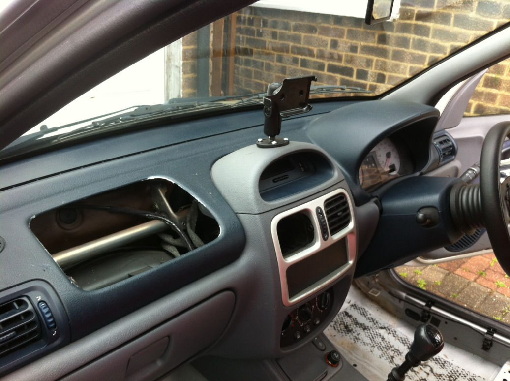

Picked up a flocked dash top from @Toms_clio so first job was to swap that over.
Went from this:
To this:
Really pleased with it, and nice to lose the hole that the airbag left.

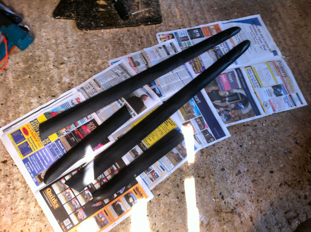

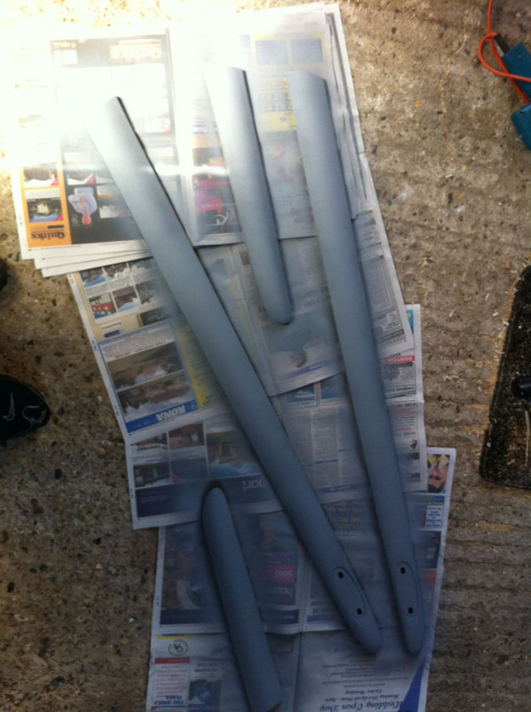

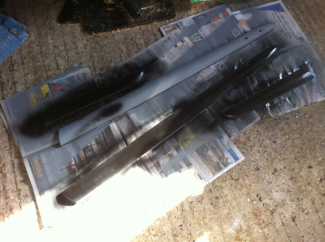

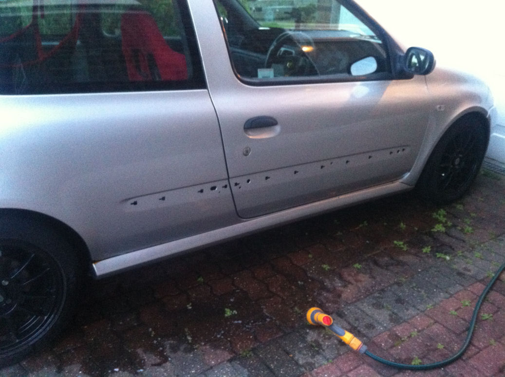

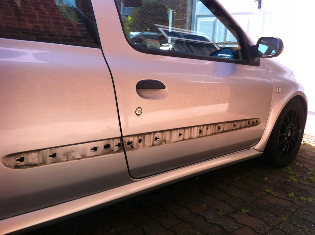

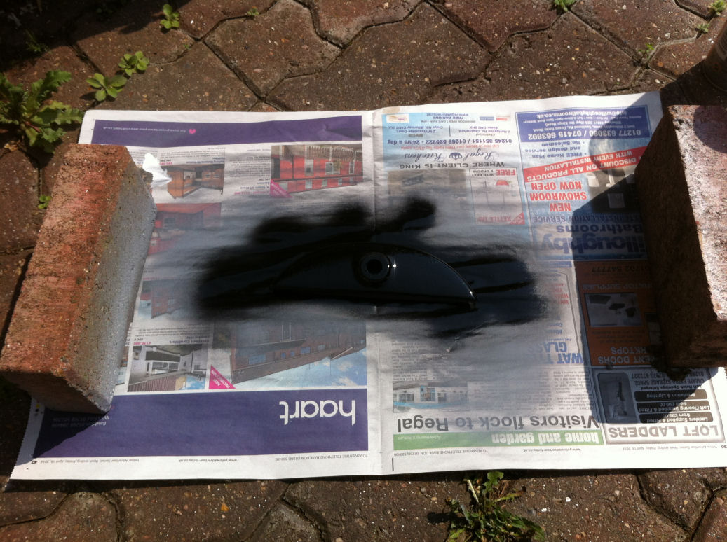

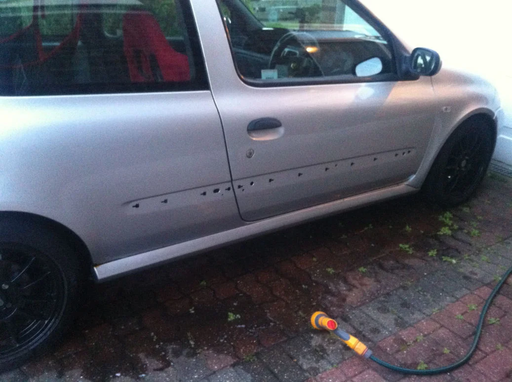

Then I decided to do something about the very grey side strips as they look terrible. Took them off to spray them:
Had to leave it there as I ran out of gloss black. Will probably end up doing the door handles to match now as they won't match any more

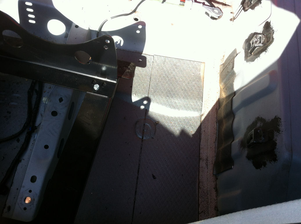

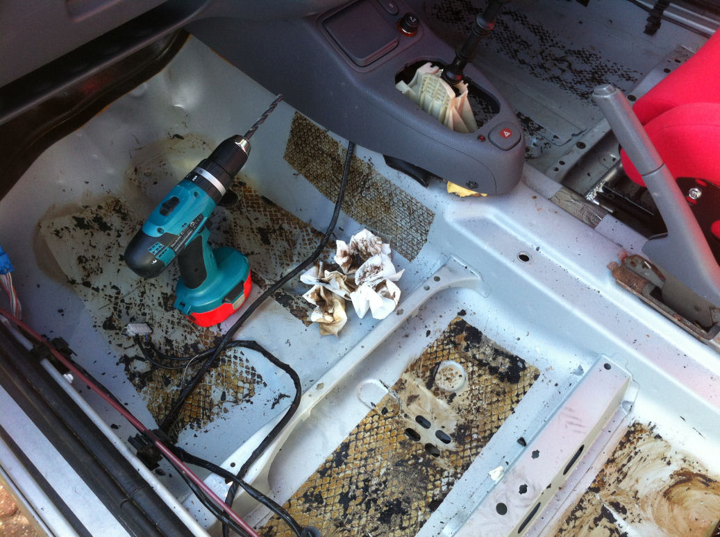

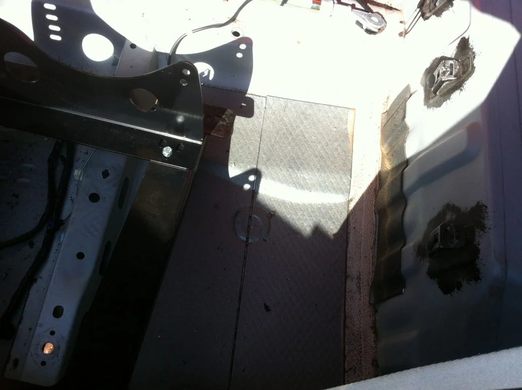

Last up was the nasty sound deadening. I already removed some of it over winter but this time I borrowed my dads heat gun. Much easier. What a horrible job though

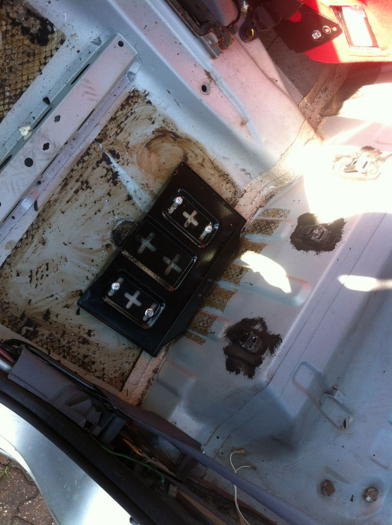

And I couldn't be bothered to spend ages cleaning so gave it a quick wipe over with white spirit. It won't be on show anyway under the seat. Then I bolted in my new battery tray ready for the relocation. Had to give up here though as what should be a simple job becomes even harder as I couldn't get the power steering reservoir of the way to pull my battery cable through as the blasted strut brace was in the way. Can't take that off without getting both front wheels off and arch liners out the way so I called it a day at this point

I stripped the tar pads from mine this weekend too! You had less around the centre console than mine which is strange. I suppose it depends on which Frenchman is doing it.
  RenaultSport 172
That's weird. Its heavy stuff aint it!
I've still got to do under the drivers seat but I'm in no hurry to do that.
Grandpa Joe
I took 5kg out, that was all the passenger side, drivers side and the boot. There is more in the doors, behind the rear door cards, on the bulkhead and on the roof. I'd hazard a guess and say 10-12kg in total.
I only did mine as I had the seats out getting the buckets in for Anglesey on Wednesday, I'm not sure I'll do the rest as I don't want to take the dash or the headlining out unless I have to.

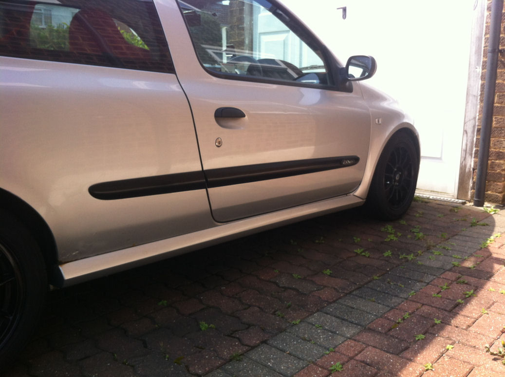

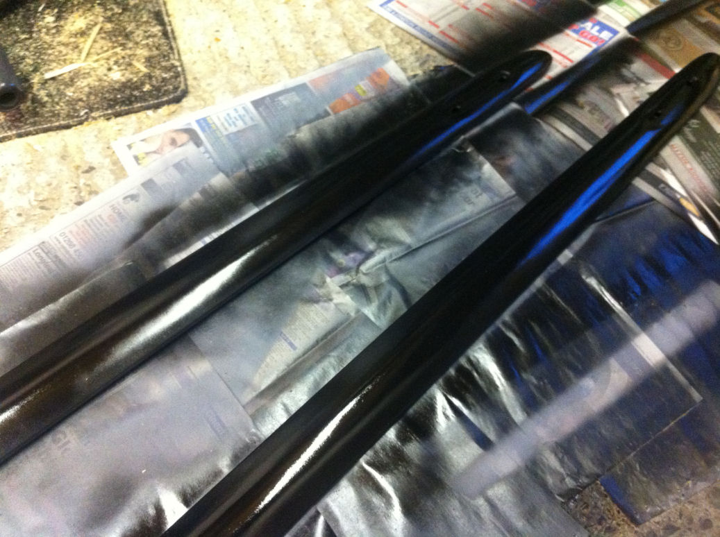

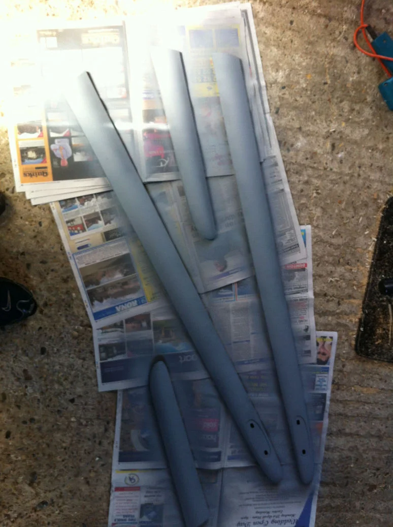

Ok so I finished up the side strips today:
Used a bit of AF citrus power on here:
Fitted:
Door handles do look crap now but I'm pleased with the strips.

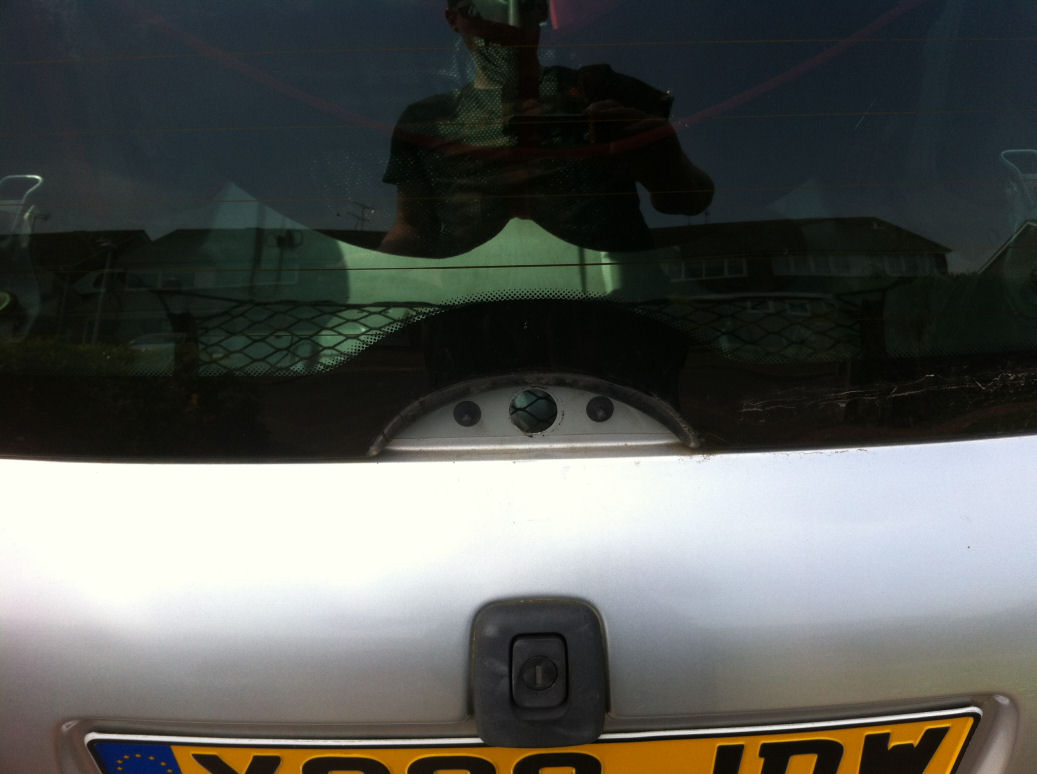

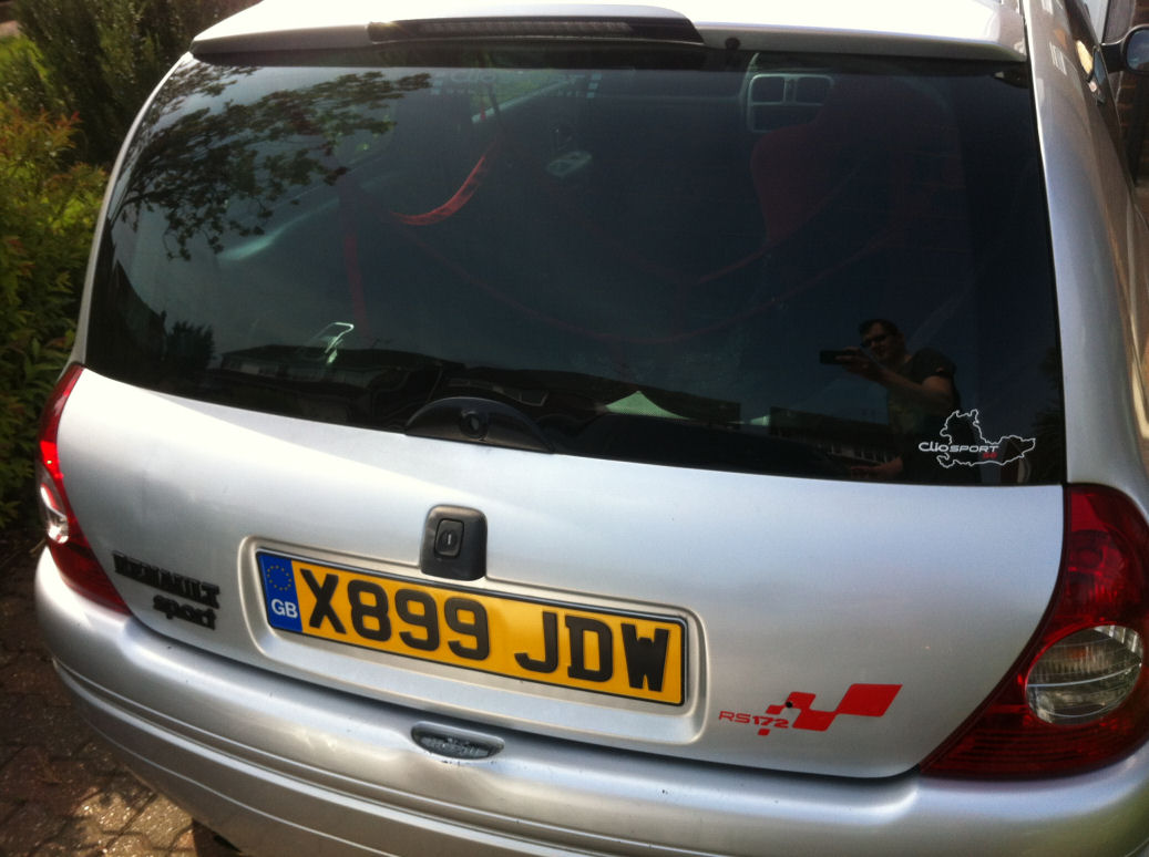

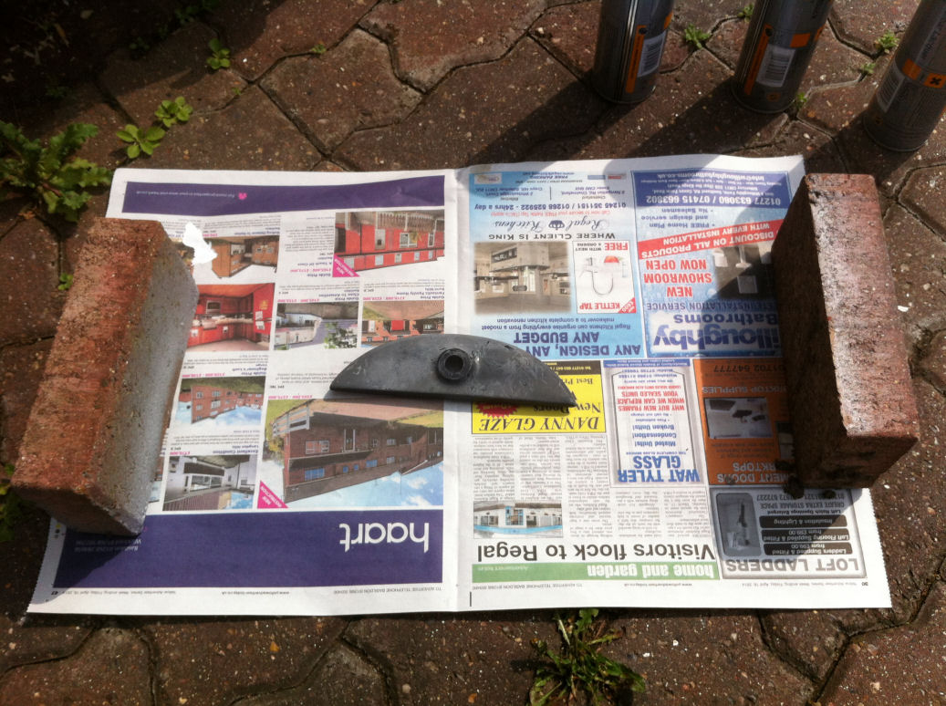

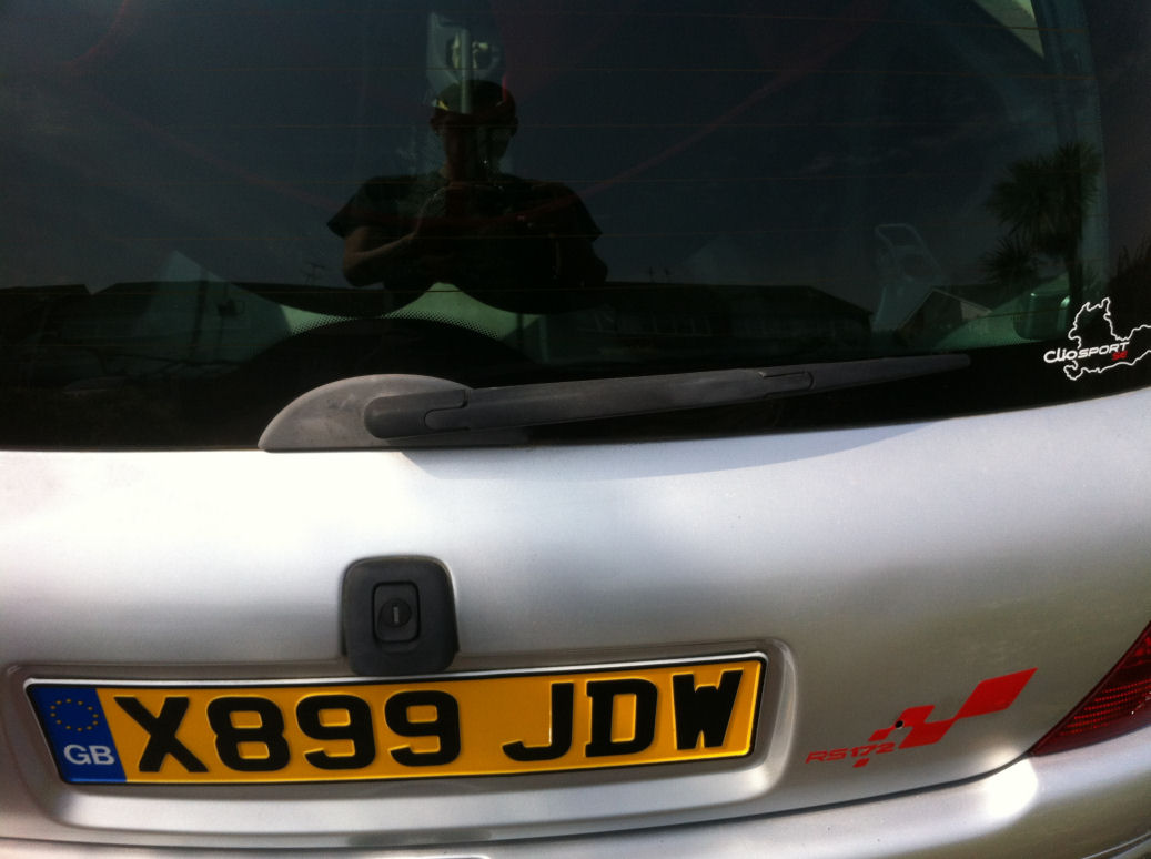

Then as I had a spare few minutes I thought I'd ditch the rear wiper:
Before:
Whipped it off after a bit of mucking around

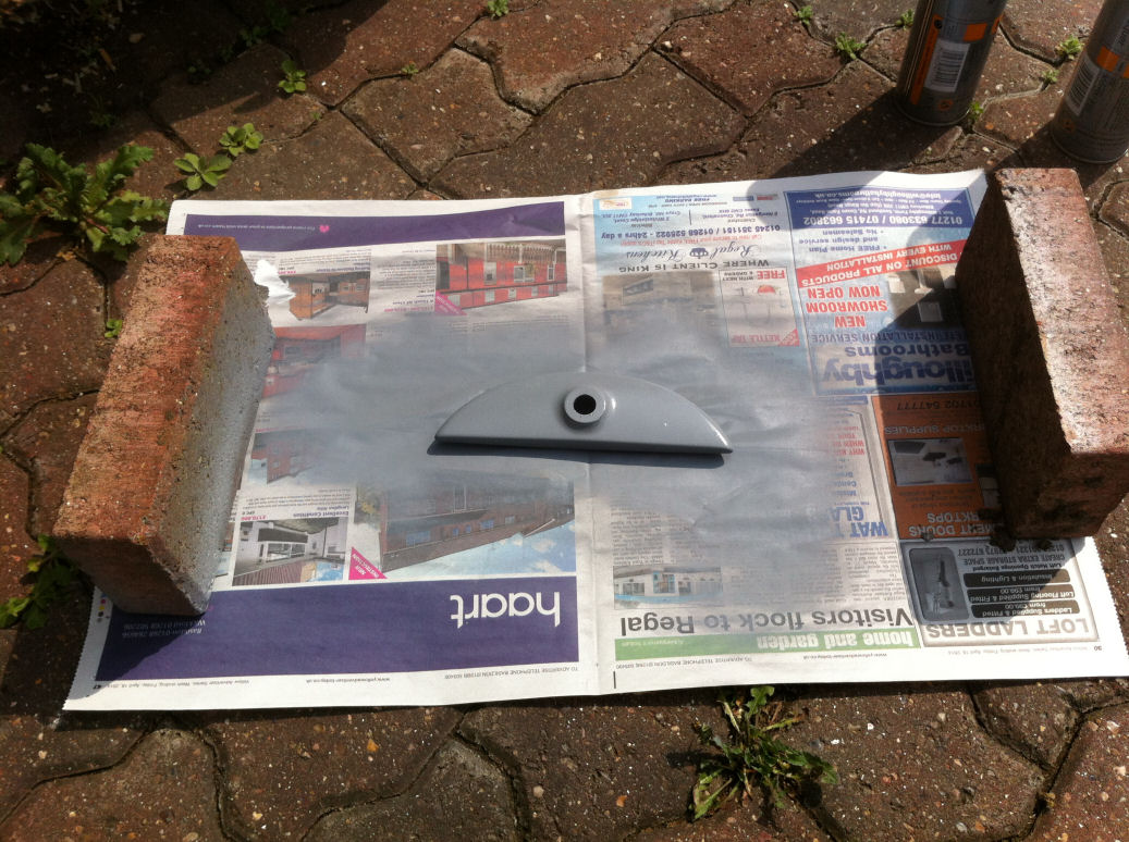

This was pretty terrible
Primed:
Painted:
Fitted:
Just need to add a rubber grommet now.

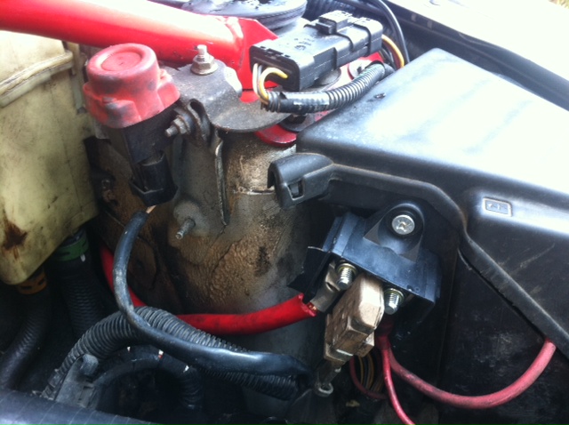

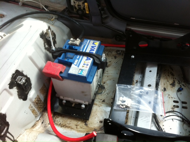

Managed to get my battery relocation sorted this weekend. Just need to tidy a few bits up but I'm pretty happy with it
Not got finished pics yet

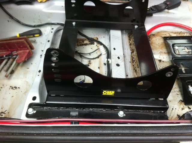

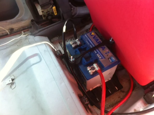

Here is my modified passenger subframe. This is now about 1.5" lower so much better.

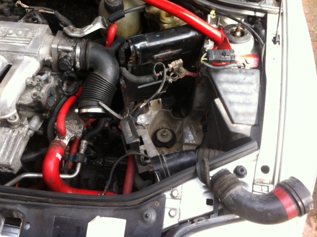

Got the battery out
And its new location
Will get some better pics soon. I also fit the new induction kit from @Ph1 Tom but I haven't driven the car yet

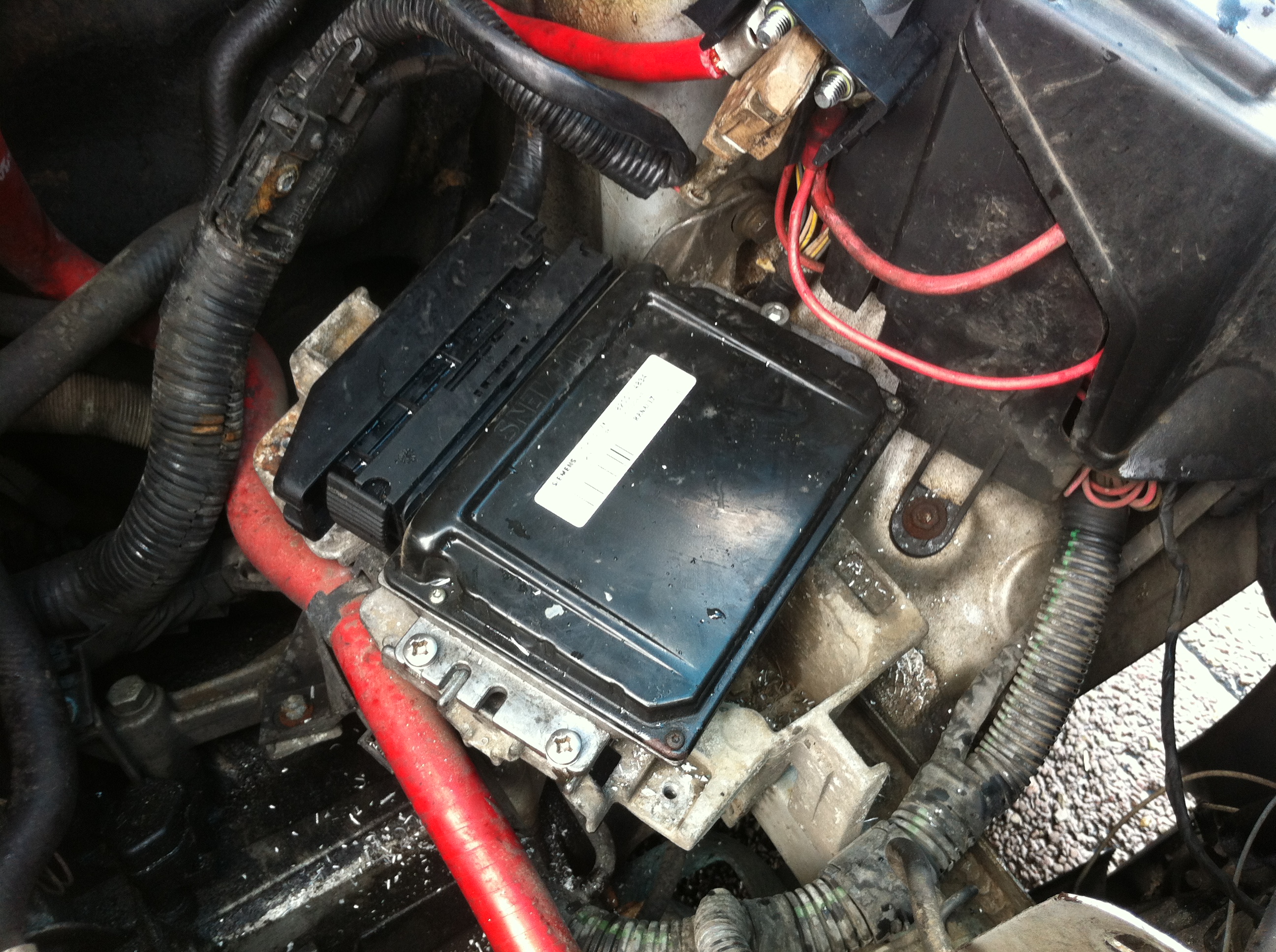

Need to get the ecu out of its cage and cable tie it down. Then mount my new battery fuse and tape up some of the wiring, few cable ties to tidy it and then its all sorted :)

Ok so the battery relocation is all finished and working perfectly :)
Just need to secure the ECU with some brackets which I'll do next weekend

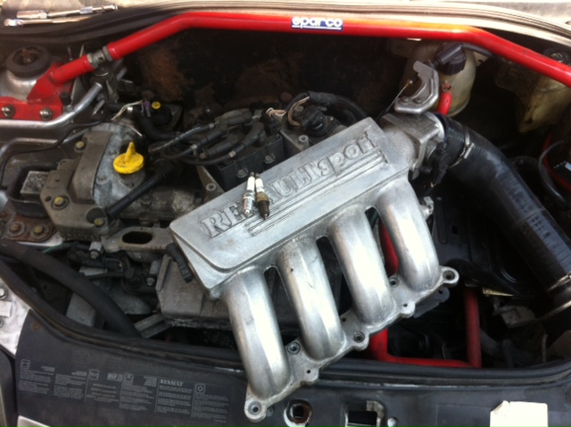

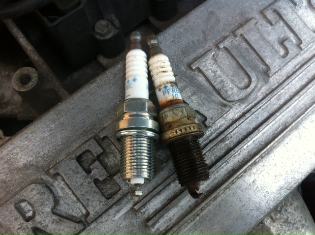

Yesterday I got the spark plugs changed. Was quite an easy job, much easier than on my ST220!
Old VS new.... No idea how old they were though

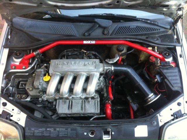

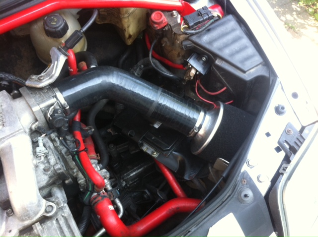

Here's the new look engine bay with ph1Tom's home made induction kit

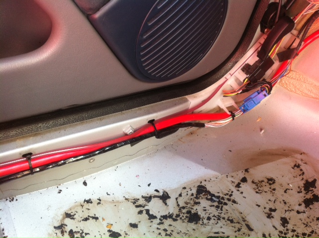

And just a few relocation pics
I could probably tidy up the length of the wires a bit in the future

And today's progress. The Ecu is now out of its cage and bolted down :)

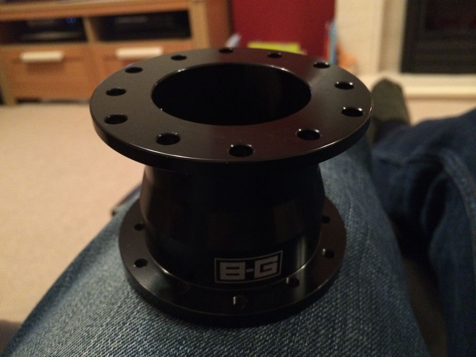

I found the steering wheel a little too far away so I bought this:
And then it was off to Bedford for the Renaultsport day. The car was great again apart from having problems with my spacers on the way there. I have now bought a better stud & nut kit to try and sort it

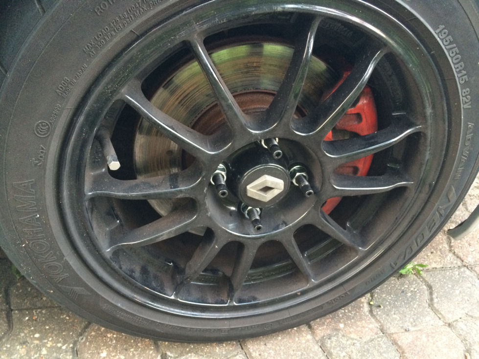

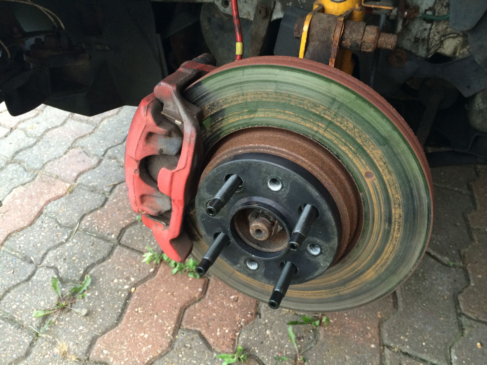

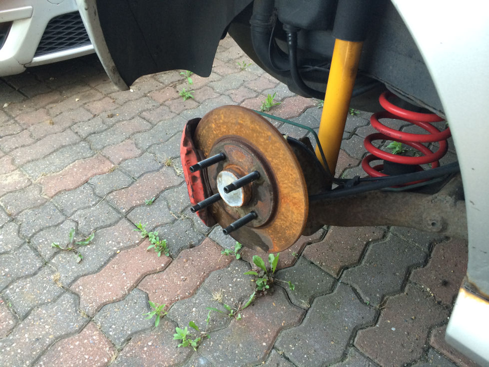

Finally got round to fitting my new stud & nut kit. This time I have fitted the studs into the hub. I should have done this in the first place!
It's similar to the pure motorsport kit so hopefully will fix all my issues
Can you tell I don't use the car much?
And with the wheel fitted:
Unfortunately I can no longer do the nuts up properly as the studs are a bit long. I have ordered a deep socket for my torque wrench which will solve that :)
