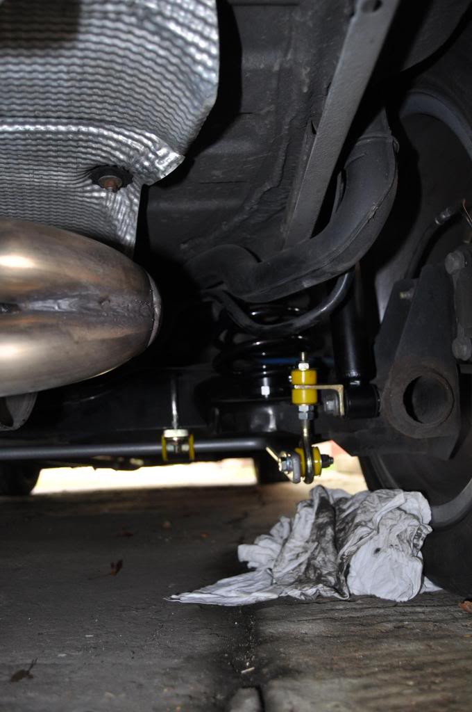

Bolt on jobby. Bolts to the same place the rear suspension is attatched to. RRP is around 155 iirc.
So its just a matter of attaching the two drop links to either end of the ARB, removing lower bolts to both rear shocks, attaching ARB and re-attaching shocks through it ?

All that + bolting on 2 brackets onto the rear axel. But yeh you got it spot on.
If you look through the old group buy thread gray has posted some pics on how they fit

They dont fit quite as i expected.

Just rying to fit mine and there is so much tension it is unreal.
Cant see why it takes 15 minutes to fit :S
Any advice? Or have I been given the wrong one?
Have you got just one side of the car jacked up?
