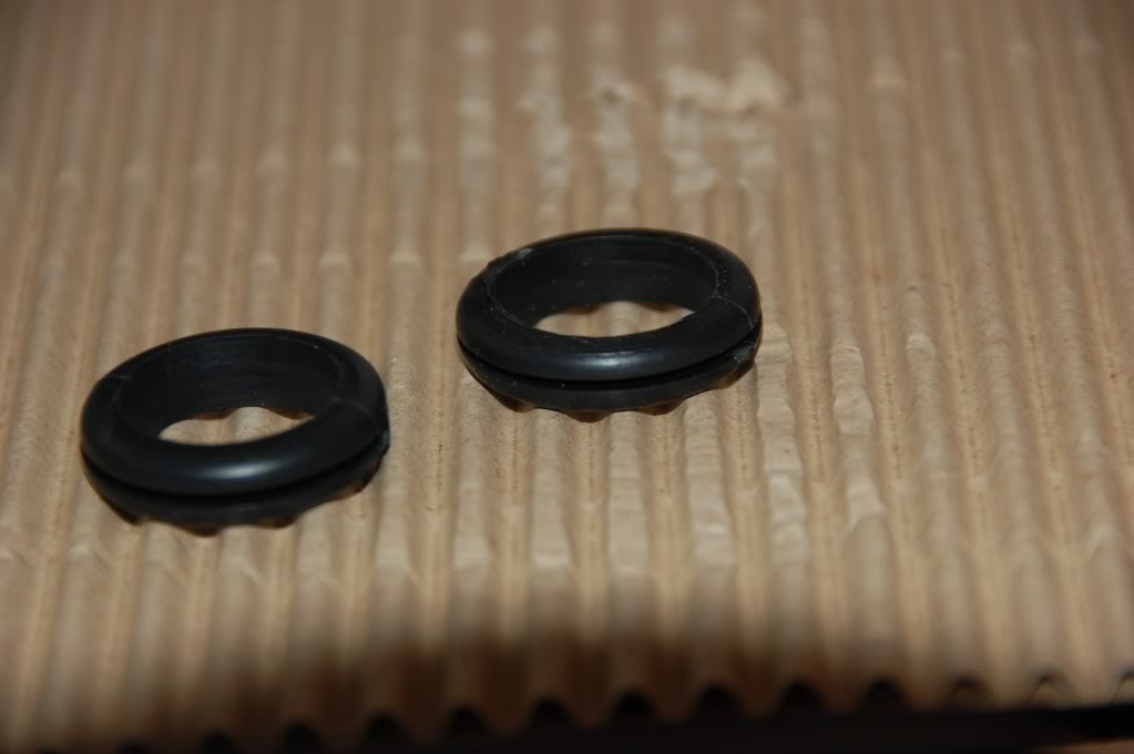

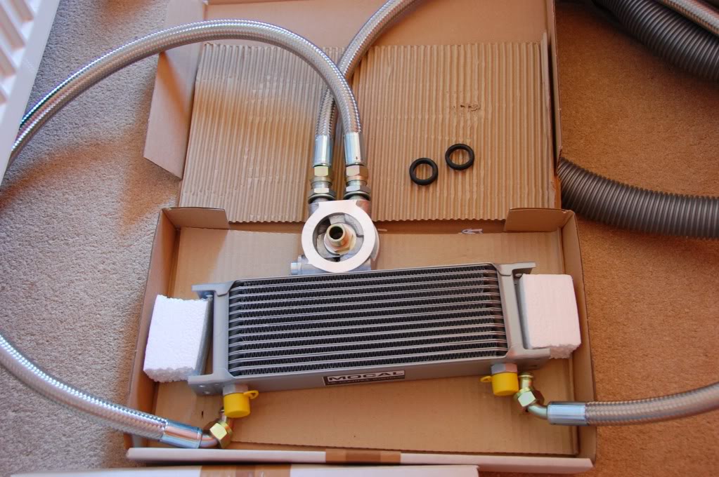

Got this off Timi (thanks mate ;)) , but i'm puzzled where these rubber bits go. Any ideas?

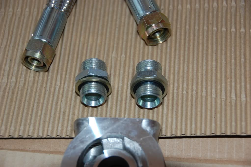

This is how I presume it goes together? ie. imagine the block is where the floor is.
I've tried putting the rubber seals in a few places, but they don't seem to compress/look like they would do anything. Presumably they must go around the thermostat/sandwich somewhere?
Any ideas?
they look like through panel rubbers
ie if the pipes need to go through the crossmember/slam panel etc, you drill your hole, put them rubbers in the hole and then put the pipework through them, stops the pipes rubbing on the bodywork and splitting
