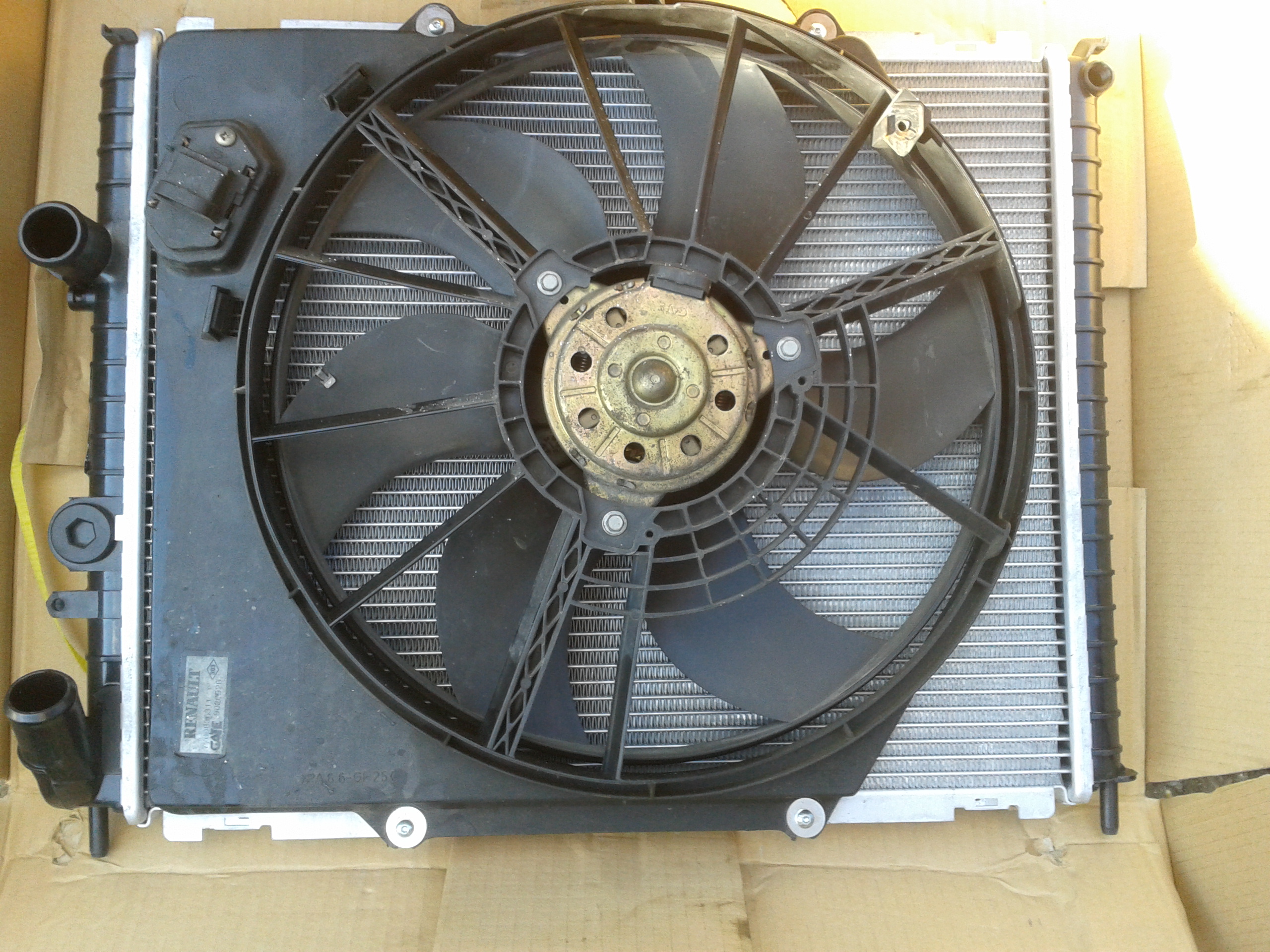

Maybe this resistor or the wiring to it..
https://www.cliosport.net/threads/cooling-fan-speed-resistor.449936/

Thanks Steve. I did come across that thread but could not work out where that part would be located on the car. Any idea?
On the radiator fan cowling.

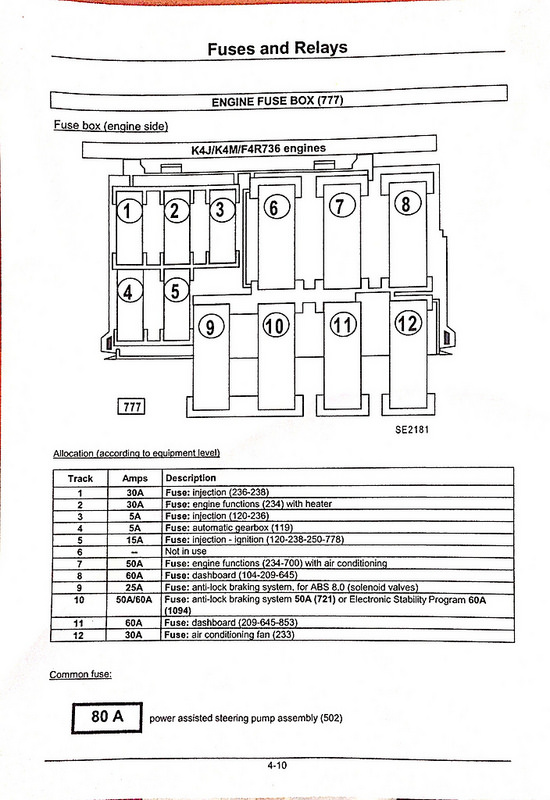

Thanks for the diagrams. I've cleaned up the contacts on the associated relays and fuses. However, the EML light is still on.

So is the fan working now?
It should run at half speed all the time the aircon is on.
