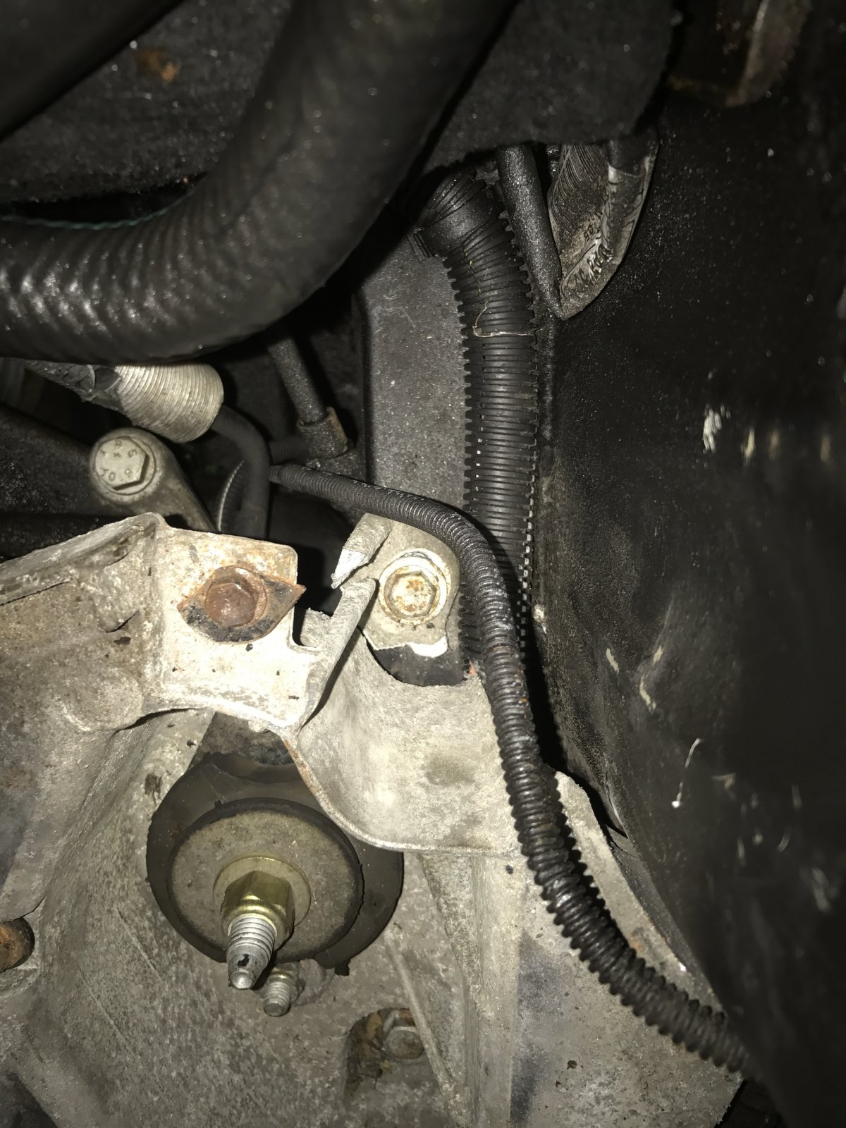

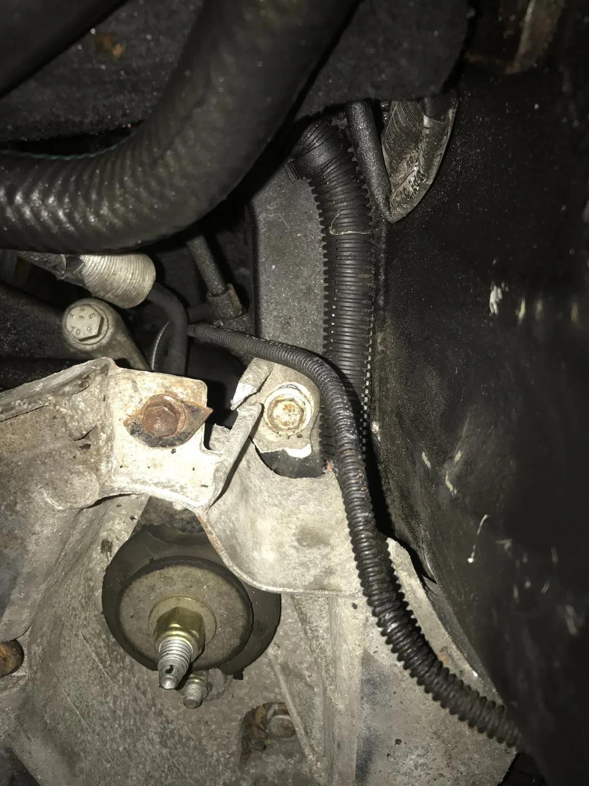

I was driving my clio round a cornor doing about 10mph when it felt like something had dropped now when turning it feels like the passenger side wheel is jumping forward and goes through the whole car. Ive checked the drive shaft etc and everything seems fine. There was a bolt missing out of the carrier on the calipers and also the bolts loose on the gearbox mount but fixing these have resolved nothing. Has anybody else had this problem
Did you check the gearbox mount? Seem to be a pretty common thing now on these with them breaking
That will be the problem
