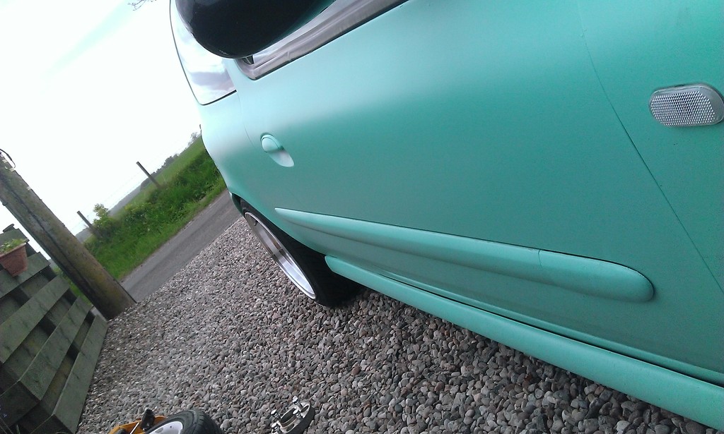

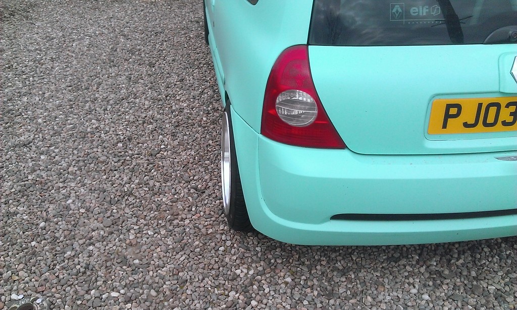

Few pics of the clio
Wheels are 15x8j et15and on the rear they are the same but with an added 5mm -1.5 degree camber spacer. Running 195/45/15 tyres
Previous wheels were 15x7j et37 with 25mm hub centric spacers all round plus the camber spacers on the rear. With the same tyres.

I'm trying to figure out whether ET13 15x8" wheels would work on my 172. You don't have more photos do you?
I'm afraid they'll poke too much with 195/50 tyres but a bit difficult to tell from that last picture.

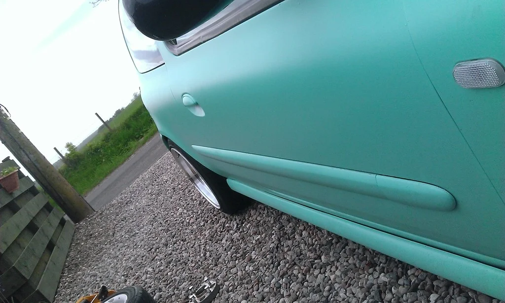

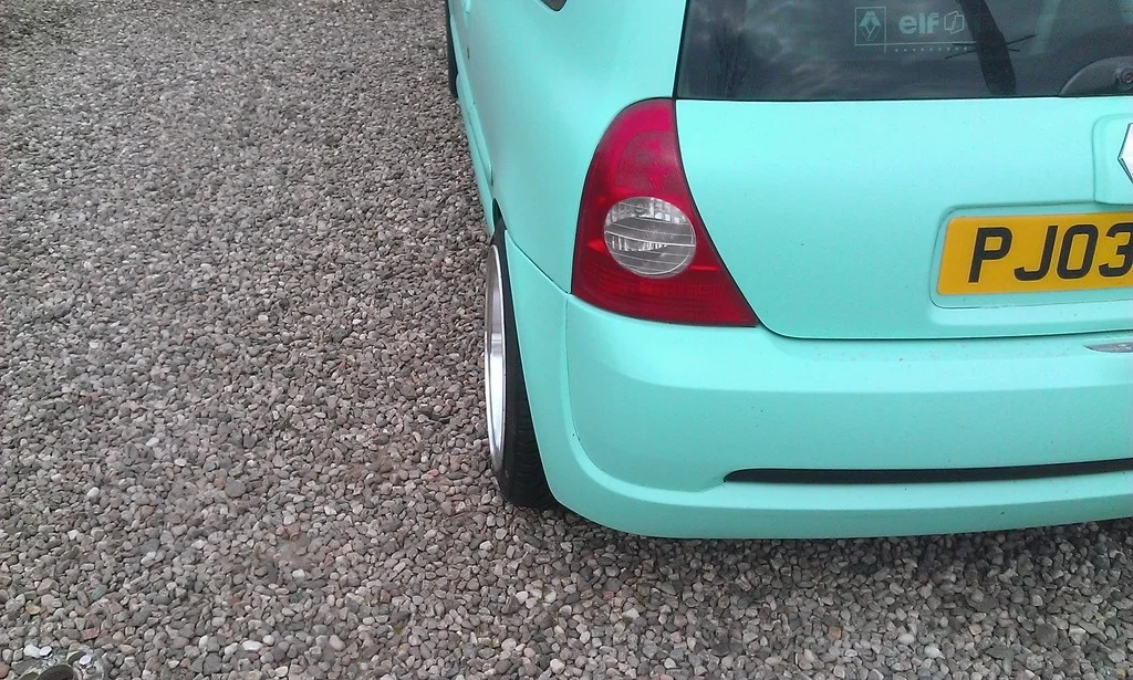

Dont know if these two will be much help.
Only pics i have that kind of show fitment.
