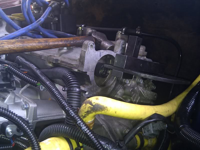

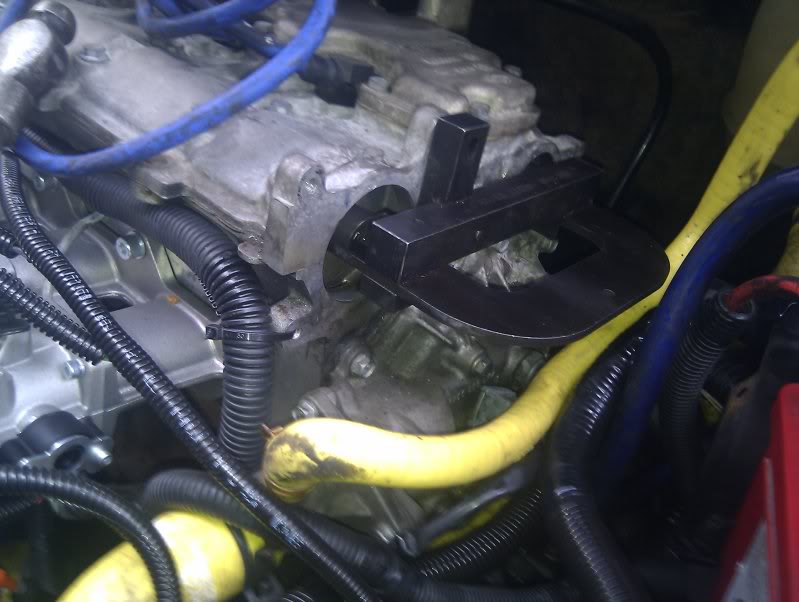

Anyway, the car gained 30bhp before the cam timing was setup.. so Danny, must be mapping? Hmm I think not.
Imo there is something wrong with cam timing, simple. It made 183bhp then the cam timing was changed and it lost 20bhp.
185bhp - SOMETHING CHANGES (ie cam timing) = 160bhp... Lets solve the equation here... oh looks like cam timing...
Also,the VVT made no difference AT ALL.... something is wrong there too...
Considering the calibre of cars we have in the workshop and the reputation and lengths we went to solve these issues??
Oh, the OEM selaed engine clio 172 that SiTech Racing mapped on our V4 made 173bhp, and went on to win its class at its first event, so that rules out the ECUs capablilities.... I wonder if that p[roffesional racing drivier said about the 1bhp gain, or the fact ther car was circa 155 when it arrived?
Im not going to defend myself etc as for a start theres a few people on here who knwo wwhat they are talking about, and like myself, are intriegued as to the low power. For the ones who cant explain MBT, AFR or ignition advance, you're right, its the mappng...
Cam timing would struggle to lose 20bhp. 10bhp maybe but 20bhp it'd have to be massively out. Also 16 degrees of inlet cam timing advance added to the above will make some difference, even if that difference is bouncing valves off pistons because the timing is so far out!
Have you checked the VVT actuator is moving? Put 12V across it from a bench supply and it should move 4mm or so. If it does stick a noid light on the VVT actuator plug and make sure it illuminates at whatever point is set in the calibration.
Is this engine running crank for posistional only or have you fitted a cam sensor to run 720 sync? If so are you sure the injection timing is sensible? Are you running the injectors paired i.e. two injector drivers or individualy driven from an injector driver each? If so 99% of Renault engines are numbered backwards to conventional 4 pots with no1 at the gearbox end as such if the injectors have been wired as per a Ford 4 pot or similar with no1 at the front of the engine any injection timing strats will be out..... by a fair whack.
The F4R 7's are a simple little engine and running port throttles on one also means there's only one load sensor to bother with as well. It should be a nice easy job. We did AT Powers demo/toy car on Tuesday and it drove out that evening, that included fitting bodies, making a loom, calibrating the controller and having a beer at the end of it to celebrate the 29bhp gain.

Cam timing was out by a long way originally
Then corrected
Car was dyno'd and the fueling altered, but the ignition timing not touched....erm, of course it was going to be down on power at this point, the ignition timing will have been massivly different to what's needed if the cams are THAT far out when it's mapped to start with

Cheers for the info, the car has now left us. We originally saw a 30bhp gain. The injectors are paired and also only running crank sync, simultaneuos (can run seq and alkternating if needed) , 90* injection. Tried playing with a few bitsd and bos to njo effect.
