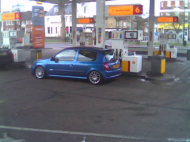

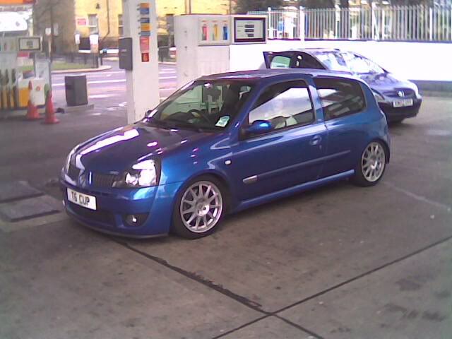

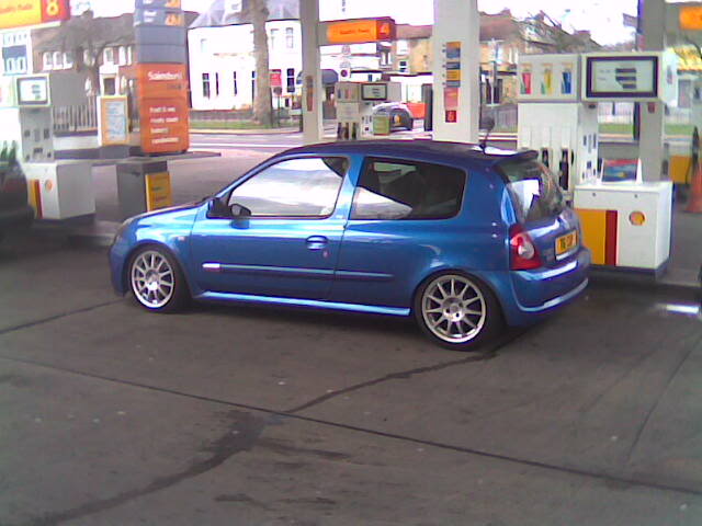

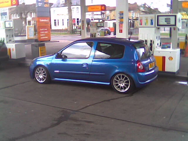

Few recent crappy phone pics... FAO:H&R thread..
first 3 have the missus in the front and a rear passenger so rear is a bit lower than usual. oh and sub in boot.
and last is empty, no one inside....so standard height.
hope it helps...

That's lower then mine at the rear and mines wound all the way down.

i want it as it is in the top pics all the time with noone in it...
Come on Fred... sort out those springs ;P
low as they go at the rear, Yozzasports Fred set them up!! just the difference 17's make. Doesnt look that low from a normal angle - it
is bloody low though.
The front cant come down anymore without rubbing loads - at the moment all is good - no rubbing (but I have cut a small piece of the
arch liner out and modded the bumper mount but I believe everyone does this with coilovers)
The rears rub a bit but thats down to a ET37 offset - getting some OZ F1 cups tomorrow with an ET42 offset so should all be sorted.
Knowing my luck will probably rub like fook on the inside! lol. May have to get some spacers for the front but David at K-Tec sells turinis
in ET42 and he says they are fine - should not get any rubbing.

timsclio 172 how low are yours H&R.I have 17" ET37 and now H&R-35.-30.Can I go lower?
the front will be fine but not sure about the back - if you pull the corner of the rear bumper down and put your hand inside you will feel a piece of metal that sticks out quite a lot - if you remove that both sides its a lot better but from that photo I would say you could probably go down 5mm and be ok
