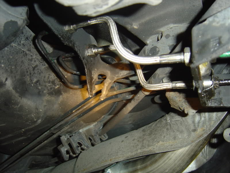

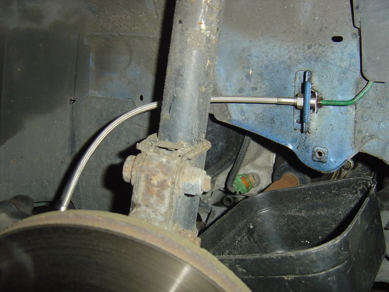

Sounds like the garage may have missunderstood where they fit. The fronts go from the solid line in the arch where the bracket is to the caliper. The rears go from the lines under the car to the axle (not to the calipers).

Heh - yeah - I think you are right. Reckon they must have thought the rears were for the fronts - ie: too short and not known where the rears go. I didn't know to be honest! Will take it back are explain to them. They are a decent garage, but not Renault specialists.
Thanks for the reply - and the pics! :)
