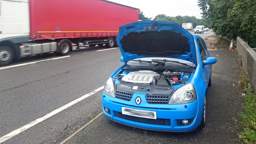

I was driving back to London from my visiting family this week when along the A14 there's a bang and the car cuts out. Thankfully I was in the inside lane and not going too quickly (maybe 50ish) having just cleared a load of traffic.
I manage to coast it over to the sliproad/hard shoulder. Popped the bonnet to have a look and there is a strong smell of plastic/rubber burning. I notice that half of the Aux belt is missing.
I know this isn't the media section but a couple of pics will break up the text a bit:

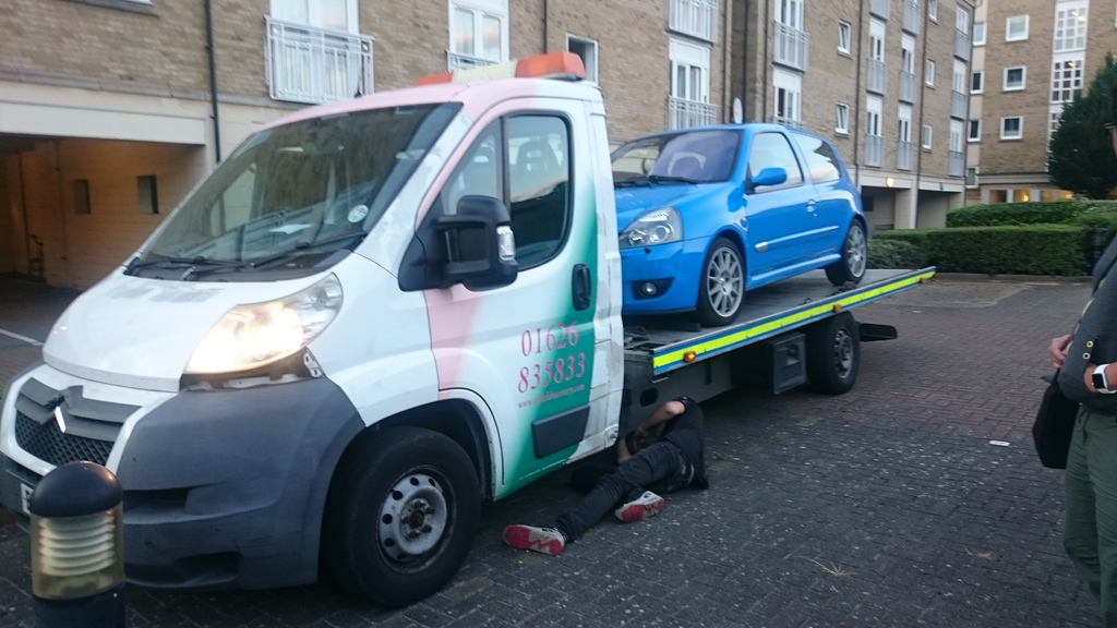

The AA came out and he reckons the aux belt has taken out the cambelt as there is no sign of the missing pieces anywhere. Anyway I end up getting recovery to take me the rest of the way into London, rather than the nearest garage.

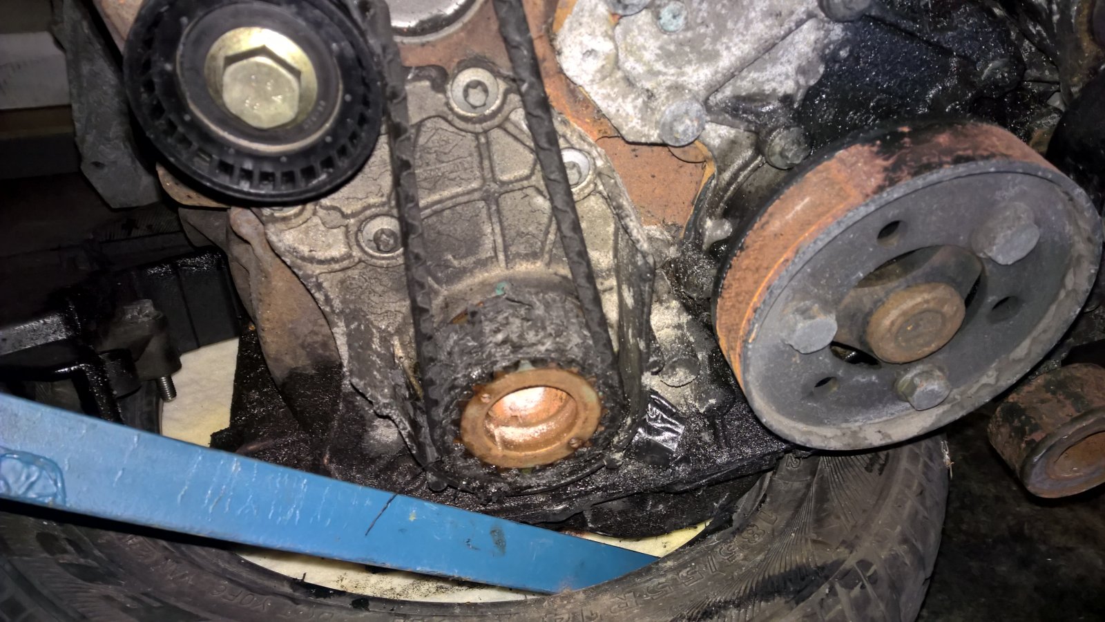

I tell you exactly what happened,
Your pas pump is fucked, the shaft moves in and the belt slowly moves until it comes off, wraps round the crank and boom.
If your belt was dodgy or done wrong it would of failed before now,
This happened to me twice, luckily I caught it before it came off and the second time it was a recon pump that failed after 2k miles.
I lost an engine before because of the aux belt so I check my aux belt weekly, better safe than sorry.
Just buy an engine off here or ebay and have the timing belt water pump and dephaser done fling a new clutch in while your at it, cost about 800 fitted, and get a new pas pump and crank pulley, the you can kick its arse without worry.

So now I just need to sort transport 150 miles [emoji52]

Back in 2003 I bought a 172 Cup brand new and on 20k miles / 2yrs the same thing happened... aux belt shredded and took out the cambelt... i was accelerating and suddently a bang and all lights on the dash came on and complete loss of power.
As it was in warranty (the whole car) they fixed the head etc.. but when it was done I could always hear a rattling under high revs etc... 2 weeks later I traded it in for a scenic (had a newborn etc)...
Just goes to show it can happen without warning in any age/condition.. must be some misalignment causing it to frey/wear then snap surely... from memory at my 12k service they had changed the PAS pump saying it had a leak... had anything done with yours recently?

They most likely used the same belt when they done the pas pump hence the failure
  Titanium ph1 turbo
Hmm possibly.. come to think of it, I'm pretty sure even before the PAS was replaced the belt had already once been replaced as it was fraying down one side... 12-13yrs ago now, trying to remember exactly what happened.....

I had the car trailered up to the dealer at the beginning of the month and left it with them.
