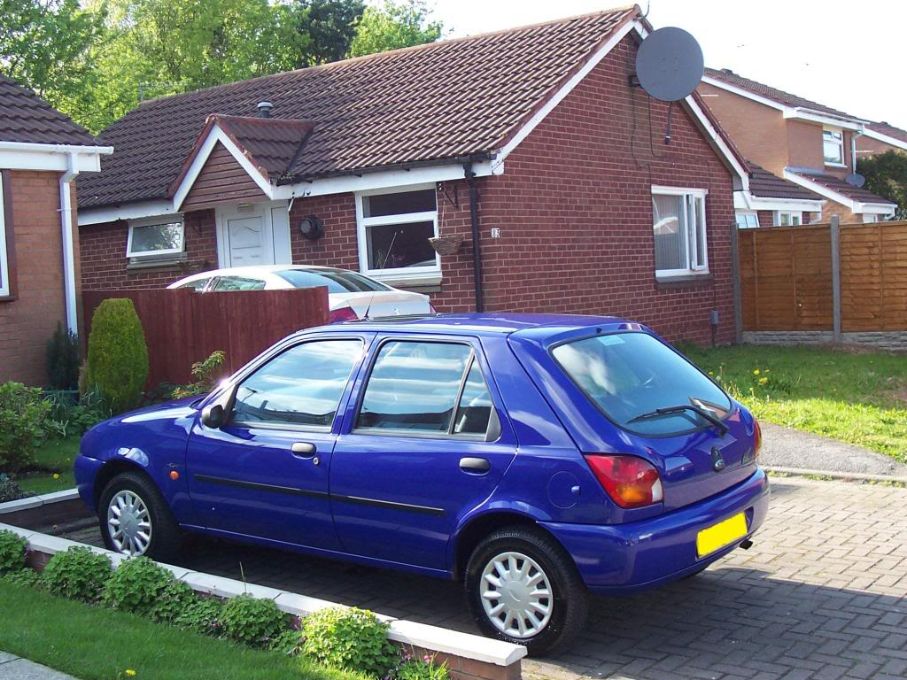

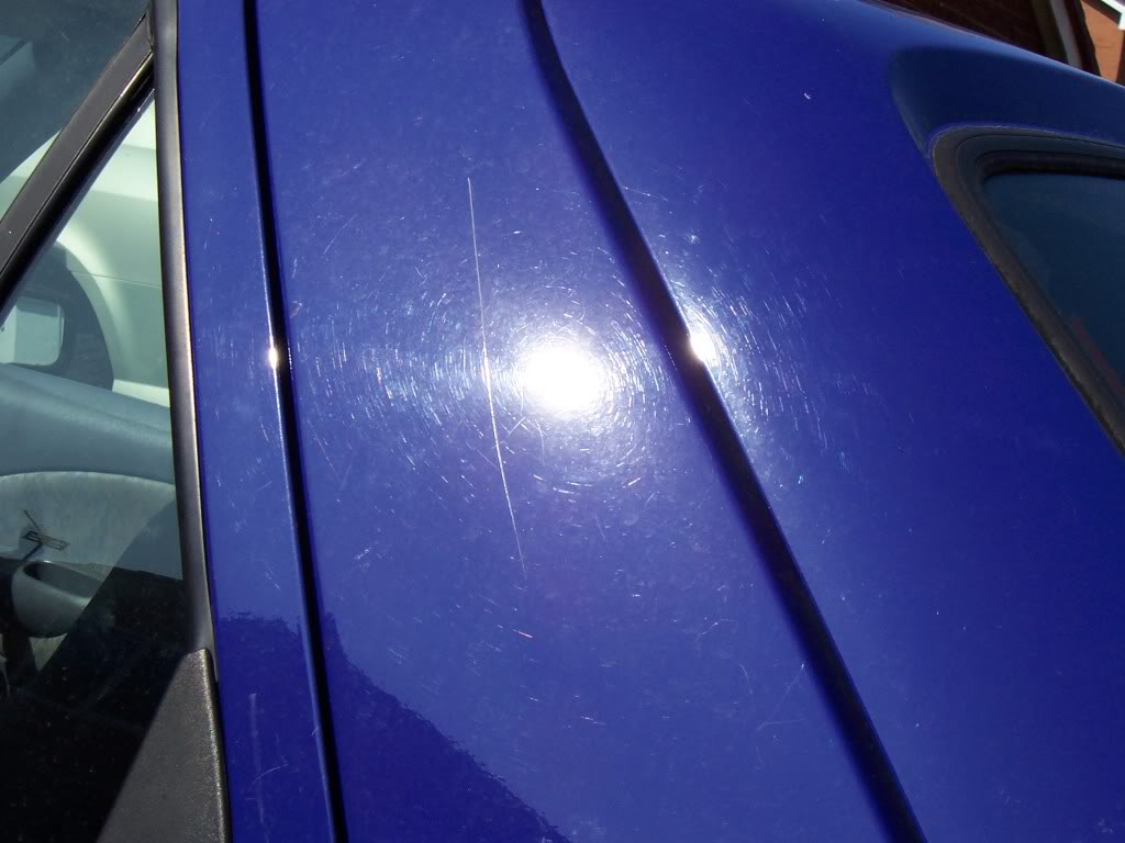

Got asked to do some work on a 1996 ford fiesta which I was told needed a few scratches taking out and a quick clean.
The girl who had just bought the car had only bought it for a few hundred pounds and didnt want to spend too much getting it looking right so I said id give it a quick clean and hoover, and take out a few of the scratches that she wanted removed.

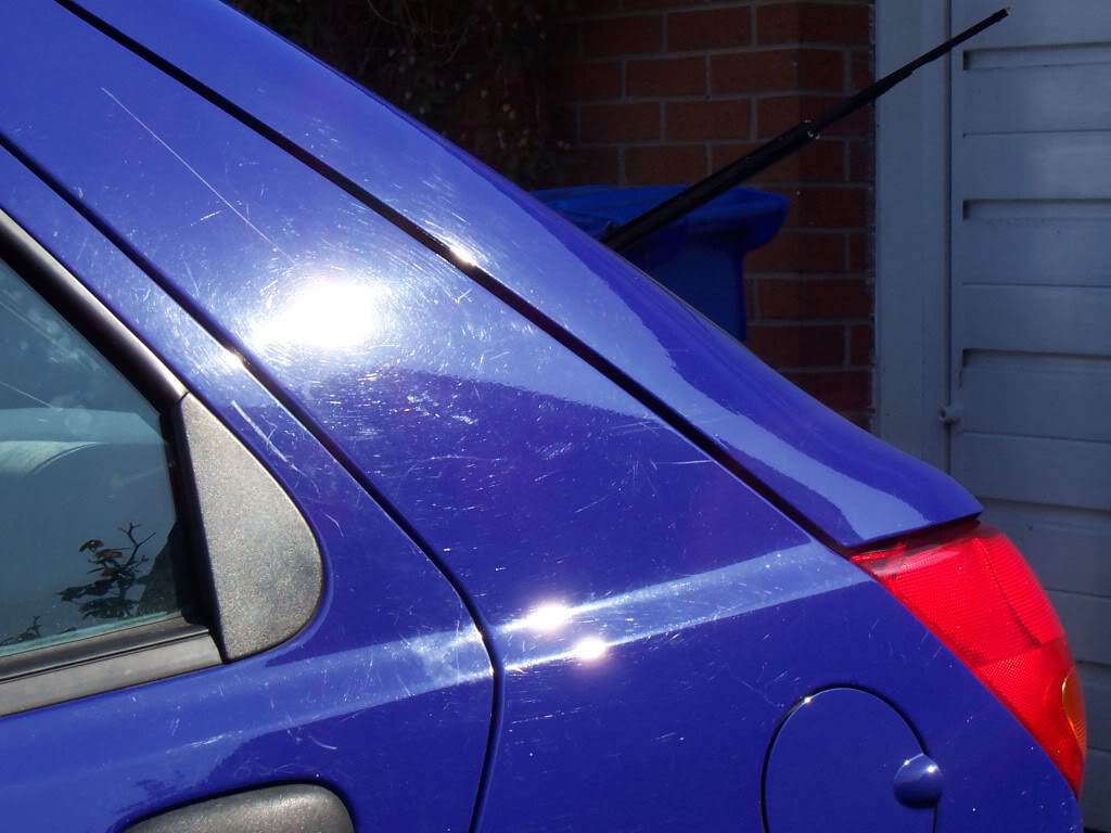

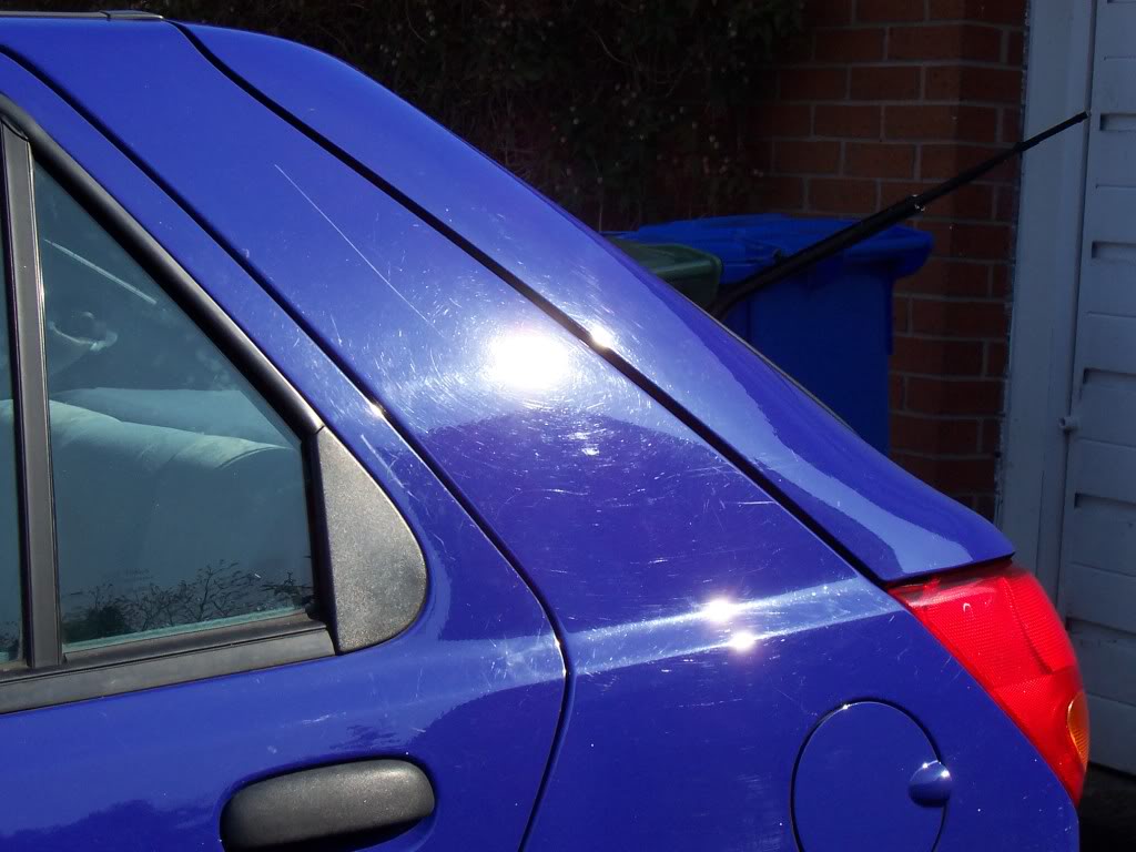

However on arrival the car had around 2000 deep noticable swirls on every panel with lots of scratches all over the car. She wanted all the scratches out :shock: This was not going to be possible lol. After a quick chat with the new owner it was decided that the car would get a one day detail (minus the wax application to save costs) and a interior valet the following week.

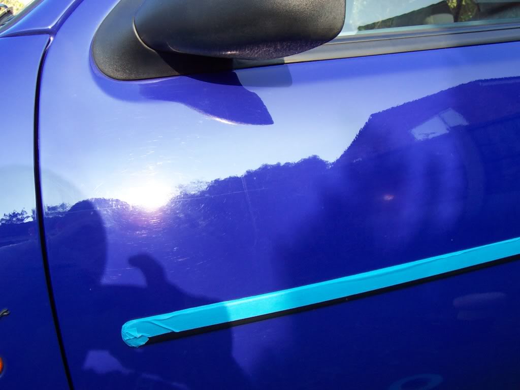

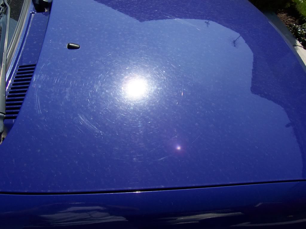

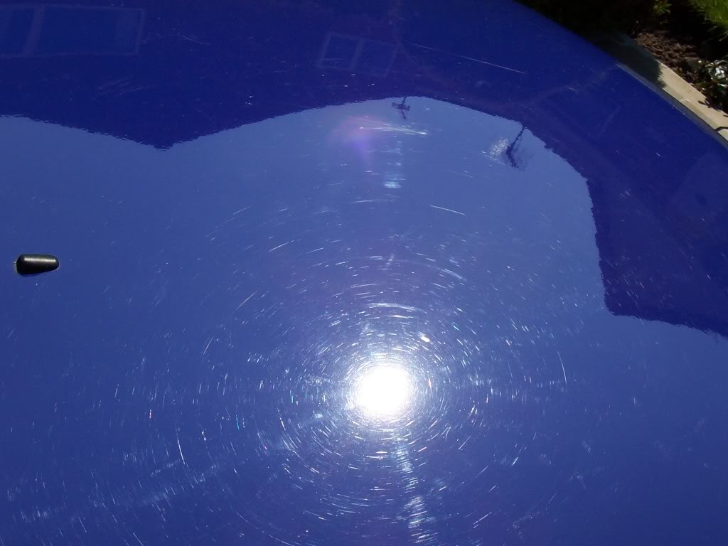

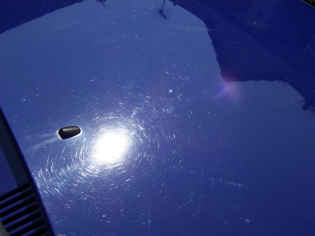

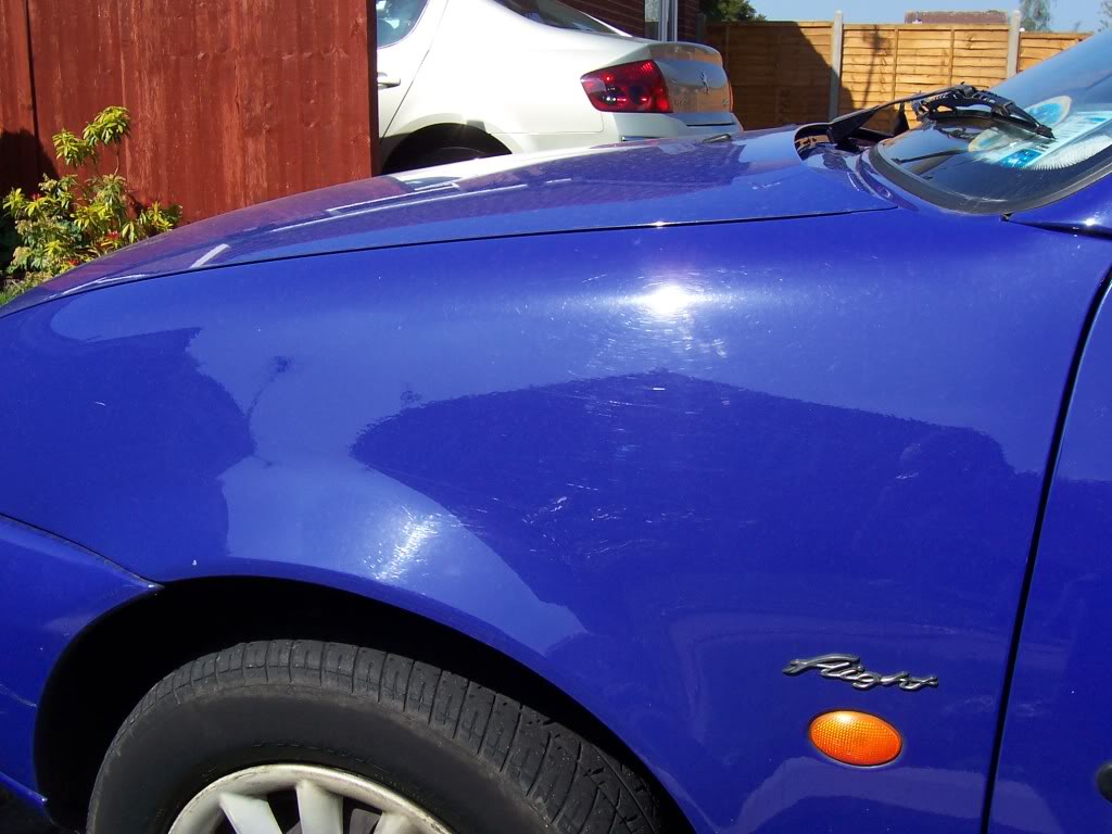

The car looked like this; (deep swirls on every panel)
So after a wash with PH neutral snow foam and gold class and dry it was out with the G220.

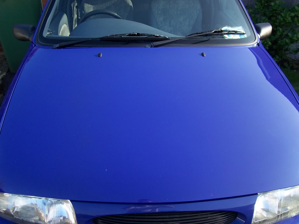

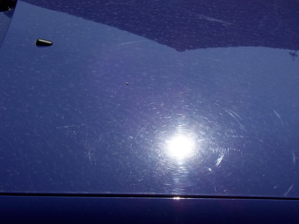

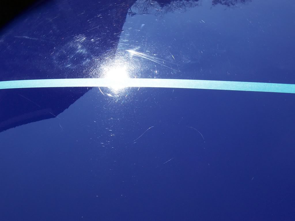

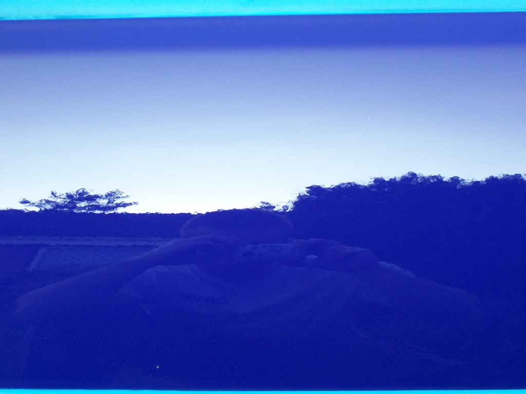

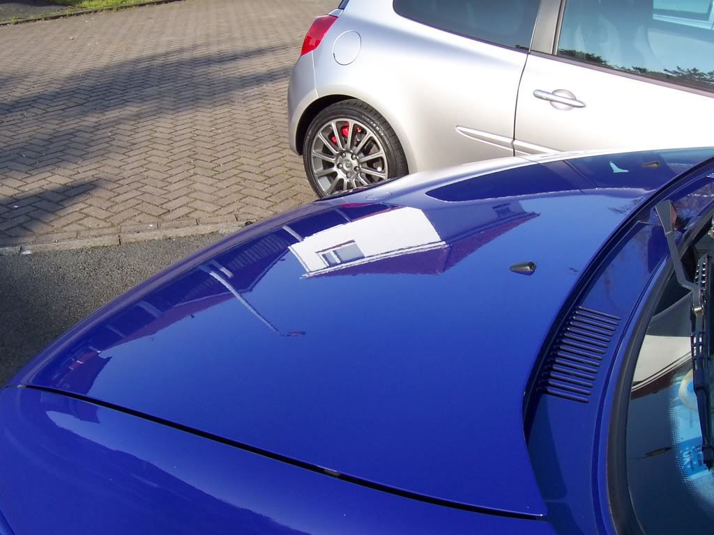

Picture below shows (a poor...sorry) 50/50 shot off the bonnet after one pass with menzerna RD3.02 but this was not enough as can be seen :dapprove:

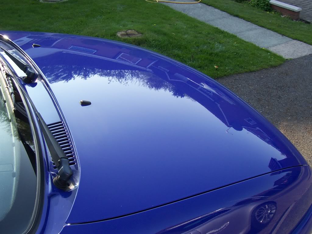

Eventually after a few tests with various polish and pads the best combination was chosen. The results were good.

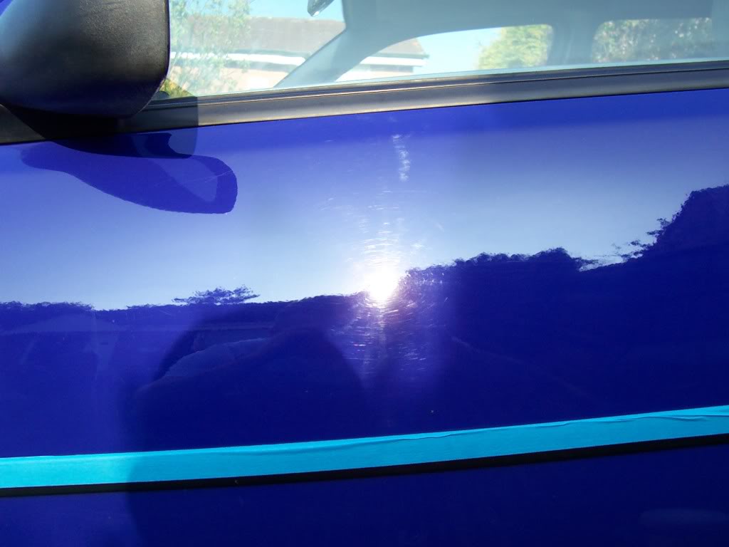

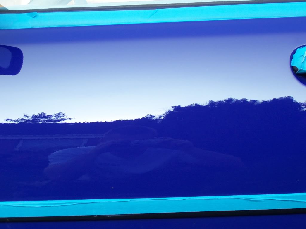

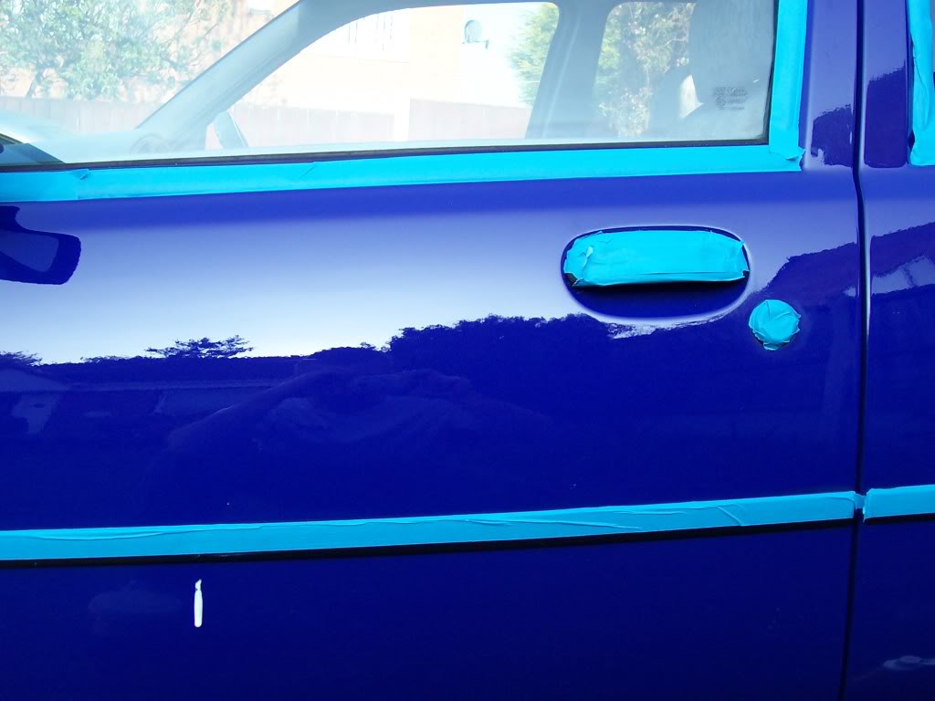

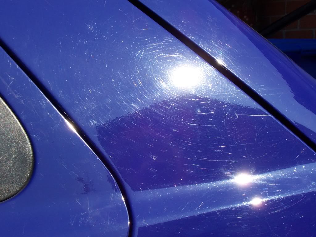

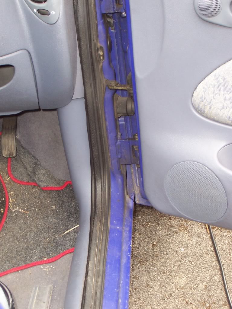

Now for the doors. These were just as bad, full of swirls and scratches.

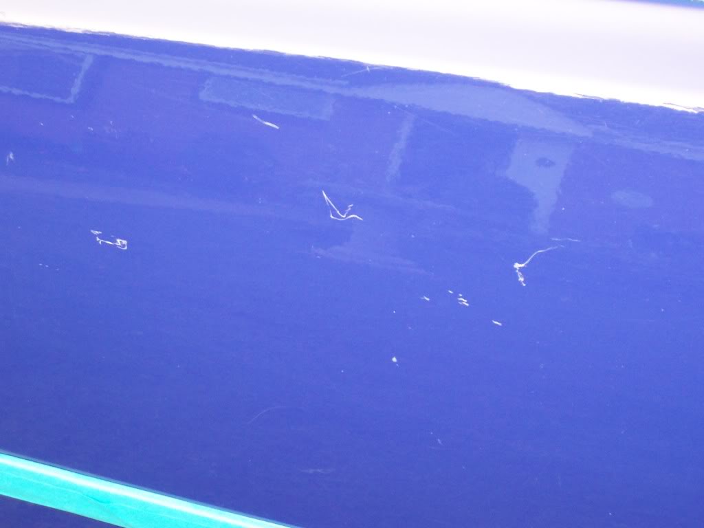

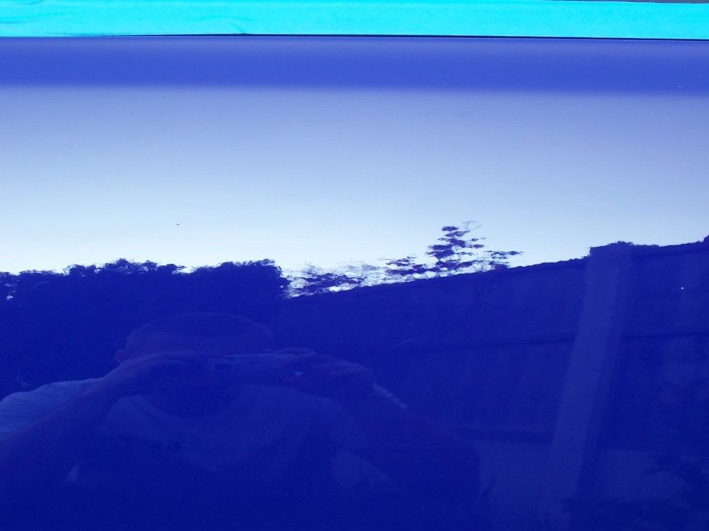

Scratches after one pass with the G220

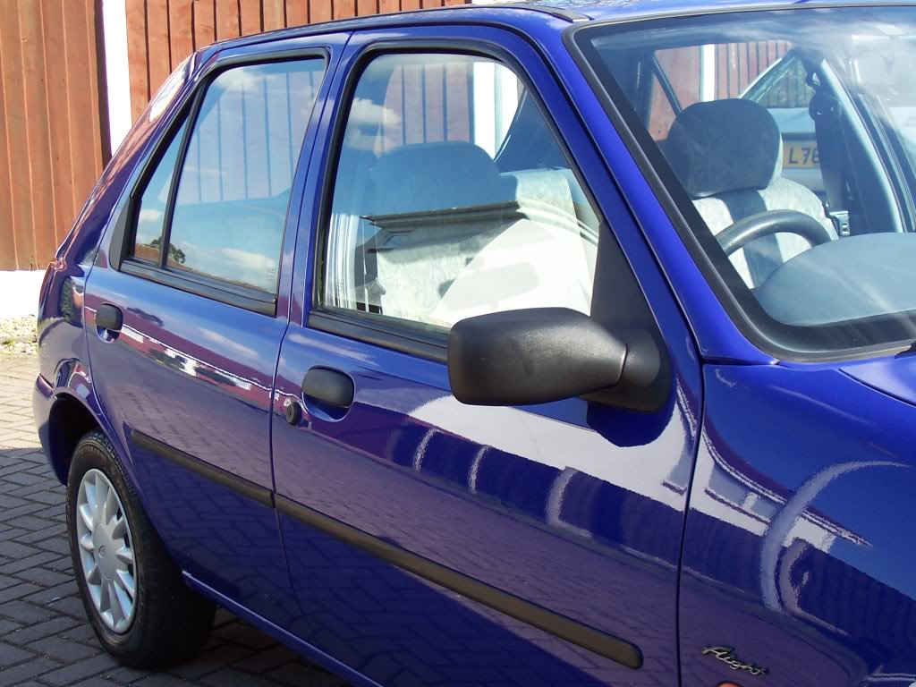

After hours of polishing :rolleyes:

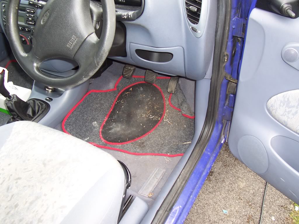

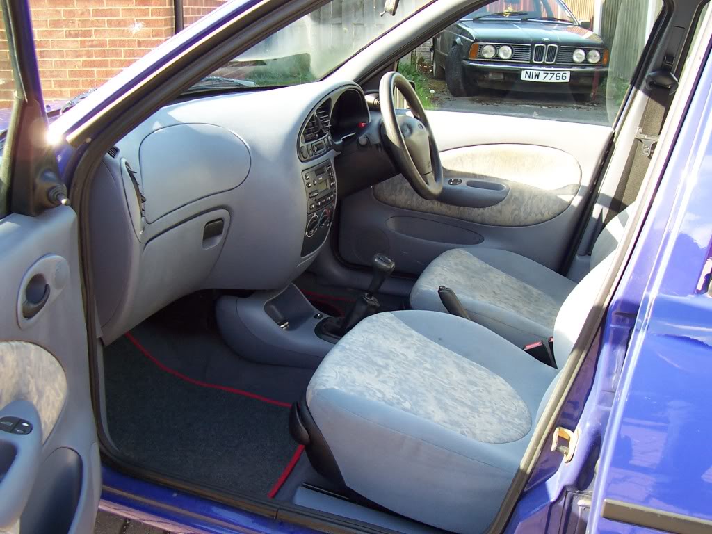

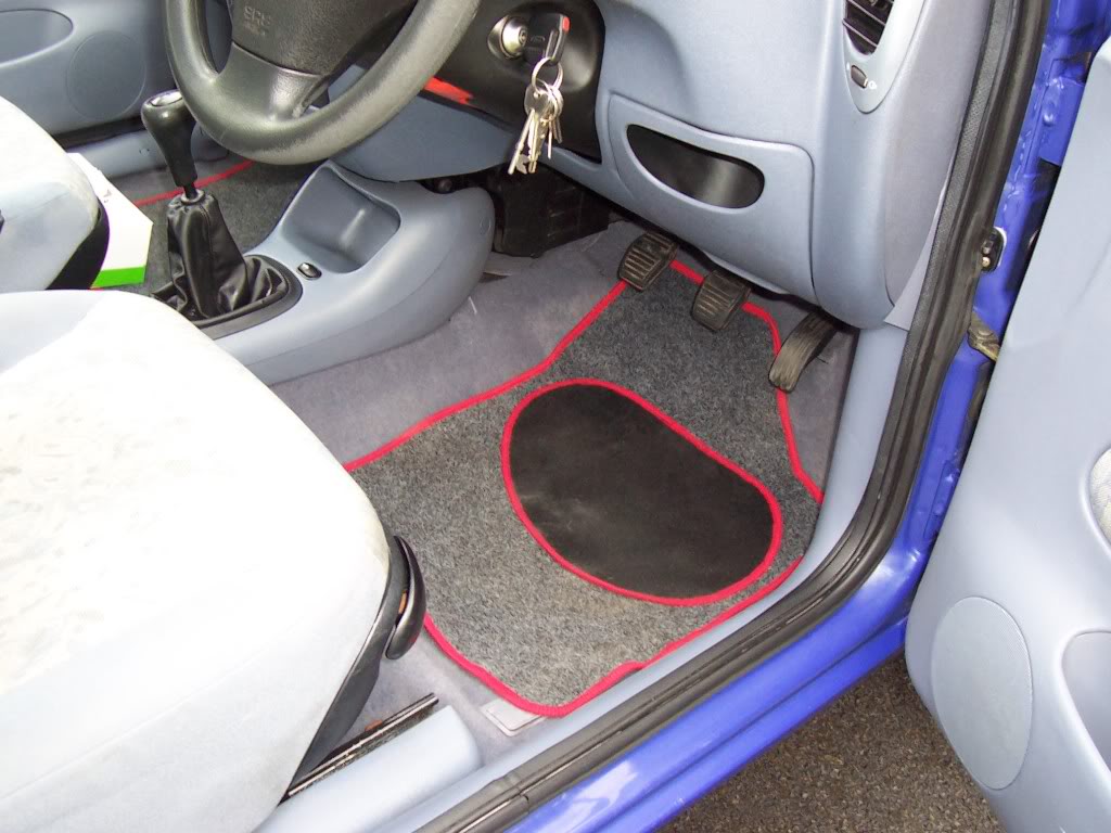

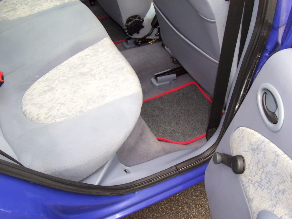

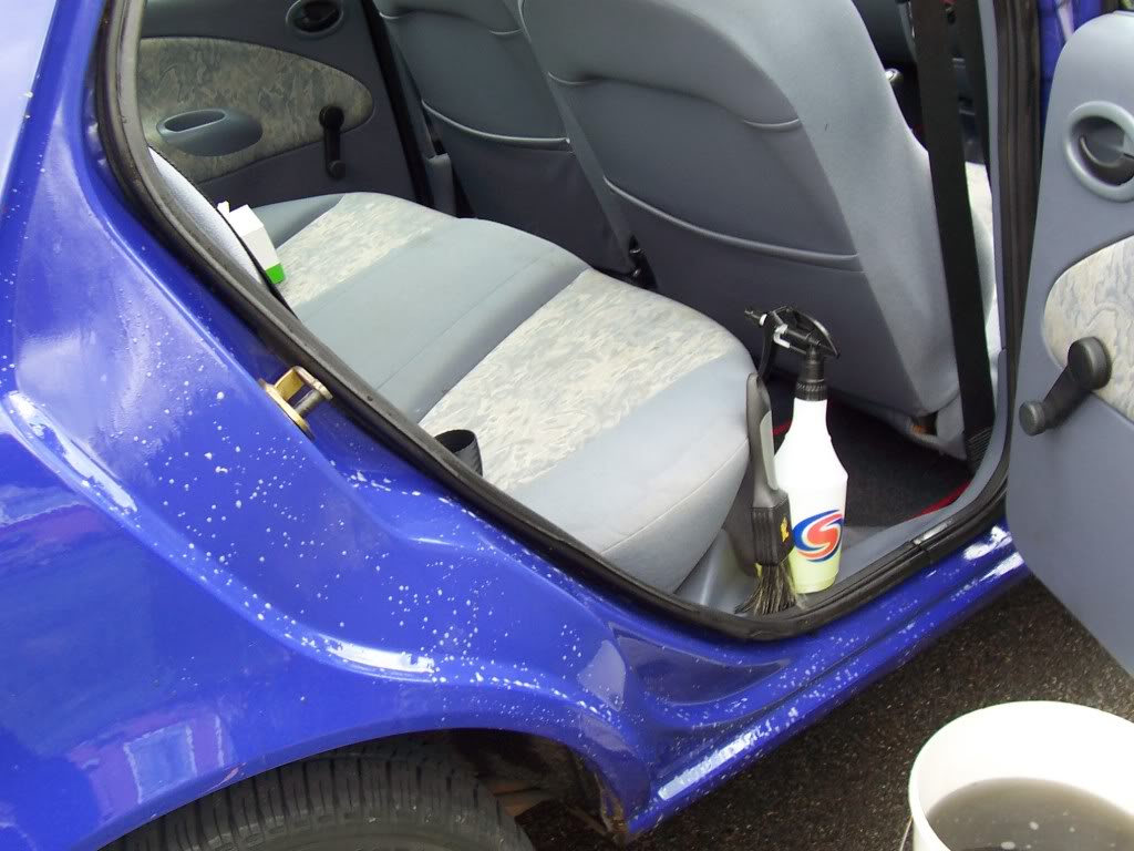

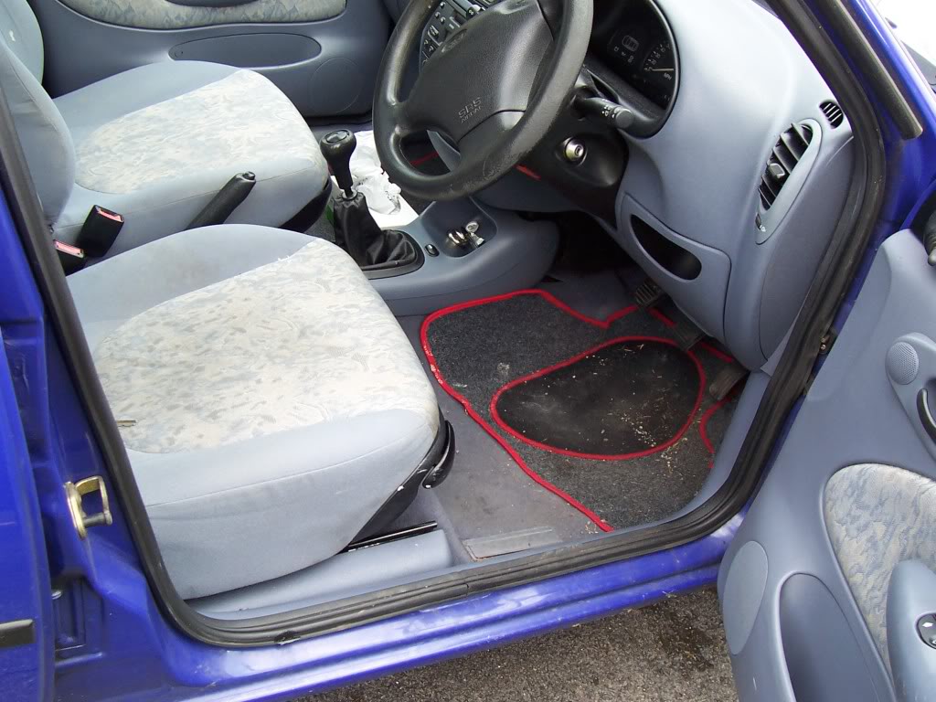

The interior was pretty bad too. Everything was dirty and grubby as the previous owner had hardly cleaned the car. Carpets, dash, mats, seats, and door sills were very dirty:

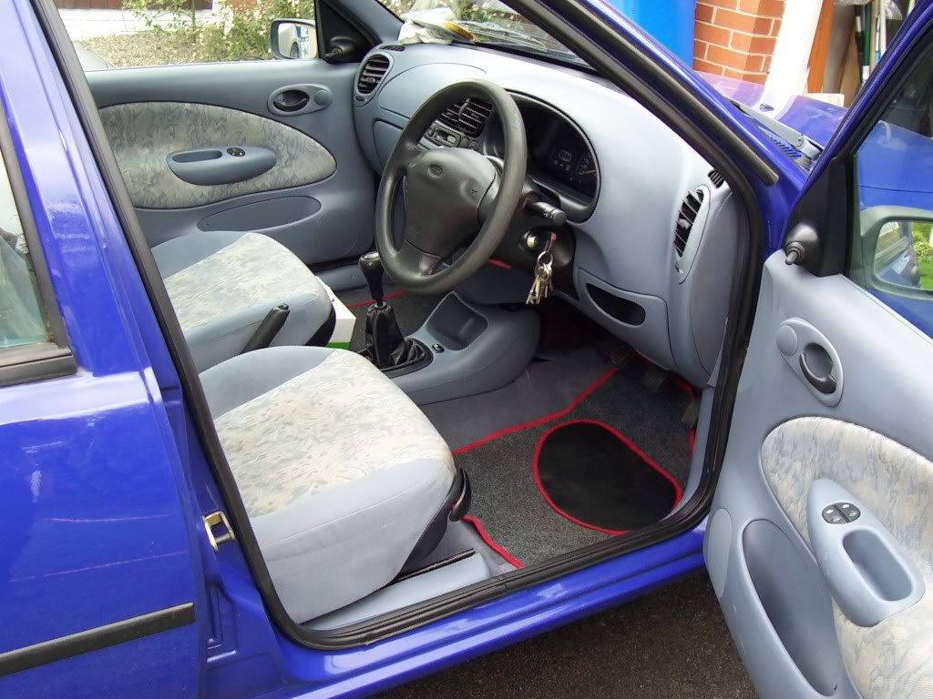

After aquick clean with G101 and AG interior shampoo and AG fast glass it tidied up nicely:

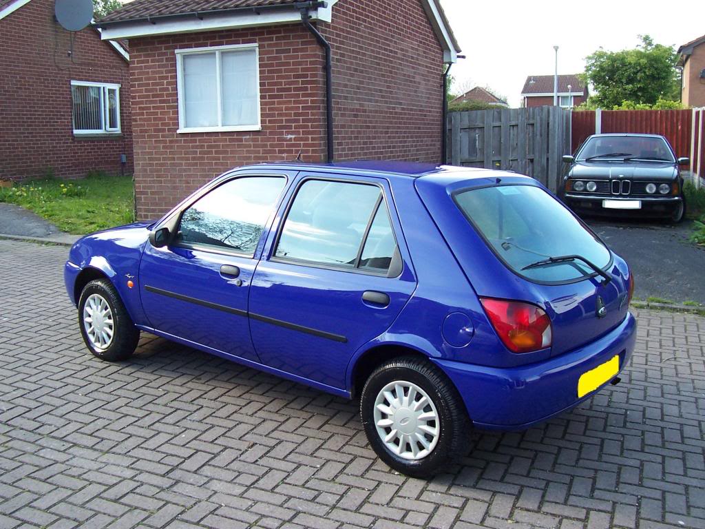

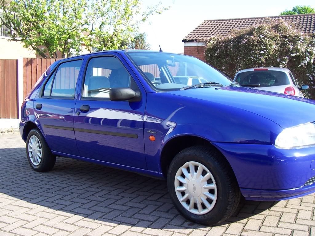

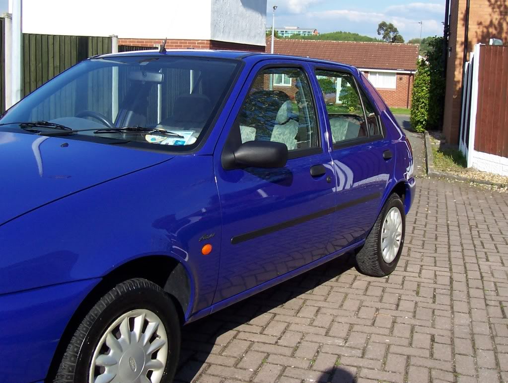

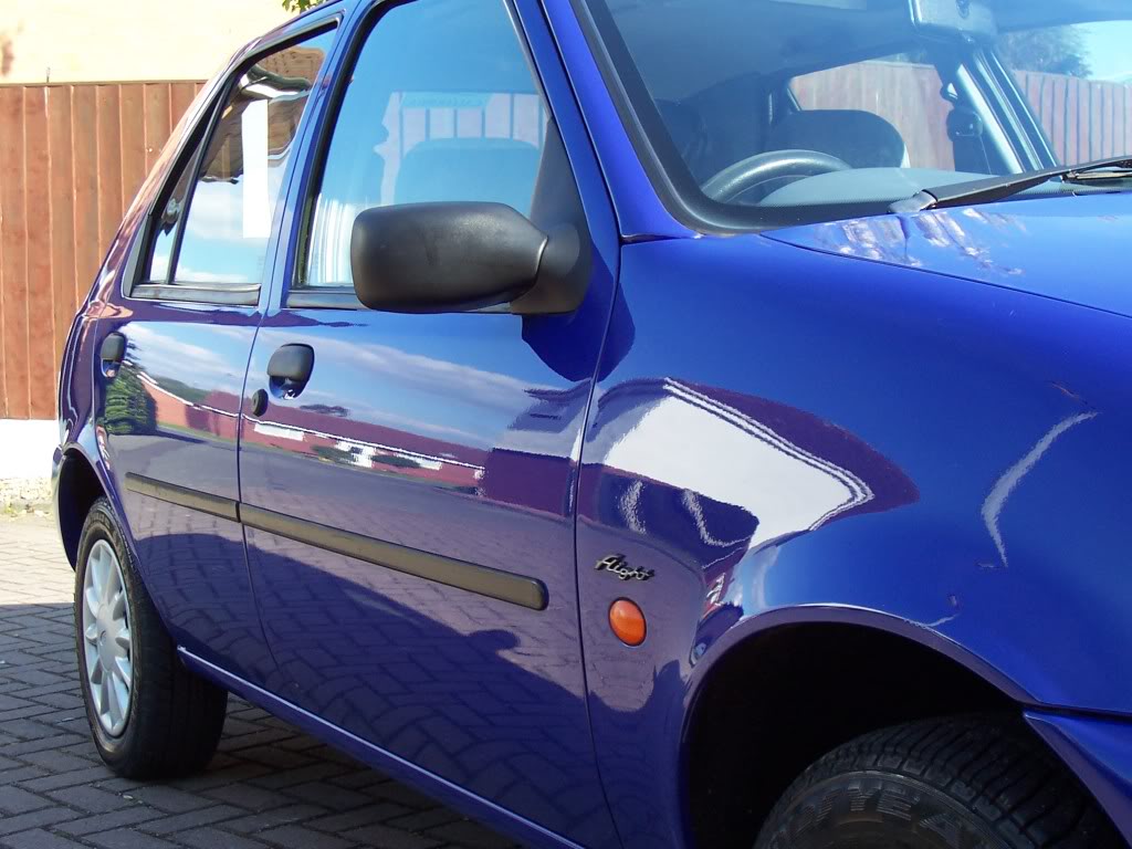

New owner was very happy :D

Cracking mate.
So how much did that cost her then?
one day detail minus the wax application to save on cost. She paid £150 which was nearly as much as she paid for the car. Engine is good on the old ford tho... previous owner 85 years old,full service history with ford, and 70k miles....not bad ;)
Good price that!

Jesus that paint was in a bad state! I thought the paint on Sarahs Fiesta (same as this but red) was bad but thats much worse!
Itwas bad m8. Loadsa swirls on every panel. Think it was washed at one point with a brillo pad haha :D
