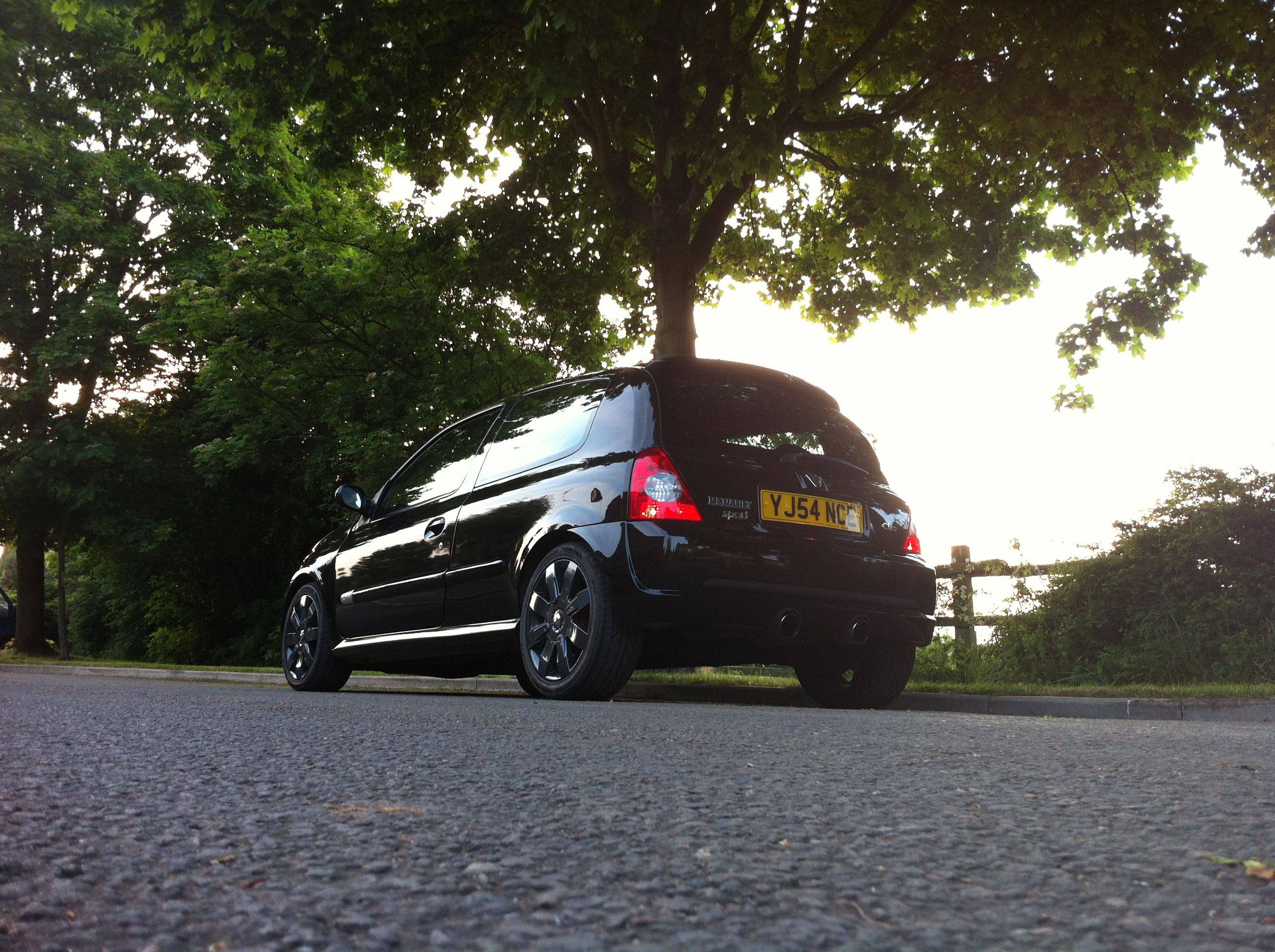

After hassling on here for peoples advice and opinions I've finally got my hands on a 182, I bought it from STRBramley off here on Saturday morning.
It was pretty dusty when I picked it up, so given it some TLC today

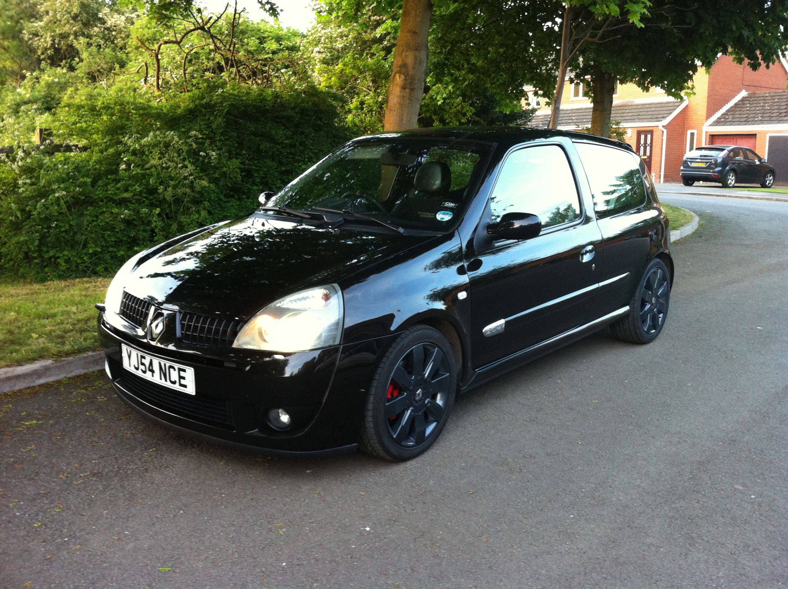

Very nice dude, IMO all you need to do is get fresh number plates, a 197 RS badge and washer blanks. Then would be top class man!
I'm planning on getting some new plates, as the garage that fitted the plates obviously cannot measure and so its currently buckled up on the back. What are the purpose of the washers for the headlights? I know the washers actually still work!
