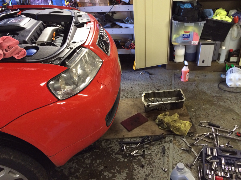

And then got a little silly, after catching the modding bug again after a recent trip to Scrooge's Unit where we fitted a new oil pickup pipe etc... so have ordered a few new bits like plugs, a vac pipe to simplify the PCV system that is known for leaks and... maybe these;
