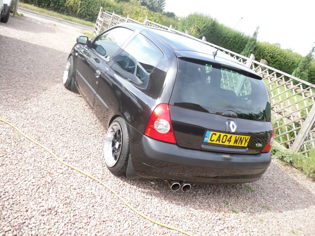

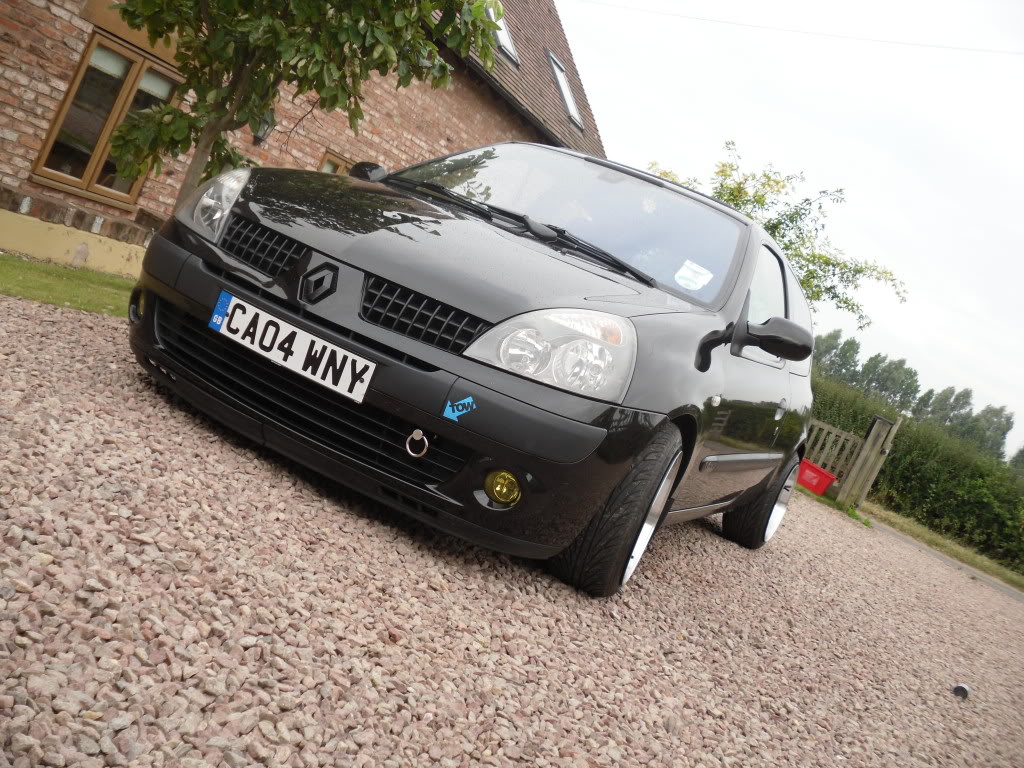

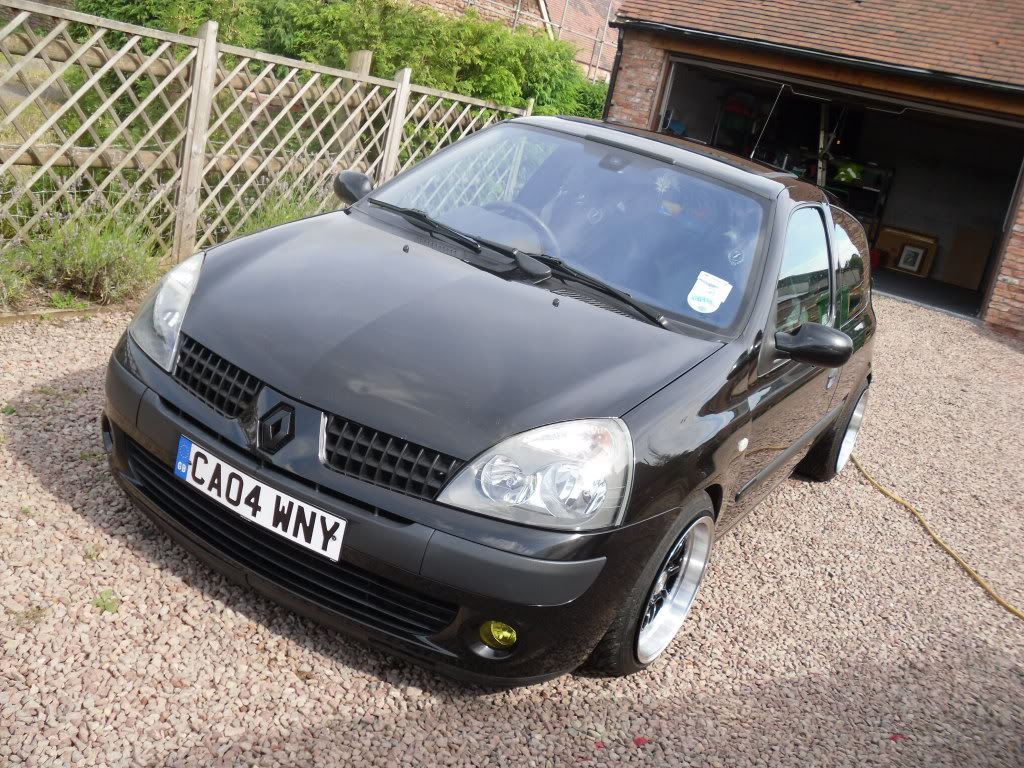

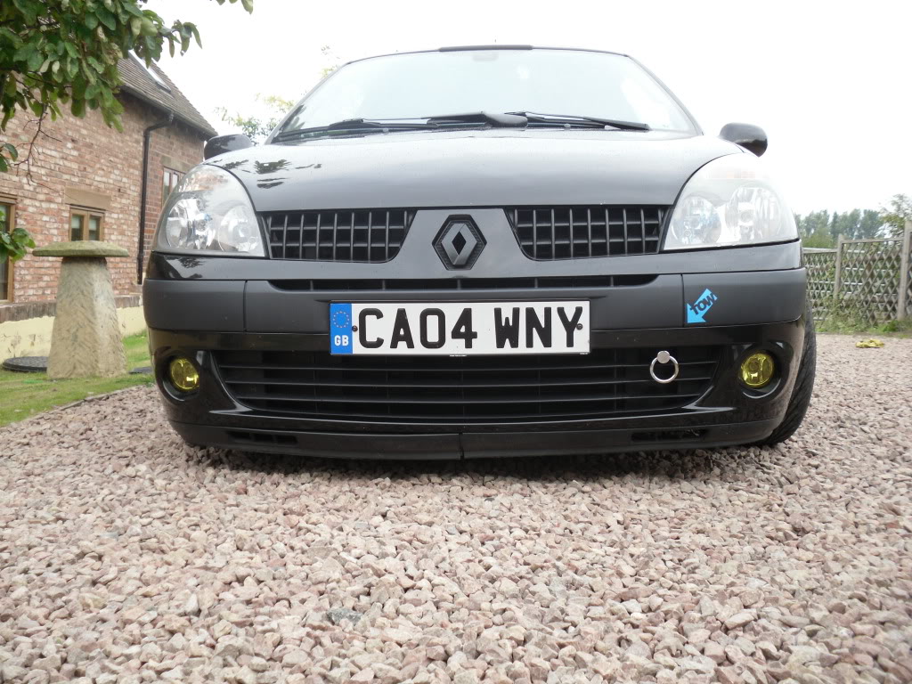

Finished Euro Clio ;)
  RS6 C7
Also whats the best coilovers for under £250? raceland are really cheap but i dont want s**t ones.. might do a trackday in it soon
BIFCAIDS
  340i M-Sport & 182
you need....
FK highsport coilovers £475 (last time i checked)
Remove ALL stickers inc tow ring.
I honestly wouldnt of bothered with the seats waste of time.
Do some measuring as your gonna have fun getting the stance perfect.
Find a local garage that can roll arches.
Remove mud flaps, they wont last long when your lower.
Just a start ;)

UPDATE.

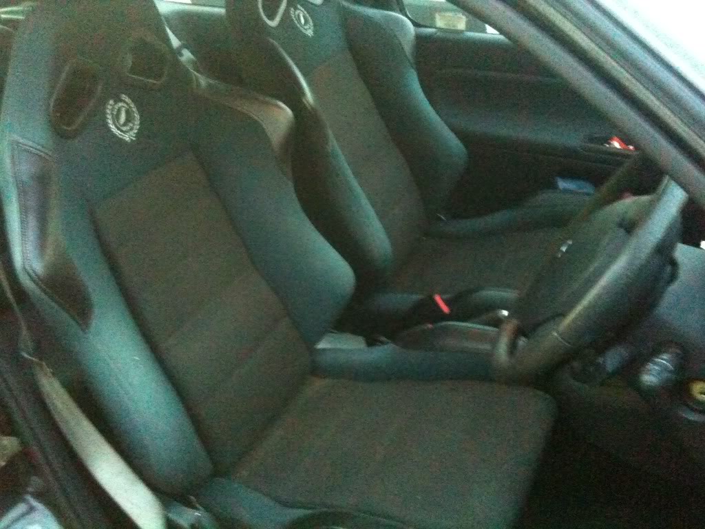

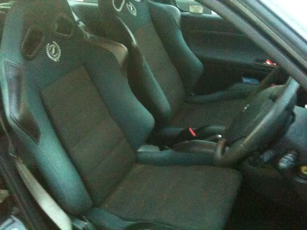

Got some FK highsport coilovers fitted today. Pick the car up tommorow from the garage. Its is sitting much lower :) He couldnt get the car off the ramps lol. Im tempted to keep it now and maybe wack a 172 lump in it at some point. Also fitted some corbeau buckets.
  1.2 16v clio

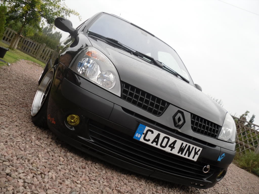

Couple of updates, fitted the RS grill (finally) and picked up a couple of corbeau buckets with clio subframes for £80! i didnt really want them but at that price i couldnt resist :p
I love your car wish i had the money for coilovers....let me know if your going to sell those seats =;)

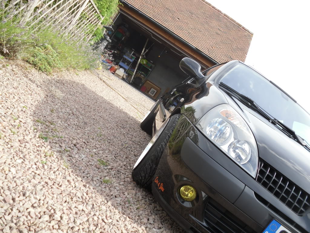

^ There not quite as low as you had them, about 3 turns away but if you saw where i live you would understand, I cannot get onto my driveway now so i had to leave my car at work in the unit lol, Ive got to build up the driveway with stones.., Also as i live down a single track lane i may have an issue if i meet someone coming the other way as i wont be able to go on the grass haha. All part of been low and im loving it!

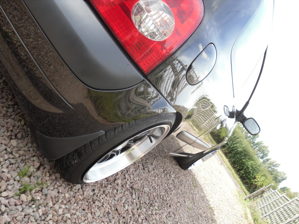

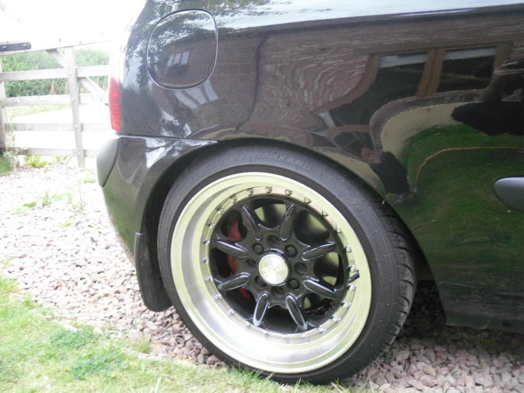

where do you get alloys with that kinda lip in a 15 or are they bigger? plus if you knew the width of the alloy eg.7j , 7.5j, 8j, dont suppose you could reply/PM i really am looking for that exact amount of poke and i have the same clio just silver
  RS6 C7
Rolled myself, Just heated the paint him a hair dryer, Then tapped it round with a hammer and a block of wood, Didnt get any cracking on the paint but sealed them after to make sure, 8j is 8inch i think

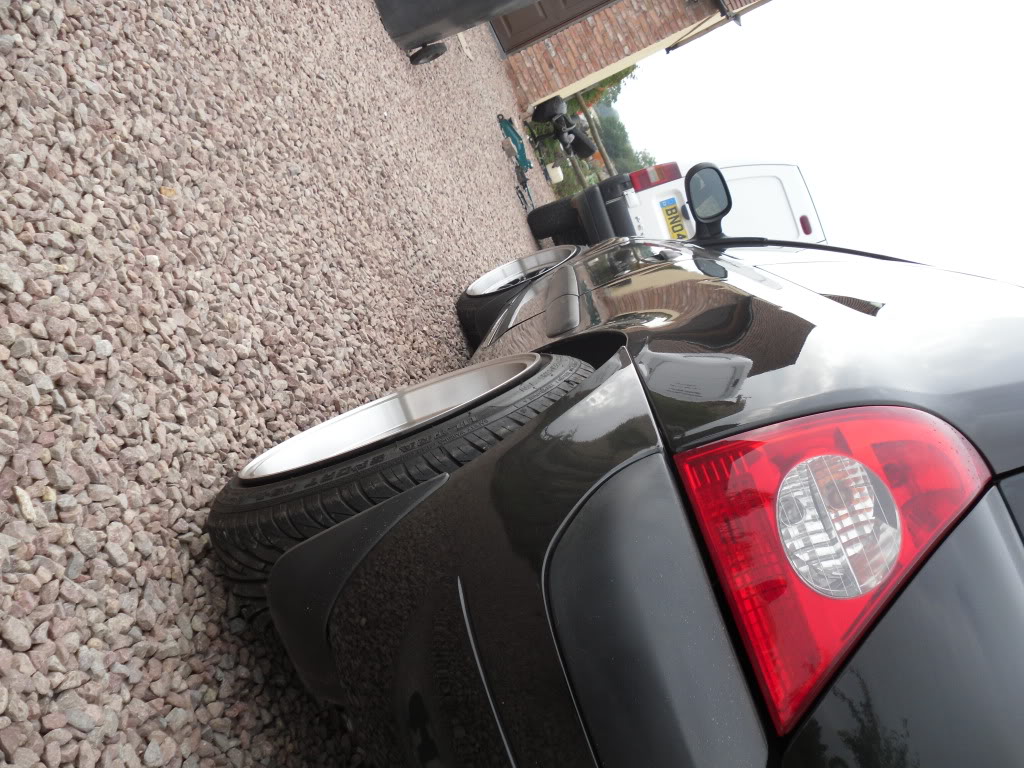

Cheeky preview ;) This was right after it came off the ramps, i had the rear adjusters removed to get it lower. Piks up the weekend once they have settled and i have cleaned it :)
  Audi A4 1.8T Sport
still not low enough for euro, can still see the tops of the tyres ffs.
arch rolling is done best with a arch roller. guides online on how to make one, but basically, make a plate which bolts on to the hud same as a wheel does, weld a scissor jack to that, other end of jack has skateboard wheel (this is the 'roller').
Attach to car and extend jack to touch arches with wheel, roll, extend and repeat.
  Fiesta ST-3
take adjusters out on back, and wind the fronts down then take some half decent pictures man! Those hurt my neck haha. Looks good though man
