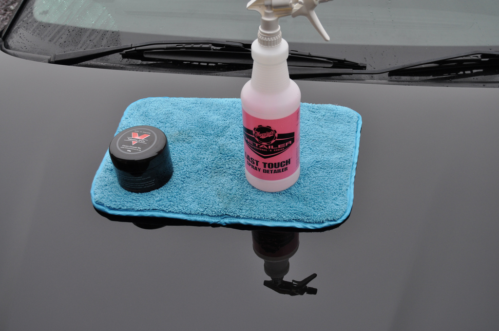

A few photos after using :
Menzerna P085 3.02 on a Orange polishing pad
Menzerna Final Finish on a Yellow finishing pad
Megs Last Touch
Collonite 476 applied by hand
Valentines Concours applied by hand

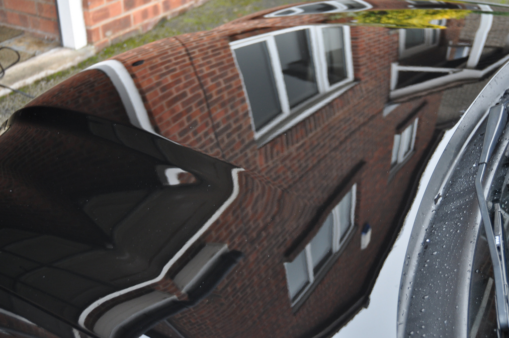

(Note only the bonnet has been done)
ABout 50 - 60% correction I'd say, not bad but could be better.

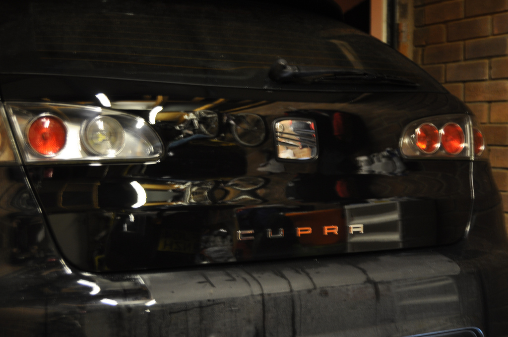

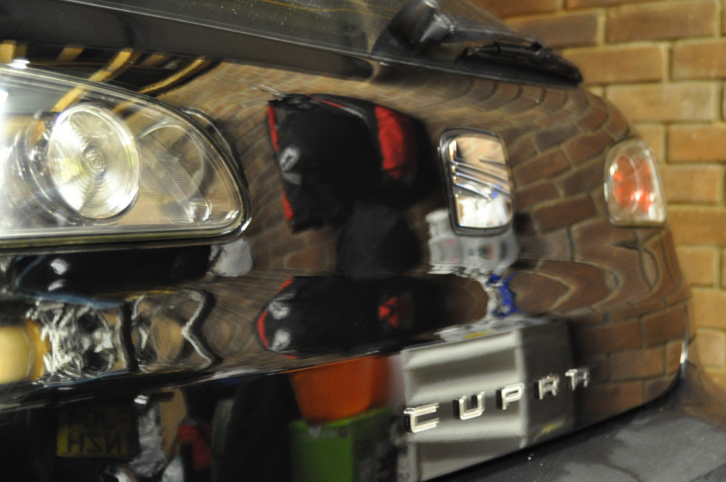

Another day, another panel.
Today I sorted the front wings and drivers side door.
Also i'm just using finishing polish and finishing pads now, and still seem to be acheiving a good level of correction :) :
Finally getting somewhere.
