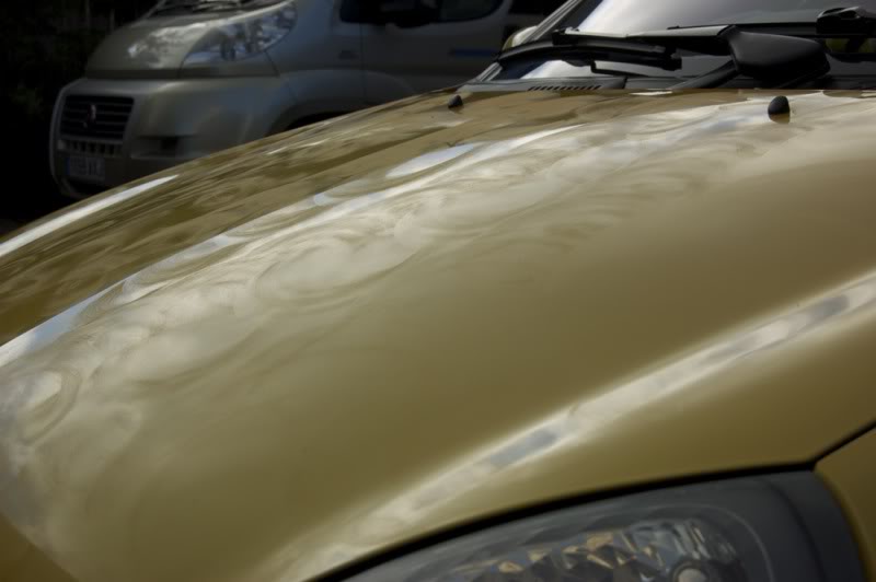

A few befores, the car hadn't been cleaned for a while
It appears the local birds like yellow

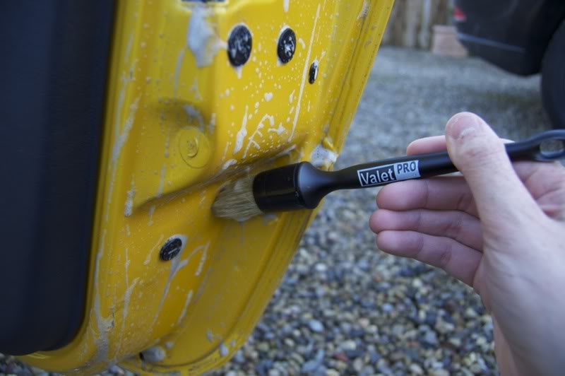

nooks and crannies were aggitated and foam was left to soak and drip off for around 10 mins then rinsed

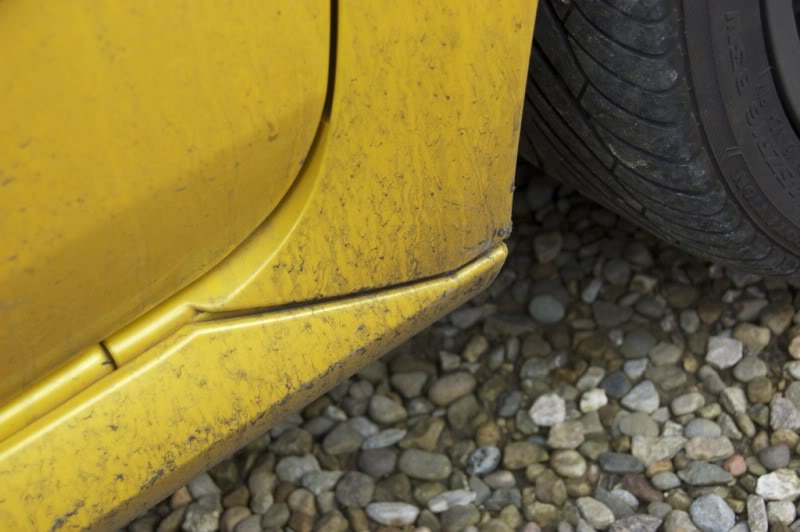

Next came the clay. I don't know a fat lot about this, but from what I've read on here the i4d lime clay seemed to be good enough for the novice, so that was today's choice. Lube used was Dodo's Born Slippy. I will now illustrate this by taking a picture

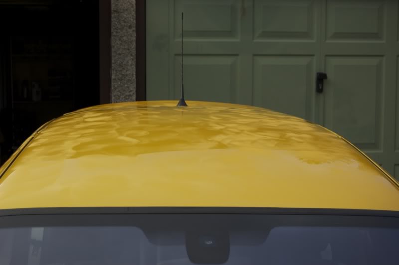

Roof wasn't too bad

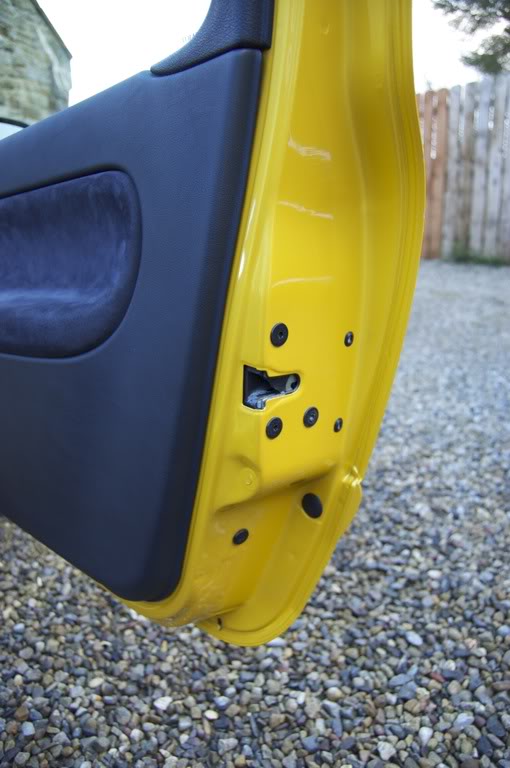

Drivers door bottoms we're quite contaminated as I expected

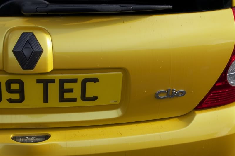

But by far the worst part was the boot

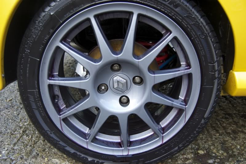

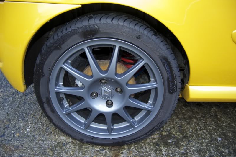

Next to tackle was the wheels. They are trophy turini's, originally from No. 007. They do need a refurb ideally, but I thought I'd see what I could do with them.
Valet Pro Bilberry was used (4:1), along with the silverline wheel/alloy brush (cheapskate I know, I didn't buy the EZ detail)
Bilberry was left to dwell for a minute, aggitated with brush then rinsed...really impressed.

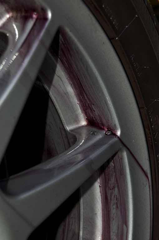

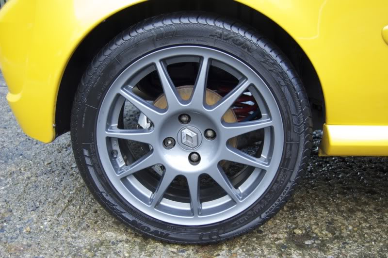

Decided to Iron-X the wheels, and so glad I did... jesus!!!!
Boom, couldn't believe how much crap came off

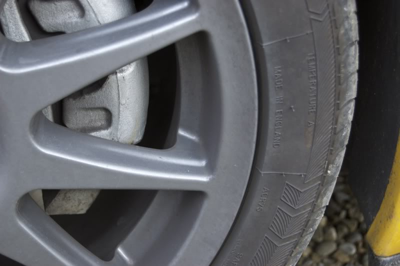

Next was tyres
From
Using (How nice does this smell?!?!?!)
To

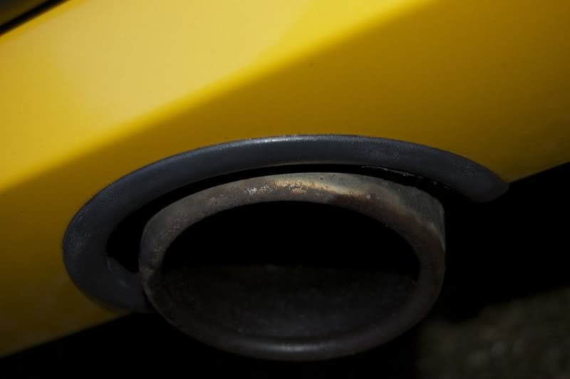

Exhaust was given a going over with wire wool and autosol but frankly I got bored so it's not a great result haha

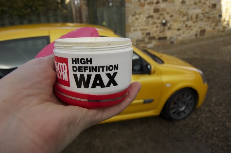

And finally the car was waxed using AG HD Wax and the supplied applicators and cloth
Left to cure for 10-15 mins

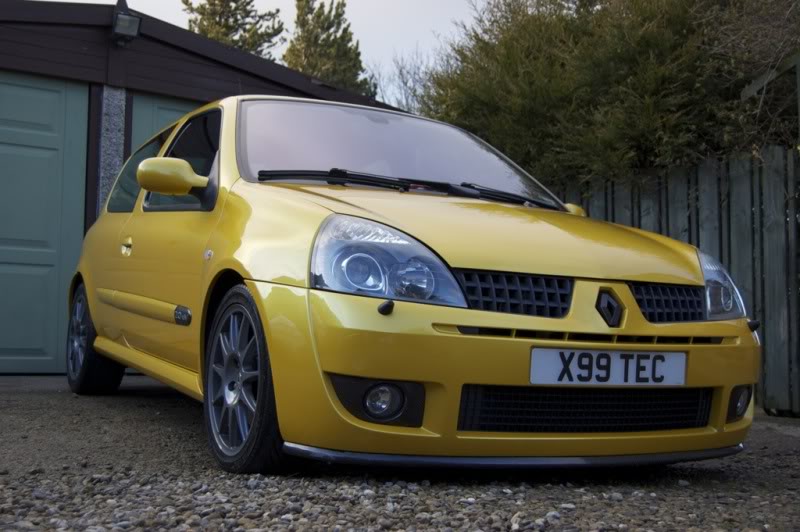

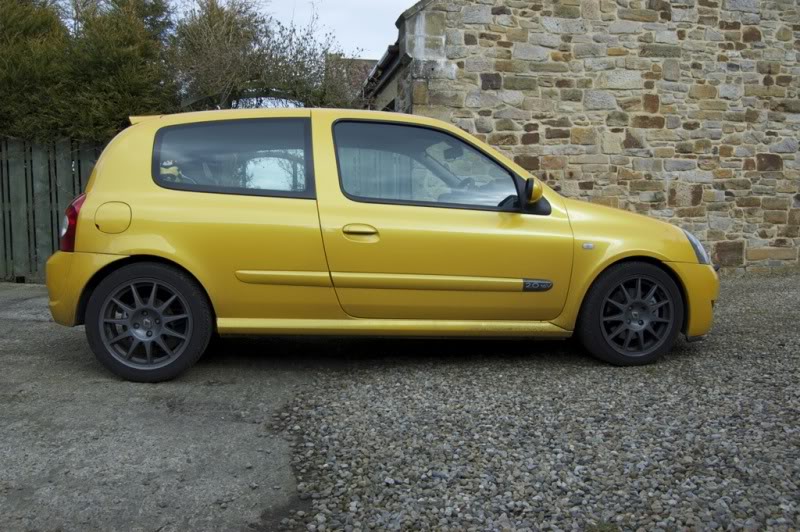

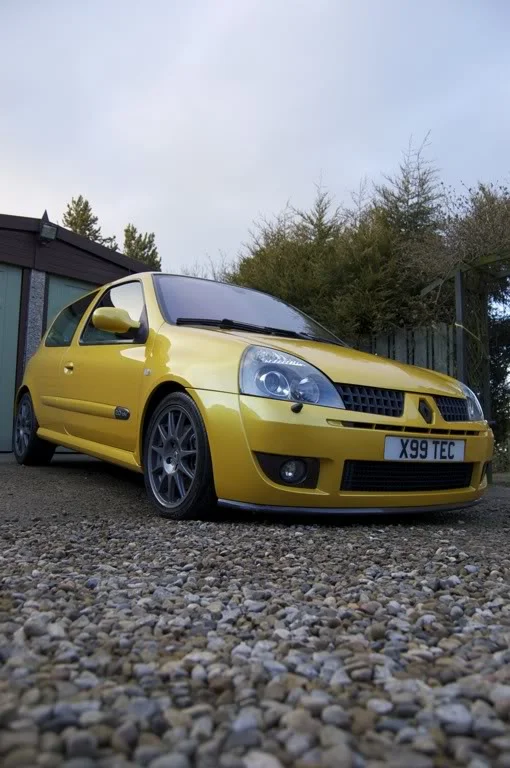

Finally a few afters:
Sorry for all the pictures, I got a bit carried away. I'm happy with the results, and always open to what I can do better next time :)

Just a few things... In the future... Tar remover (Tardis) - Iron X - clay. Also maybe look into something like Prima Amigo next time instead of SRP. SRP is a very good product but it's very old school. The likes of AF rejuvenate is a more modern bettered version. And Amigo is a very good glaze that should be used before the wax.
When waxing do a panel or 2 at a time. It'll be a lot easier to remove. 5 minutes cure time is reet. Nice job.

If I may add, next time, try using a damp applicator to apply the wax and use what seems like far too little product. You'll be surprised how far it spreads and how much easier it is to remove.
