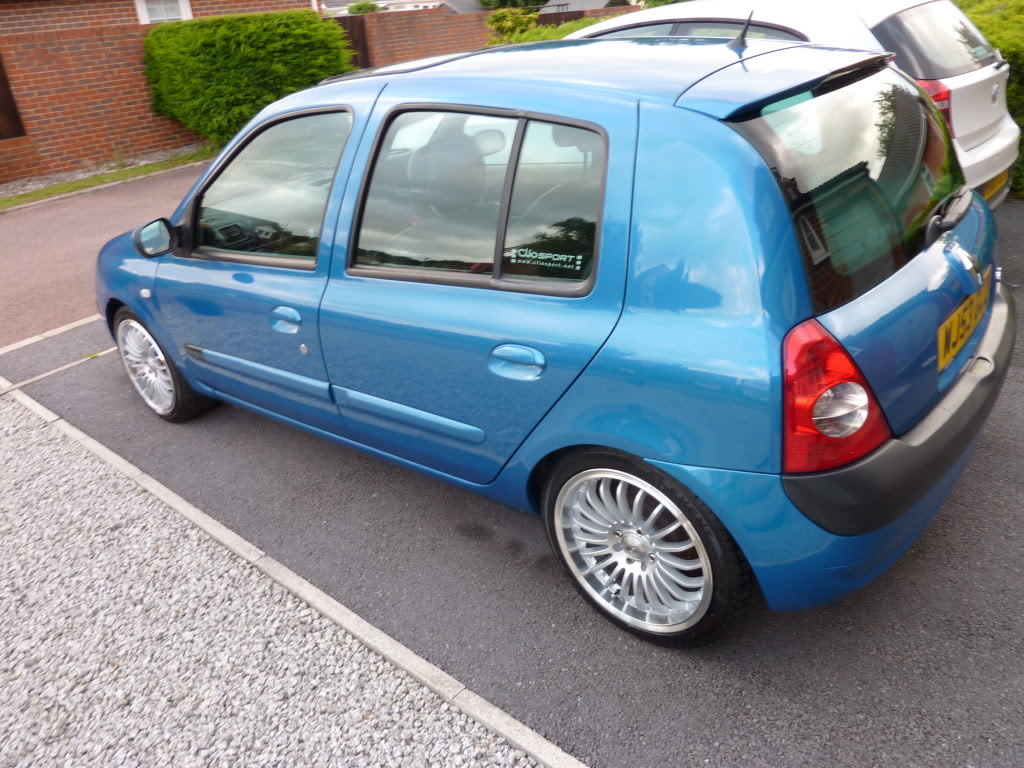

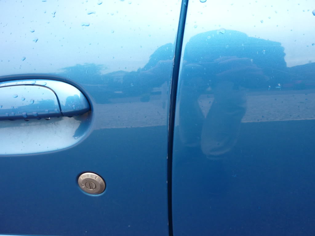

Strange order to do things in but ill summarise first... WOW, what a piece of kit, the results i got today have blown me away! but ill let the photos do the explaining!
the method
.rinse and go over intricate areas with a detailing brush
.wash with AG shampoo
.ValetPRO tar remover
.Iron X
.Dodo juice medium clay with born sloppy lube
.dry with Dodo juice towel
.polish certain areas with menzerna power finish (2500)
.glaze with Prima Amigo
.wax with DoDo juice diamond white hard wax
.trims with Back to Black (rubbish product need some AF Revive!)
.tyres with AG tyre dressing
.glass with AG glass polish
OH and the DA I was using was Meguiar’s G220v2
the actual wheels were cleaned the day before to save time!

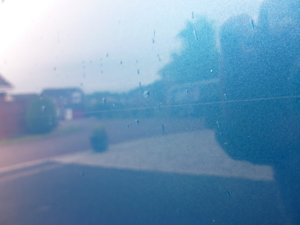

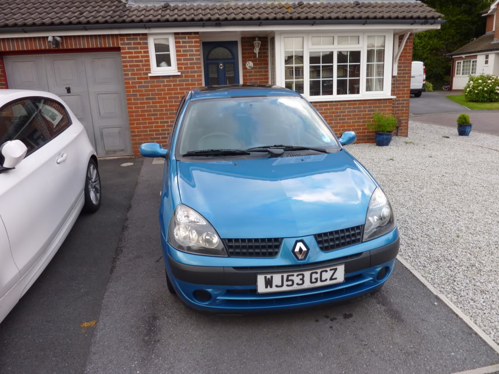

well some before photos...

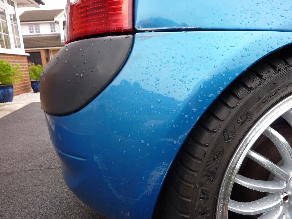

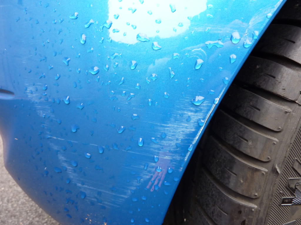

as some people know my car used to be a driving instructors car so it was COVERED in very deep scratches from hedges, walls, etc the arches being the worst.

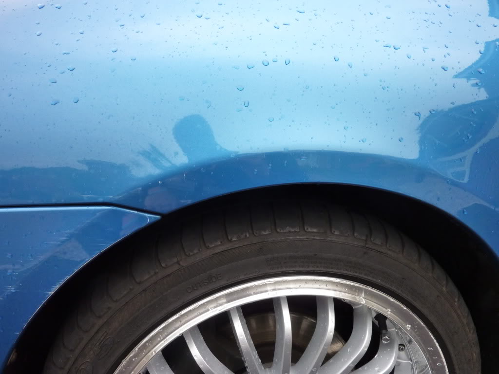

Now these next few photos show the worst arch of all that i thought the DA wouldn't even touch!...

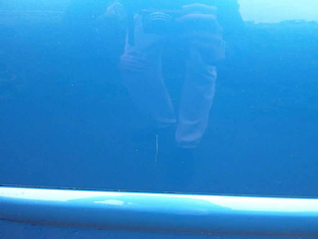

prior to polishing..

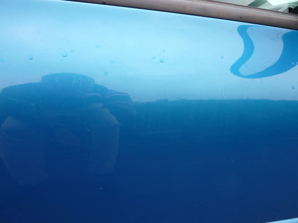

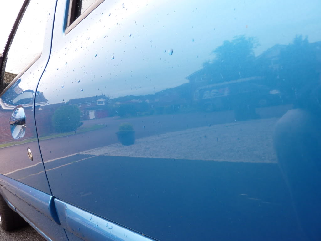

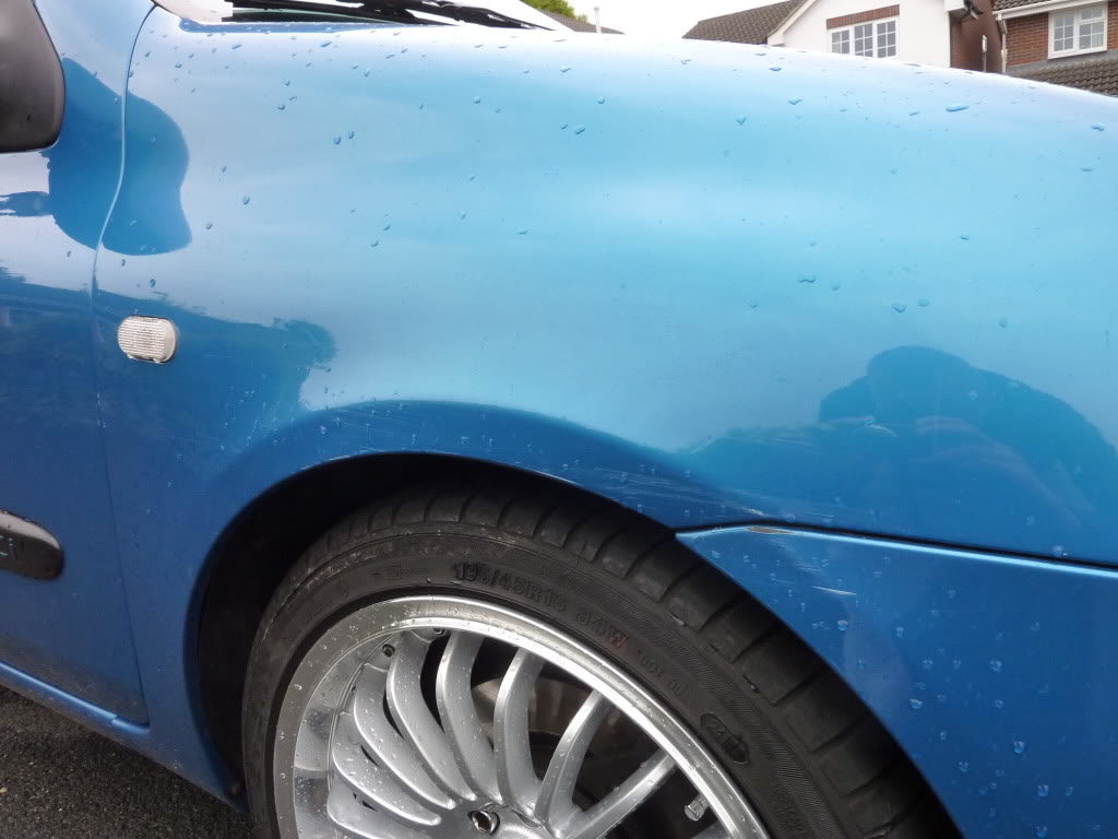

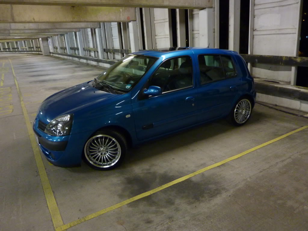

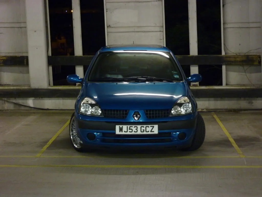

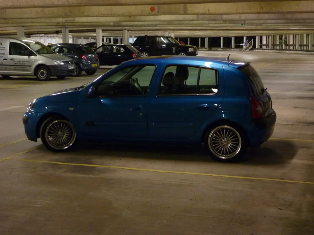

and well the results, first of that one arch then lots more snaps!
those scratches has severely disappeared, and since it was the first time i've ever used a machine i think i did quite well?

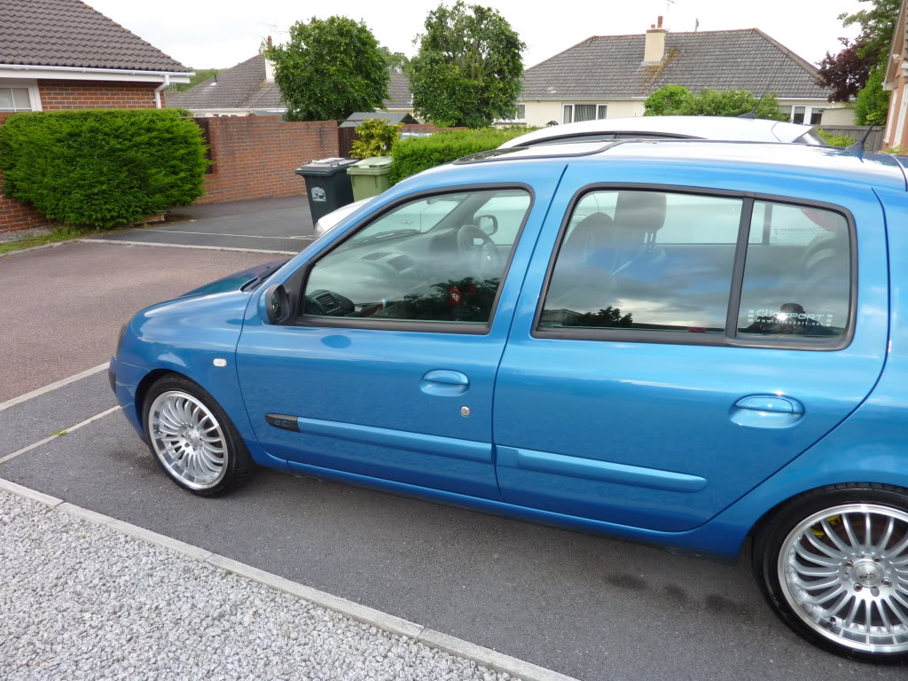

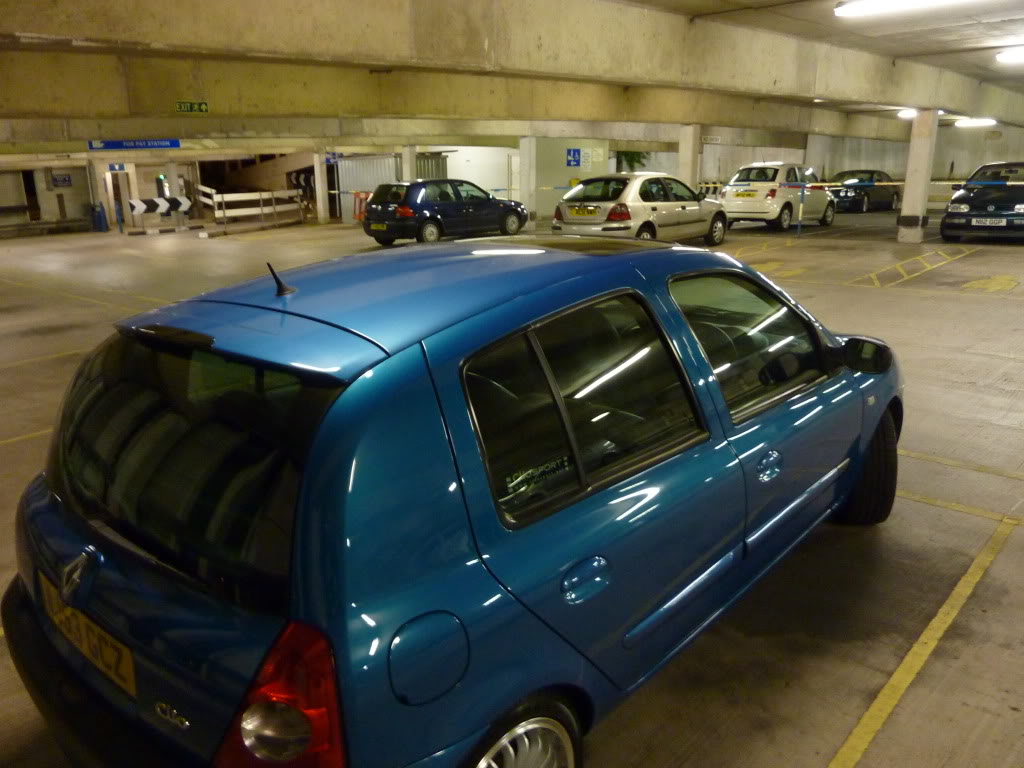

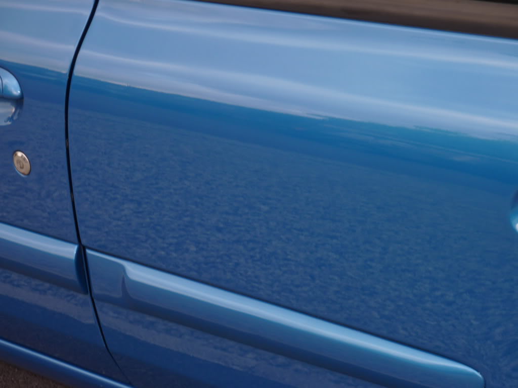

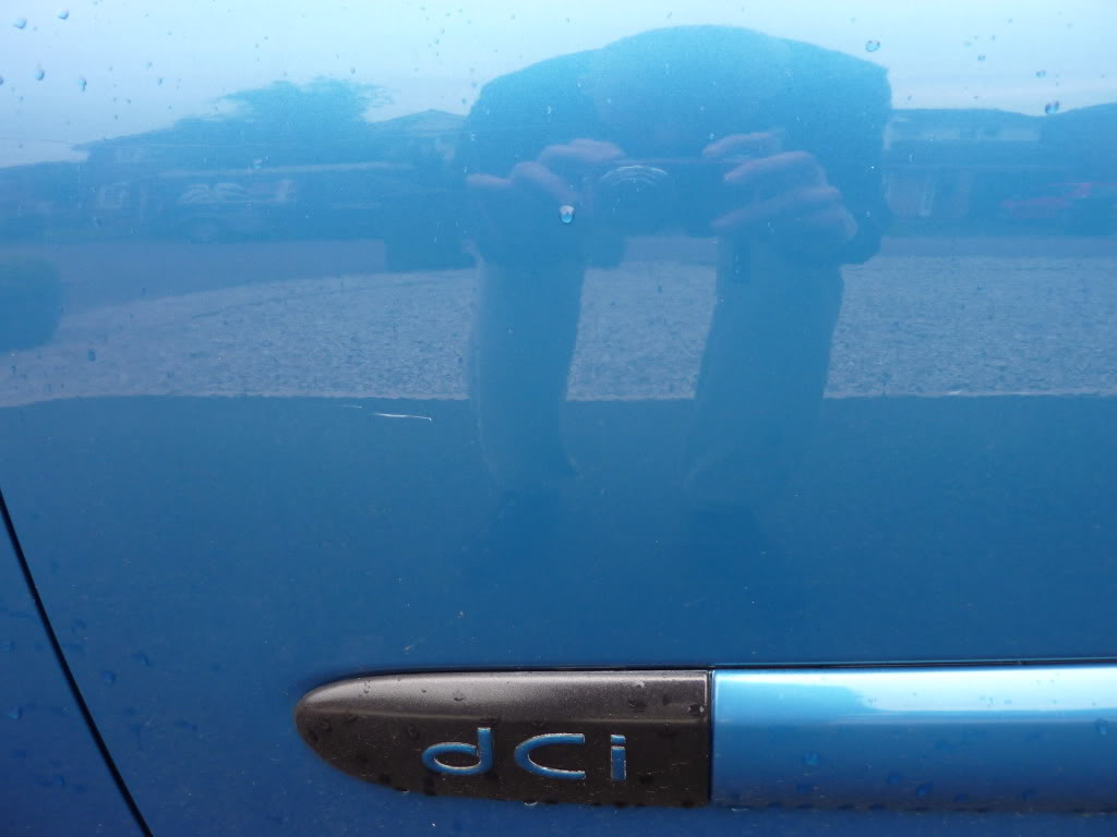

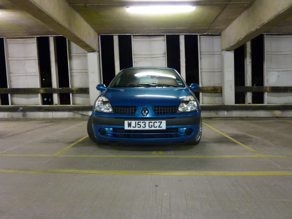

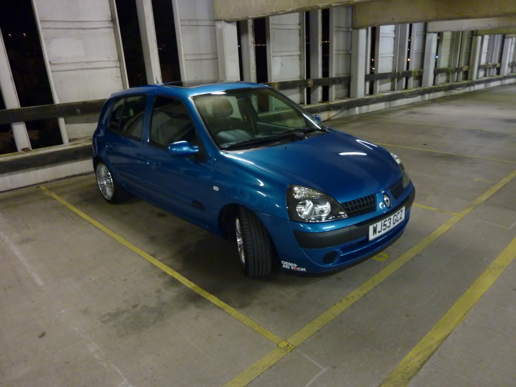

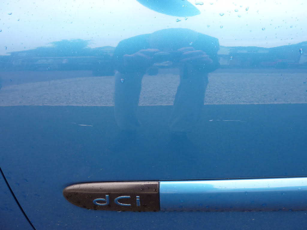

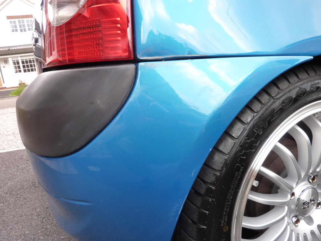

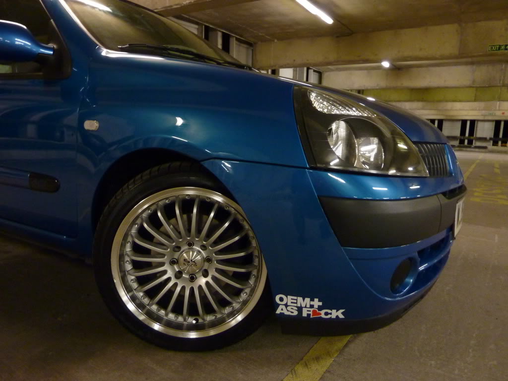

anyway more photos..... there are quite a few!
Thank you for looking C&C welcome, and if anyone has any advice to give me about changing my method or products please to say so as I'm all ears as i want to learn!

Nice work but i also think your wheels look 'cheap'... and not OEM.
  Clio 1.5 dci
Not OEM I know, but in my eyes there are other things that are more influential to the cars look to be changed first, but at some stage they will defiantly be changed!
  Clio 1.5 dci
i'll take that half compliment as i know they arnt to taste but i can't complain got them for free brand new! with new rubber too! :D
