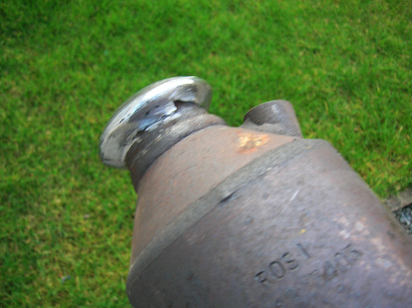

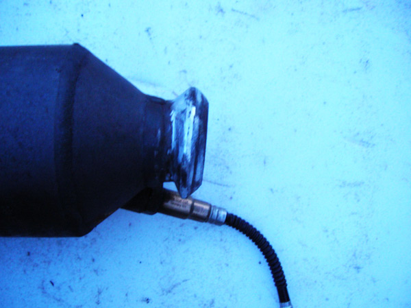

One CAT:

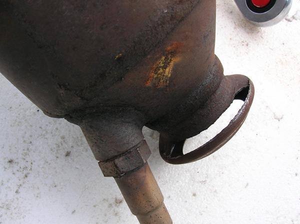

One huge gaping hole:
Delighted...
I haven't managed to find anywhere that sells the right type of flange on the internet, was hoping there was the off chance that I'd be able to cut the old one off and have a new one welded on. Flat faced flanges are obviously a lot more common but might be a pain to retrofit.
New cat from Renault is £916.50 so that's out the window without even a seconds hesitation. Sports cat from K-Tec Racing is £281 which would be a bit of a stretch. De-cat pipes are between £50-100 but I've got an MOT to think about in April and don't much fancy the second lambda triggering the emissions light on the dashboard. I guess I could have an exhaust place get creative with some flat flanges and their welding gear?
Something had to break! I guess the engine mounts may be to blame as they do feel like they are letting the engine rock a little.

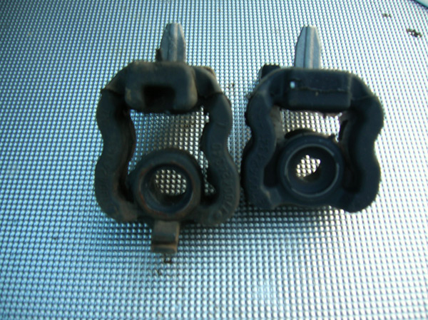

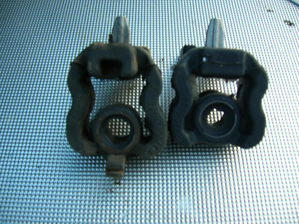

This happened due to the center section hanger rubber being very worn, this was causing the exhaust to cat clamp to dig in to the cat.
On replacing the hanger i found the rubber was approx 3/4 inch longer than the new one, at the cat this translated to the exaust hanging about 2inch lower than the cat. Also replaced the clamp.

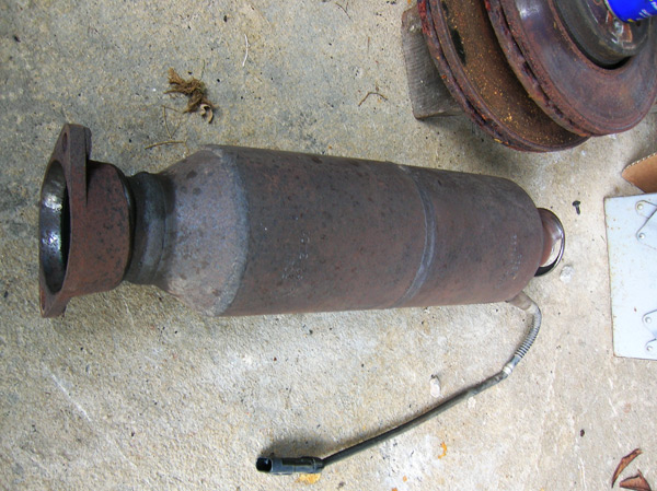

Cat came back all welded up nice!
Bought a new centre exhaust hanger and the old one was indeed stretched.
Fitted the new hanger and tried to get the cat back on. It was at this point that I realised the cat is actually bent! It would not mate up to the centre section of the exhaust as there was a 5mm+ gap between the two sections. Should have really spotted it earlier but as well as cracking the metal it has also deformed the flange quite considerably!
Going to refit the old exhaust hanger, bolt the cat back in and then have the car MOT'd. I'm then going to buy a decat, job done!
