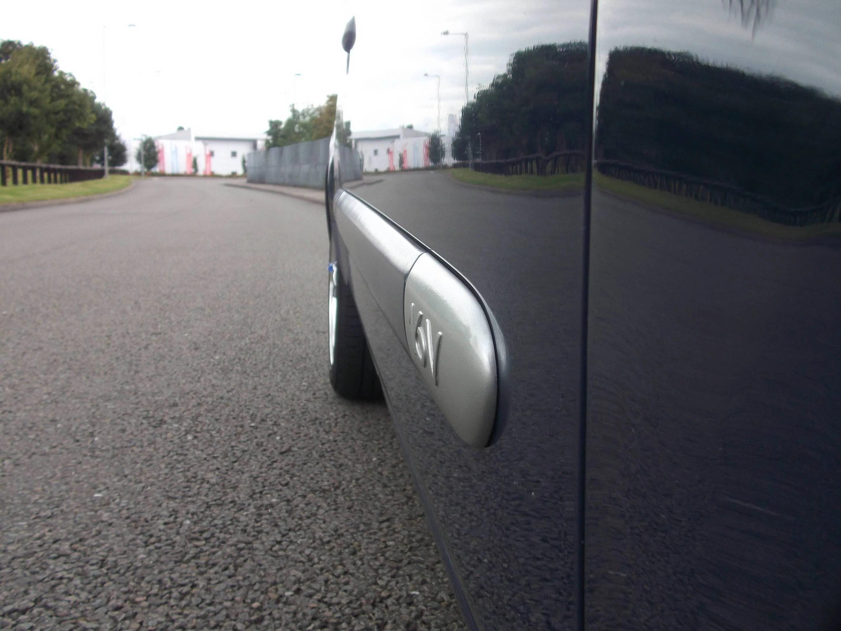

Bit fiddly, some of the letters didnt transfer etc, and im fairly sure im missing the dot above the i :cool:

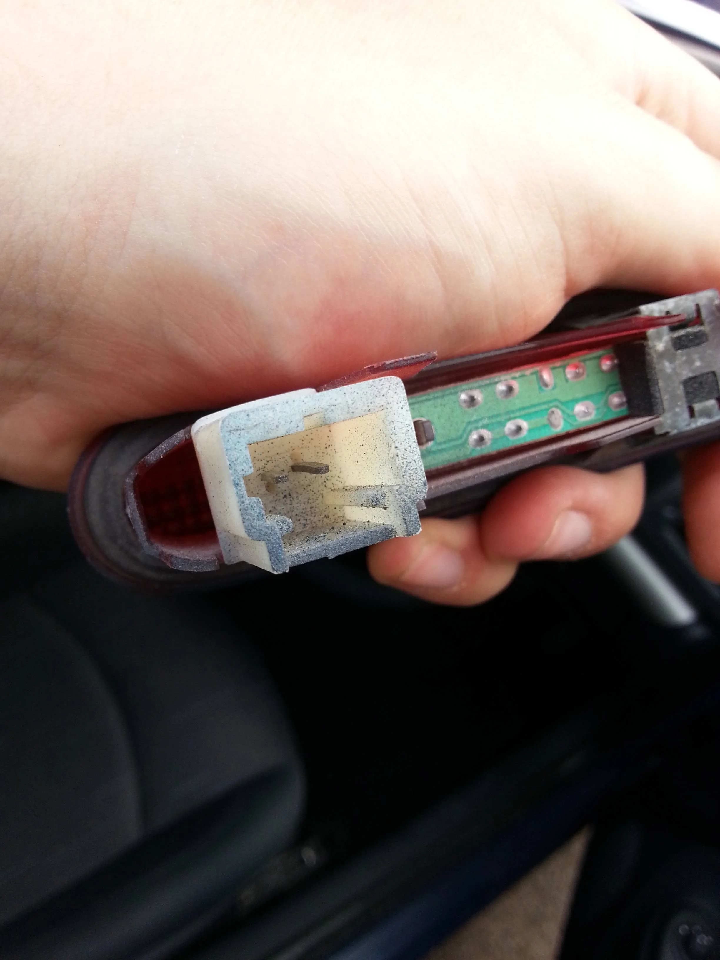

Anyway from one problem to another, i need a plug...
The plug in mine currently is round (same as the number plate light) soooo. Anyone got one lying around? ;) Im gonna take it into work tomorrow and see if theres a way of maybe soldering the cables on, or maybe some teenie tiny shovel crimps...
i just cut the plugs off the spoiler etc, and crimped on butt connectors. MUCH easier for fitting. though isnt that jsut the plug for the brakelight into spoiler? I thought they were all the same.
150 quid to post?! Mine was 30 quid to post!!! Who are you sending it by and does it come shipped in gold leaf? ;)
Well thats the brakelight itself, the plug on the cable coming from the car is different so i might have to do abit of modding, if i cant track one down.
haha over reaction dw ;) would be difficult making sure it gets there in one piece though...

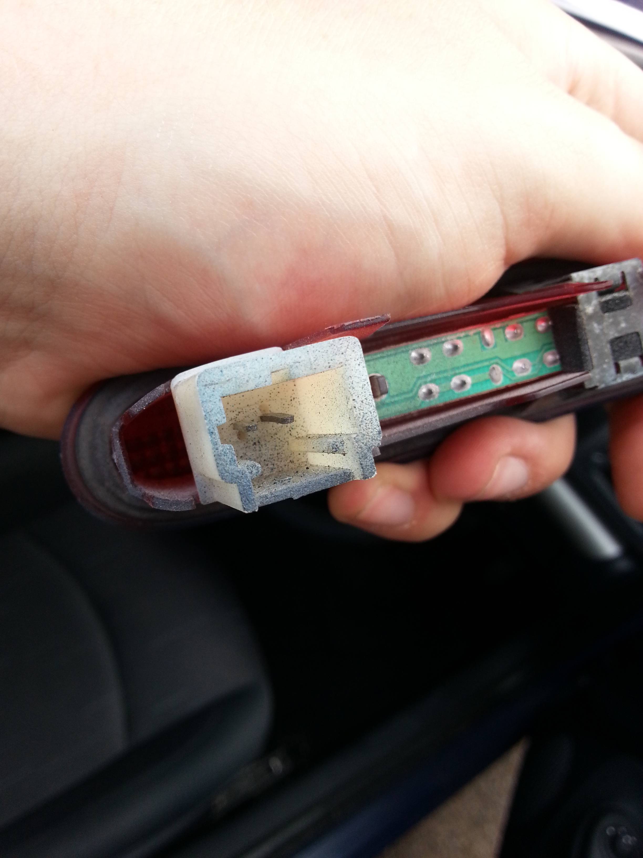

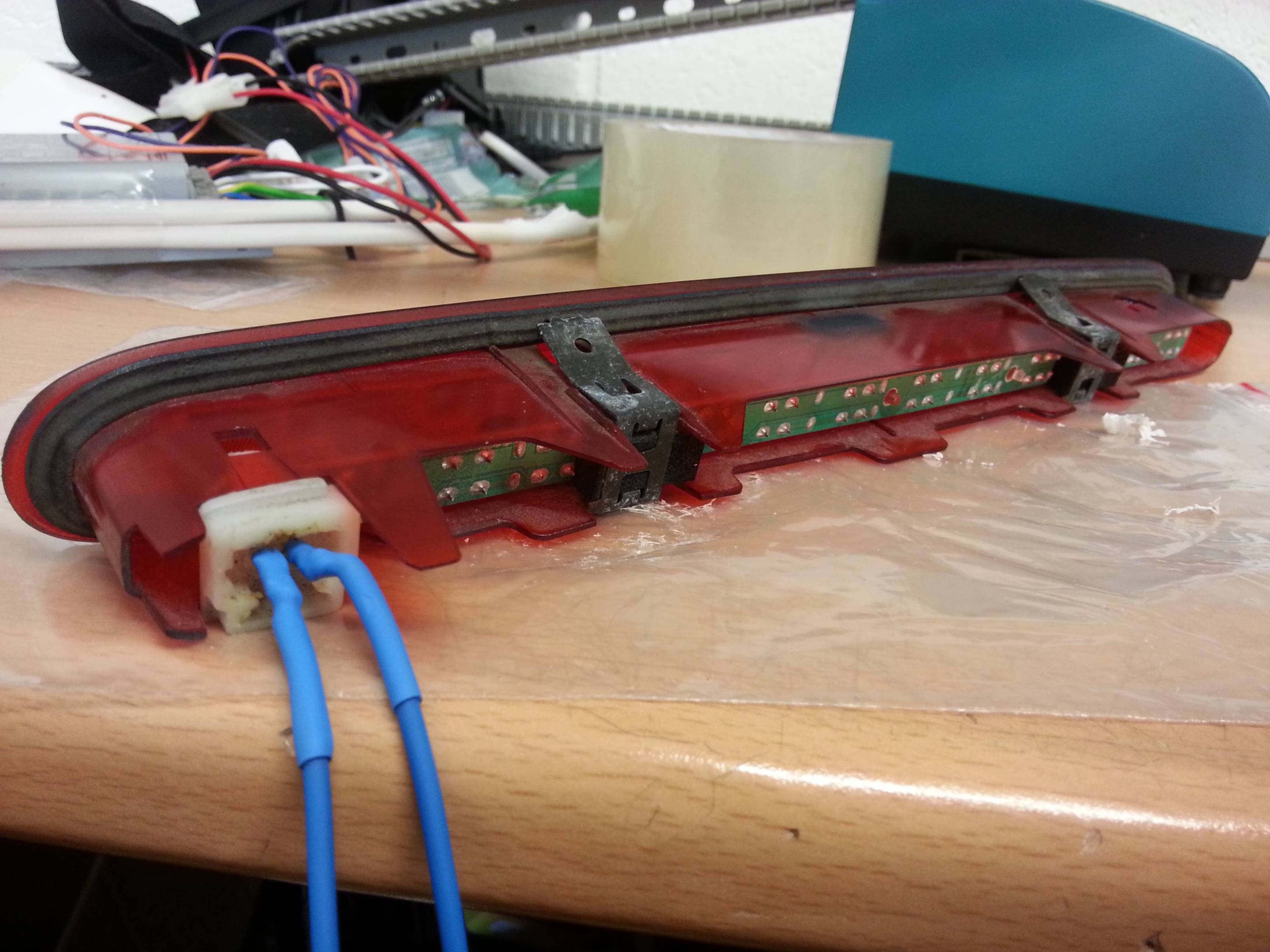

Had a free morning at work so i decided to use the workshop to my advantage and get this cup spoiler fitted!

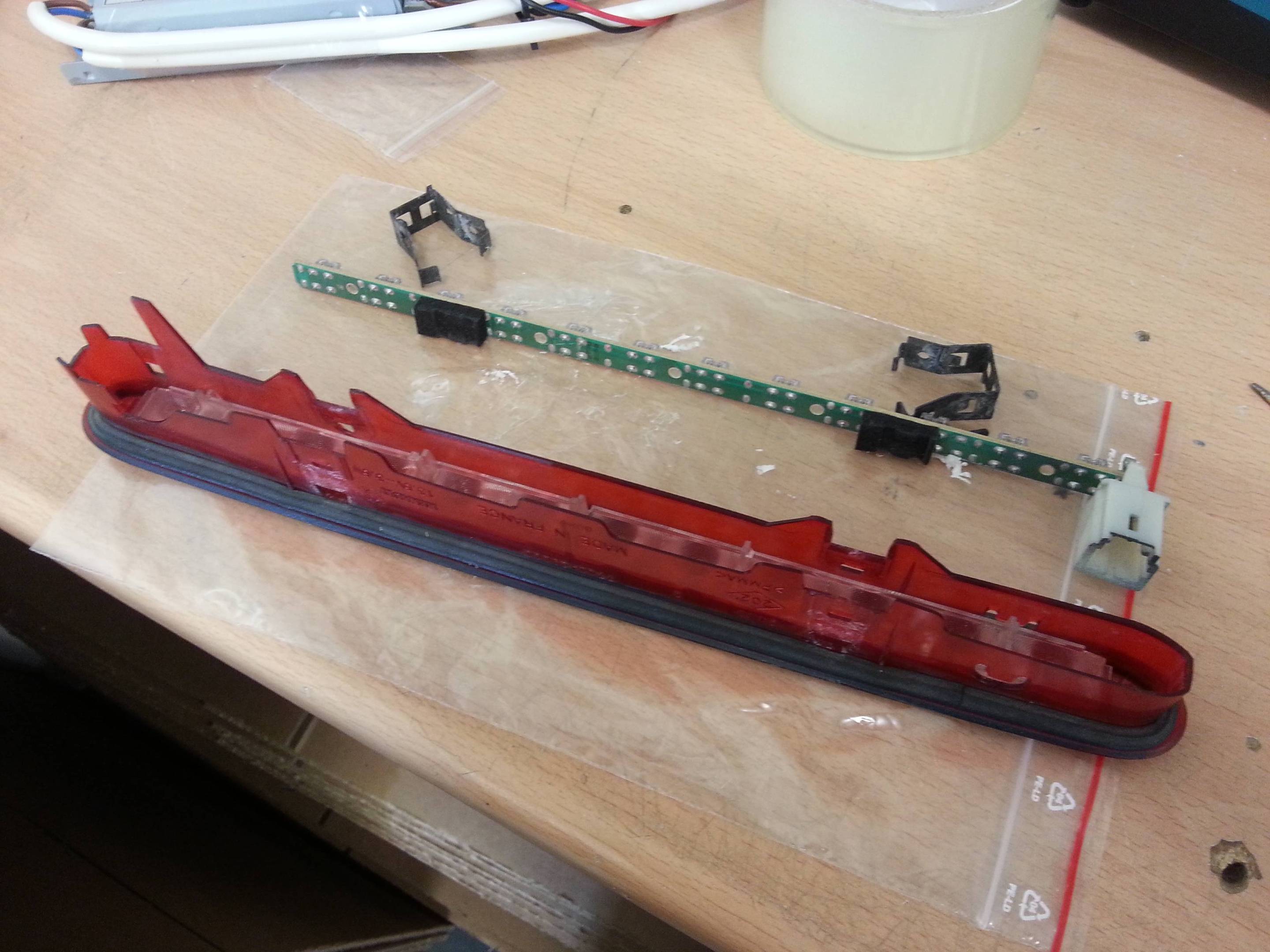

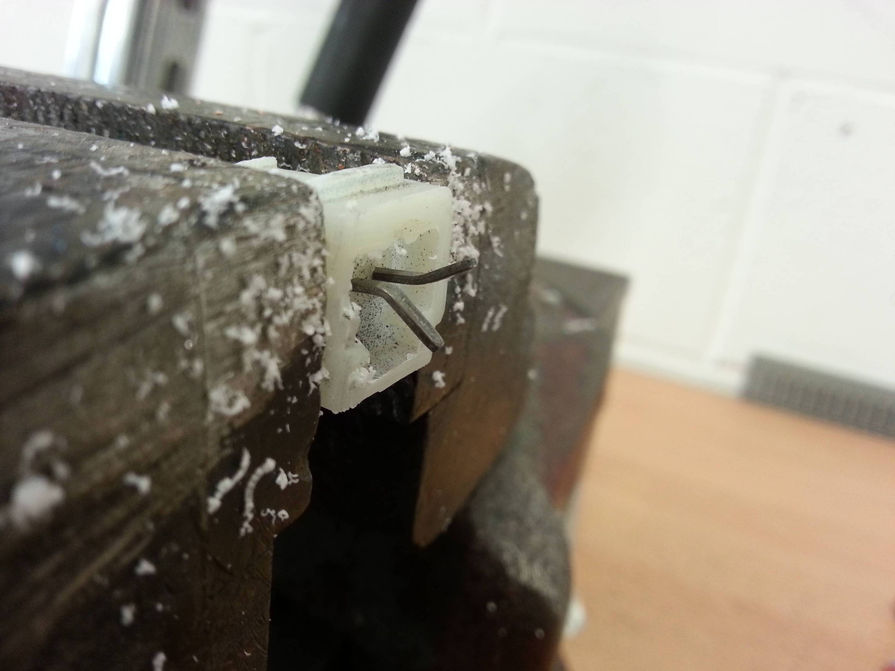

First things first, needed to solve the mis-matched plug issue on the brake light. Nothing a soldering iron could fix though! So i went ahead and stripped it down:

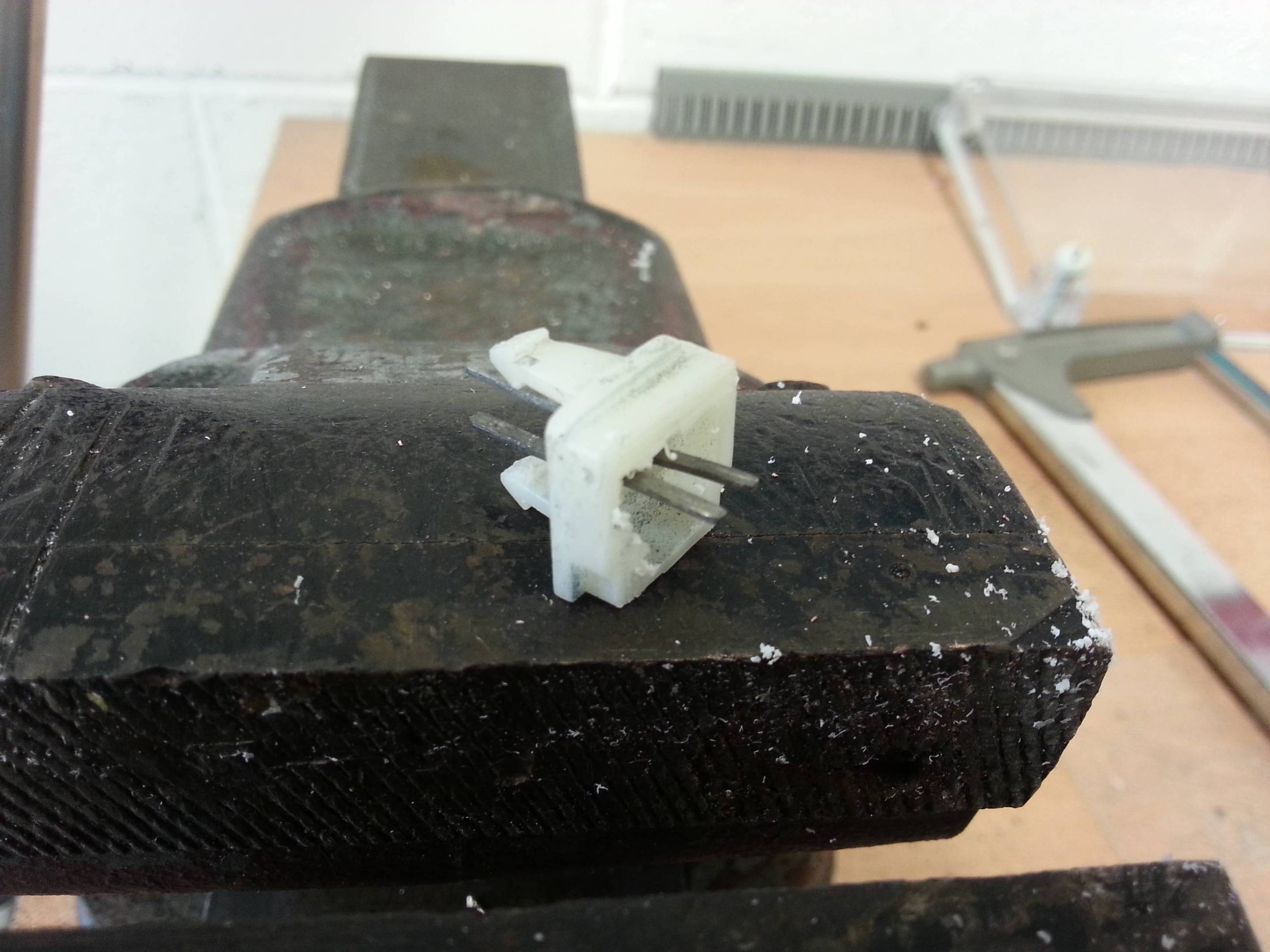

Then i removed the plug from the PCB:

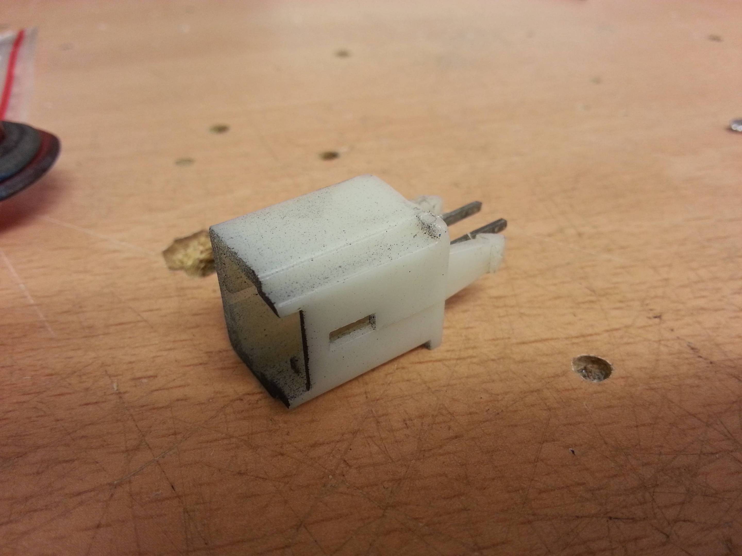

Needed to get access to the pins inside so i decided to hacksaw the outer case off:

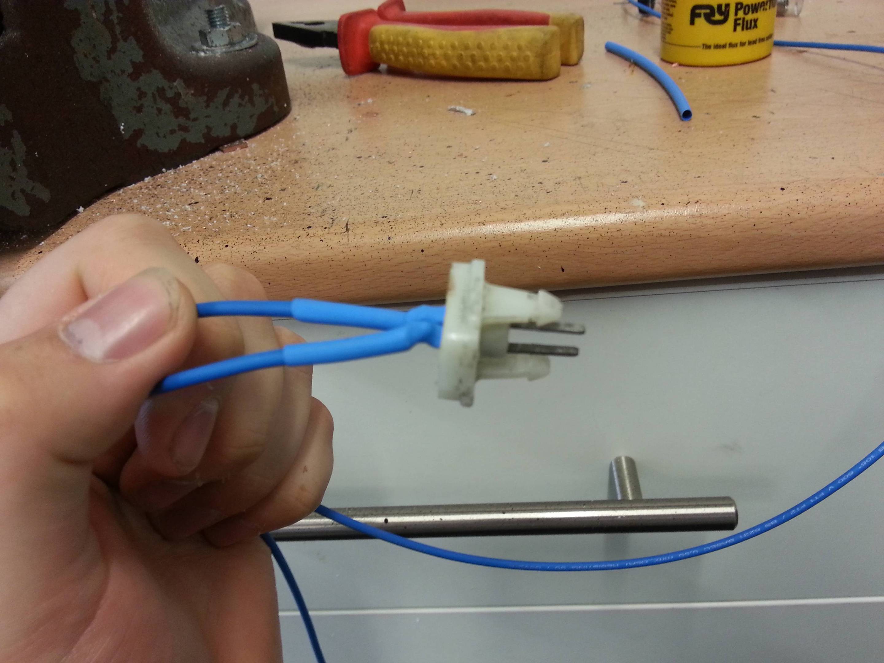

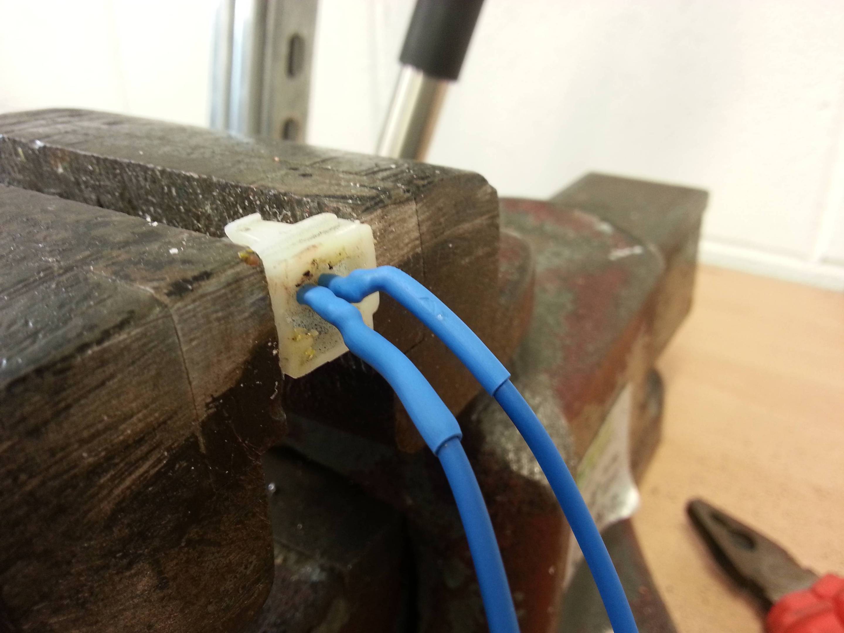

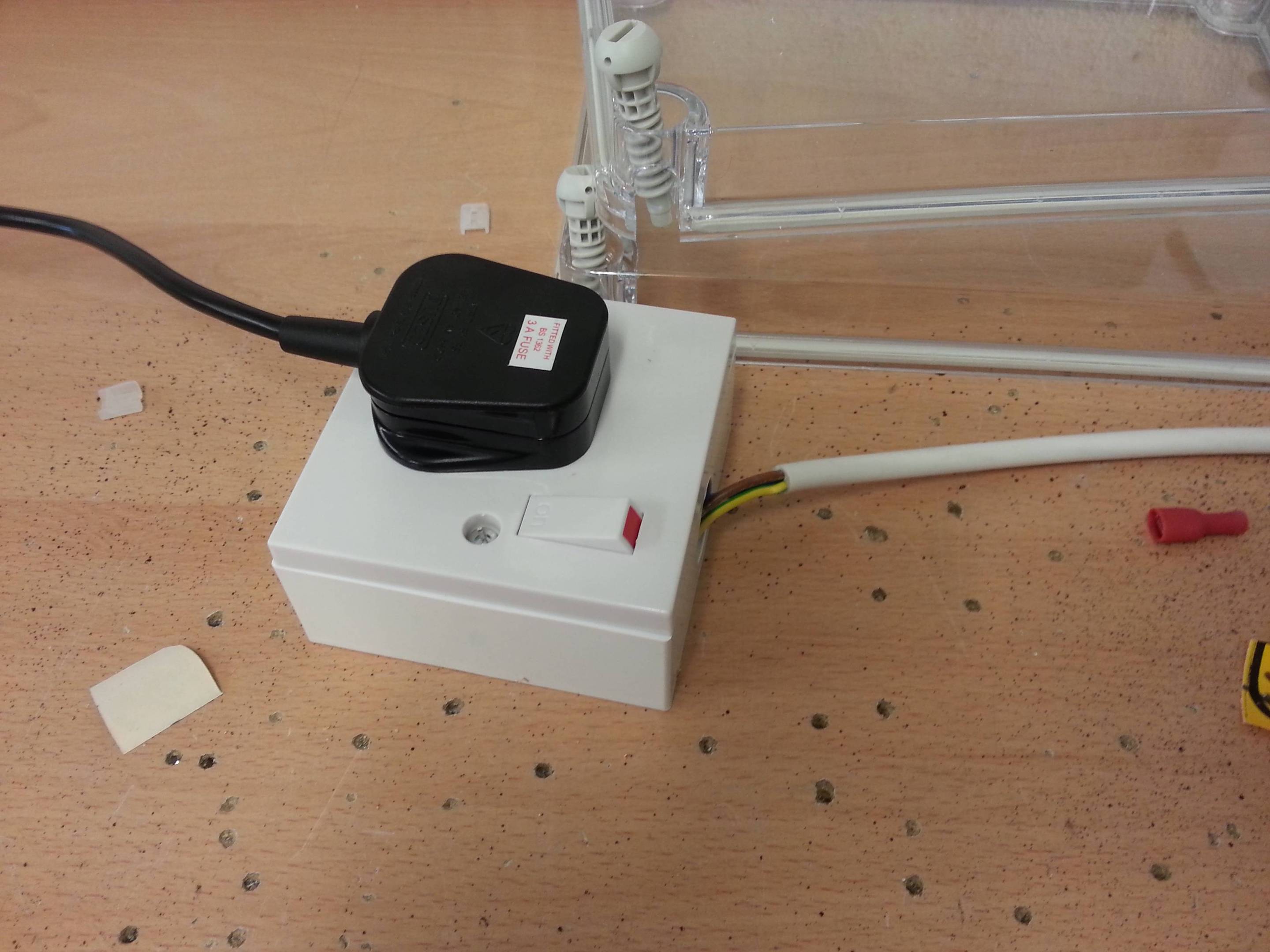

Then out came the iron! with my bodged extension lead of ofcourse ;)
Pretty happy with the final result!
Time to put it back together!

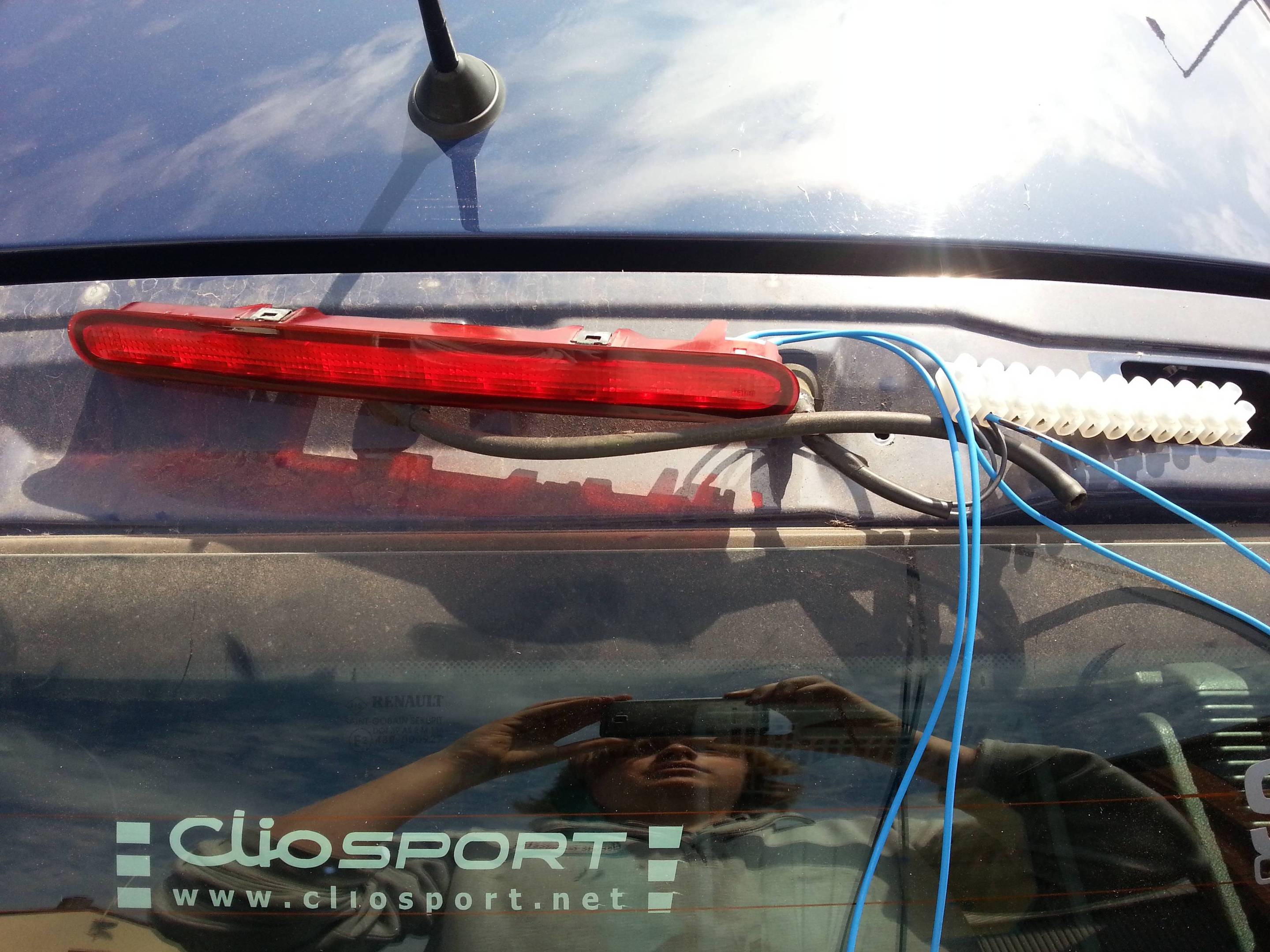

Then a quick test to see if tall was well, gotta love choc block:

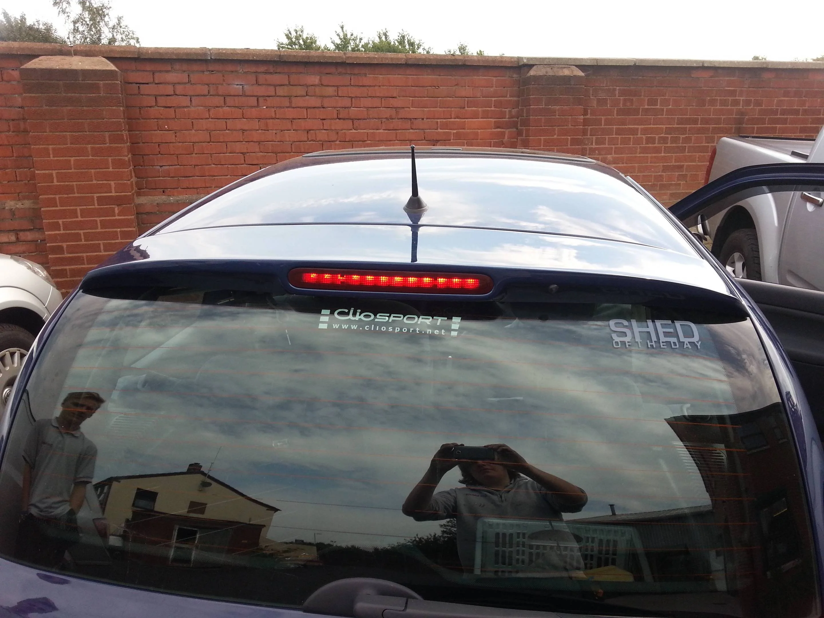

And its on! perfect :cool: Had to disconnect the washer though as the pipe is waaaay to short to reach the nozzle on the Cup for some reason, couldn't get the spoiler to sit with it connected...
So all in all pretty happy! anyone wanna buy a dynamique spoiler.........

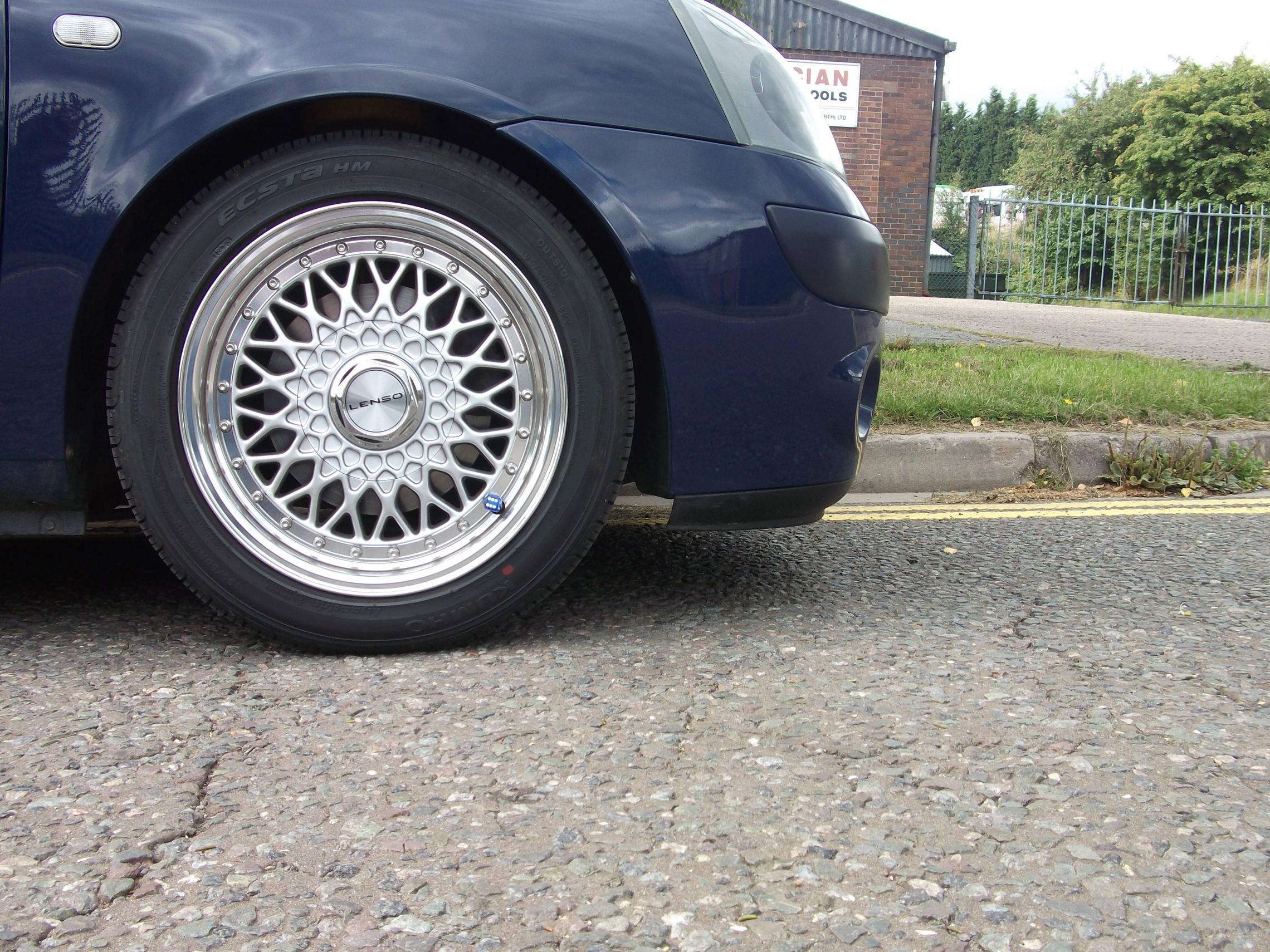

Looks great but you need some stretched tyres on the wheels and lowered down coilovers ;)
Sounds perfect mate but its an insurance game atm :/
Wish id have gone for coilies the first time round, 60mm isn't low enough...
i believe they may be a different colour although font quote me on that :/
Might see if i can track one down if they are. Don't plan on using the wheel straight away anyway

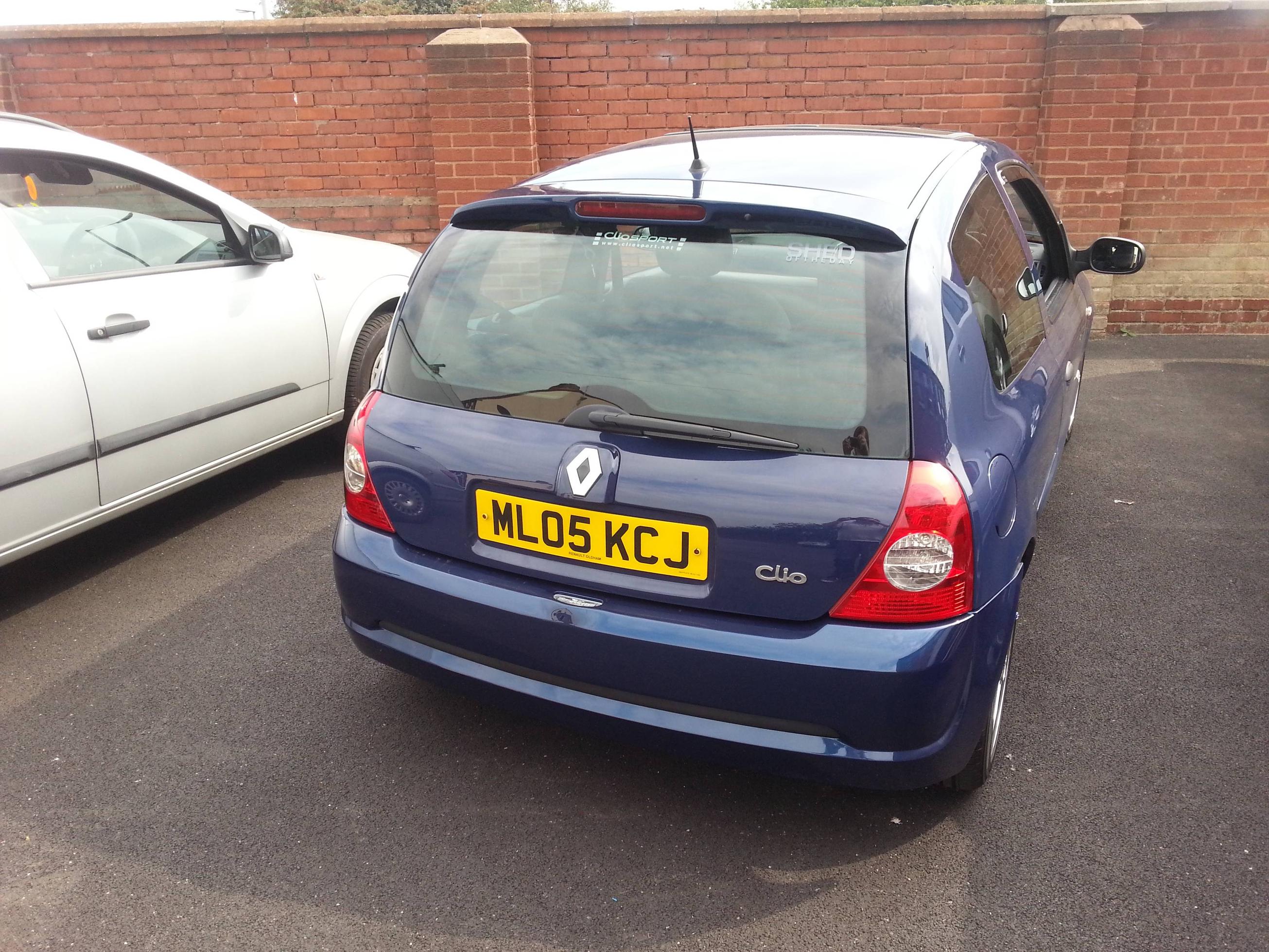

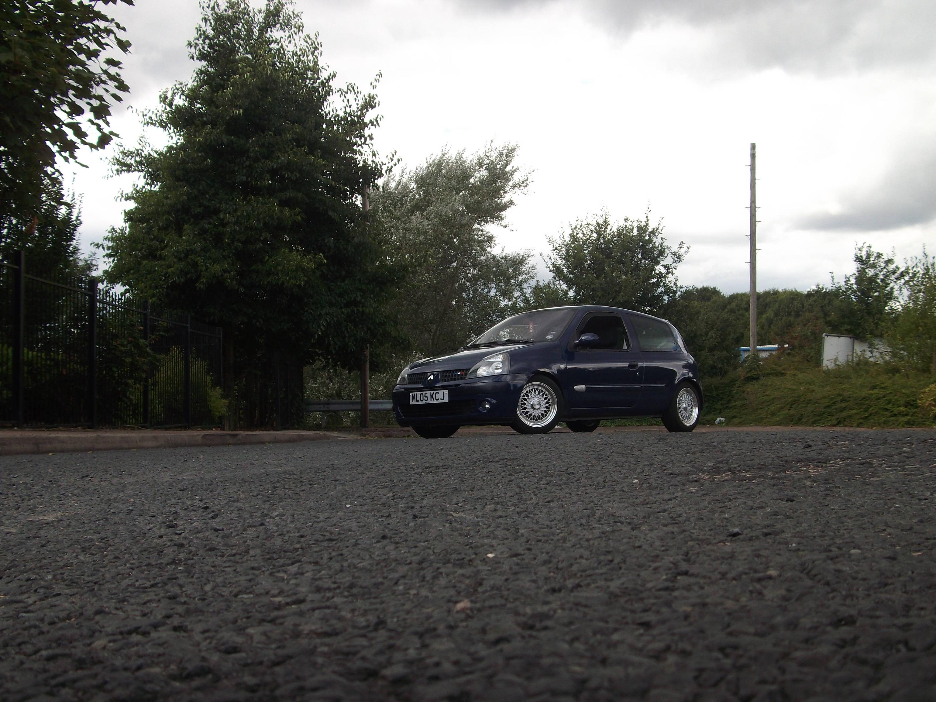

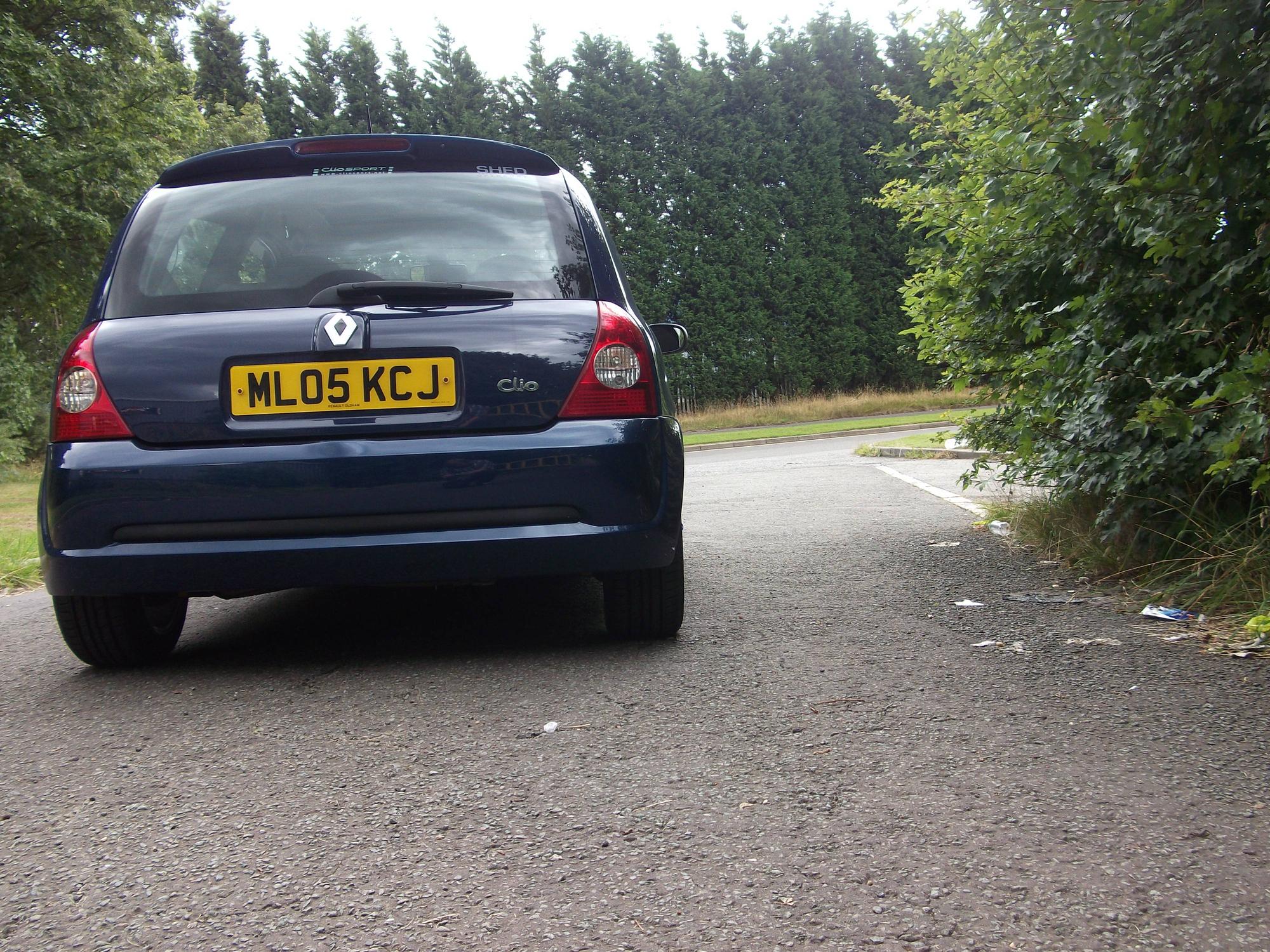

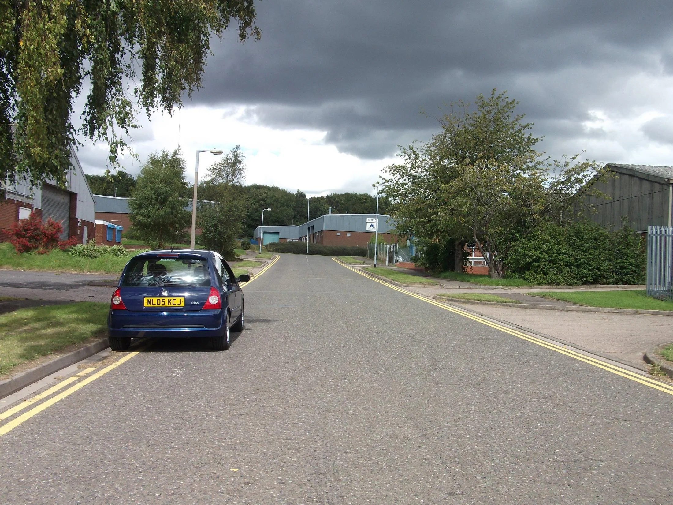

I thought the spoiler was a totally wrong colour? Car looks well.
Yeah its the same colour as the bumper, you can tell from this pic:
Might bite the bullet next year and just get them sprayed up, wouldn't mind goin to afew shows with it maybe. Cheers though! :)
