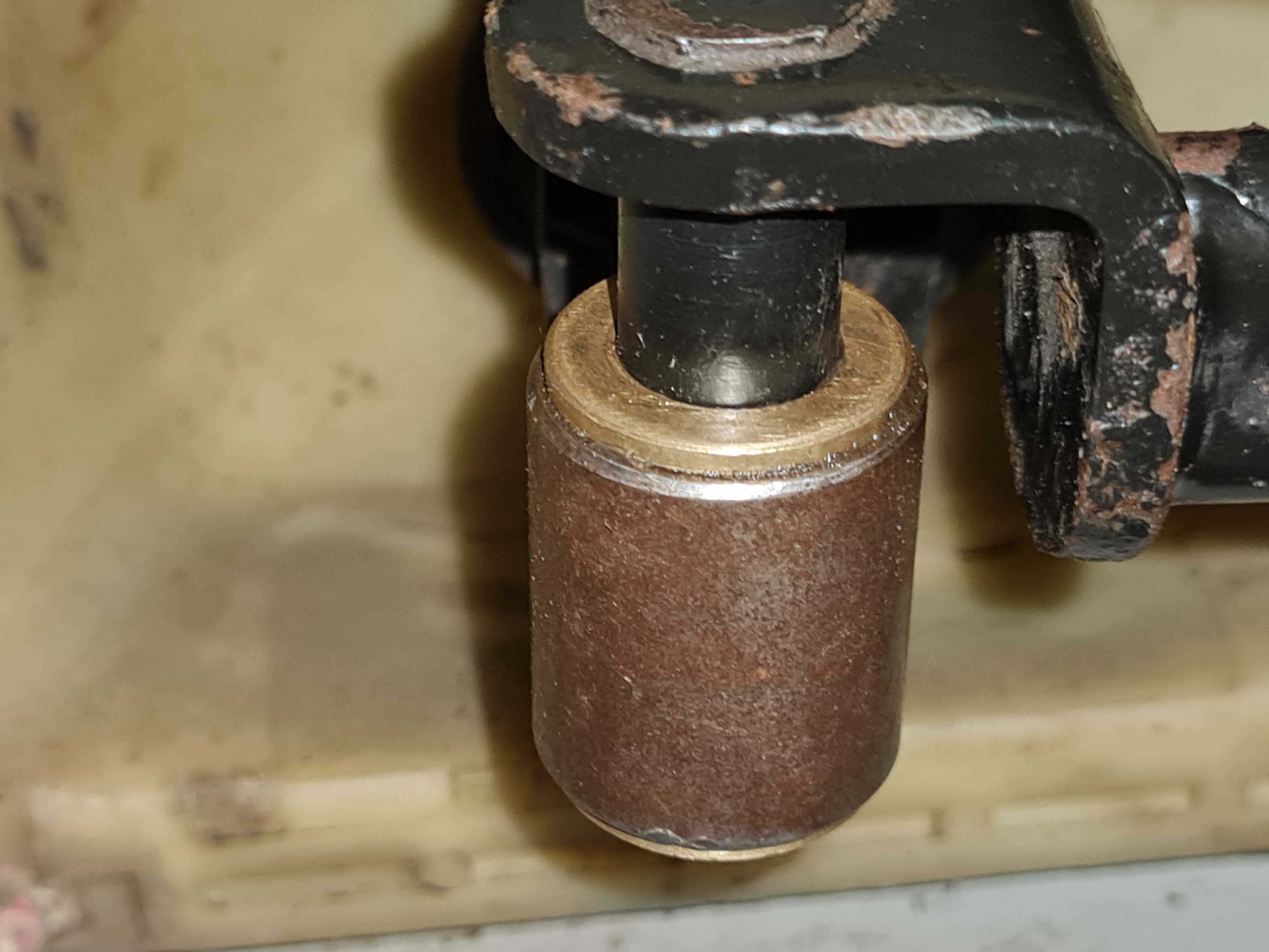

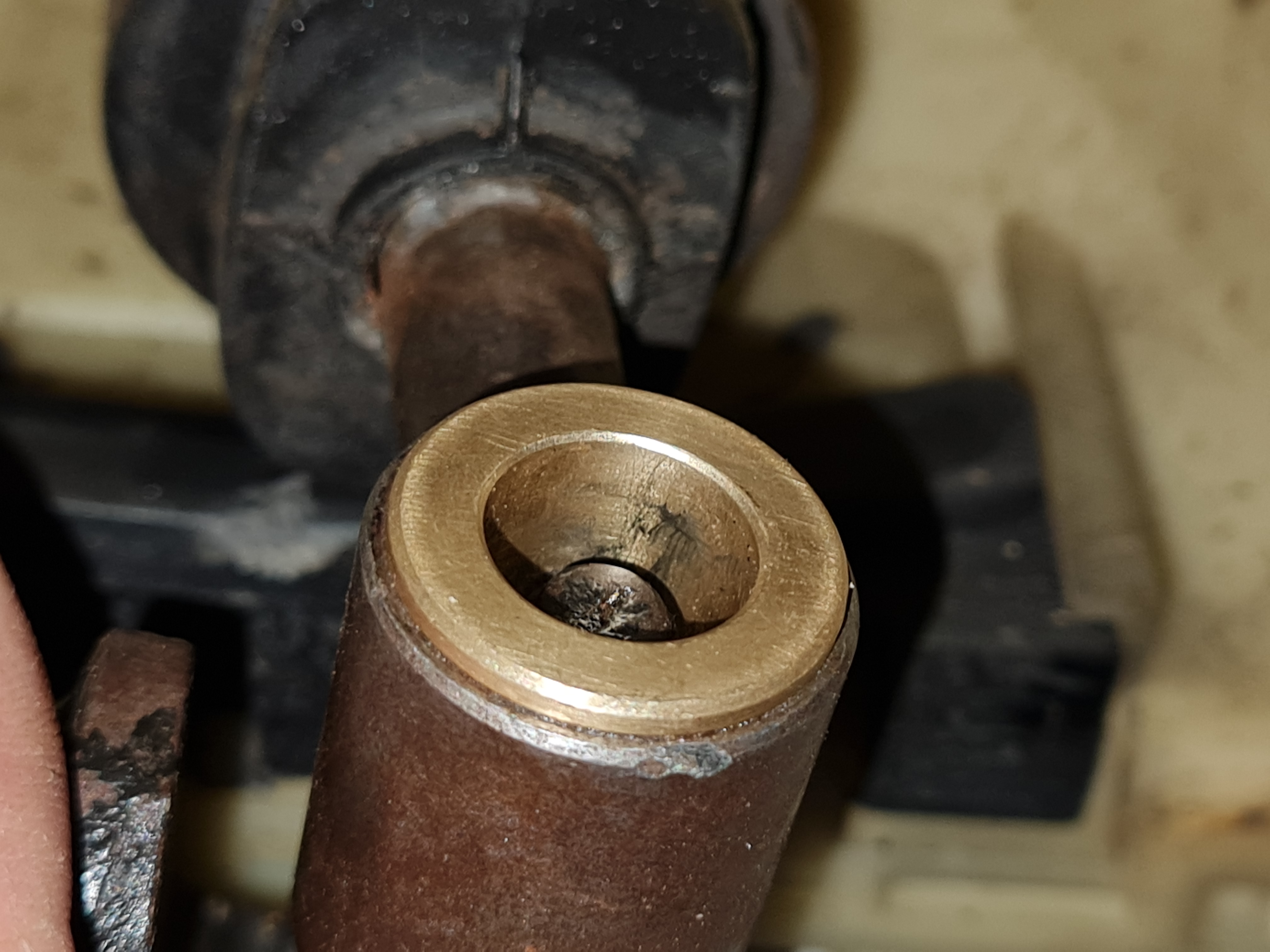

Nice day so I thought I'd perform the simple task of fitting the brass bushes from @plees . The heatshield pretty much fell apart so that but was easy but getting the selector to pass through the brass bushes is another thing all together. It simply will not go thorough nor can I get the bushes back out of the gear lever. Any ideas other than cat off and gearstick out?

There you go mate, stuck at that point. It will pull out but won't pass through and can't get the bushes out.

I'm at the point of no return really, got it on but the gearstick is pretty much immovable.

I fitted these to my mk1, other than one of the old bushes being a bit of a s**t to come out the brass bushes fitted lovely. Looks like there is some paint on the selector where it inserts into the bush? May be worth cleaning that up with a bit of emery cloth as mentioned

The problem I have now is that I've got it on but can't separate the two, my fault losing my temper with it, it slipped through the first bush fine.
It's far too tight for use though so I'm going to have to do something to separate them.

I know that they can take a few miles to loosen up a touch. But as @RichValver mentioned. It does look like there’s a coating of paint on the pivot pin that goes through the centre of the bushes.
If using it doesn’t free it up. You should be able to prize the pin out using a set of grips or similar, on the back of the bush and on the front of the pin where the thread is if that makes sense.

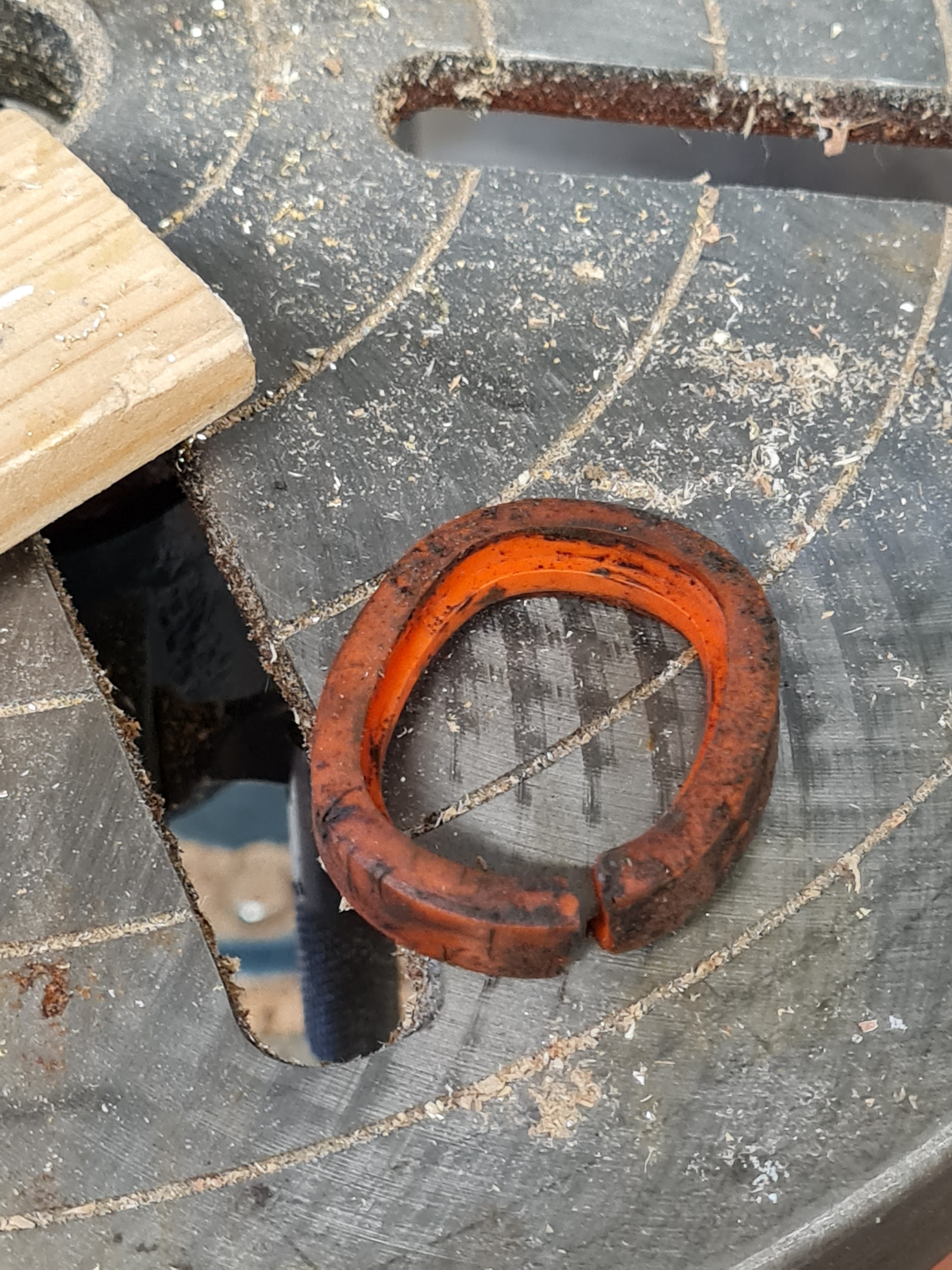

What is the purpose of this bit that fell off the lower part of the gearstick? Looks to just cushion the linkage from touching the sides.
