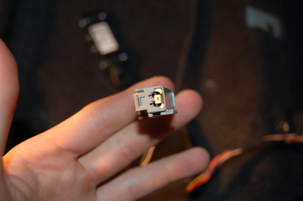

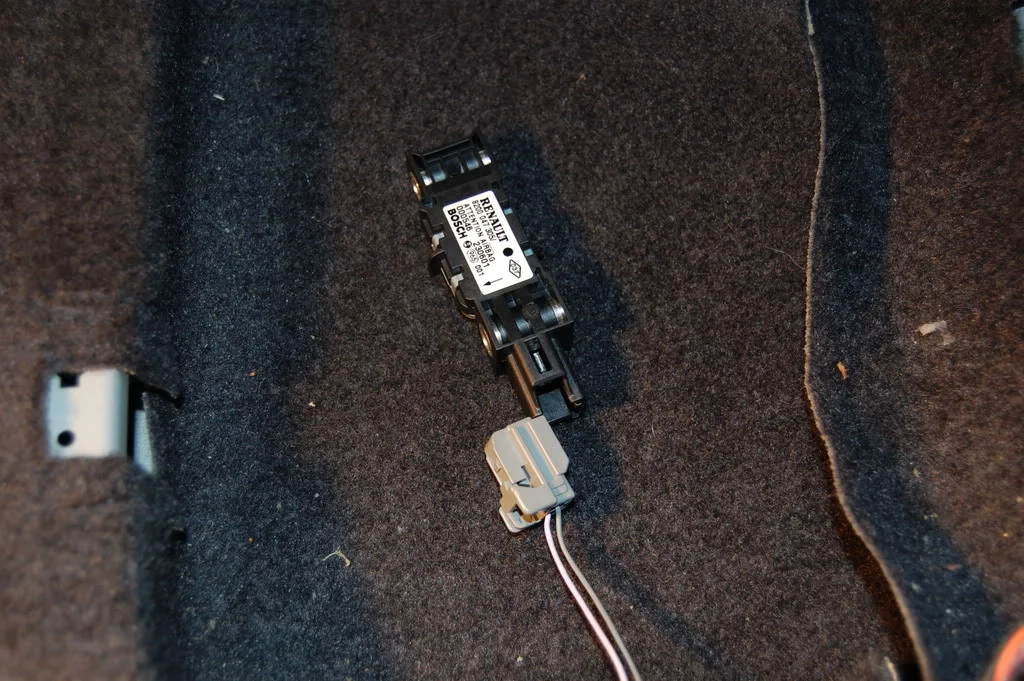

The grey connection pictured was attatched to the black 'box' which was bolted to the side of the car next to the seat. The black bit says airbag on it and the grey connection has two metal terminals where I assume my resistors go. (pictured below)

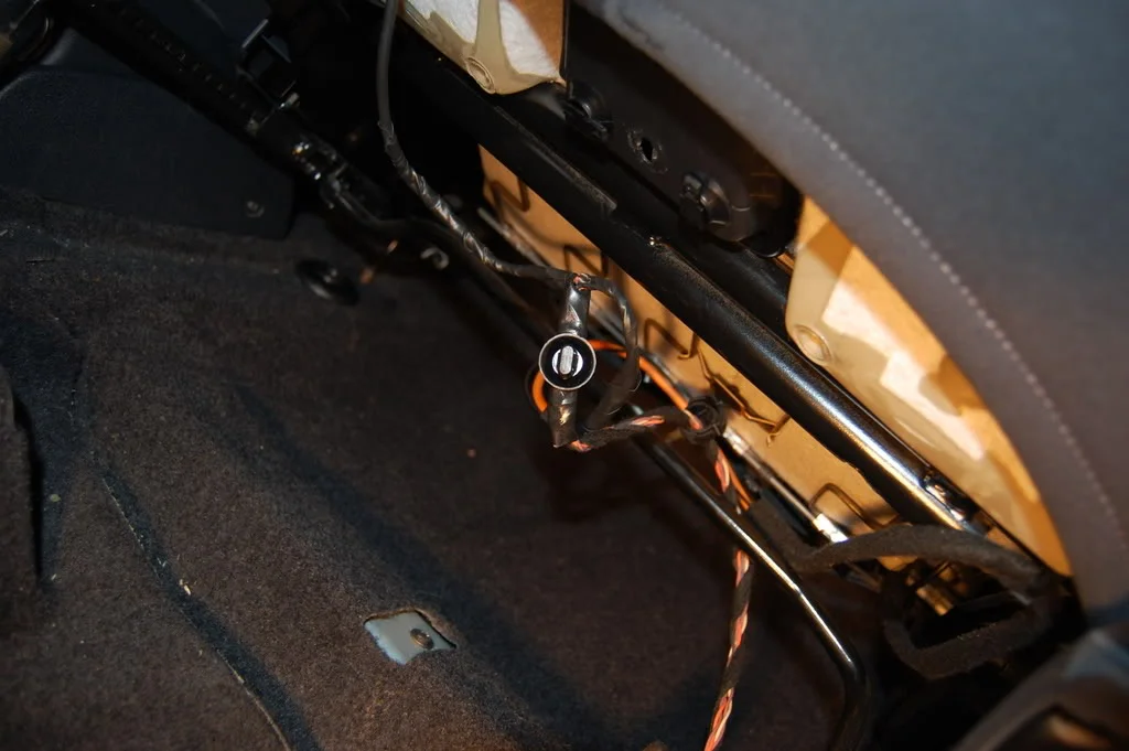

But thats all the connections I have, the following picture is under my seat. The loom with all the different colour wires comes from the same place as the grey terminal above and then goes under my seat where it splits into 2 sections, one going to one side of the side and another going to the other side. As far as I can see, there is no connection anywhere along this loom.
It's this loom thats keeping my seat connected to the car. Can I just cut through these wires and solder them back on when it comes to refitting my standard seats?

The other connector should be under the seat the same as the grey one and should be very obvious. iirc though the airbag light came on in some cars due to a faulty connector and the fix was to cut it out and fix the wires together. i would of thought it would be absolutely fine to cut the wires and solder them back together when reinstalling the original seats but can understand being nervous about doing so.

Your not supposed to remove that black box. It doesnt need to be touched.
You should have a black connector clipped to the under side of the seat and then a grey/yellow one should be attached to the seat belt clip. This needs to be unclipped and fed through the seat to remove it and then it can be reconnected again.
