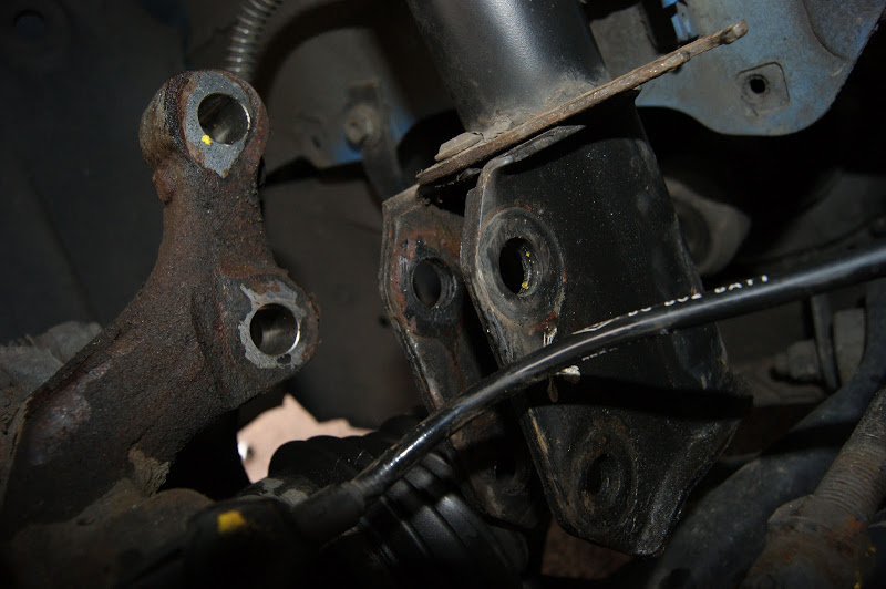

Done the front drivers side but that took about an hour because when you come to put the 2 bolts in the bottom on the springs to attach to the hub, they are so far out and its pretty much impossible to push the springs up or the disc down to align them up.
What is the easiest way to get them to line up?

get both front wheels off the ground, its easier that way ;)
22min to do an entire car is my record now :D
Did my 172 yesterday. No probs at all with both wheels off the ground at the same time.
Done it, thanks.
When I lifted the other front wheel up they lined up nicely.
Here is a picture of what it was like before
