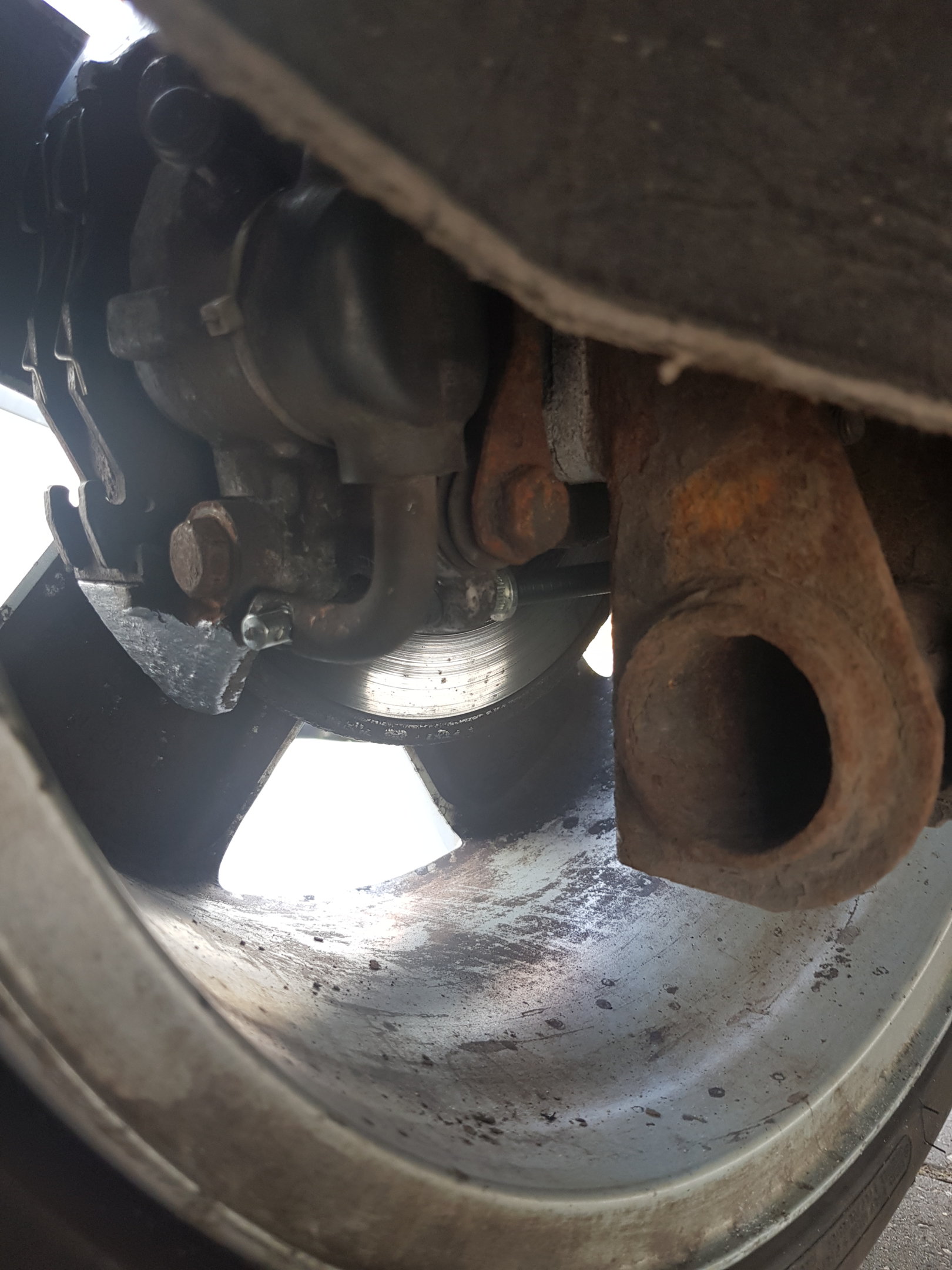

Well the left ha d cable snapped when the mot tester did the brake test so I went to eurocarparts and managed to find the cable which apparently fits.
The actual cable seems to be the correct length but the issue I'm having is the casing isn't quite long enough to allow the metal bit to locate into the hole in the caliper.
See attached pic
Will it be ok like this or should I just bitethe bullet and order Renault?

they don't fit now. they changed just after euro started using the name, they know they don't fit as well but no one seems to actually do anything about it. even the first line ones don't fit now either.
