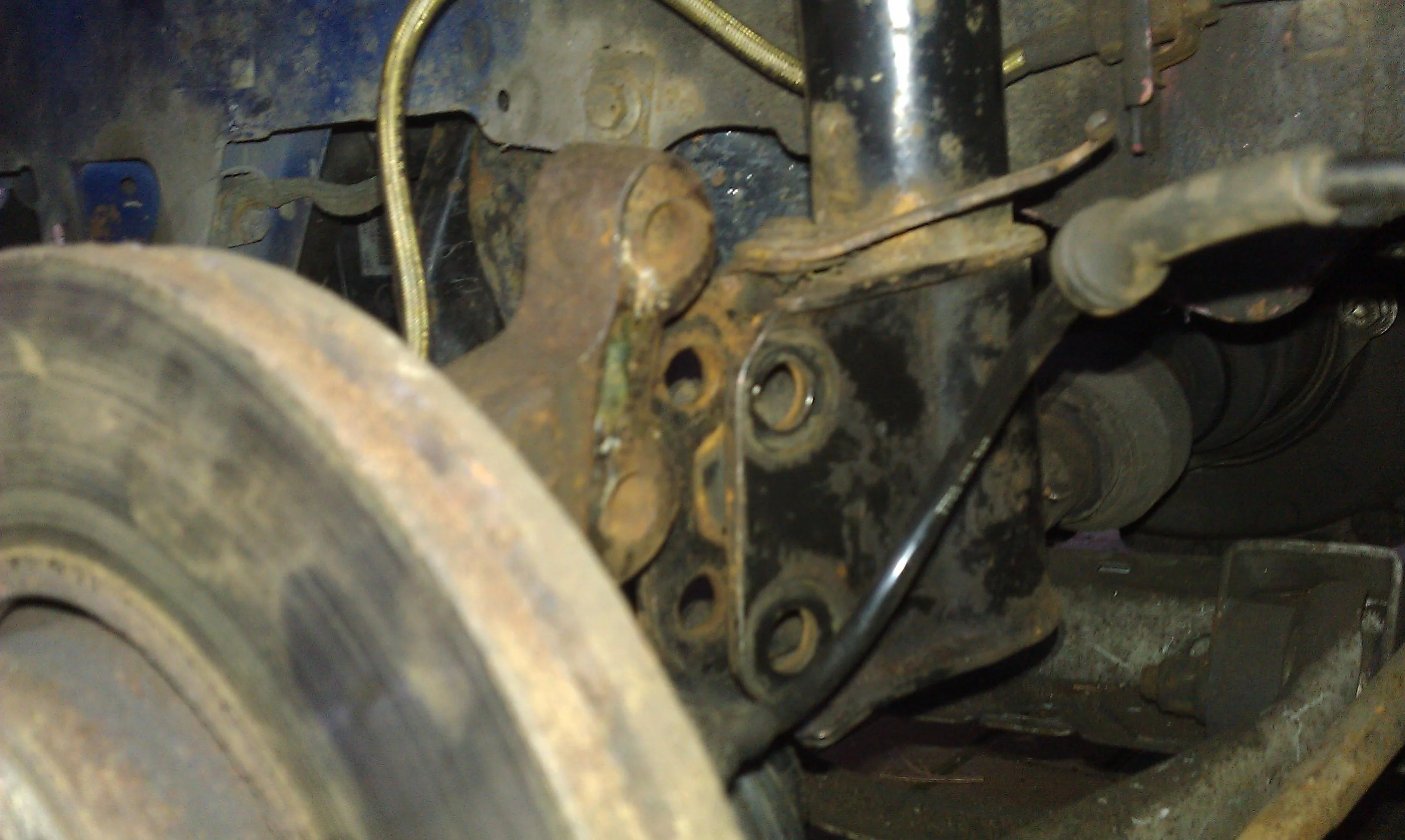

Here's my problem

you need 2 people mate. one person pushes down on the wishbone(i think) and the other pulls it. Have the nut ready to go in then hammer it in. Thats the way I did it. Needs a fair bit of force to go back in.
  DCi 100
Re: Fitting shocks, should I be able to put the shock in and bolt up hub, seems too l
And you have all the top mount in the right way and up through the hole?
Either way, jack handle or breaker bar in the wishbone will get it down!
  Clio 197
get some weight on the hub eg your bodyweight ! it takes a bit of force to get it in position , get a mate to help if you can , they will be able to slot in in when low enough

Will try a bar on the hub later, or get a mate round at the weekend if I still can't do it.

I had this problem getting mine back together. You need a bit of leverage under the shock. We just used a bar lifted it up a little, hammered a bolt in, hey presto.

lever the lower arm down, simples

Got it sorted but both inner driveshafts popped out with how low I had to take the hubs. Passenger side went back in no problem but drivers side was completely separated. How much of an issue is this? A quick look in the haynes suggests I need pin for the drivers side at the very least but it's not looking too clever at the moment just pushed back in place.

if your on your own, undo the 2 bolts on the ball joint, on ur wish bone, undo the track rod end, then bolt shock to hub, then put ball joint bolts back, and track rod end,

just make sure your drive shafts are pushed in thats all,

Just use a prybar to pull the wishbone down, and then slide the bolt in with your other hand...simple!
