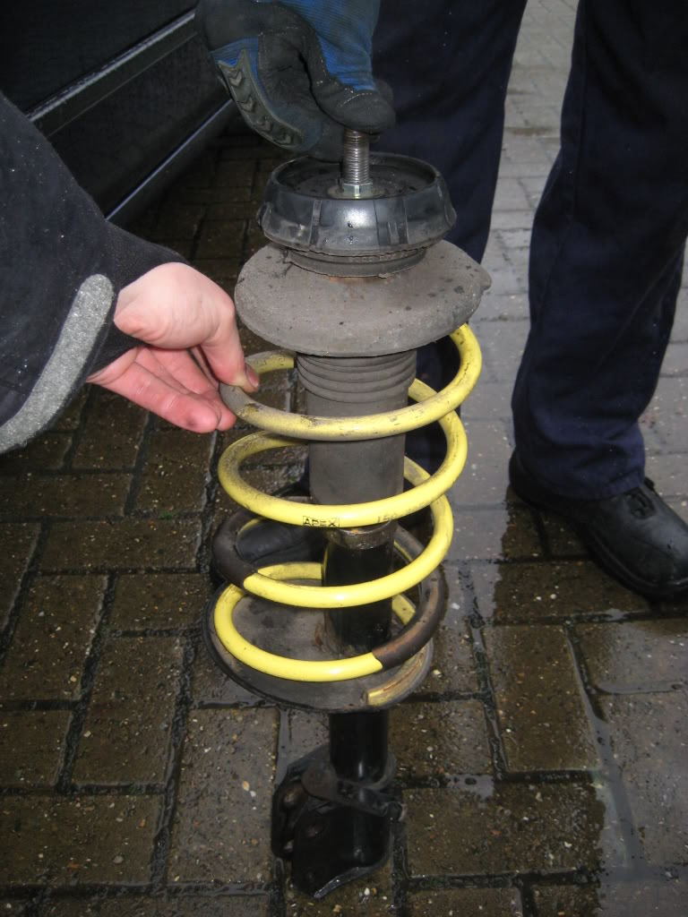

okay so mine are fitted but i think i have done it wrong

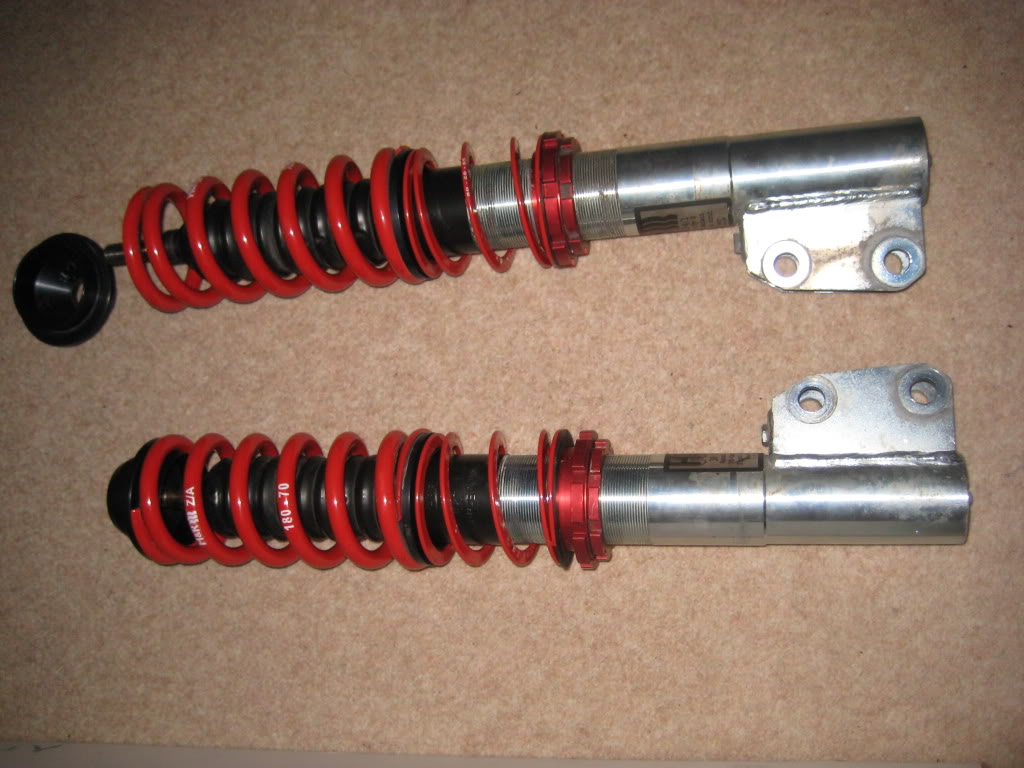

okay so this is the standard suspension, i had taken the nut off and used the big black rubber part and put this on top the the rubber i recieved from my coilovers e.g the black bit below
^^ then i jus put the bearing on and screwed this to the top mount and tighted all the other nuts, have i done this correct? should i have used that original black bit of the standard shock?

take the black but off the standard shock and the washer thing you can see from the picture, then the black disc underneath and assemble it like it was originally and place in on top of the black hat thing with the coilies mate, thats what we done and mines are fine.
edit... i mean the disc immediately under that rubber but, not the actual but that touches the spring.
