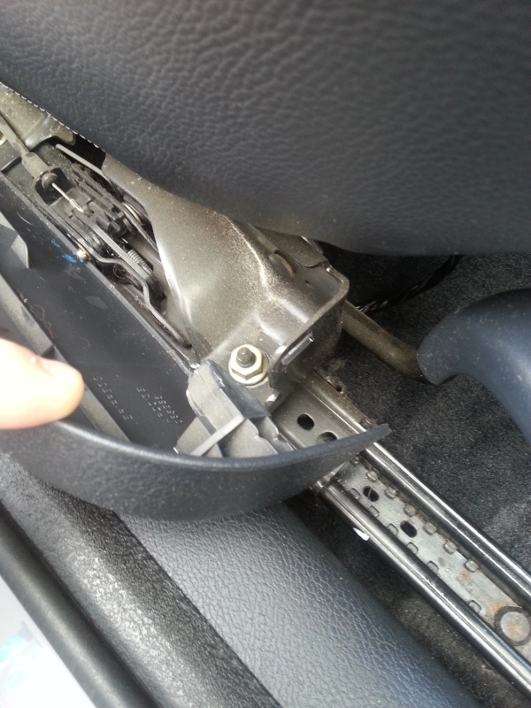

flat-eric Car Monaco 172 Aug 26, 2012 #1 Well after searching I came to the conclsion that my runners had had it but today I had a butchers and found this! Turns out that the front 13mm nut was loose and had undone by about 2mm! so a nipped it up and did the rest and job done! Rob
D Dan@SJM Car 07969 124504 Aug 27, 2012 #2 I'm finding this is quite common actually. 2 172's I've bought recently have done this and a handful that have been in for servicing.
Paddy_R Car Clio RS200 FF Aug 27, 2012 #3 Small drop of thread lock should stop it happening again too.
