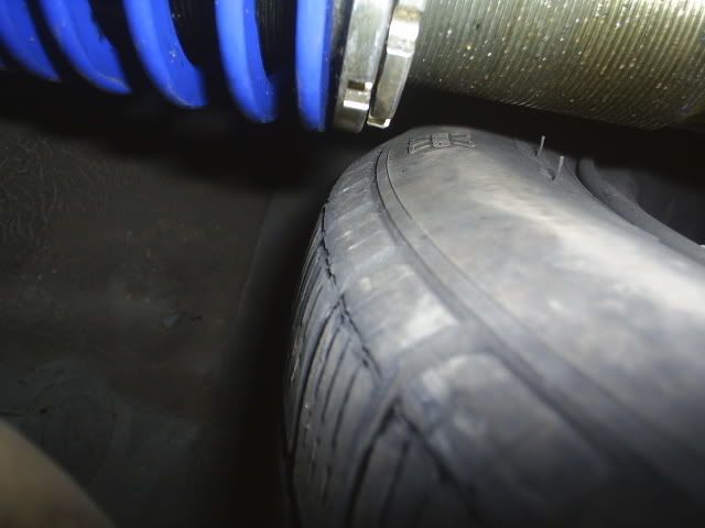

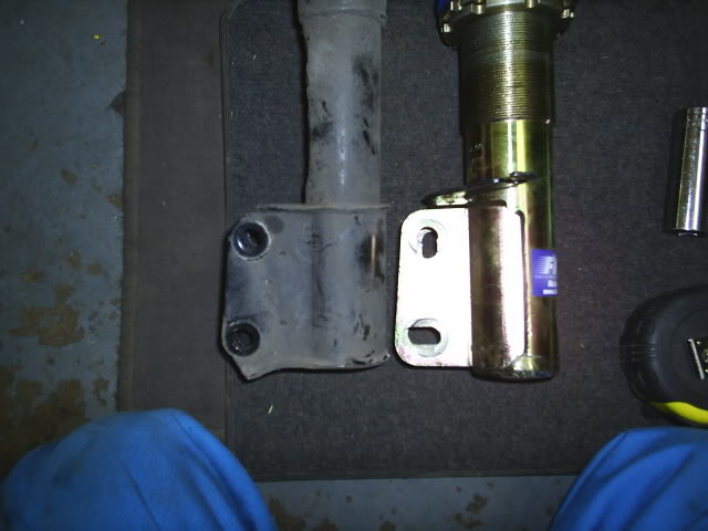

ok iv got a 1.4 16v 2004 clio and iv had probs will them i cant set the camber up right i cant set it to - camber .. iv been emailing modified for over a month and fk have said its the wrong kit and they dont make one for my model .. has any one had this problem do i just need 5 mm spacer ?

the wheel needs to go in more at the top but cant cuz it hits the strut
i thought some one said on hear infact i thought it was you .. said you need 5 mm spacer on all 1.4 s?
FK's? if you pop by my house at a weekend or something i can set the camber up by eye, won't take more than an hour, call it a beer or four ;)
