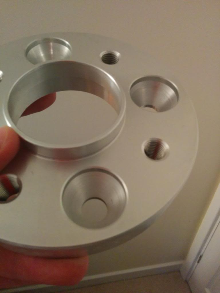

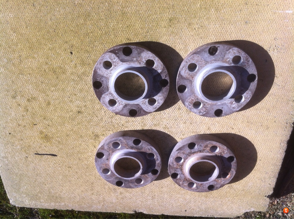

The spacers with sloped holes:

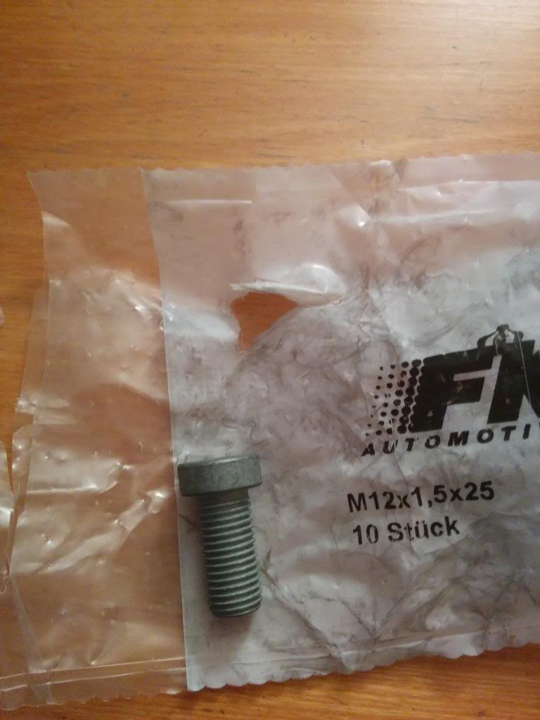

Square headed bolts:

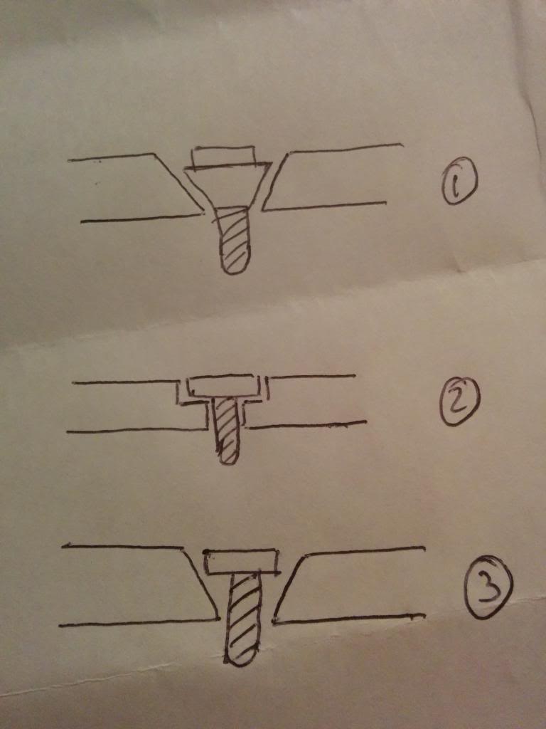

The problem (I've got number 3):

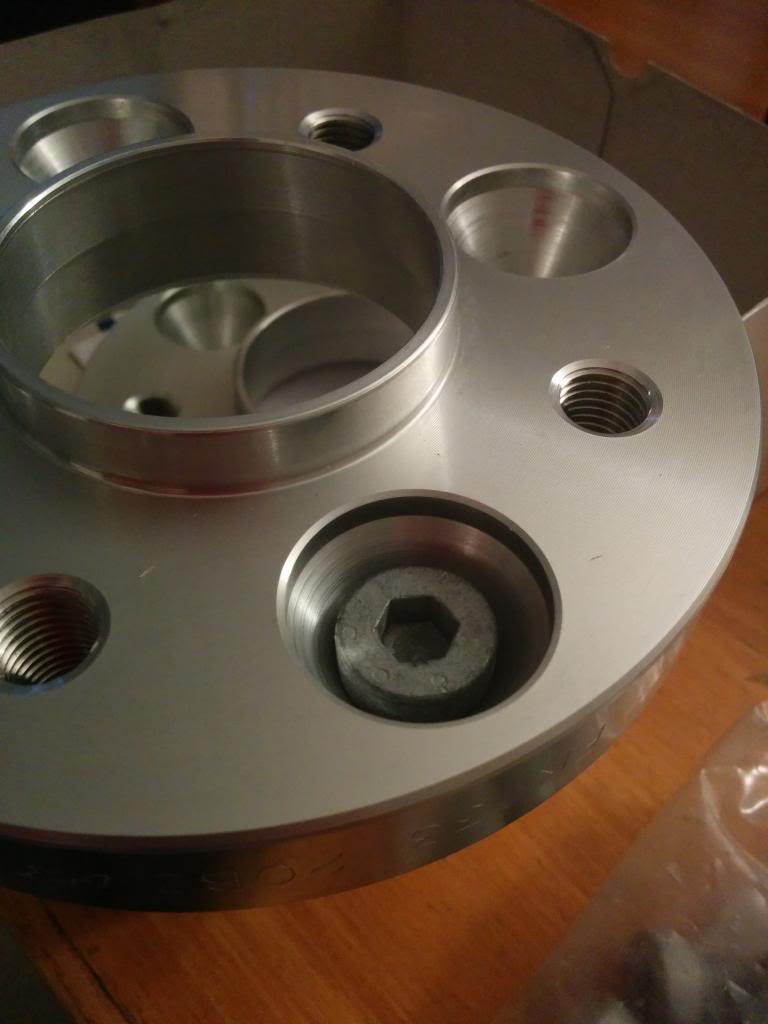

The bolts in the hole, not fitting flush and looking far to small:
What I was expecting:

Rob, sorry but this is just not the case. They're just standard "caphead" bolts in a standard metric size "M12 fine."
The bolts provided are designed to sit in a counterBORE ("square"). The spacers have been machined with a counterSINK (tapered). Clearly there are only two possibilities:
1) They've simply put the wrong bolts in the box (they should be "countersunk capheads") - believable.
2) The bolts are correct but they've accidentally machined an entire batch (it'll be CNC'd, not done by hand) of spacers with a countersink instead of a counterbore - less believable.
Edit: Opened reply before Skeeter posted - but spot on exactly what his pictures show!

100% incorrect though, your diagram explains it perfectly so I'd be tempted to send that over.
  330i. E30 Touring.
Yep. Those bolts aren't right for those spacers.

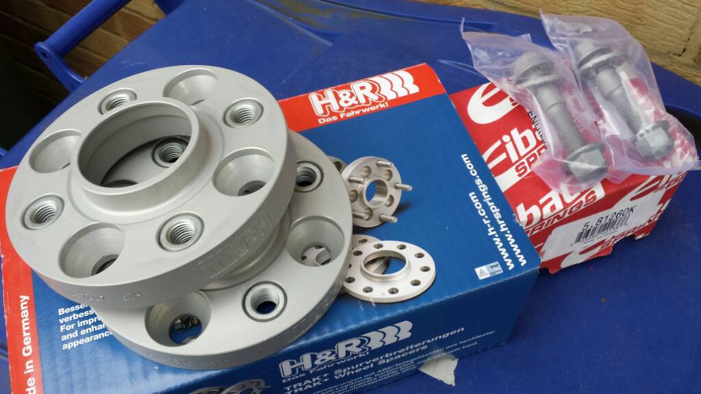

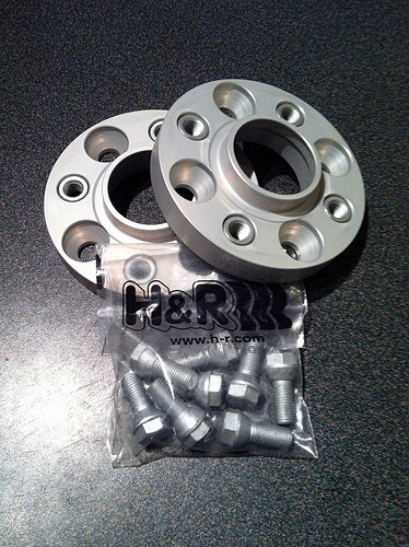

But H&R spacers from Euro car part's, best spacers ive seen.
Even have steel inserts for the wheel bolts.

Does anyone know if the H&R ones come with bolts?
  A special one.
I ordered mine from Larkspeed, they came to me with a Euro Car Parts label on the box and where sent direct from ECP.
If id of known then id have ordered direct from them as i have a trade account.
