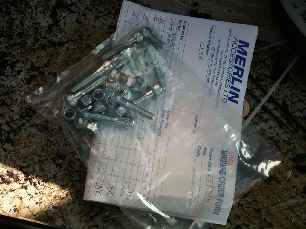

Can I ask what size bolts you used to fit your subframe down, as av got a pair of Corbeau Revolutions to fit aswell.
Here's a picture of them. The shorter ones were for fixing the sidemounts to the subframe.
I think they are about 50mm grade 12.9 high tensile bolts.
Cheers lads for that but if you could find out the ones for fixing down the subframe to the car it would be much appreciated?. Av already got the sidemounts mounted. Also where did you get them from?
As I posted above mate, purchased from Merlin Accessories Ltd.
You need grade 12.9 high tensile bolts for all fixings.
Subframe to car: 50mm
Sidemount to Subframe: 20mm
