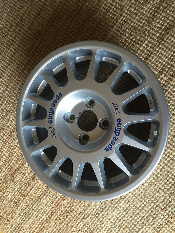

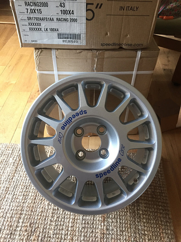

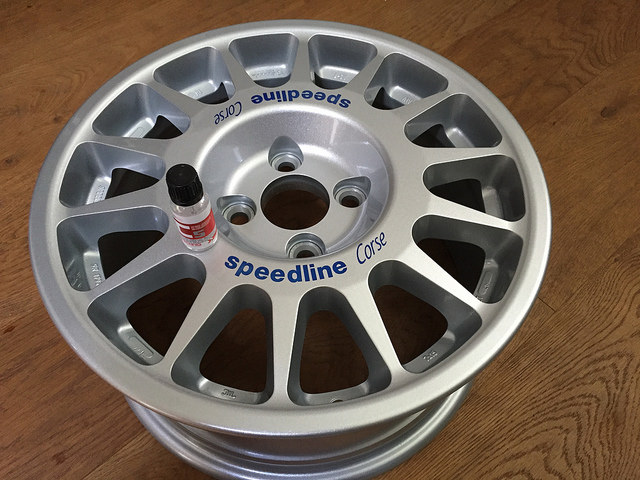

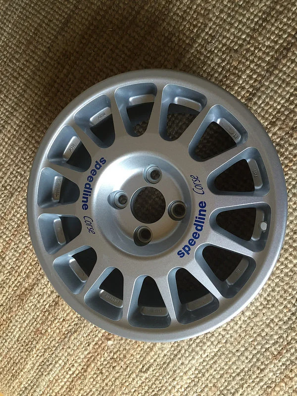

And purchased a new set of silver Speedline 2118's...my third set.

Silver 2118's coated with C5, hopefully this will help with cleaning the brake dust off, and protect them.

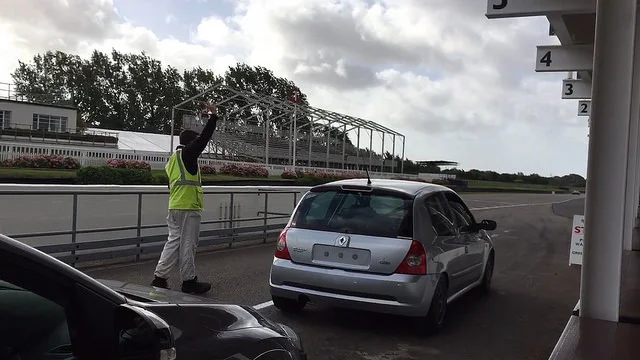

On Saturday, Mel and I went to Origine RS, I had the morning track session booked. I was looking forward to it as I haven't been out on track since the April 'Ring trip and, as I previous mentioned above I had that annoying misfire. This would also be the first time I have done Goodwood, and the first time out on a track with db limits with my Pure Motorsport race exhaust system fitted....
Static test @ 5200RPM was 94db so a pass. However it didn't do very well with the db metres out on the track 😧 and was black flagged after my first lap.
I was planning on getting a centre silencer for it anyway, as It would make longer journeys more comfortable for me and passengers. The good news is I did really enjoy my short time out on the Goodwood circuit and the car was running very well, so I plan on booking a full day there soon.

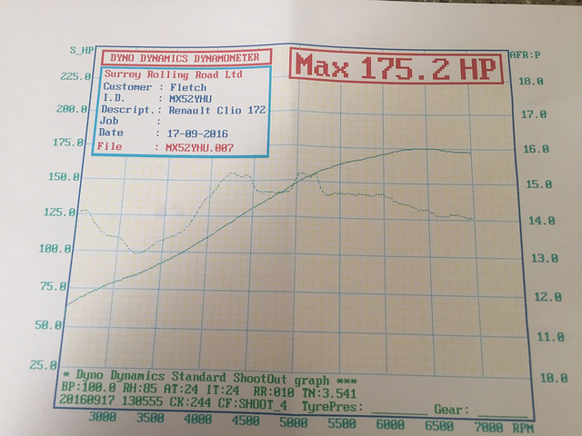

Saturday just gone I went to CS Surrey Rolling road day. The car now on 156k made 175.2bhp and 157lbft so pretty pleased with that. What I am not so happy with is how lean the car is running :(

Silver 2118's look really good Fletcher. ET38 or 43?
Yep, can only echo what Ant said. If looked after and serviced well, there's no reason why they cannot go on and on, even with some hard pushing on the loud pedal!
The F4R is a strong engine, and if looked after should go on and on. Once warm It gets driven very hard.
Cheers Mark, the offset is ET43...the same as my white, and anthracite set

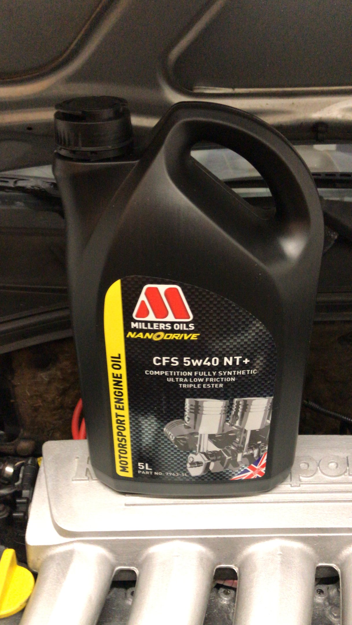

Update: Got some millers oil for a oil/ filter change.

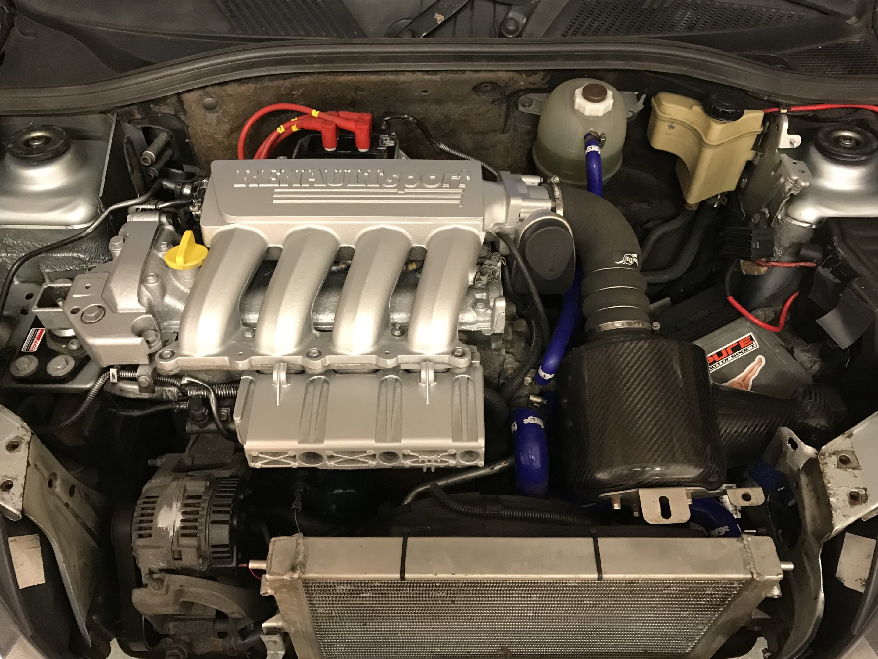

Resprayed/ painted the inlets rocker cover with Hamerite silver paint.

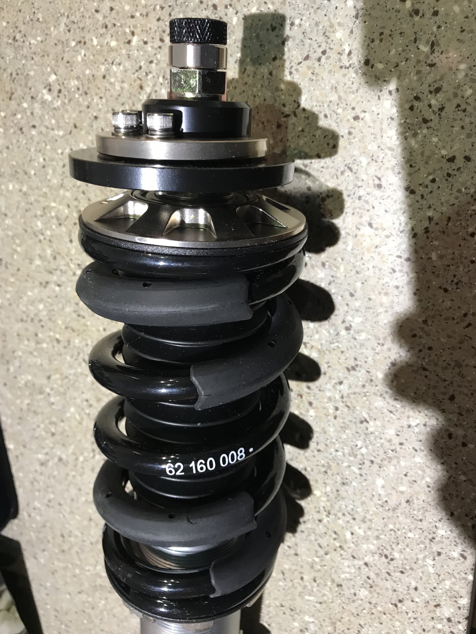

And finally purchased some new coilovers BC/ DR 8kg front 8kg rear springs, with adjustable top mounts.
The car is currently away having the above coilovers fitted corner weighted along with having a mot.
Cambelt change due next year, so am currently debating between either fitting some 421/438 cat cams, or 197 with group N timing... Thoughts on that please?
