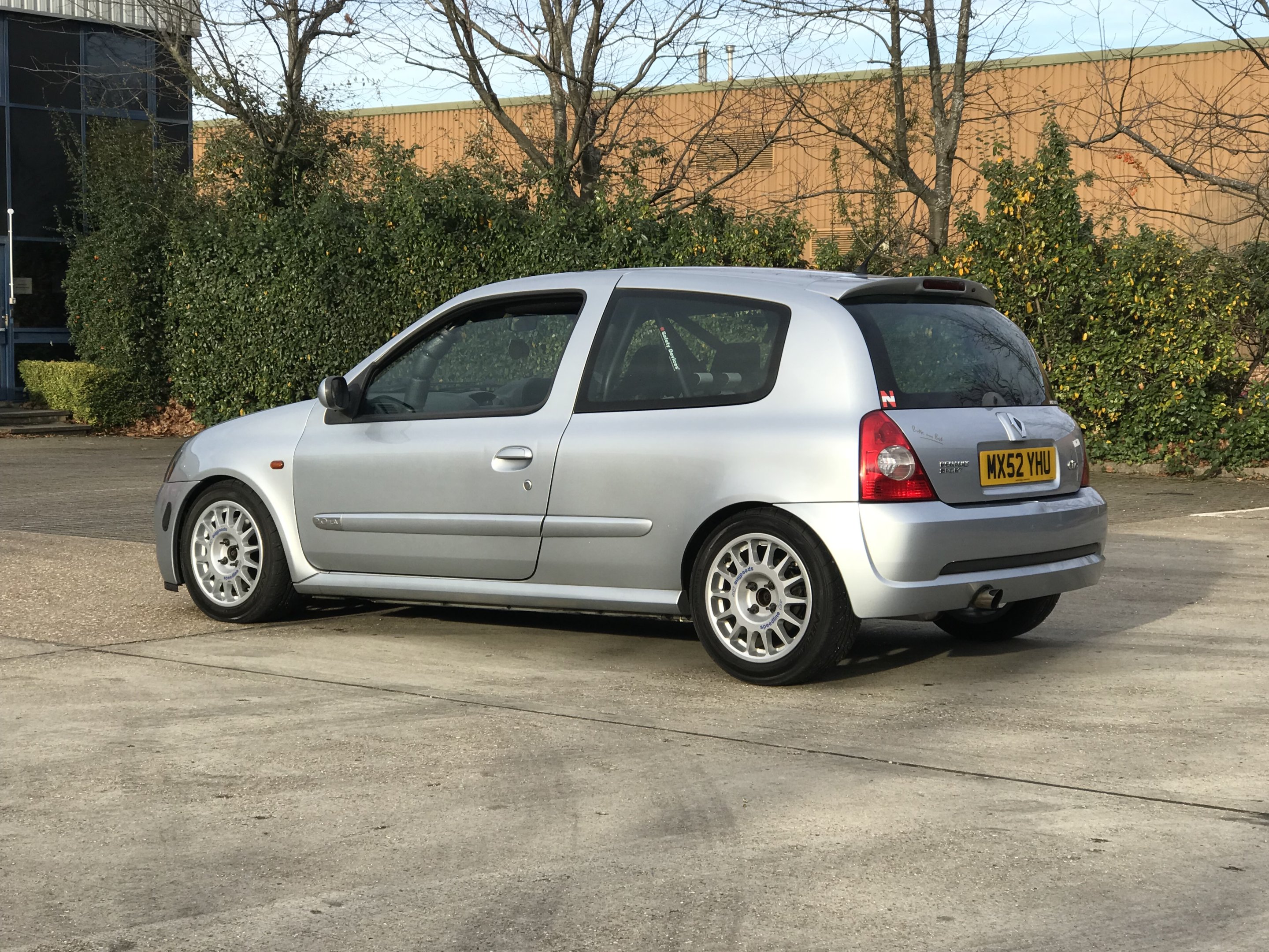

Update:
The 172 passed its MoT a couple of weeks back, and is now running BC DR racing coilovers 8kg/ 8kg. Today I lowered the fronts a little bit more. A couple of pictures..

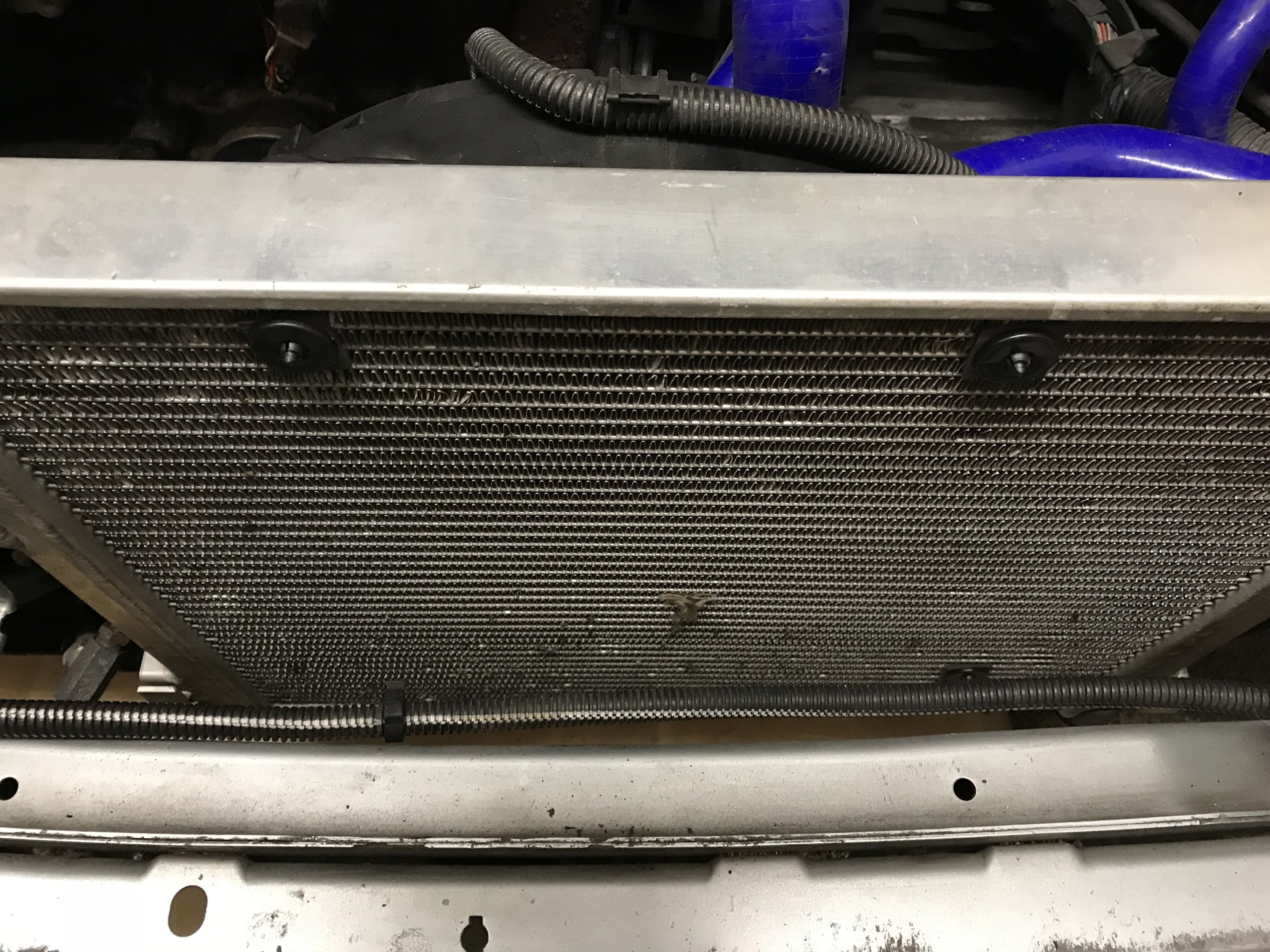

Last Sunday after a spirited drive I noticed the temp guage go well over the half way mark, and the fan didnt kick in. After checking all the plugs, and relays I still had no luck. So purchased a new fan from Renparts, I fitted this still no joy :(
Then I remembered last summer as I was cleaning up the engine bay - a bolt, connecting an earth, snapped as I was cleaning behind the pass headlight. I unplugged the coolant temp sensor and touched the earth against the old bolt, and the fan fired up into life!
As I changed the radiator fan over I thought I would secure them with some proper fan clips, as previously the fan was attached with zip ties.

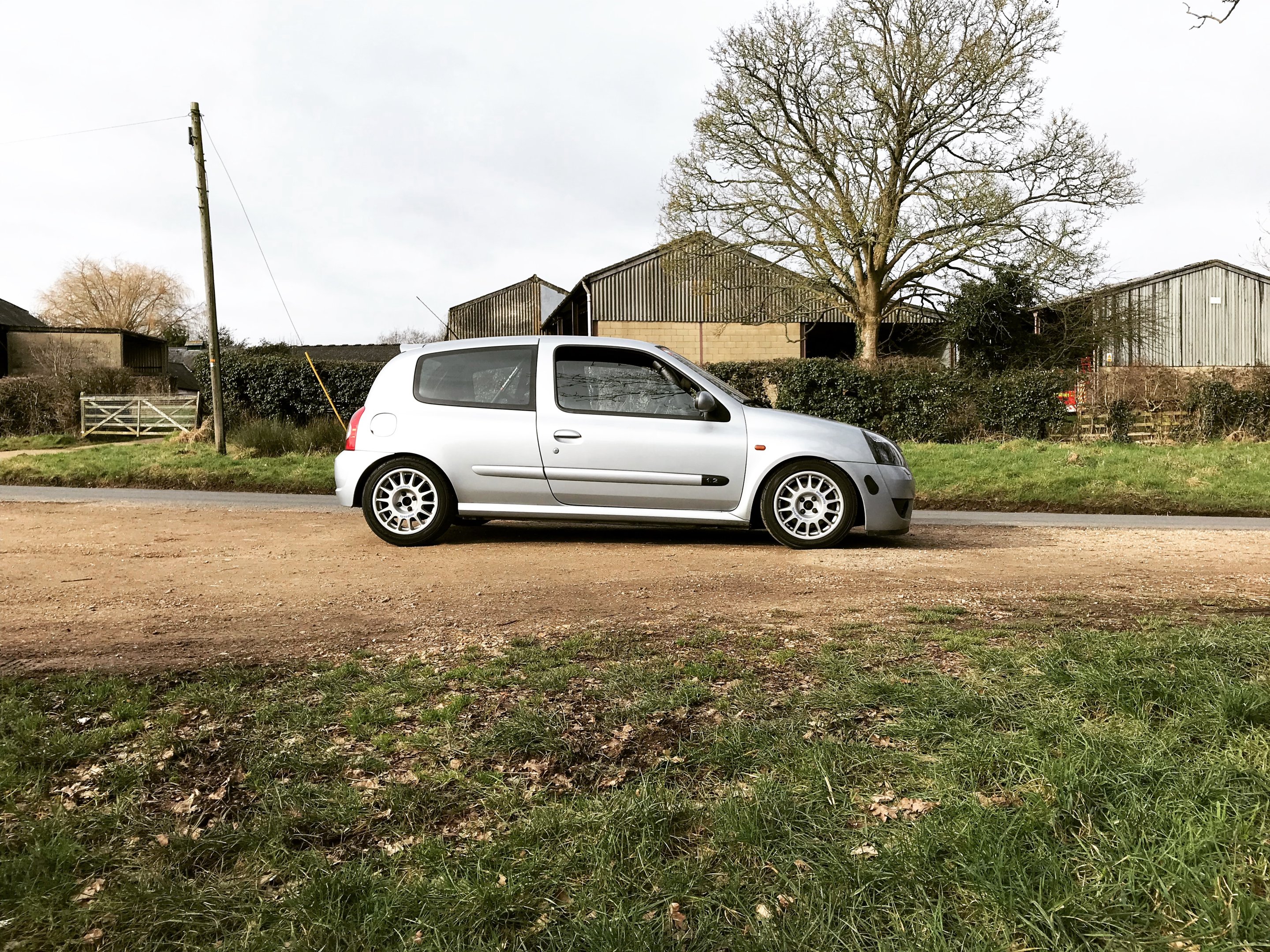

Update:
I haven’t done much to the Clio over the winter, it’s just been sat in the garage waiting for the weather to improve.

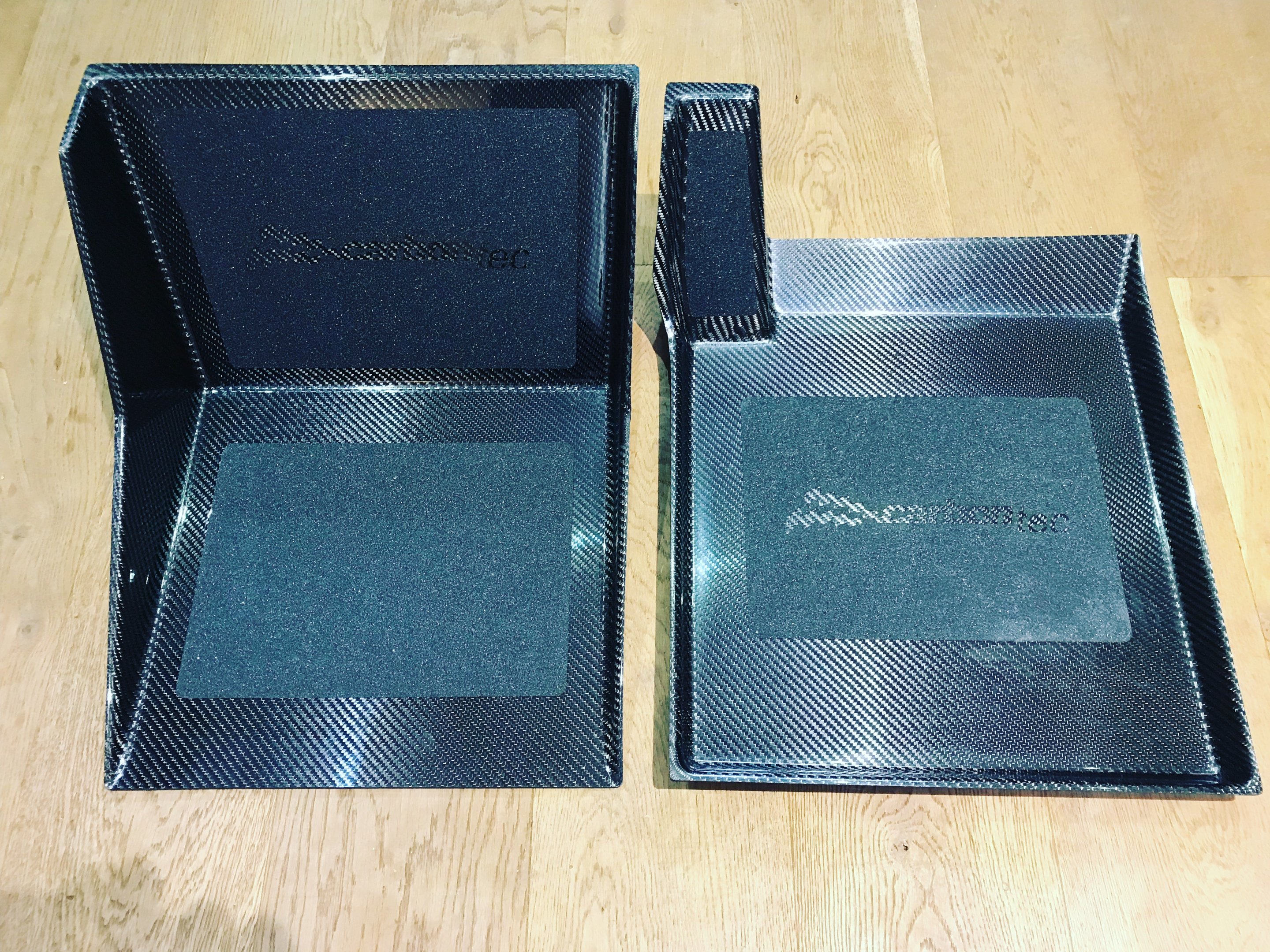

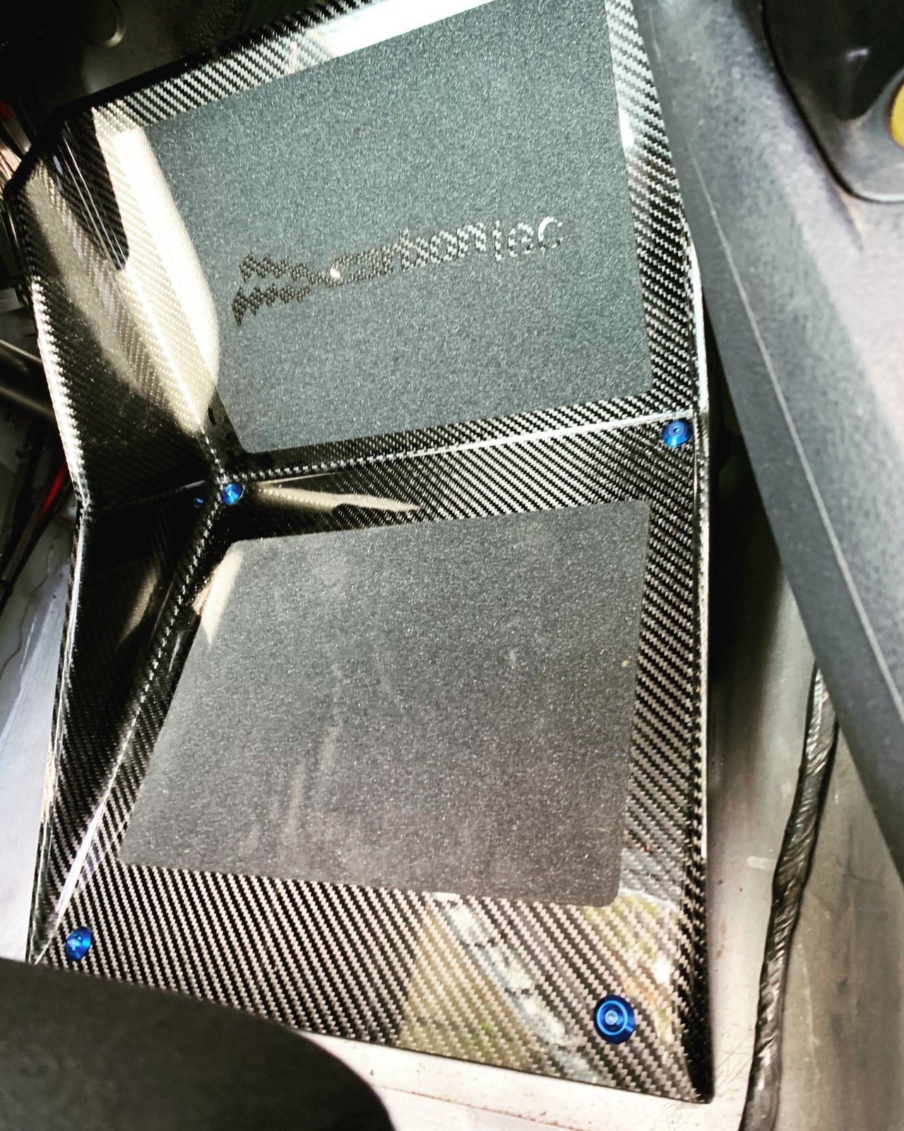

I picked up my Carbon- Tec footplates big thanks to @John Lindsay for organsing the GB on them. Really impressed with the quality/ finish, and am looking forward to fitting them in the coming weeks.

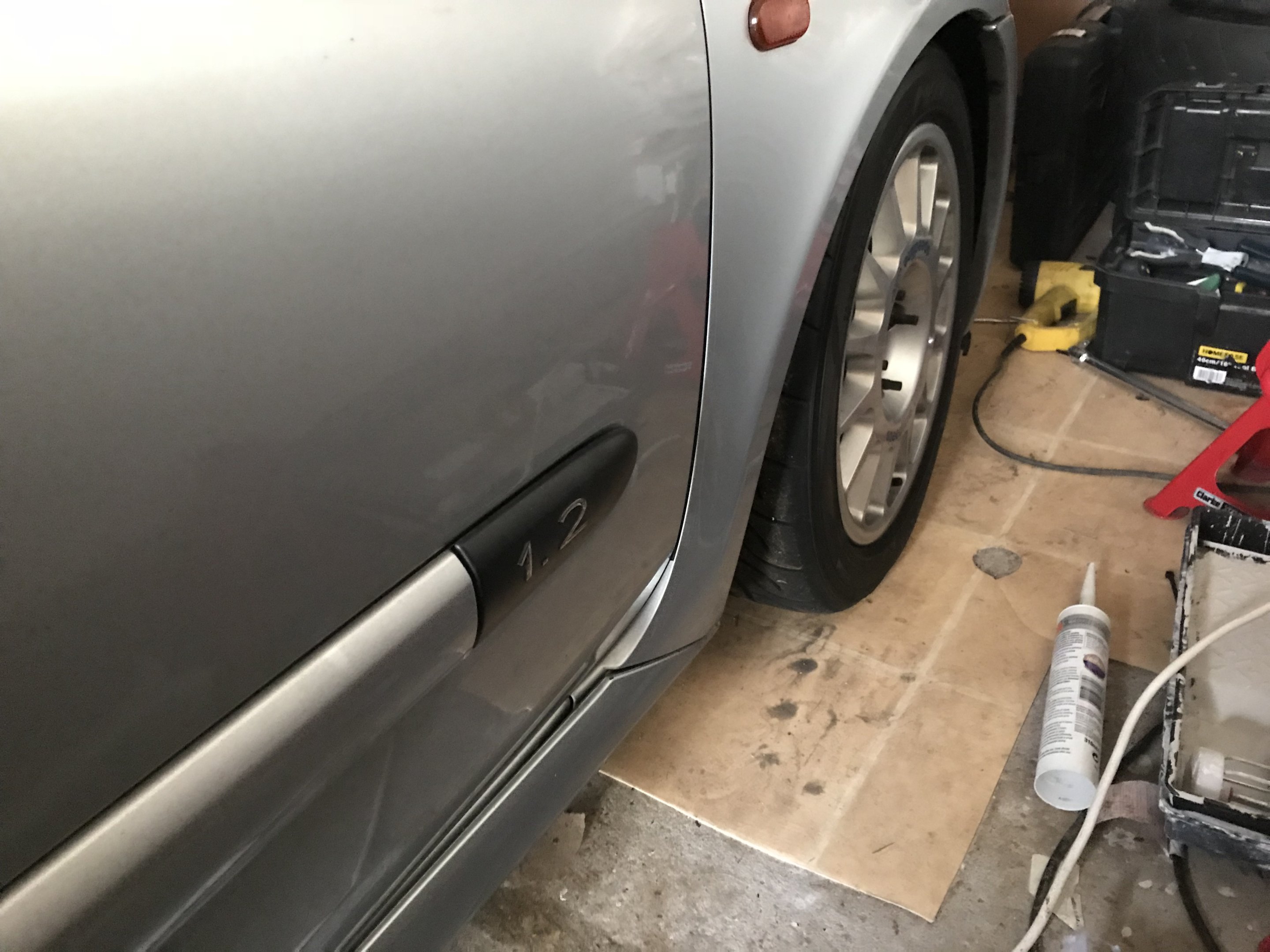

A while back I changed my badges for some 1.2 that I had lying around, as my originals were a right mess, but may well buy a brand new set of 2.0 badges again in the summer.

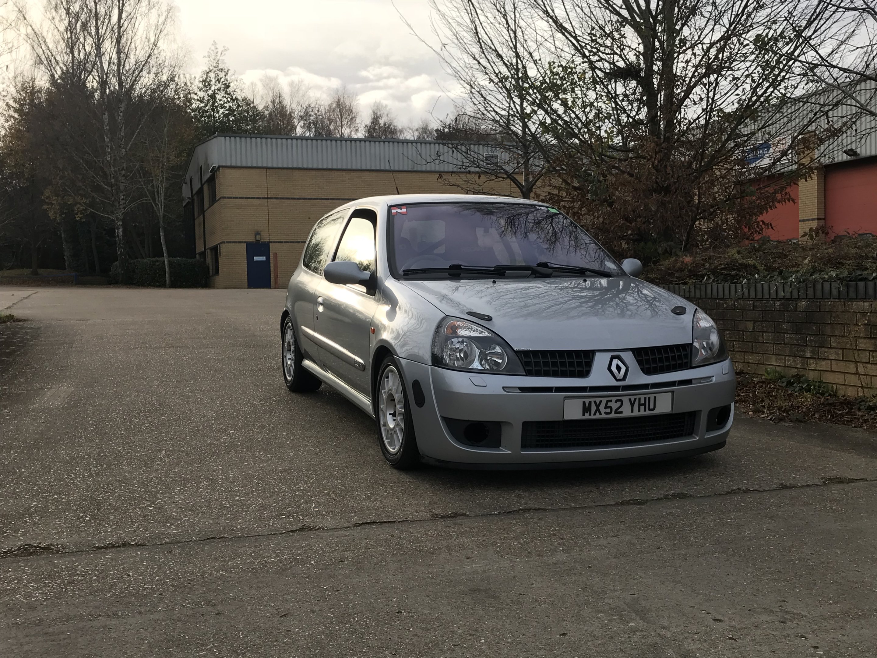

And a picture from the last time I drove the 172, in Feb.

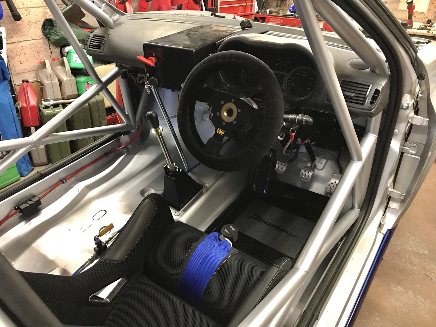

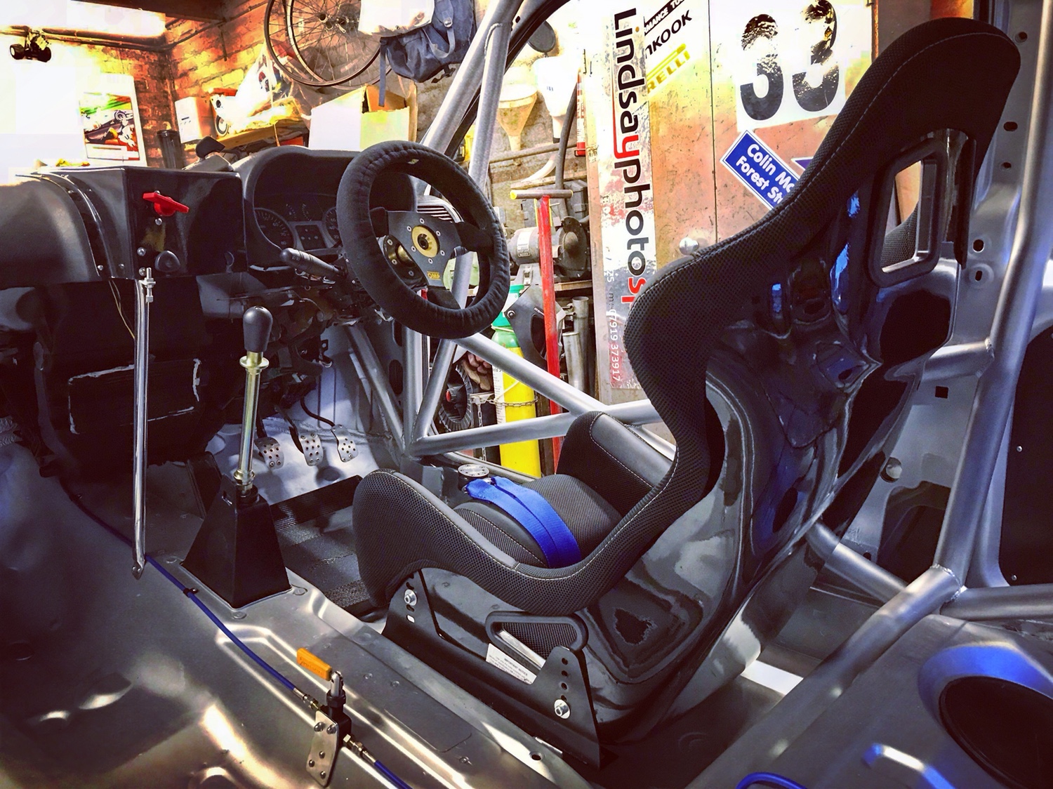

Really liking that @John Lindsay the cage, seat, foot rests etc looks great mate.

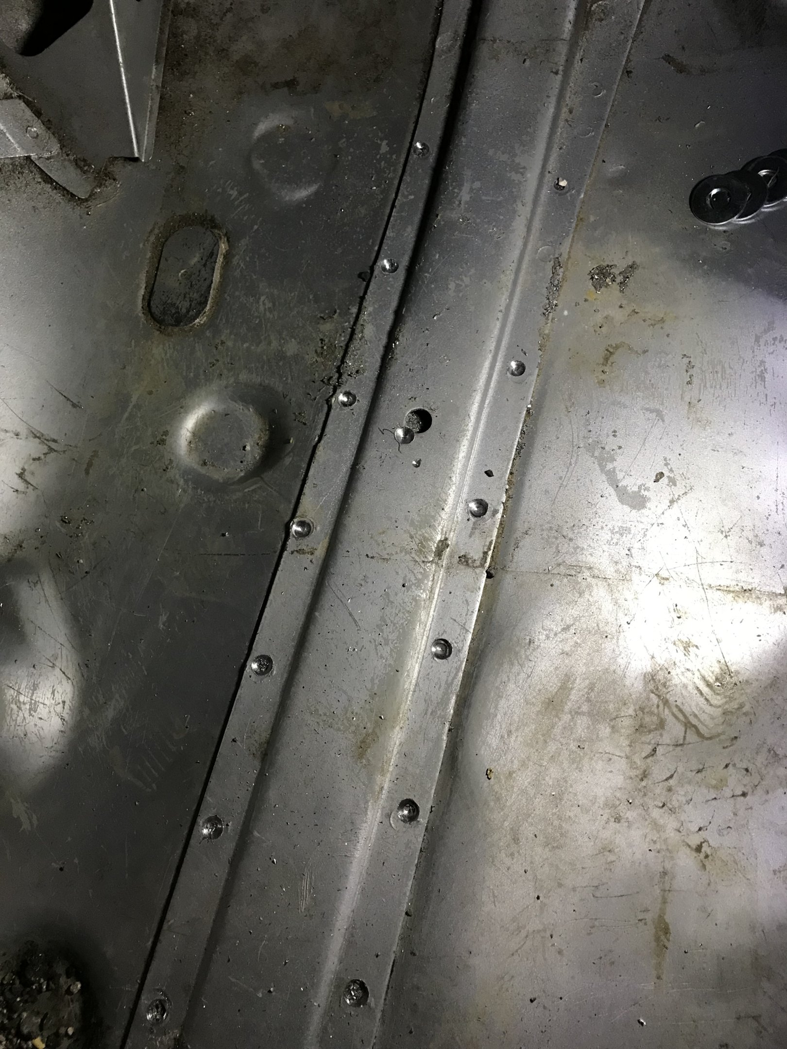

I am just waiting for my spot weld removal kit to arrive, so I can remove the rest of the spot welds on that annoying plate in the drivers footwell, and finally bin it.
They might be all that’s holding your car together the number of times it’s seen a disc cutter and dremel :tonguewink:😂

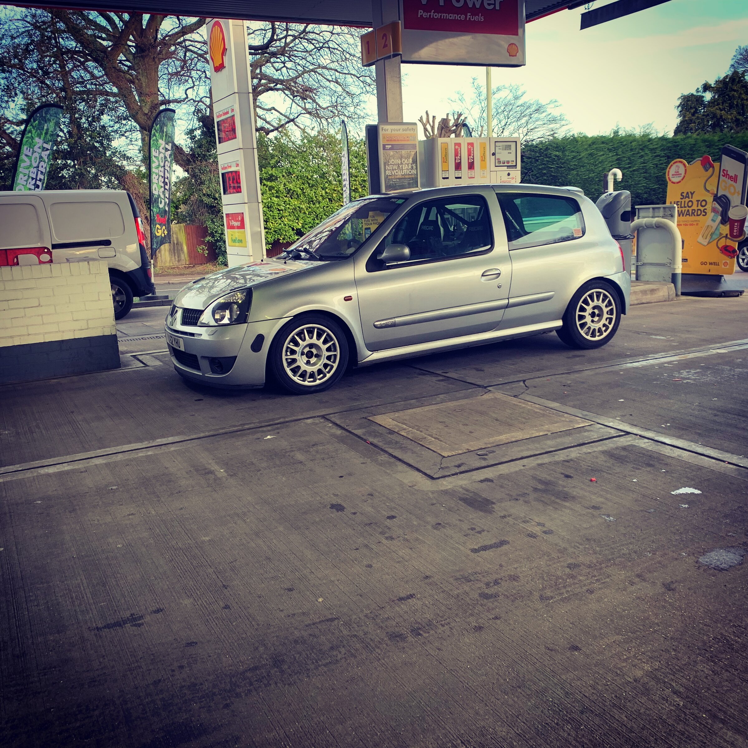

Update:

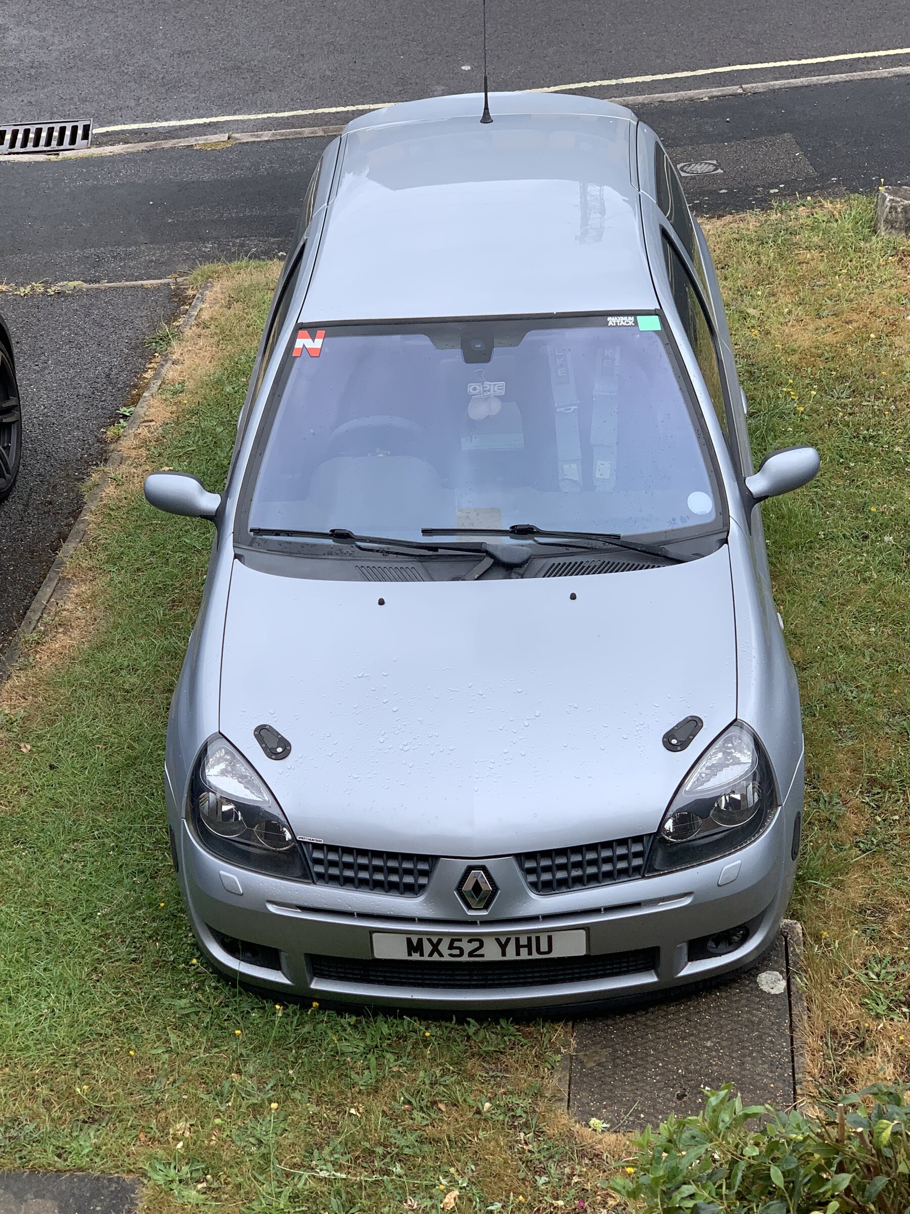

The 172 has just had it’s mot (it passed) it’s running well, but is now overdue a cambelt, so I will get that booked up asap. I really must book up some trackdays for next spring summer 19, as I’ve only done a couple of laps of goodwood with my LSD/ BC DR coilover set up. Pic from this morning, she’s just about to tick over 160k too.

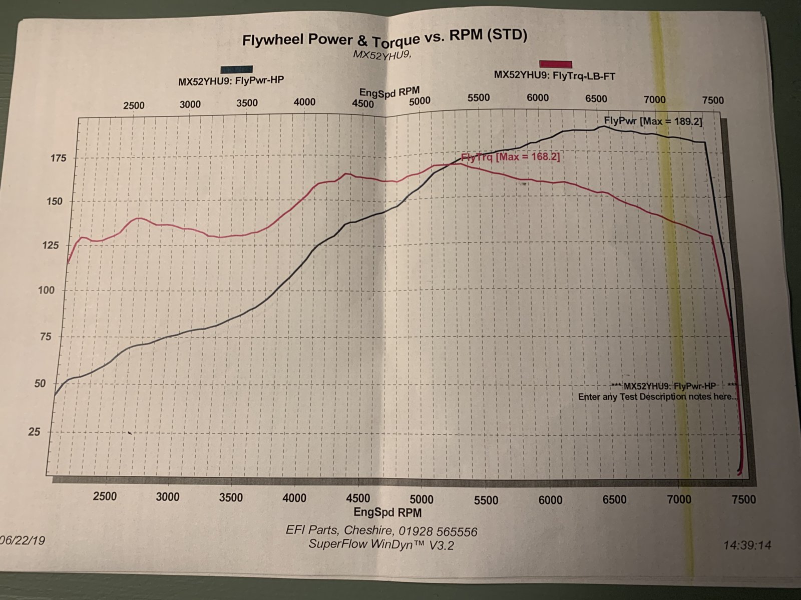

I’ve only gone on one ‘proper drive’ on my favourite roads so far (looking forward to getting it out on track) but very impressed. The added torque is really improved the drivability, I am not sure how much is from the 197 cams, or Chris@EFI mapping though. With the 197 cams and EFI live mapping I gained just under 15bhp, so if you’re due a cambelt change it’s a no brainer imo mate.
