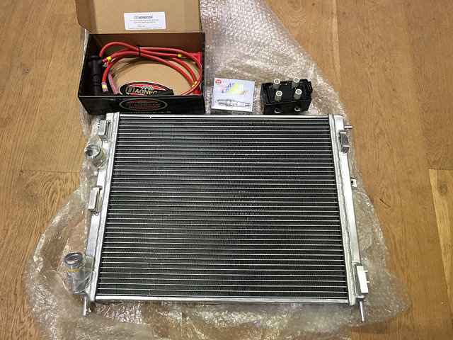

So I have had to address a few issues with the car! The radiator is fine, but it's never been changed and starting to 'bulge' and the fins look a mess, not the best for a thousand + miles across Europe. I have replaced it with a Direnza radiator, spark plugs are overdue a change too, so I have replacement NGK OEM plugs. I have also bought a set of Magnecor 8.5mm ignition leads and OEM coil pack.

That's the last place you want to be breaking down at this moment in time! Lol!Knowsit Mark, I had visions of the radiator giving up/ failing as we go through Brussels lol.
Where did you get the radiator from bud?
It looks decent, and much like your's was. My original radiator has certainly seen better days!
Does the cooling fan bolt up the same?

I have the same rad. It's a really good item.
I can't remember now. Think mine had fitting locations for the standard fan.How have you mounted your fan Iain?
I just used those foam pads with plastic ties that go through the core..How have you mounted your fan Iain?
