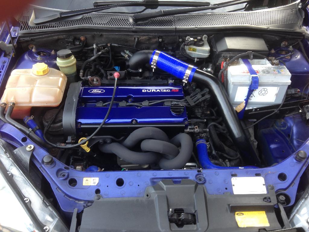

Gave the manifold a bit of paint, makes everything look so much tidier.

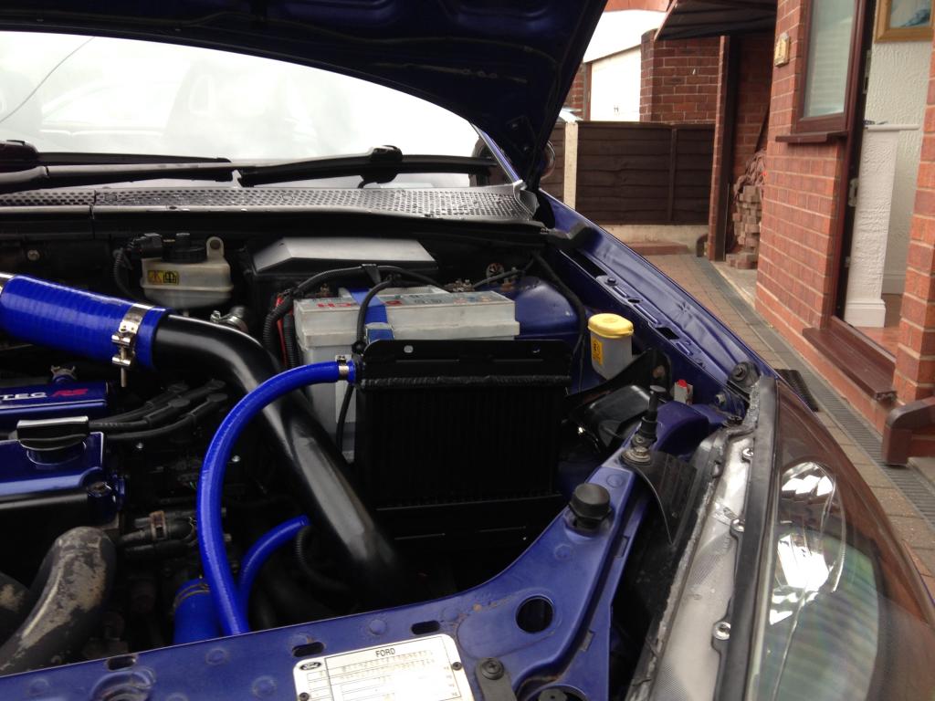

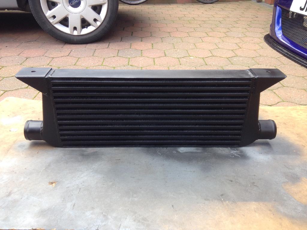

Decided to spray my FMIC black, I've always wanted to do it but was a little worried about it effecting the cooling properties of the intercooler, guess time will only tell if it does.

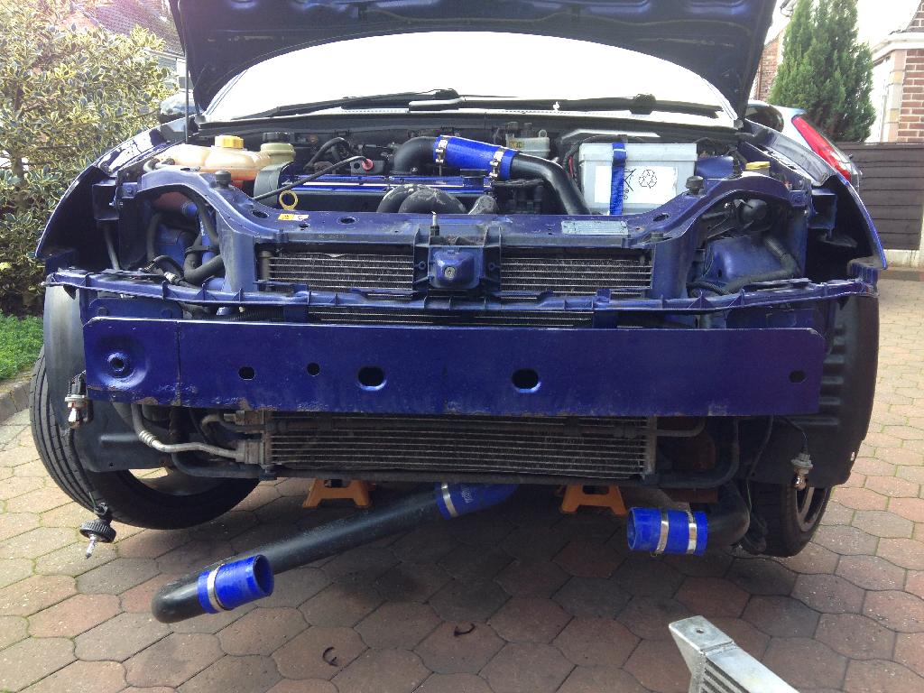

Front bumper and intercooler off again, hate taking the front bumper off as it's a right pain in the arse and fiddly.
Intercooler painted.

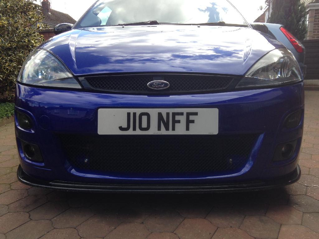

All back together. Looks miles better IMO, due to the size of the void behind the grill and the intercooler not filling it, it kind of made the car look buck toothed lol.

Looks 100x better black and I'm sure that it isn't detrimental to performance either.
Matt Cup
  Iceberg 172 Cup
Yeah if the fins start to get blocked then it's not going to cool as well, but a quick blow over I'm sure will be reet!
Just been out in it and the intercooler appears to be working properly, intake temps are the same as before. Winner!

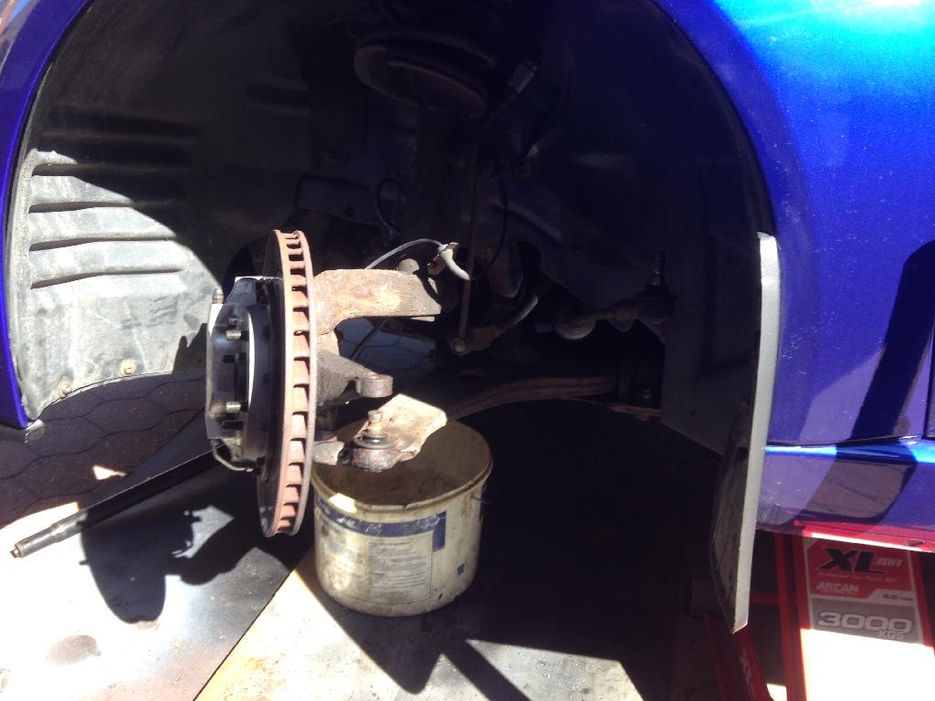

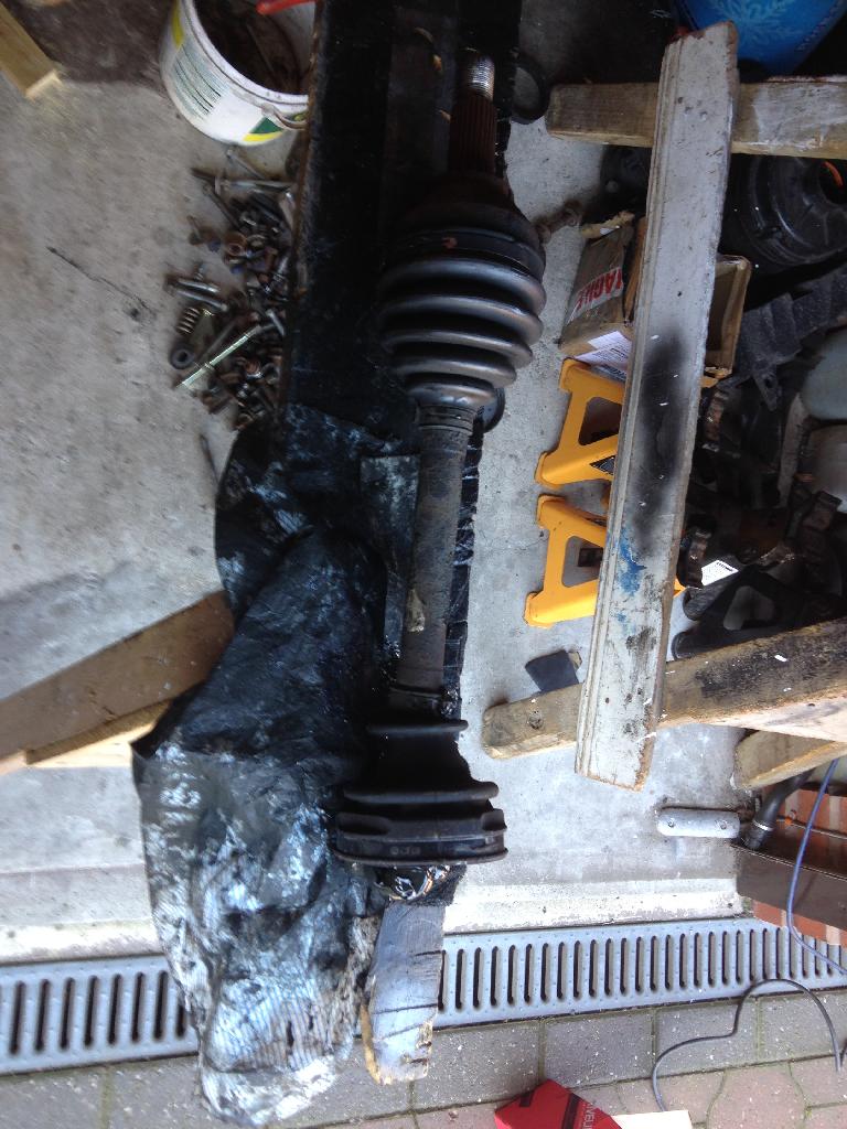

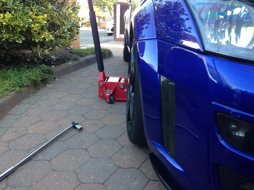

Seeing as we've had exceptionally good weather today I decided to crack on with the next job, split inner CV boots both nearside and offside were split. Noticed these had split a few months ago but as they weren't leaking grease it wasn't an urgent job.
Quite clearly the ball joints or driveshafts have never been removed in the 10 years the car has been on the road as they were a complete pig to remove. Pinch bolts needed drilling out and to remove the ball joint from the hub took a crow bar and my full weight on it to get them to split. Removing the driveshafts from the hubs took a lot of effort but after much swearing and perseverance I finally had the driveshafts out.
Next up was to remove the snap ring holding the CV joint together, then split the CV joint so I could remove the old boot and fit the new one. I'd got side tracked by this point and completely forgot to take any more pictures.
Car is now all back together, took longer to do than it should have really due to the problems encountered but it's a job I'm glad is out of the way.

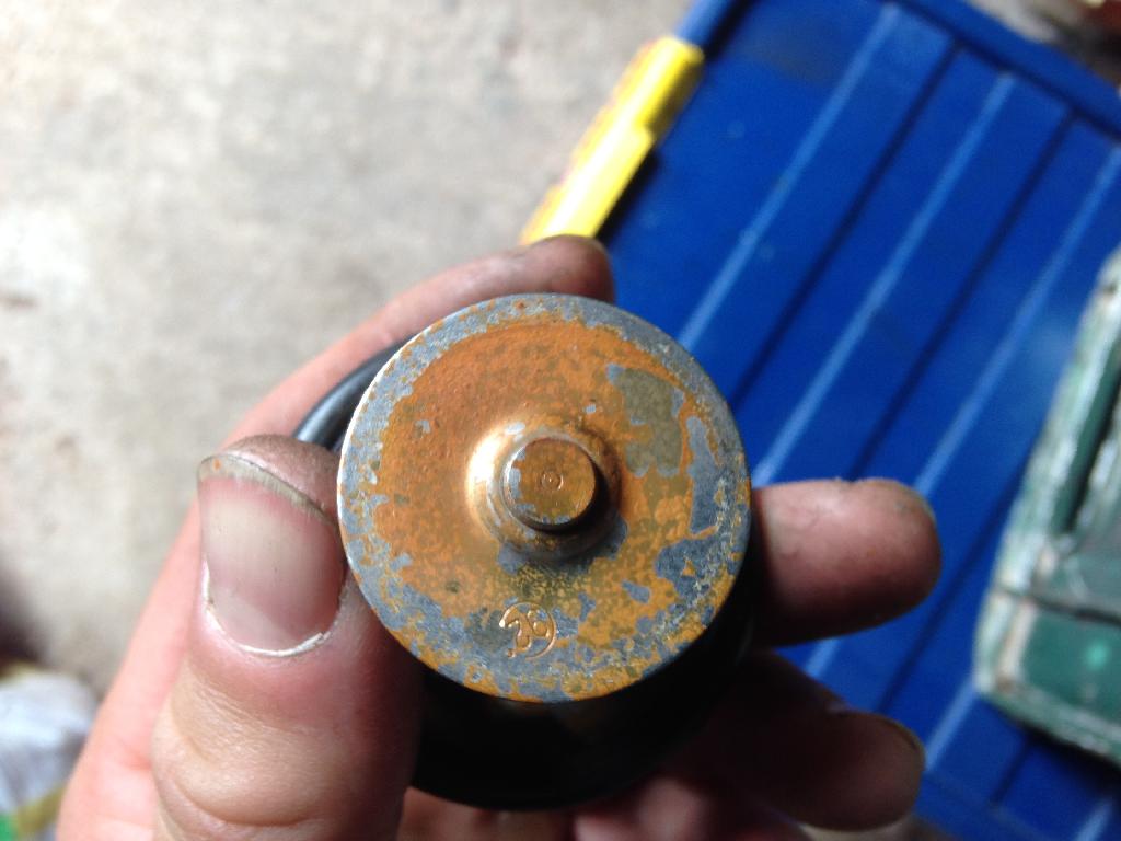

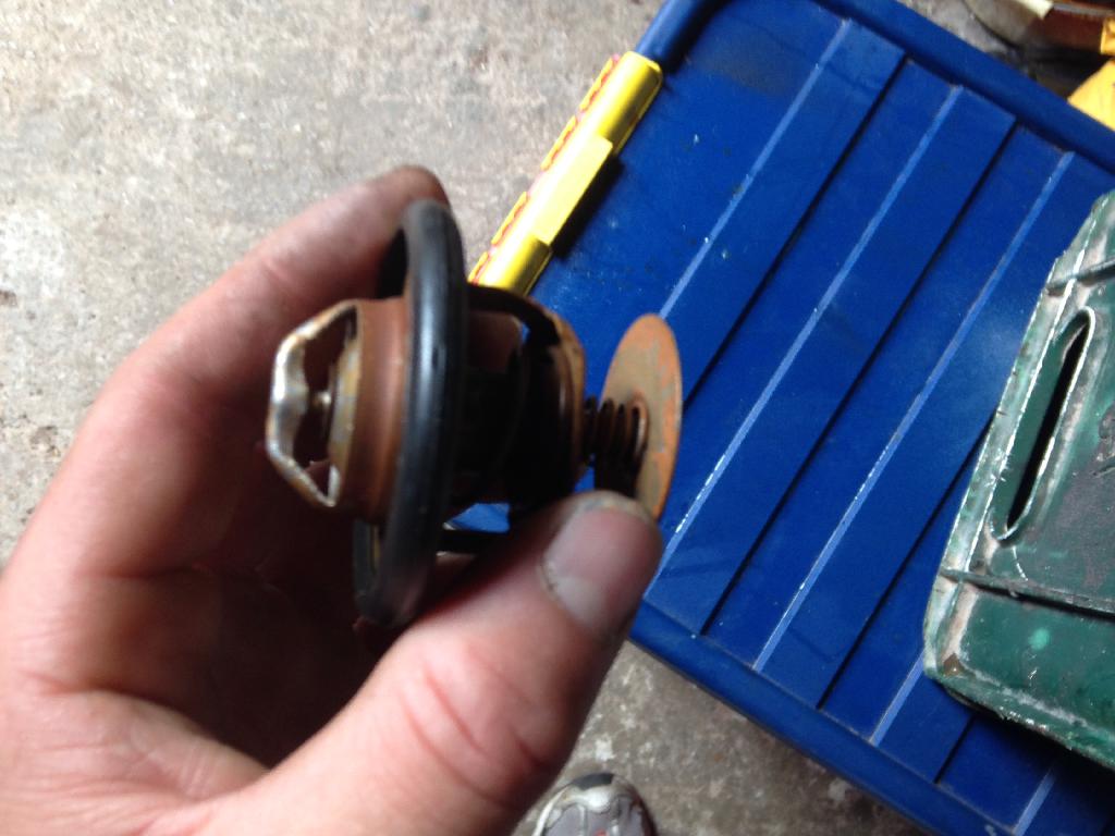

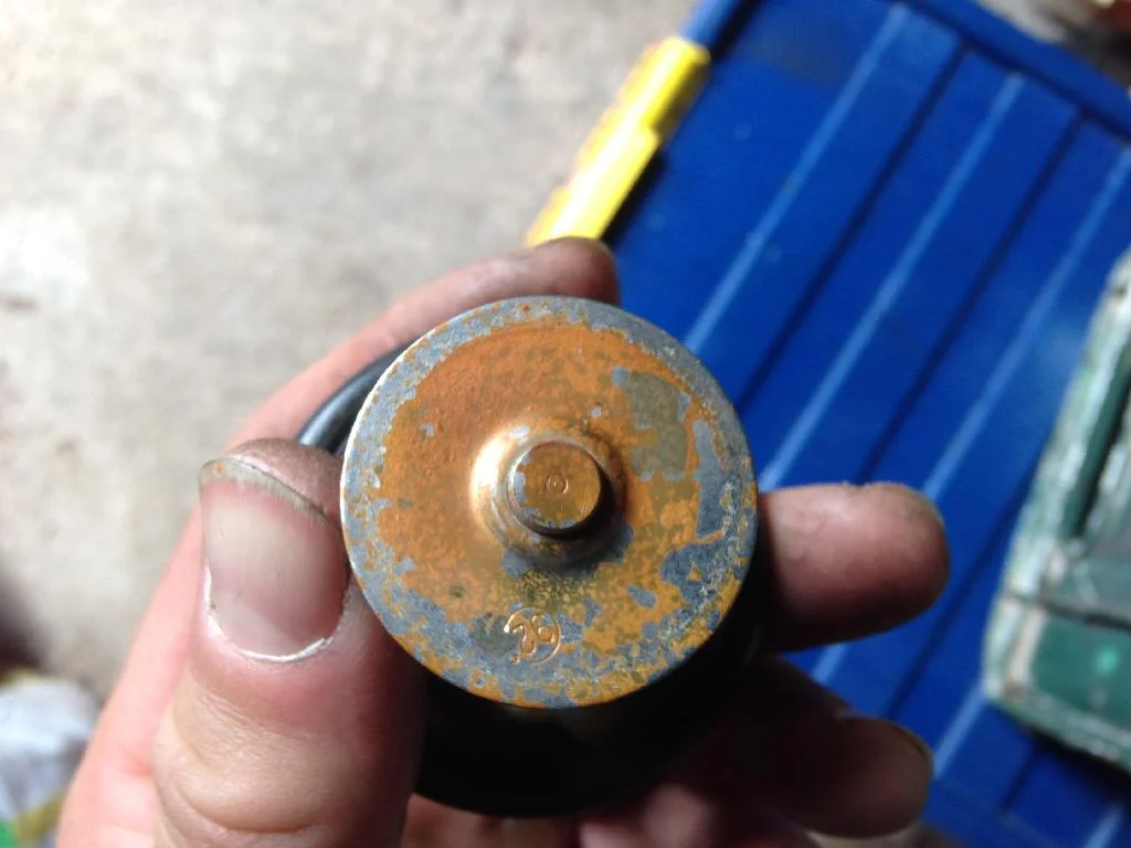

I was having a few issues with the coolant temps getting a little high since the weather has warmed up lately, nothing that would damage the engine but higher than I'm comfortable with. Decided to change the 92degree thermostat for an 88degree thermostat.
Old stat out

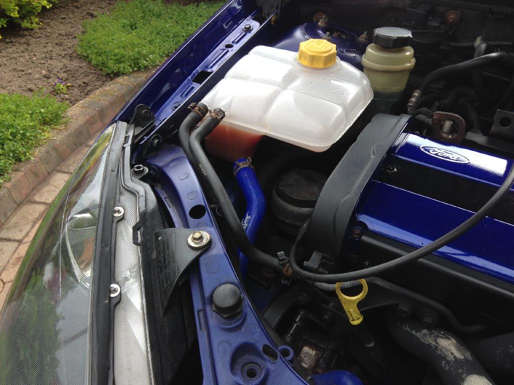

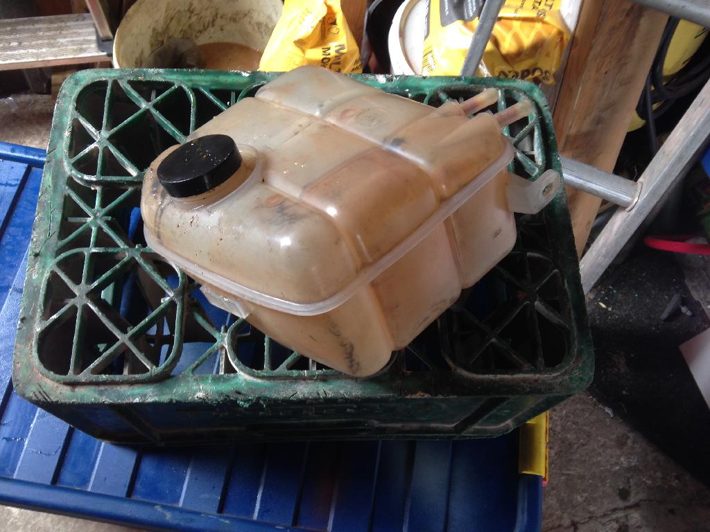

I've also replaced the old coolant header tank as I found a slight weep on one of the outlets.
Old coolant header tank
New coolant header tank fitted.
I also flushed the old coolant out and refilled with new. Car is running cooler now but I just think it's down to the warmer weather temps mixed with the fact these Zetec engines run pretty hot.

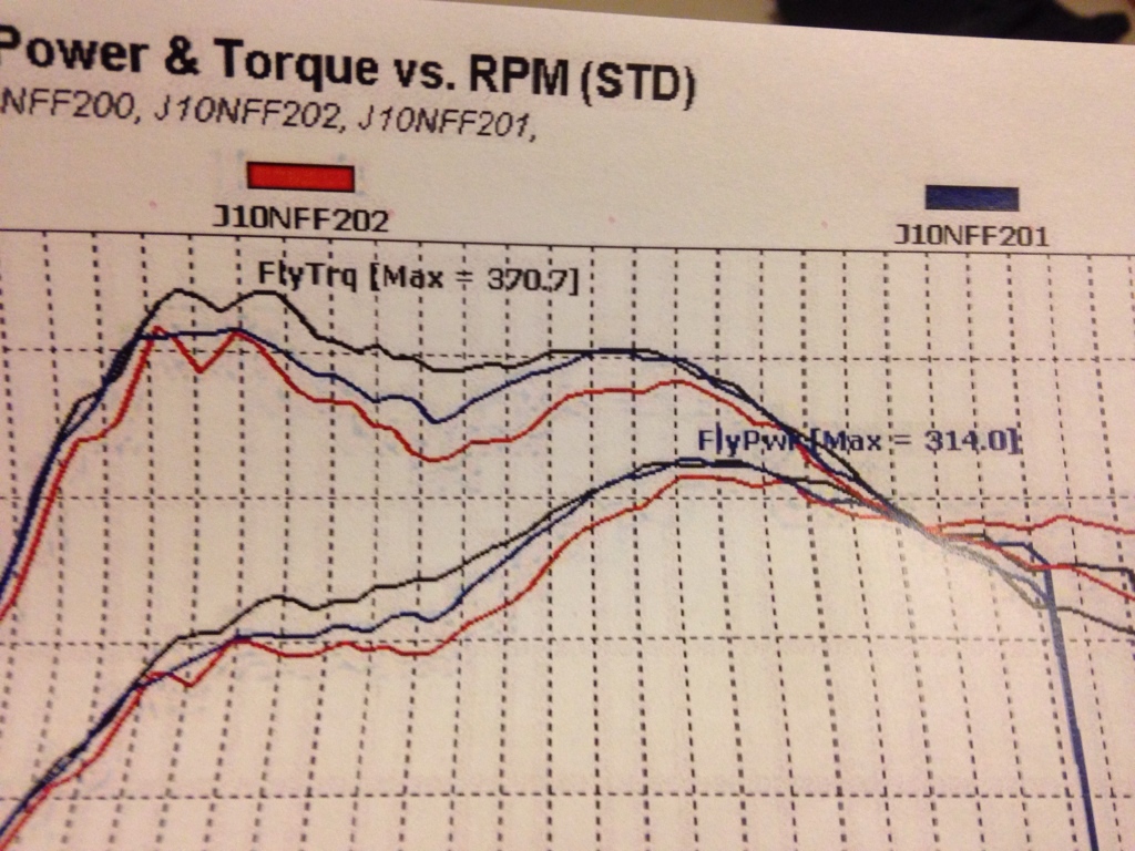

Results from EFI yesterday
I've lost 6bhp peak but gained 47lbs ft of torque and it peaks much earlier in the rev range. The car is much quicker across the ground in it's current form.

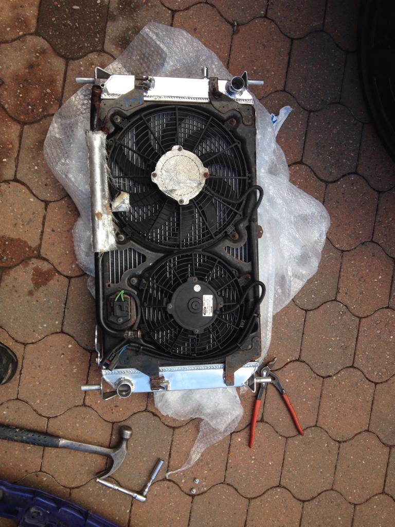

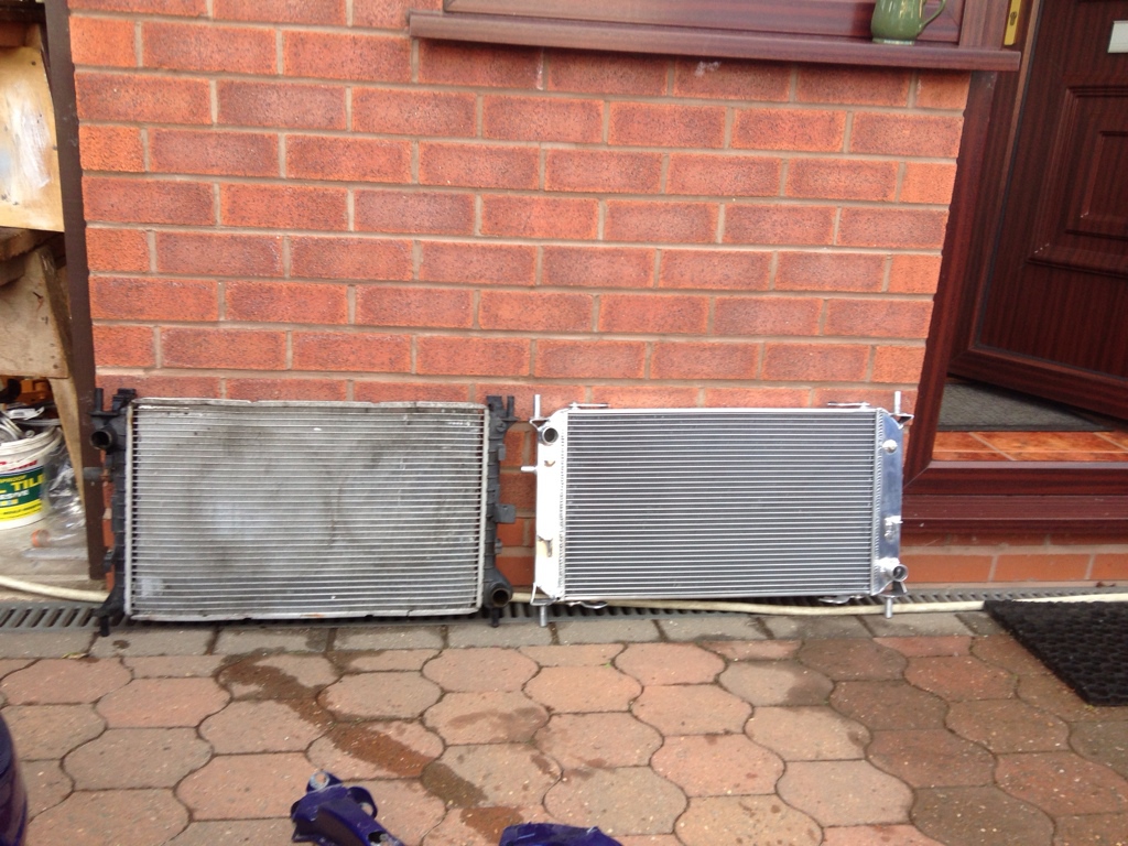

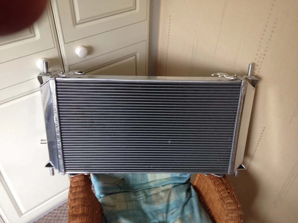

This arrived yesterday

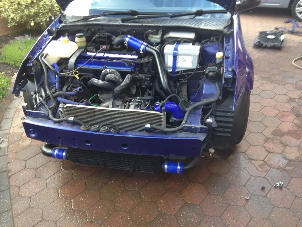

So once again I had to dismantle the front end
Only 30+ bolts and nuts to remove to get it to this stage lol.

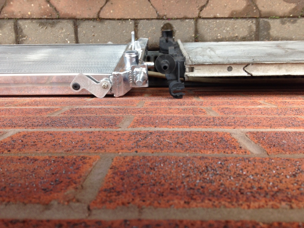

Couple of old vs new pics showing the core size difference
Then I had to mount the fan housing to the new rad
Took a bit of drilling and jigging about to mount it but wasn't anything too difficult.

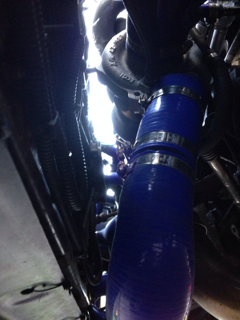

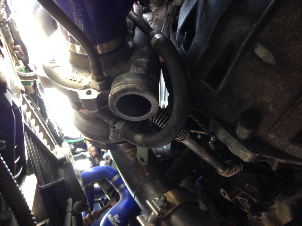

Next up was to spin the turbo housing back, due the thicker rad it was fouling on the rad.
Intake pipe removed had turbo housing span back
Intake pipe refitted and a lot more room between it and the rad.

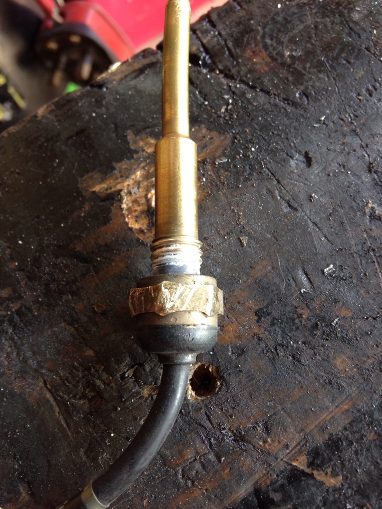

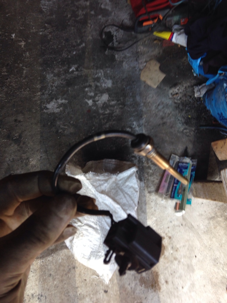

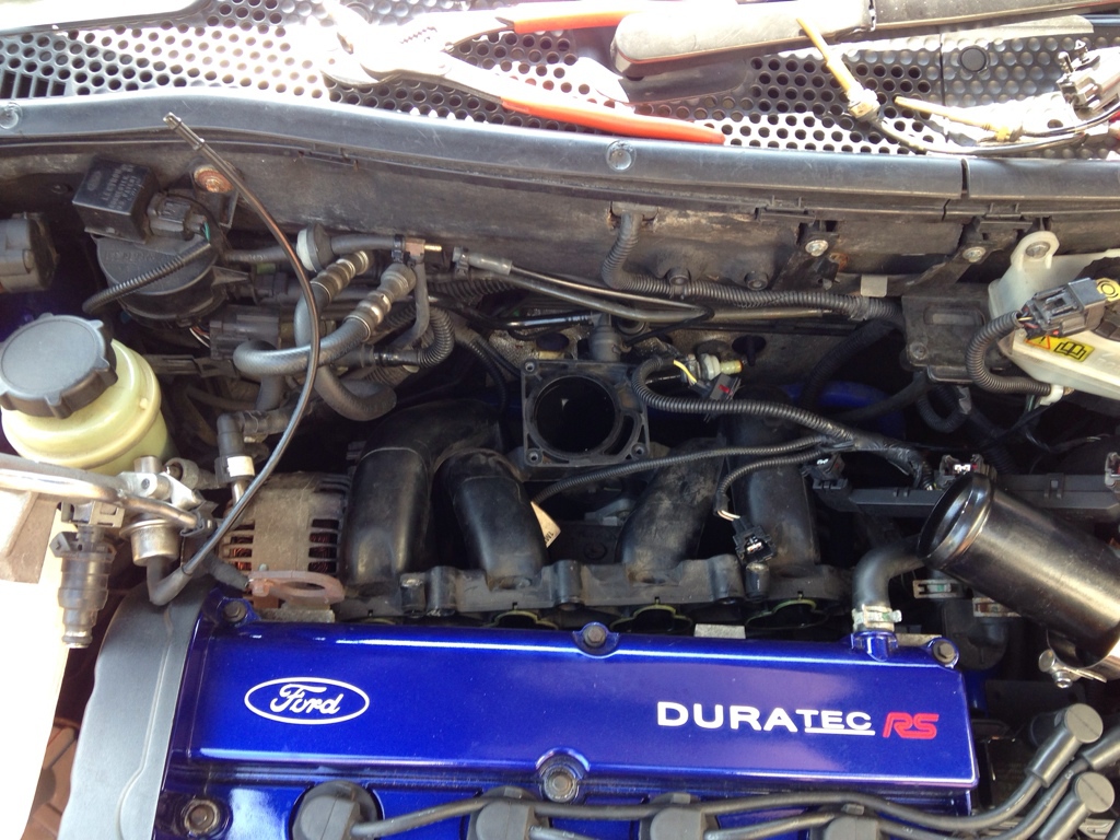

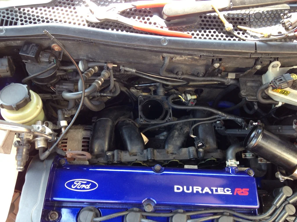

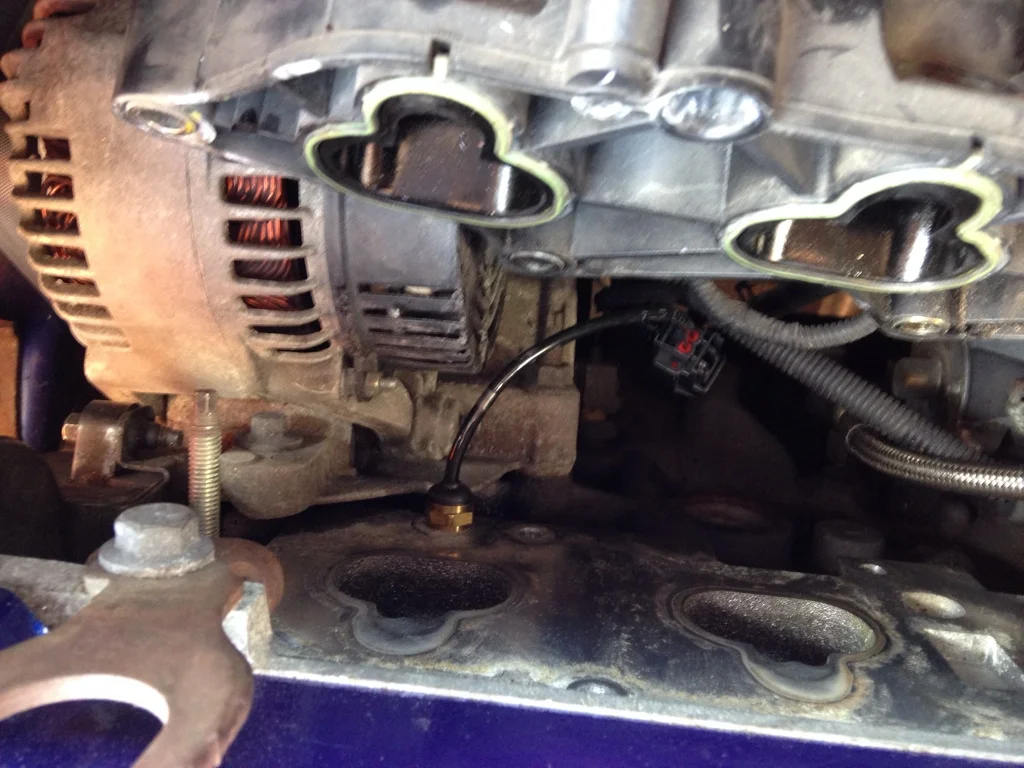

Next up Cylinder Head Temp sensor. Been getting a few strange readings from the scangauge so the sensor was the 1st thing to change.
Bit of a pig this job as the sensor is located in the back of the head under the inlets and infront of the alternator.
1st removal of the inlets.
Then removal of the sensor.
Someone clearly has had ago at it before as it was nicely chewed up making it a b**ch to remove
New sensor fitted
Car is all back together now and I'll see if it's made a difference to the readings later on

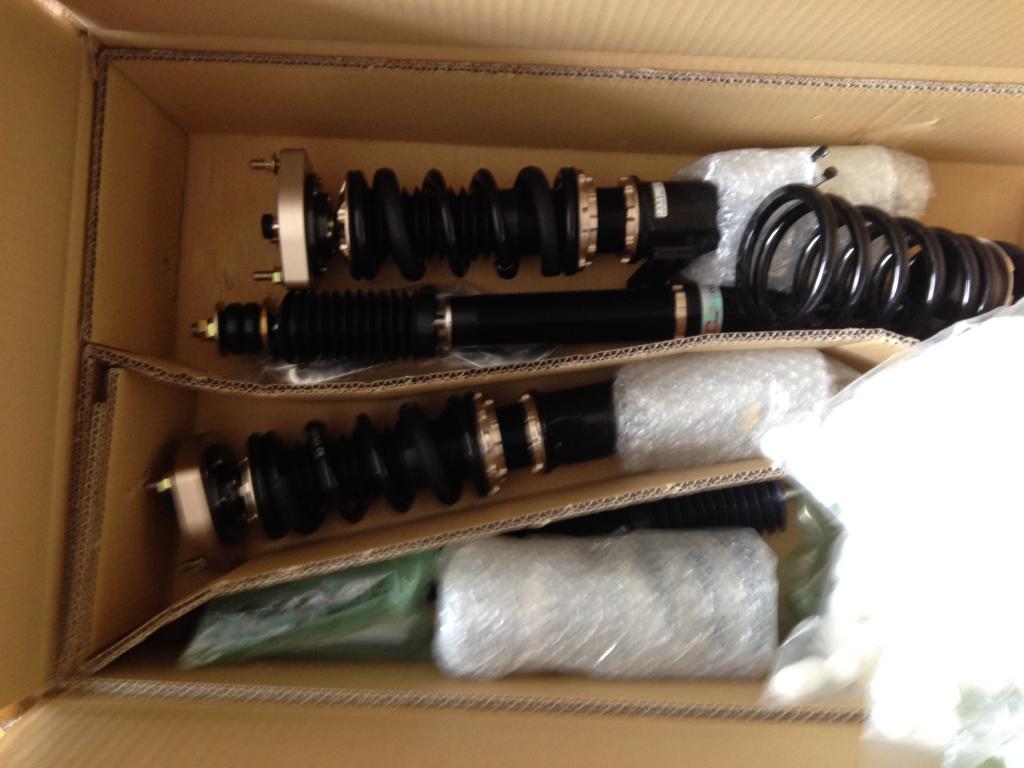

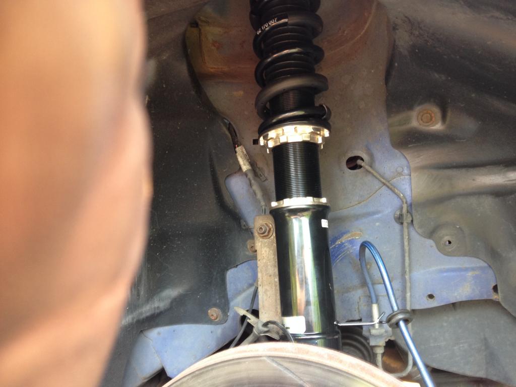

Been a while since an update but I've now replaced the worn out suspension which I managed to trash on track with some BC coilovers.
A very good set up for the money IMO, fully adjustable (height and damping stiffness) come with solid top mounts with camber adjustment too. I've replaced the track rod ends and and front drop links too as the nearside one was completely shot and was causing knocking. It's roughly 10mm lower than it was previously, I'll get some photos of the new height at somepoint.
