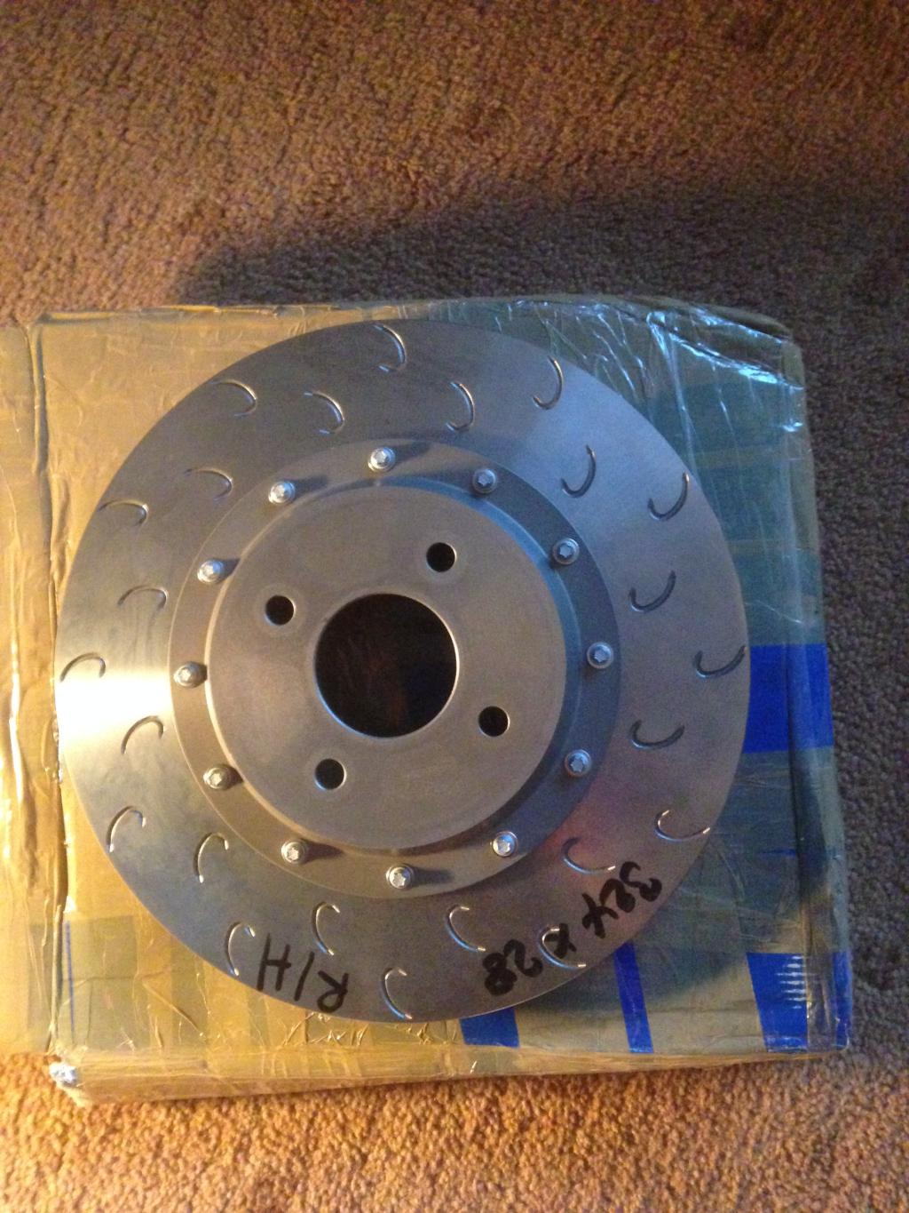

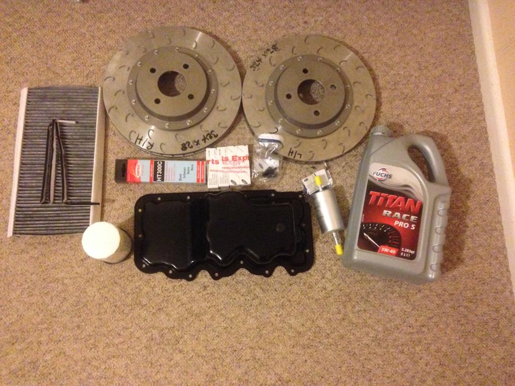

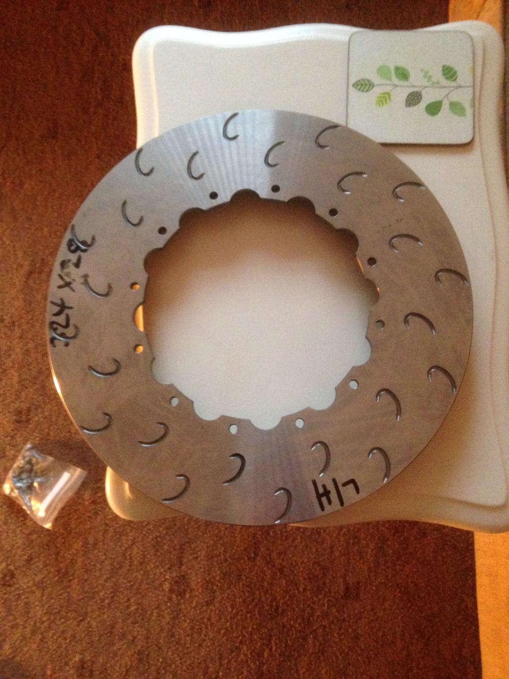

So with that in mind I gave it it's annual service, while I was at it I decided to tackle the leaky oil sump too, rather than reuse the old rusty sump I just went a head and bought a brand new one. Also decided to upgrade back to two piece brake discs again as well.
Discs as they came, only needed the discs as I had the bells from the previous 2 piece discs that were on the car

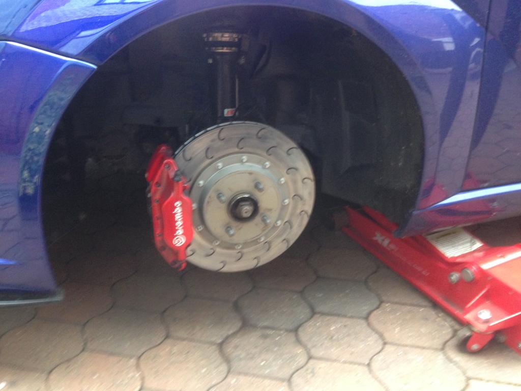

and assembled

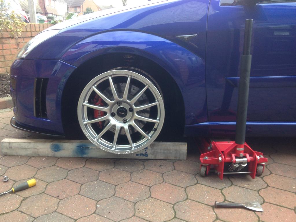

and fitted to the car.

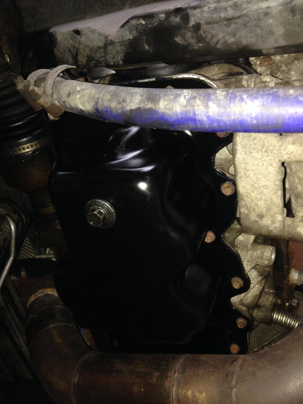

Sump was fairly easy to do, bit messy cleaning all the old sealant off but apart from that it went on without much incident. Although I hate using sealant on oil sumps, hear many horror stories of too much sealant being used, it dries and breaks off and falls in to the oil inside, then the oil pick up pipe sucks it up and becomes blocked thus causing oil starvation.
Sump fitted
No more burning smell from the oil dripping on to the down pipe. lol

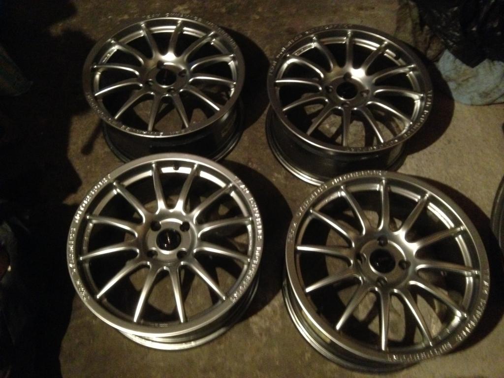

With the semi slick tyre idea in mind I picked up a set of Pro Race 1.2s in 18s for £250, absolute bargain cos they're in mint condition bar one scuff
Plan was to use them as my track wheels but after trial fitting them to the car I'm considering using them as my road wheels and using the standard wheels as my track wheels as they're in need of a refurb.
Look much better on the car than I expected.
Rears are as low as they'll go and the front only has 10mm or so left. So the car will be higher, I might polybush my rear beam while I'm at it as the car will need realigning again if I do the springs.
