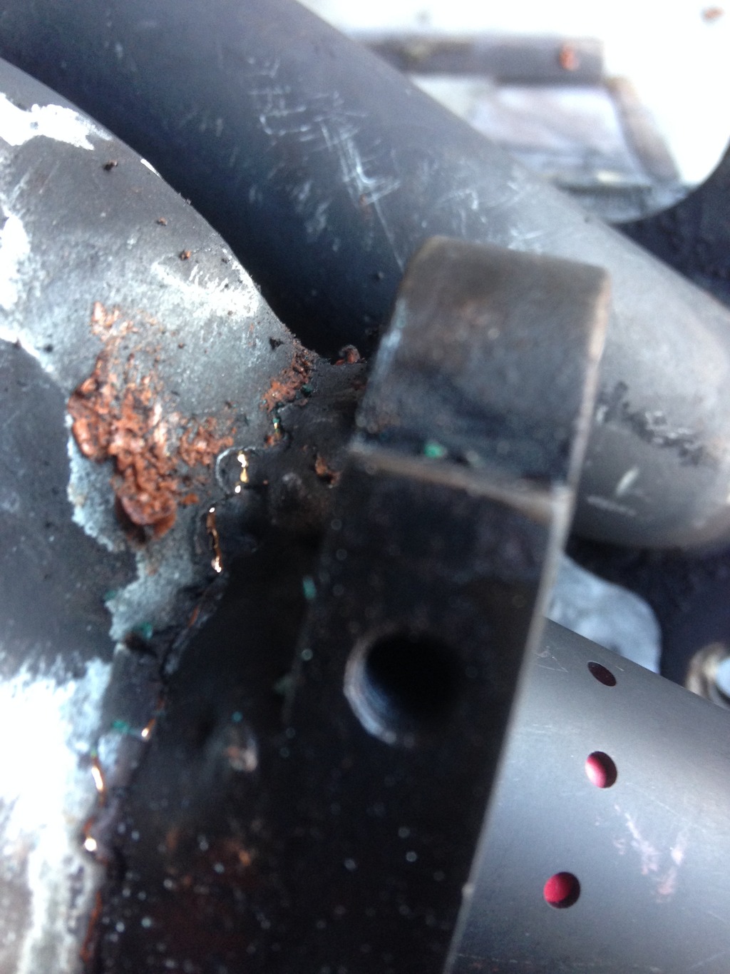

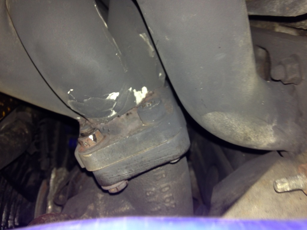

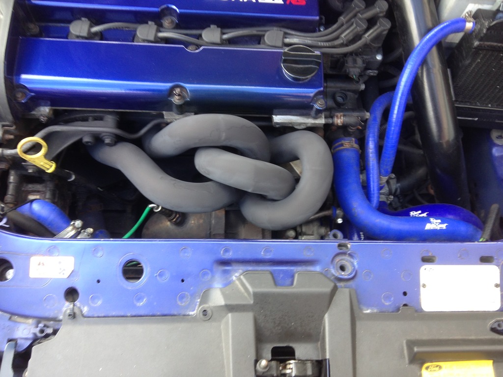

After completing the above jobs I heard an exhaust blowing noise and after chasing it I found it coming from the front. Wasn't sure if the manifold had a crack in it or it was the gasket that sits between the manifold and turbo that had failed.

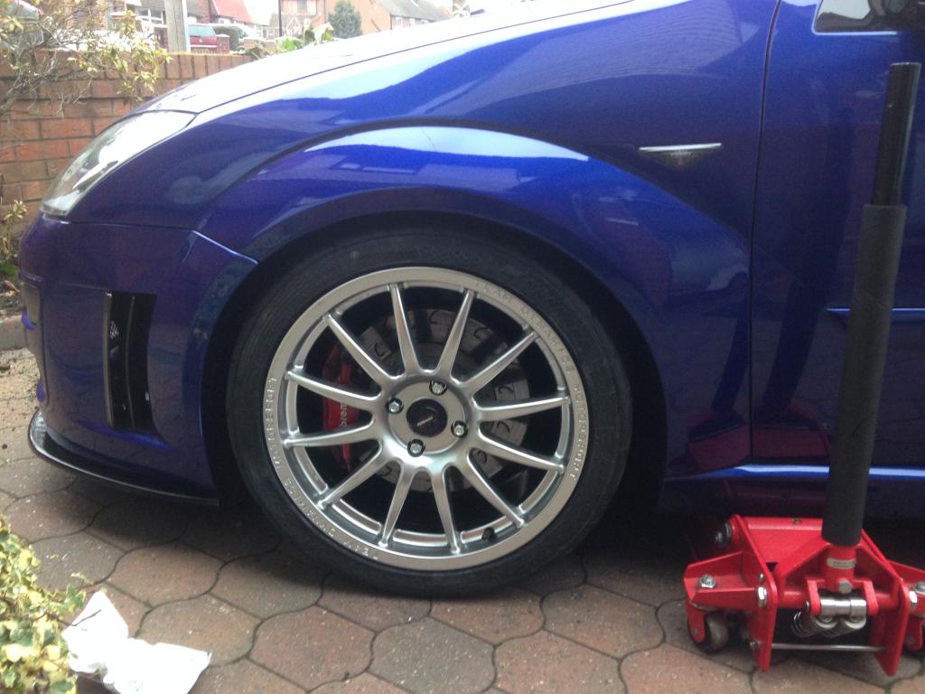

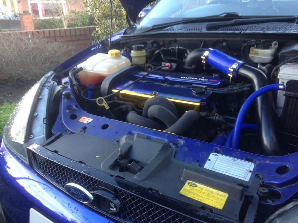

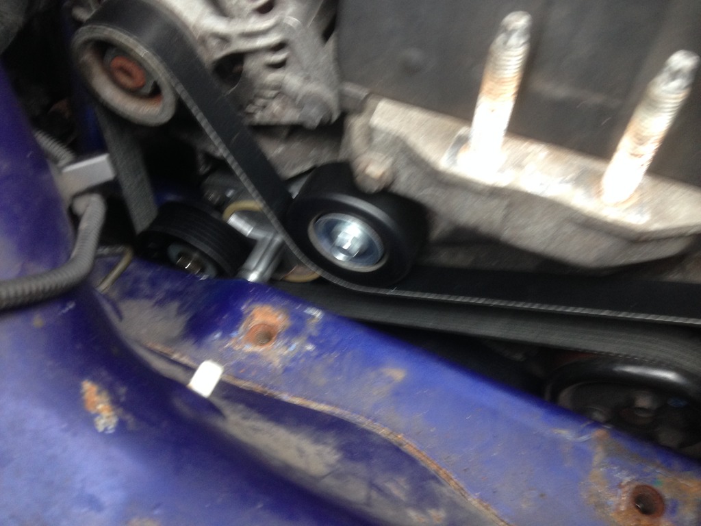

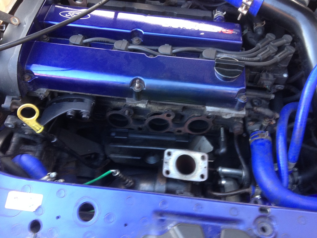

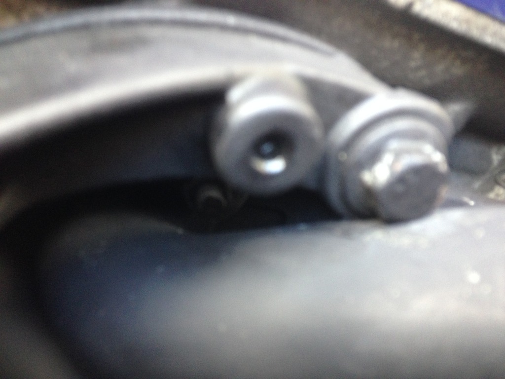

So the manifold had to come off regardless and what a pig of a job lol.  Knew it was going to be fiddly but access to the bolt in the below pictures was near impossible

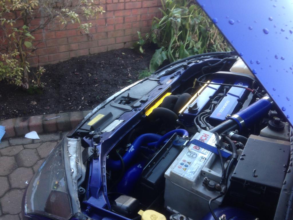

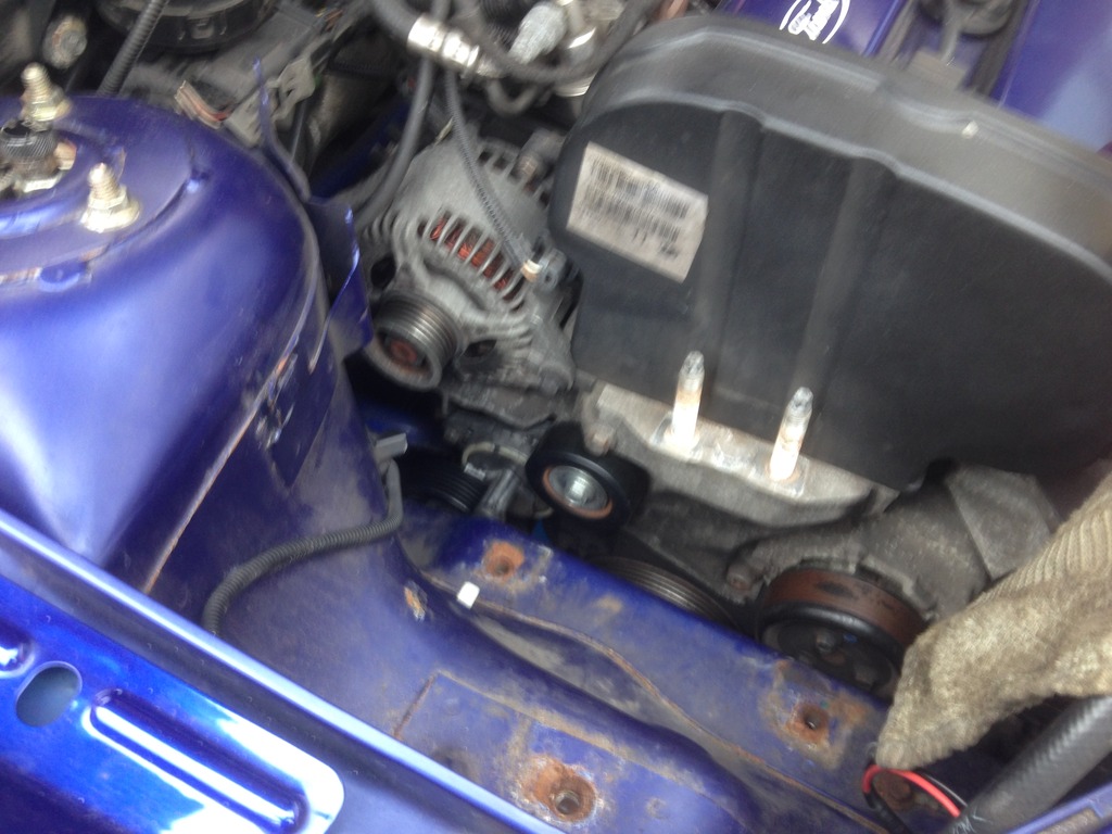

Not the best pic but you can just see a nut and stud sitting between the PAS bracket and manifold.
After what felt like a lifetime I finally got the manifold off
and as I expected, nice big crack in the manifold
Had it welded up and refitted it, refitting was far easier and I had it on in no time, I then repainted it with some FlameProof VHT paint ready to be cured tomorrow morning.
