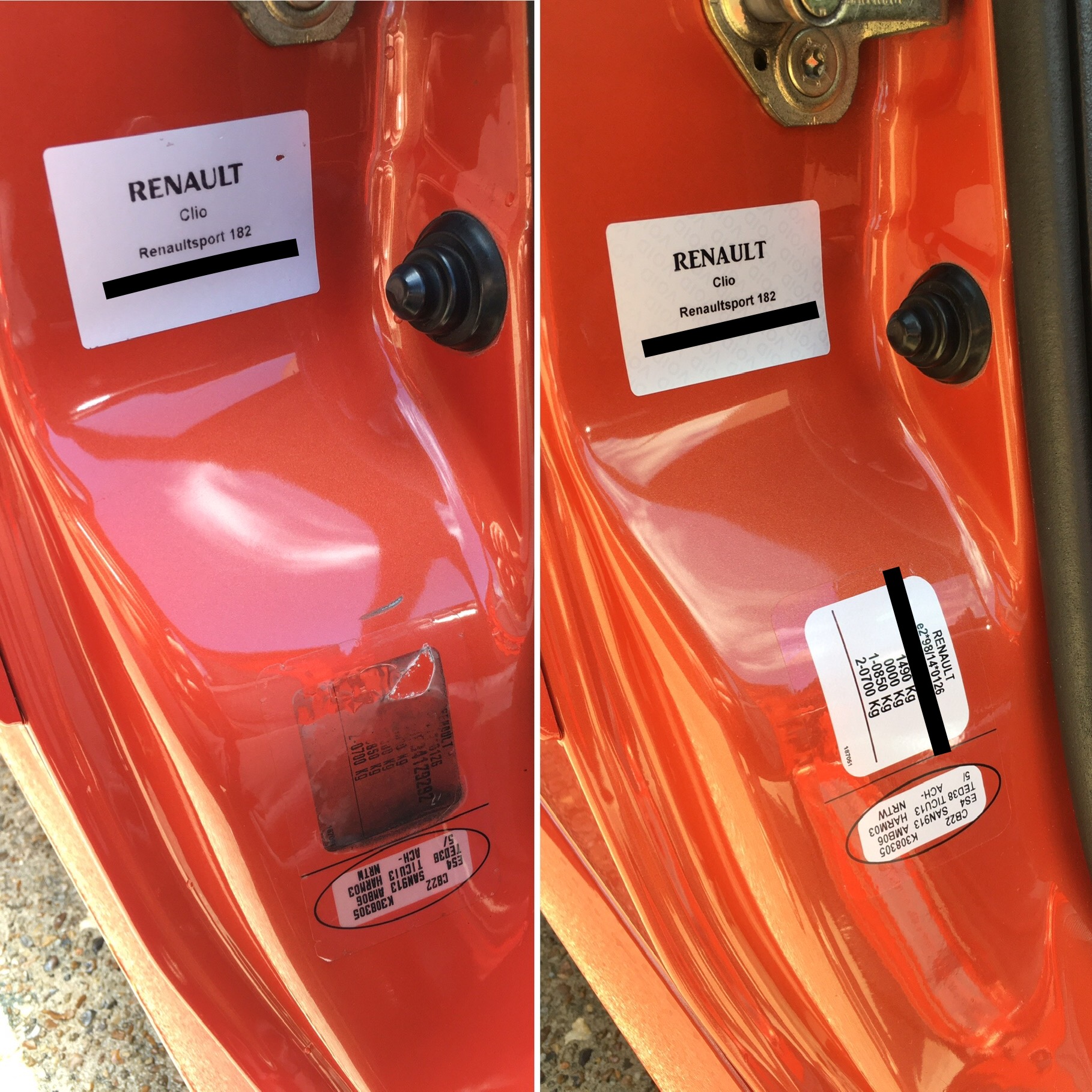

Big shout out to Tony @ VintagsUK for custom making me a pair of new decals. These are absolutely spot on and the silver decal is still an anti tamper VOID when removed.
Some might say expensive for what may be considered as just stickers but well worth replacing the damaged items and getting these details right.

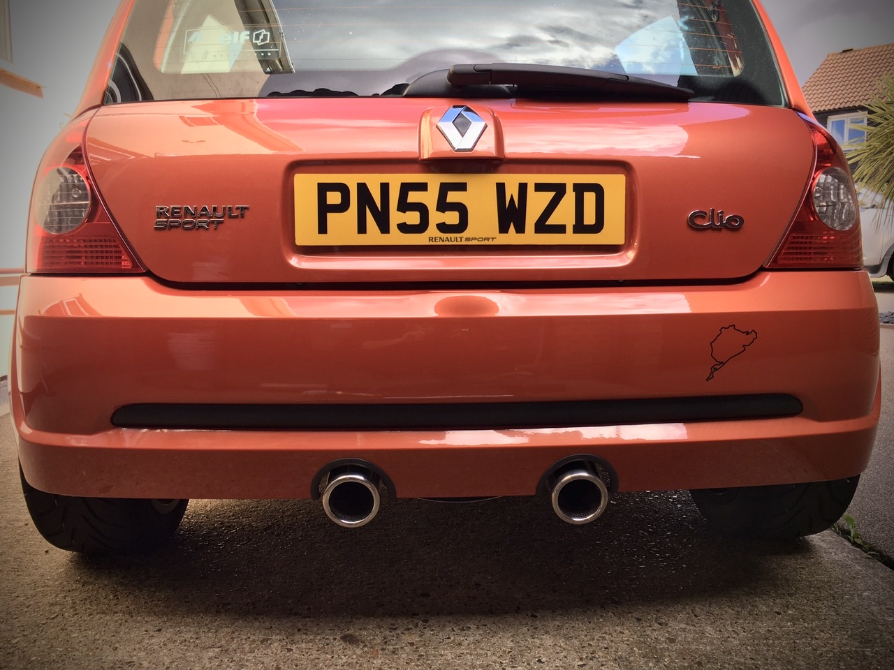

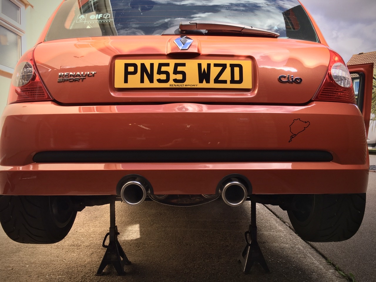

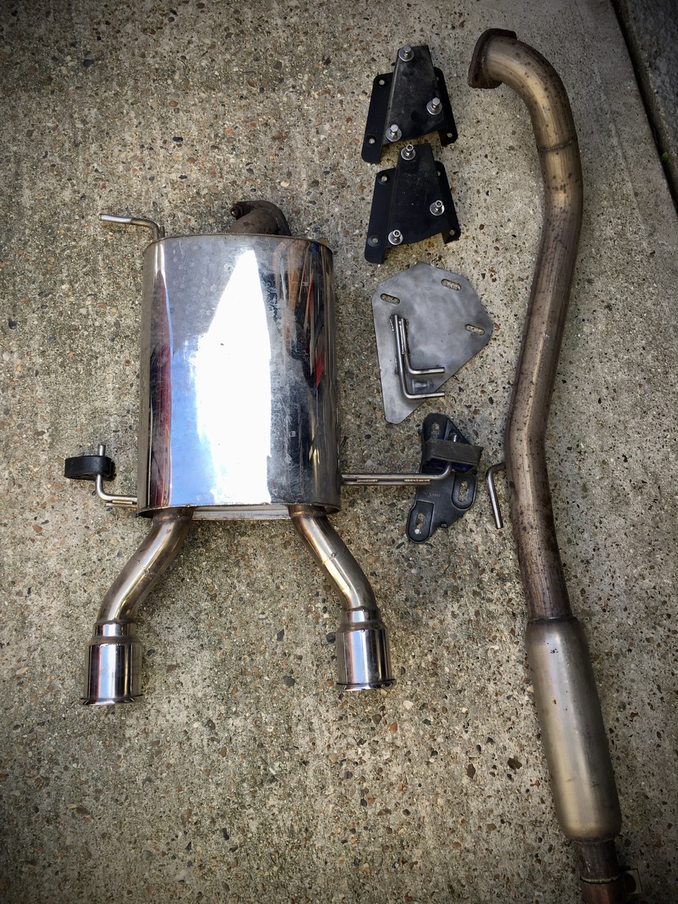

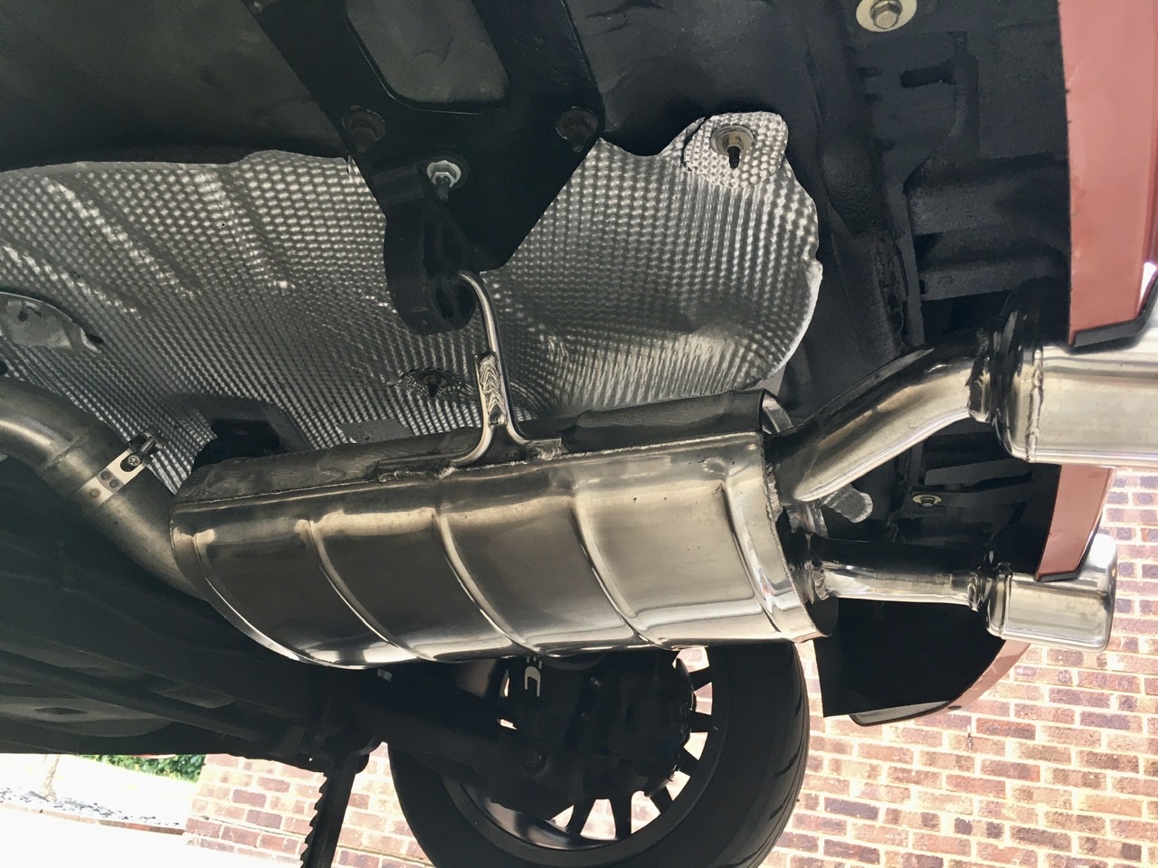

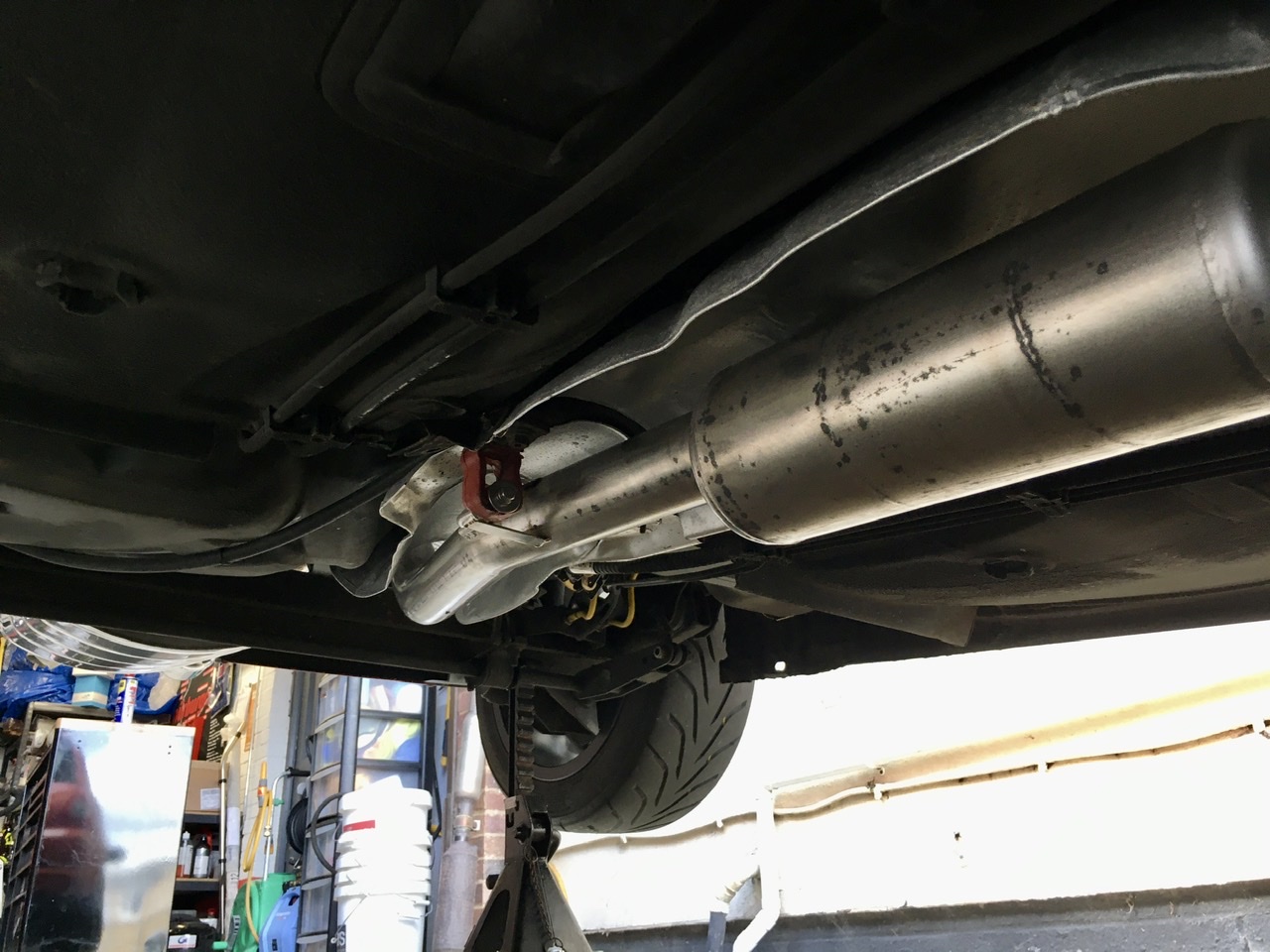

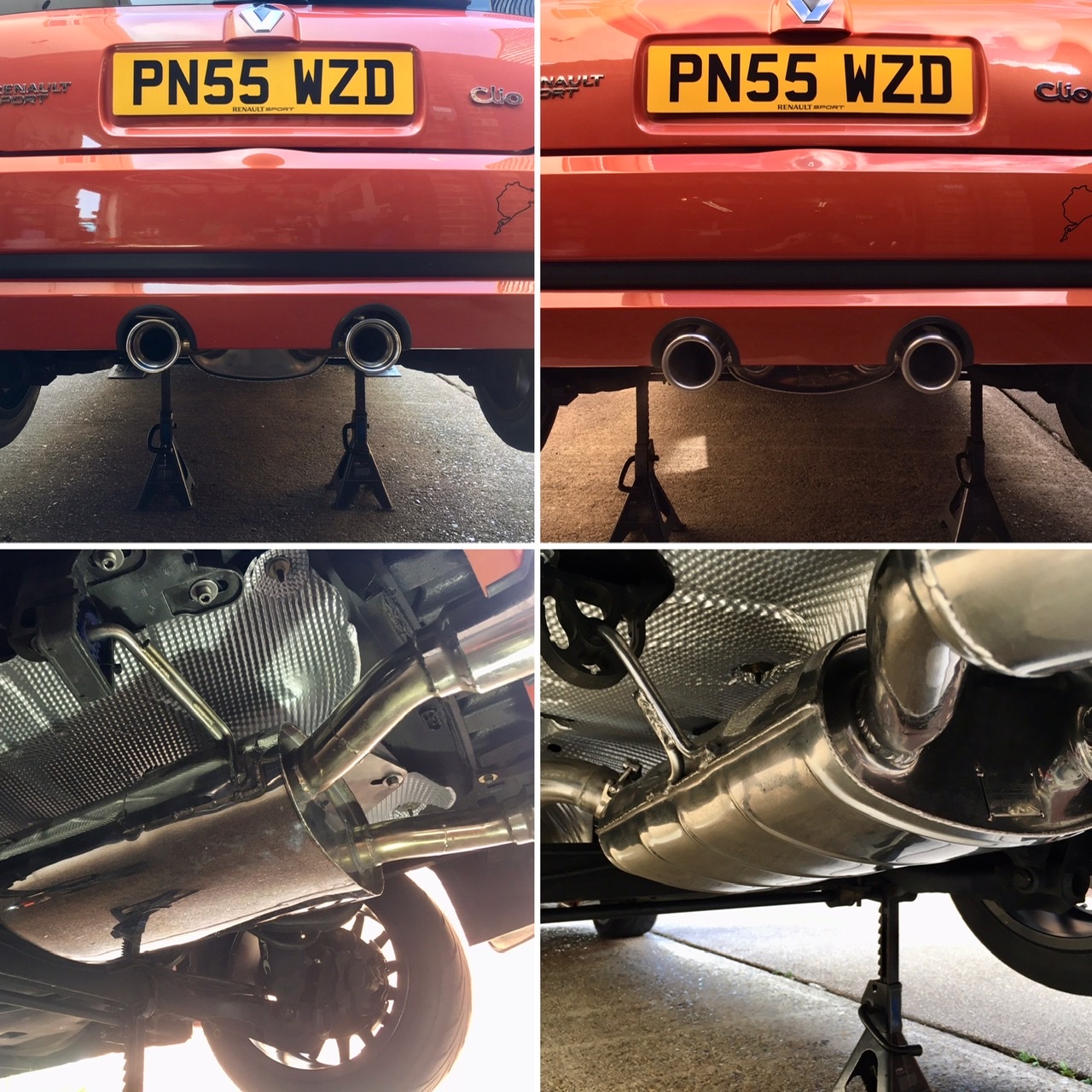

WZD has worn its BTM exhaust system for 8 years, and after removing it this morning, it’s practically as mint now as the day it was fitted.
The BTM has only been removed as I fancy a change and have been intrigued by the hype that’s always surrounded the Orbisoud system. I have to say I’m not a great fan of the inwardly rolled Orbisoud outlets but they may grow on me.
The system fitted up well in no time at all.
BTM removed.
Orbisoud fitted.
BTM left, Orbisoud right.
I prefer the look of the orbi tbh. Like OEM, but bigger

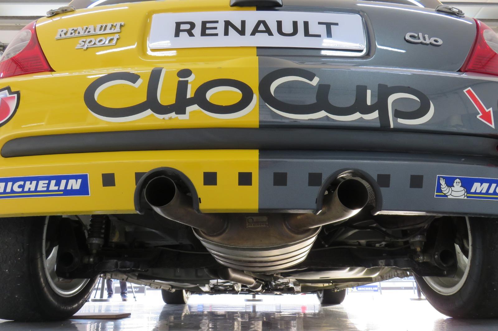

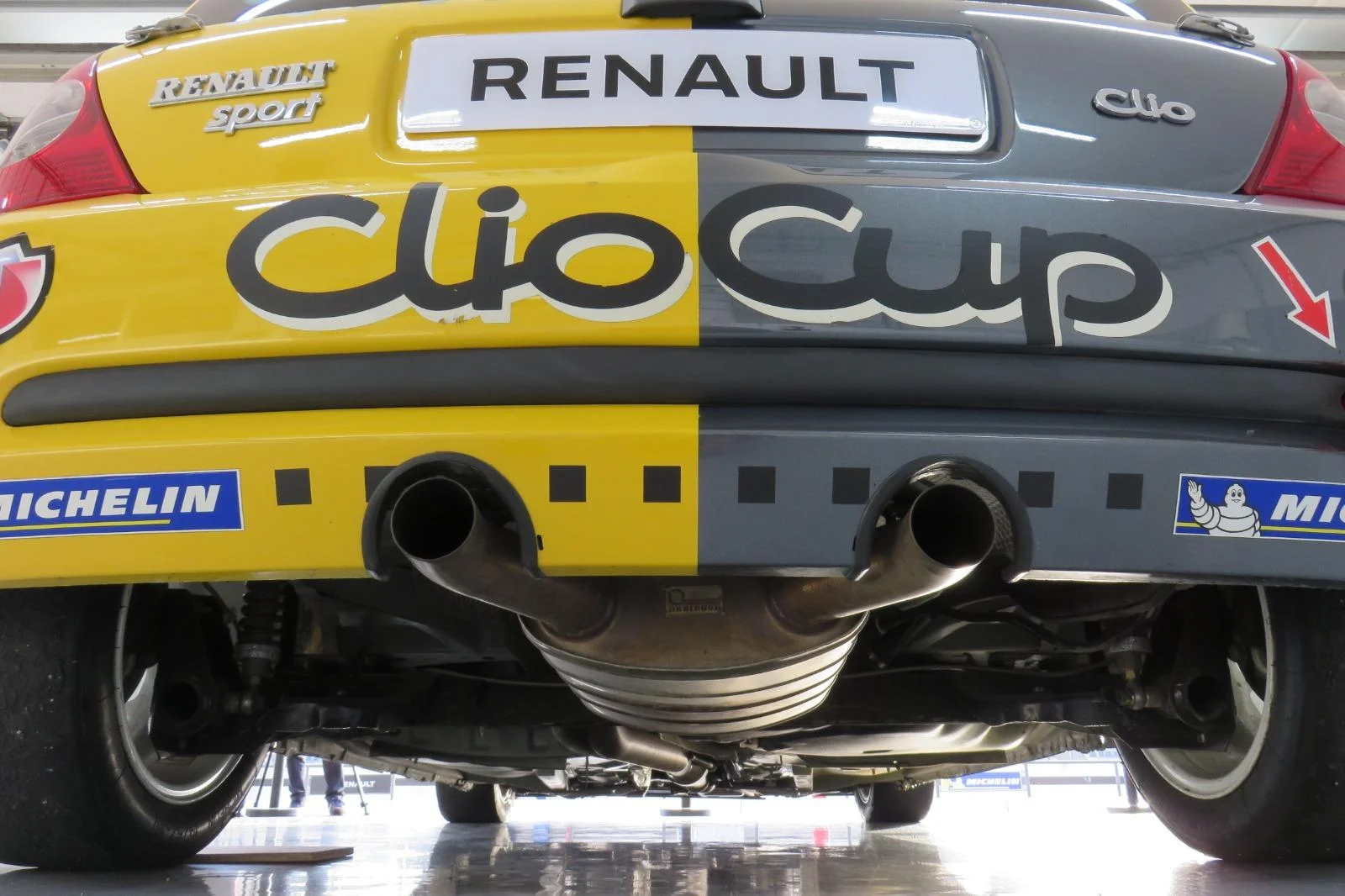

My favourite would be if I could get a genuine Cup Racer one as they had just dead straight cut outlets and I like the “no frills” motorsport look.
I imagine I’ll break the Clio Internet if I was to cut the outlets off a genuine Orbisoud system though. 😂
No offense but the cup racer looks naff imo. As Cookson says the tips on now look oem but better.

I really like the look of the fat rolled tips on the Orbi too. I assume getting hold of a cup racer one would be a challenge so dare I say if you really don't like the tips but do the exhaust then just have them cut off and replaced. @moktabe has the look you're after on his V6.
Wost case you can get a new one from Orbisoud but they'll charge you plenty for it.
Thats what i like about them ha.. you know me dude... im a bit mad :D
Not at all. I'm totally with you. There is something really cool about them. Reminds me of the Ashley Group N system on my old rally car. No chrome, no fancy shapes, just pure function over from.
Yeah i like it that way too. Just a pair of brushed finish straight cut outlets.
We shall see what happens though. Ive gone from an OEM cat & catback to a decat with centre silencer. So i need to make sure im happy first with whatever i do lol.

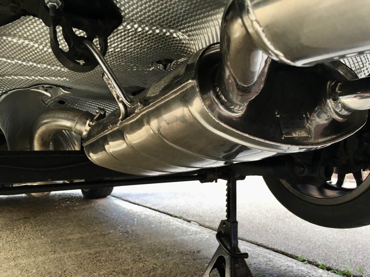

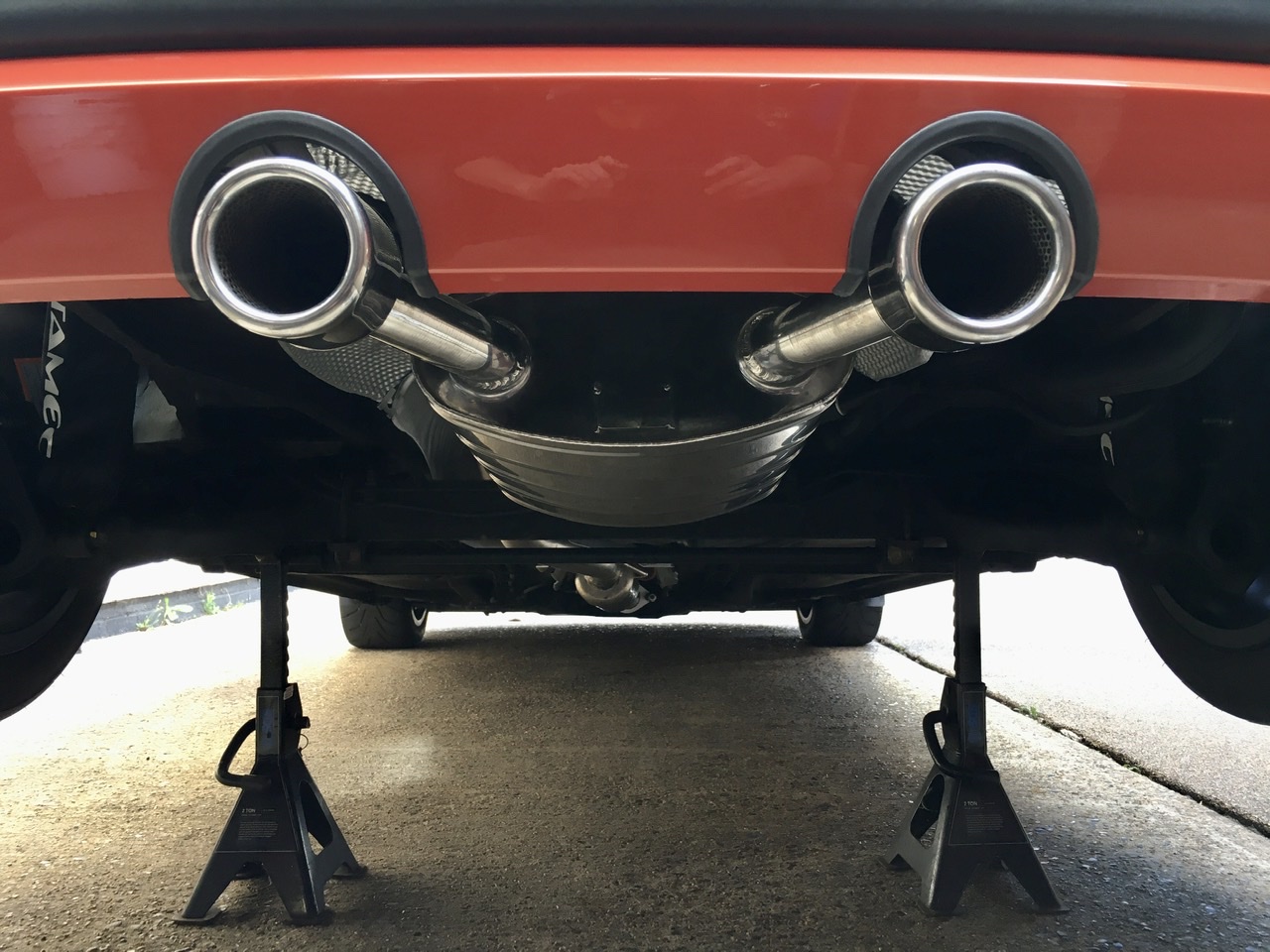

So im, 4 days into the Orbisoud and was asked on the Trophy forum as to my thoughts vs the BTM. For what its worth, this was my response for anyone interested.
Sound I think is slightly better on the Orbisoud, It’s got a deeper more angry tone than the BTM. It’s certainly gotten better over the last few days driving.
Having said that, the Orb is a silenced decat and my BTM is a cat back.
You can feel the cars lost a little bit of torque around the 3k rpm area but the motor certainly feels less restricted and revs much more freely. This is most noticeable when bliping for heel/toe. Dispite the slight torque loss, the way the car drives decatted is far more to my liking.
Fitment on the Orb is very good, infact it’s one of my favourite things about it, it fits the bumper outlets perfectly. Doesn’t knock or touch anywhere underneath and I like the fact it bolts directly to the boot floor and does away with the OEM triangle mounts.
It does however only have 2 mounts at the rear and this allows a little more movement than I’d like. For this reason it does touch the bumper cutouts under hard load. I know this because now the exhaust has a layer of dirt on it, I can see clean witness marks around the outlets where it must just kiss the bumper trims.
Build quality is reasonable but far from spectacular. I’d say my BTM is built every bit aswell as the Orbisoud, In some areas the BTM is actually better.
Frankly my Simpsons system on my Impreza makes the Orbisoud look like a lump of French pig iron. It’s far better than the off the peg Milteks, Scorpions etc, but also a far cry from a proper motorsport exhaust. I think anyone that does cartwheels about an Orbisound’s quality has never seen a proper race exhaust.
I’m also not a fan of the inwardly rolled outlets or the slightly pointed down angle they have. I’d much prefer a straight cut pipe like that of the cup racers. I’d also like to try it with a sports cat and delete the centre silencer.
Not sure if I can bring myself to cut up an Orbisoud to have other tips fitted, probably cheaper to sell it and buy a different system.
Overall I like it for the most part and if you like the asthetics of them, i don’t think you’d be disappointed buying one. It certainly sounds nice.
Ive also found Orbisouds customer service and response to be absolutely appalling.
This alone makes me not want to own one as they’re not cheap. To buy one at £850/£900 it’s strong money, but £1300 quid though, not a chance.
I may still sell it, so if anyones genuinely interested I could move it on to chase something even better, all be it at greater cost.
That pleases me, I cant justify the cost of doing mine yet, they've gone exactly the same. Was the upper one only fitted to cup cars?
This is what I didn’t want, to have to start hacking bits up. I liked the idea of a totally OEM style fitting item. In the 197, they have the bumper meeting the edge of the duct, but the aperture in the 172/182 is larger even though they use the same lamp unit.
Your correct, carry over item, same part numbers [emoji1360]
