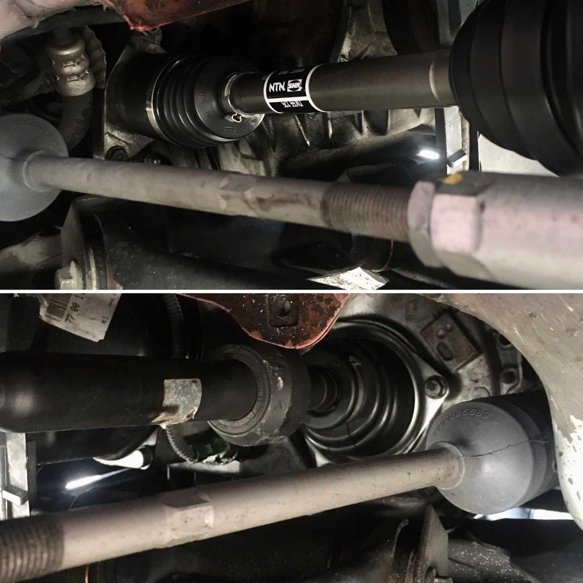

Have to say another huge thanks to Alex @ AW Motorworks for fitting a pair of brand new driveshafts and poly boots in WZD this morning... and yet more gearbox oil. Its 5th lot of oil in the last 9 months Haha. Needless to say the gearbox oil was a clean as it went in.
I had a noise that i suspected could have been a shaft so ordered 2 new ones, fixed the noise which turned out not to be a shaft but fitted 2 new ones anyway... because why not :D

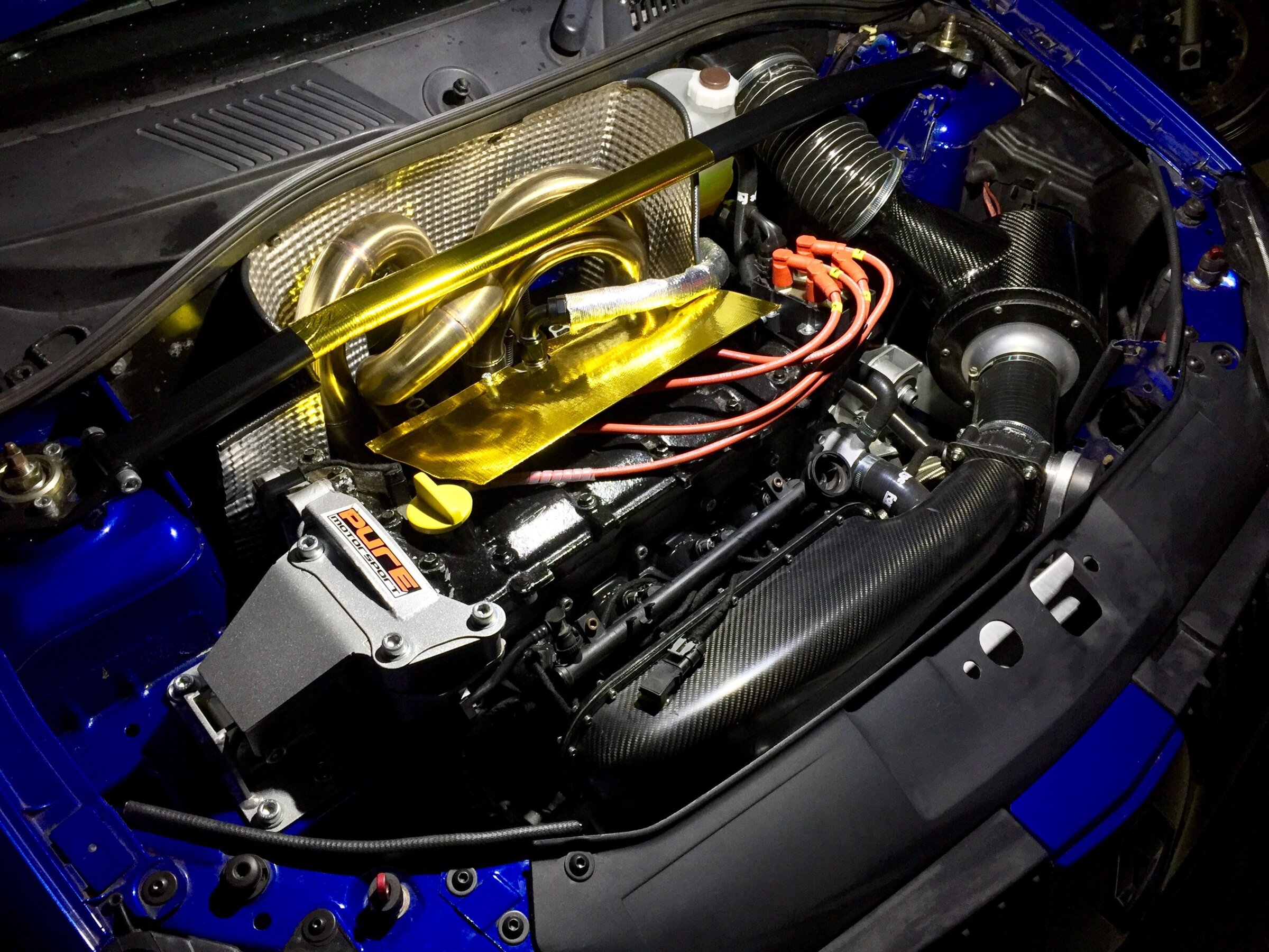

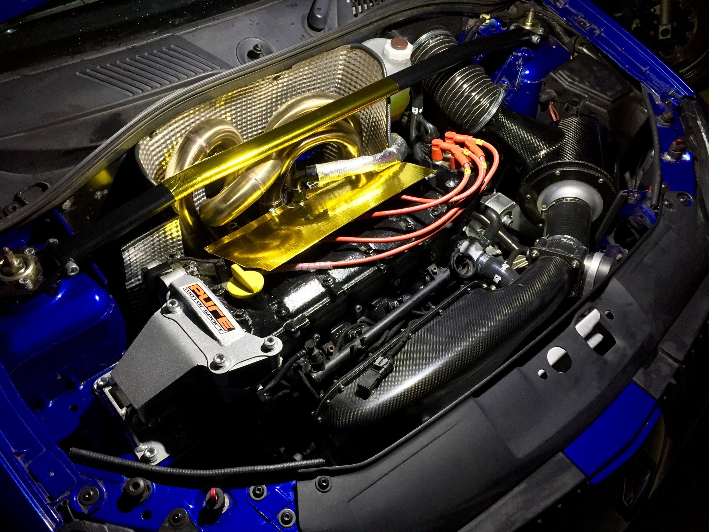

Turbo Testing
As said previously i was hoping to drive some turbocharged Clios this morning and thanks to some very generous owners, i was allowed a go in a pair of them.
Car 1)
This was a low boost 182 setup running approx. 240bhp on stock engine & gearbox. (7psi)
Boost controlled to limit midrange torque and allow boost to be held further up for peak power to be used on track.
Car 2)
This car was 172 Cup with switchable boost running no torque limit (13psi).
240bhp low boost, 300bhp high boost forged engine with a basic Engine Dynamics kit.
Both cars fitted with LSDs, proper tyres, brakes, dampers and all the trimmings to be done properly.
I'm no stranger to turbocharged cars having started out with a 350bhp/340lbsft Sierra Cossie when i was aged 19. Later on with what became a 575bhp/520lbsft Subaru Impreza.
Also owned a supercharged Mini GP running 250bhp+ and driven lots of big bhp turbo cars, the fastest on the road being a 700bhp+ 996 GT2.
So I went in with both my eyes and my mind open to turbocharging my own 182, as maybe this was the extra power and theatre i was perhaps after?
The LB 182 had a decent amount of low down torque which provided a nice amount of get up and go in 1st,2nd and 3rd gear. Thereafter the torque dropped off quite significantly and i was left wanting more. This was great for a bit of low down punch but thereafter felt similar to a standard car.
Personally this setup didn't suit me at all, but was done this way at the owners request for trackday use.
It was great to experience how they can be tailored to each owners needs should that be what you want.
The Cup LB was significantly quicker than the 182 being not torque limited and although only about 20lbsft more than the LB 182, it was the aggressiveness of delivery and the overall torque spread. A LB Clio in this setup makes for a suitably quick road car. Just borders on what's usable in all conditions and would hook up and drive well. For most people this would be more than enough.
The Cup HB in the damp was completely unusable in anything below the middle of 3rd gear due to the aggressiveness of the torque ramp. A proper ECU with boost by gear would be nice to use here as you could add some much needed flexibility.
Once on the roll it was a potently fast car with approx. 300bhp per ton comfortably putting in the same category as a Porsche 997 turbo.
I cant write everything here, but Alex and i spoke at length about what options i have for going boosted with my 182. Needless to say he is incredibly open and honest about what can and cannot be achieved, what i would or wouldn't be happy with too.
I went today really wanting the turbocharged route to be an easy decision, its cheap and easy, but it has been anything but. I wondered if when i got back in my own car that i would be feeling it was hugely lacking. But driving home was quite the opposite. I have been thinking lately about what i like about the Clio and that was how assessable it is to really enjoy driving it. The little lightweight car coupled to the tactility and delicacy of the NA engine.
The more I've driven it lately the more i have been enjoying using all the revs, the delivery that builds as the rpms rise and the crescendo of grabbing another gear and doing it again. The balance is great, and I've always loved how adjustable it is on and off the throttle mid corner too.
Having experienced both turbo Clios for a decent real world drive, i think I've decided the turbocharged route is not for me with the Clio. Yes the allure of cheap bang for buck is superb. Its pennies to boost one of these which results in a significantly quick car.
The turbocharged car makes for a very potent little machine and is a bargain way to performance. If you have never experienced a fast turbocharged car, or you just want to go quick making some great noises, and not really caring how you get there, its great product. In HB it feels like you've been fired from a cannon and i would say is probably somewhat dangerous should you not be familiar with car control at the limit.
The turbo route certainly adds something to the Clio package, but for me i think it took away more than it added. It alters the way the car behaves and its power delivery (certainly for me) removed too much of how good the Clio feels to drive.
So i have to say I'm incredibly grateful for the experience in both cars, but i think I'll be exploring the NA route with whatever route that may be. :)

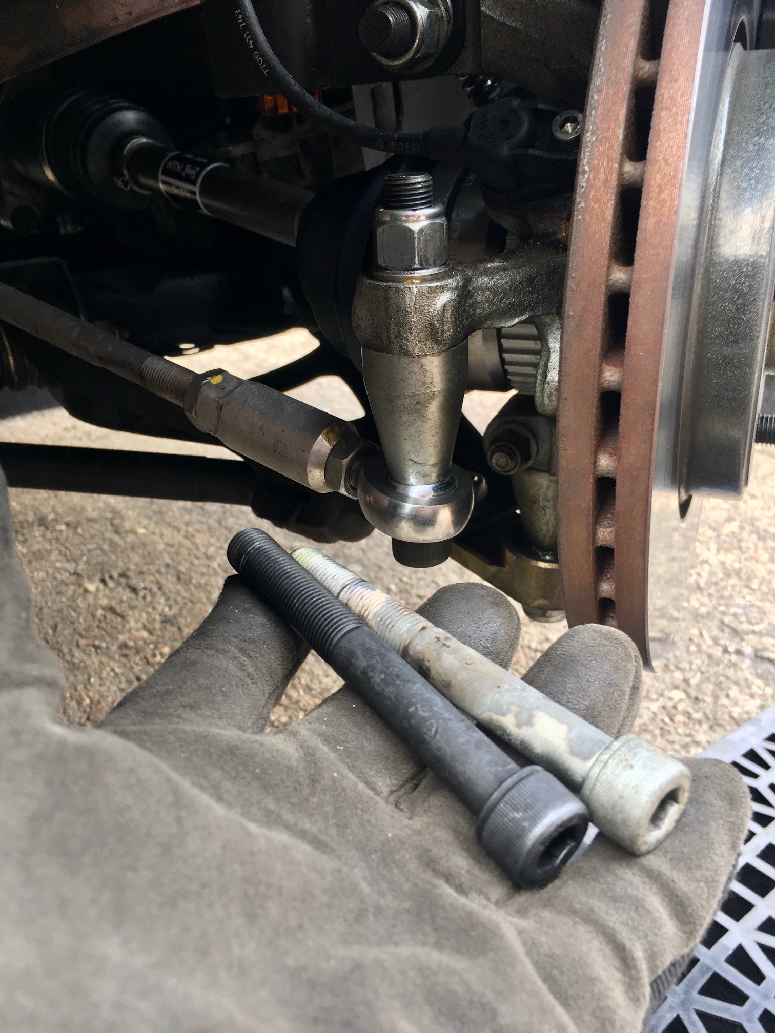

So couple of tiny jobs on WZD this morning that i wanted to do.

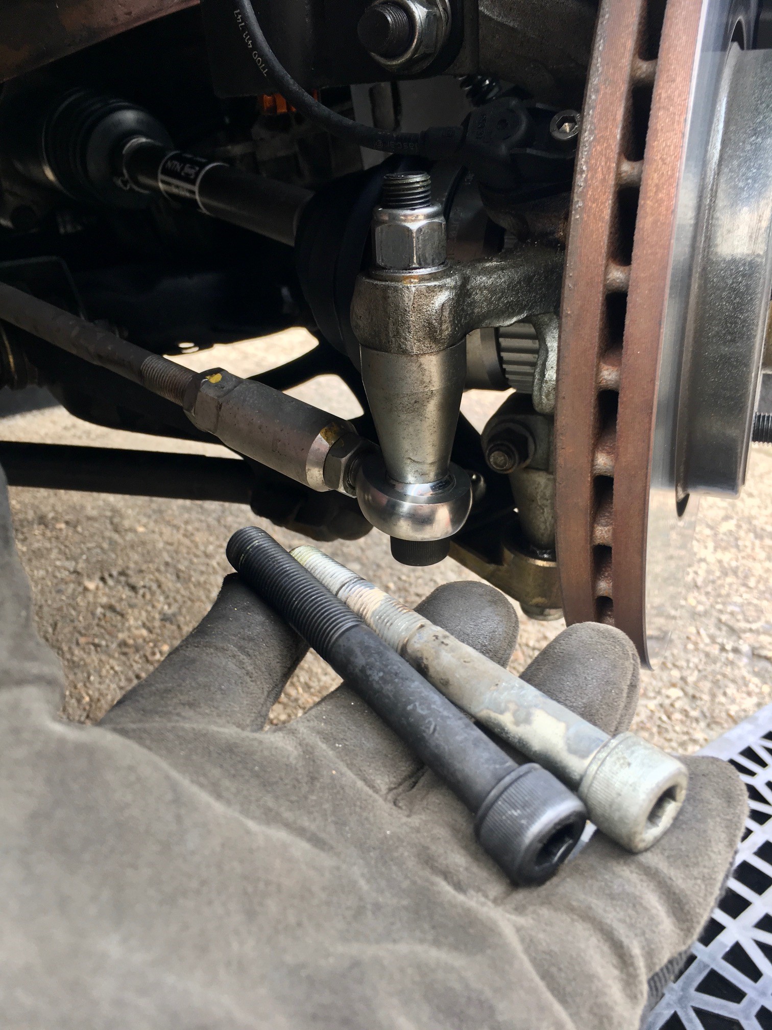

Firstly was fit new 12.9 hardware to the TCAs. I had previously zinc coated these and ever since I've been a bit twitchy about hydrogen embrittlement.
Deep down I'm sure they were fine but i couldn't shake it from my doubts and you can have doubt about a key fastener like that.

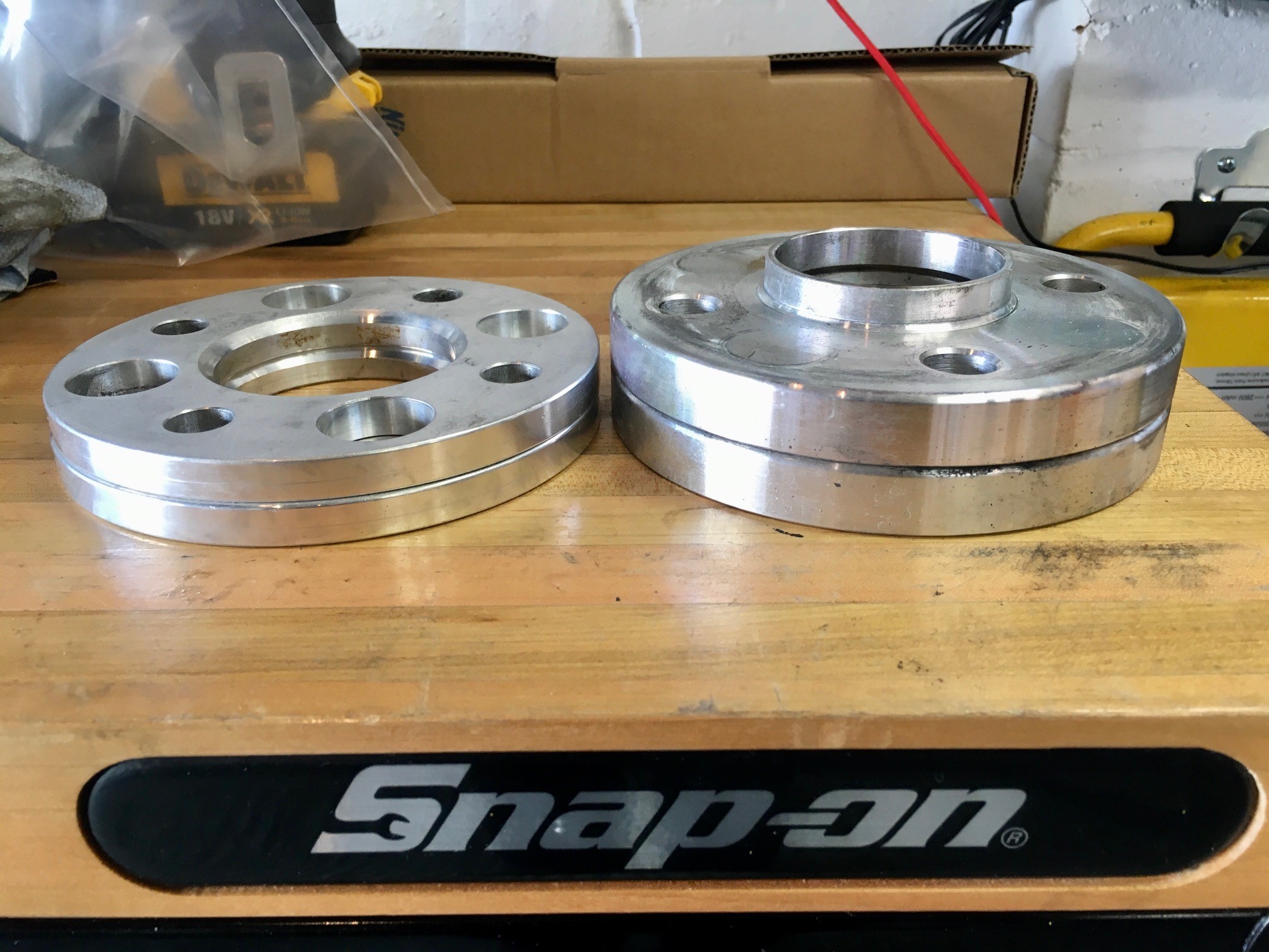

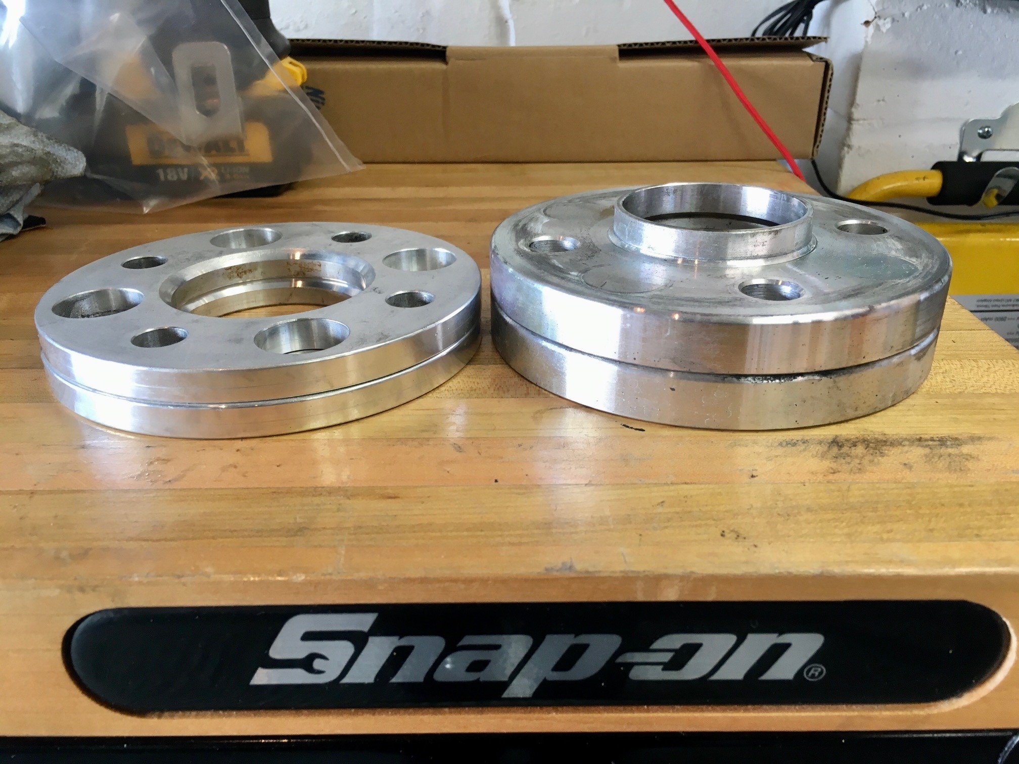

Next was to drop my front spacers from +16mm down to +10mm in an attempt to dial out some tramlining i was experiencing. Im happy to say this has made a significant improvement to the way the car steers and drives undulations now.

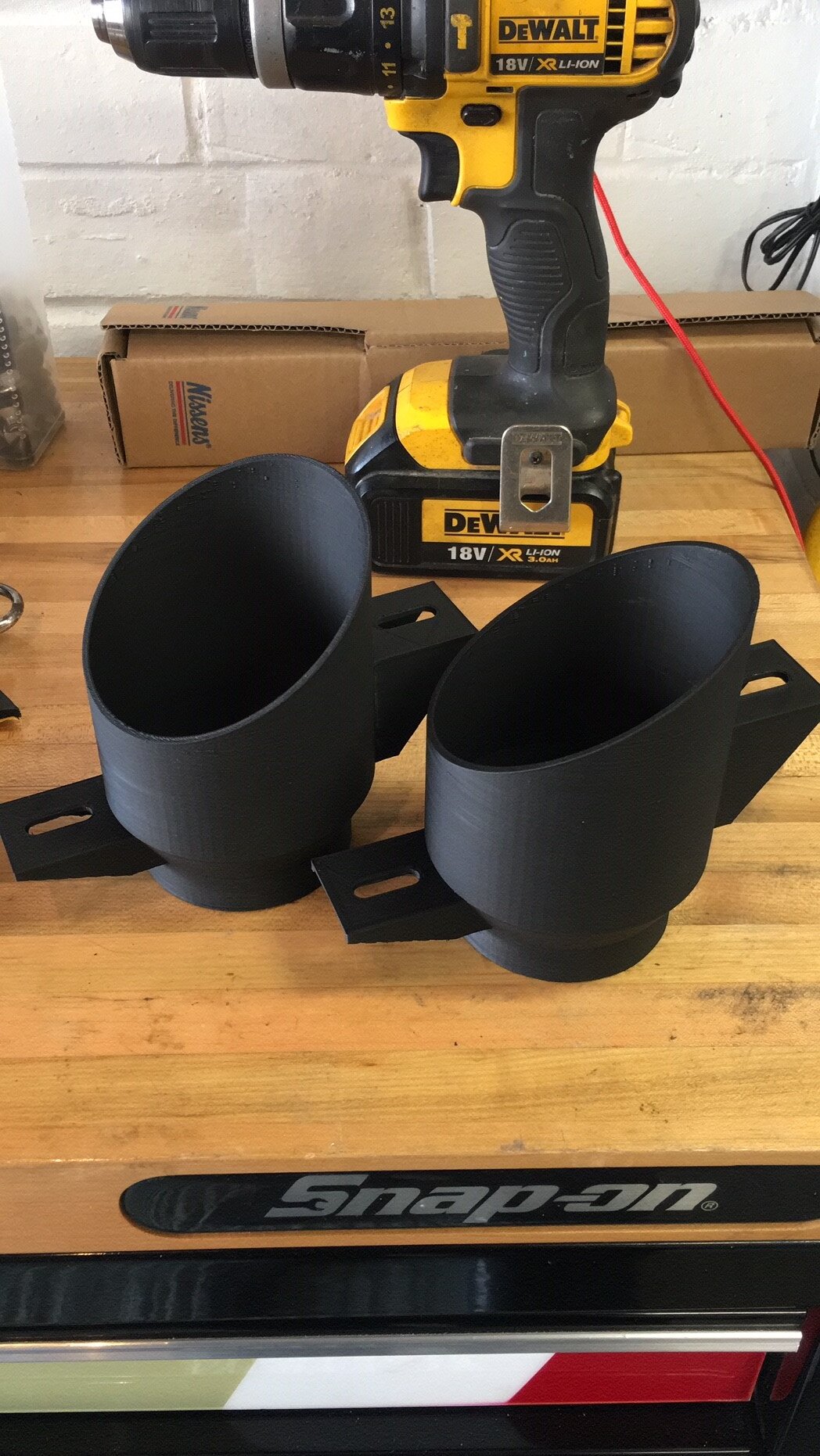

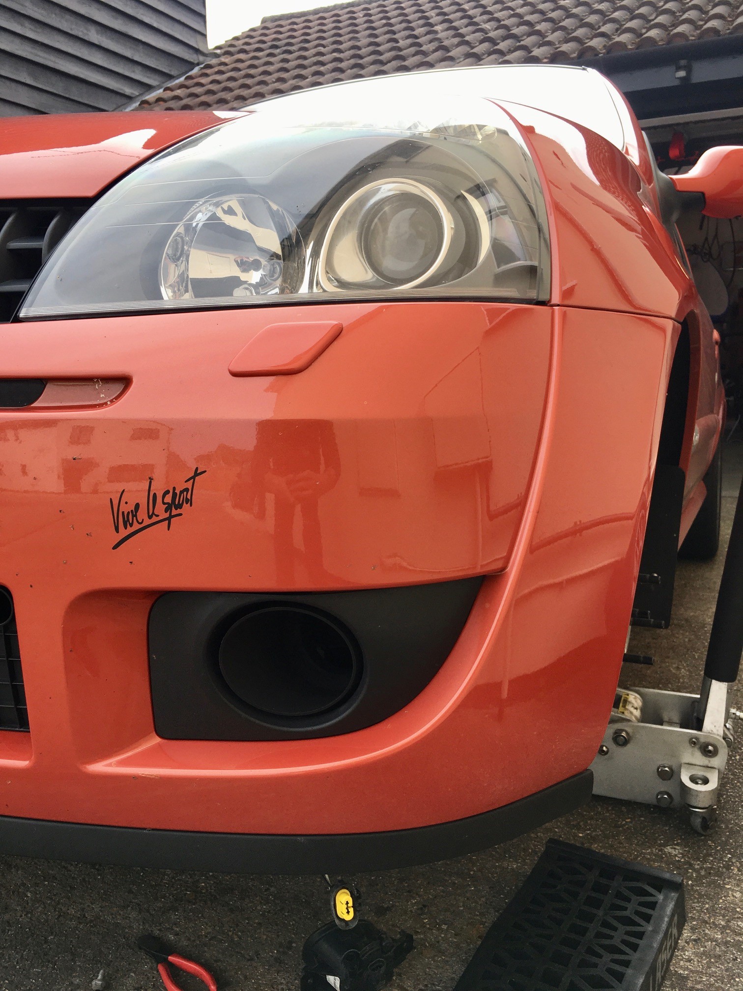

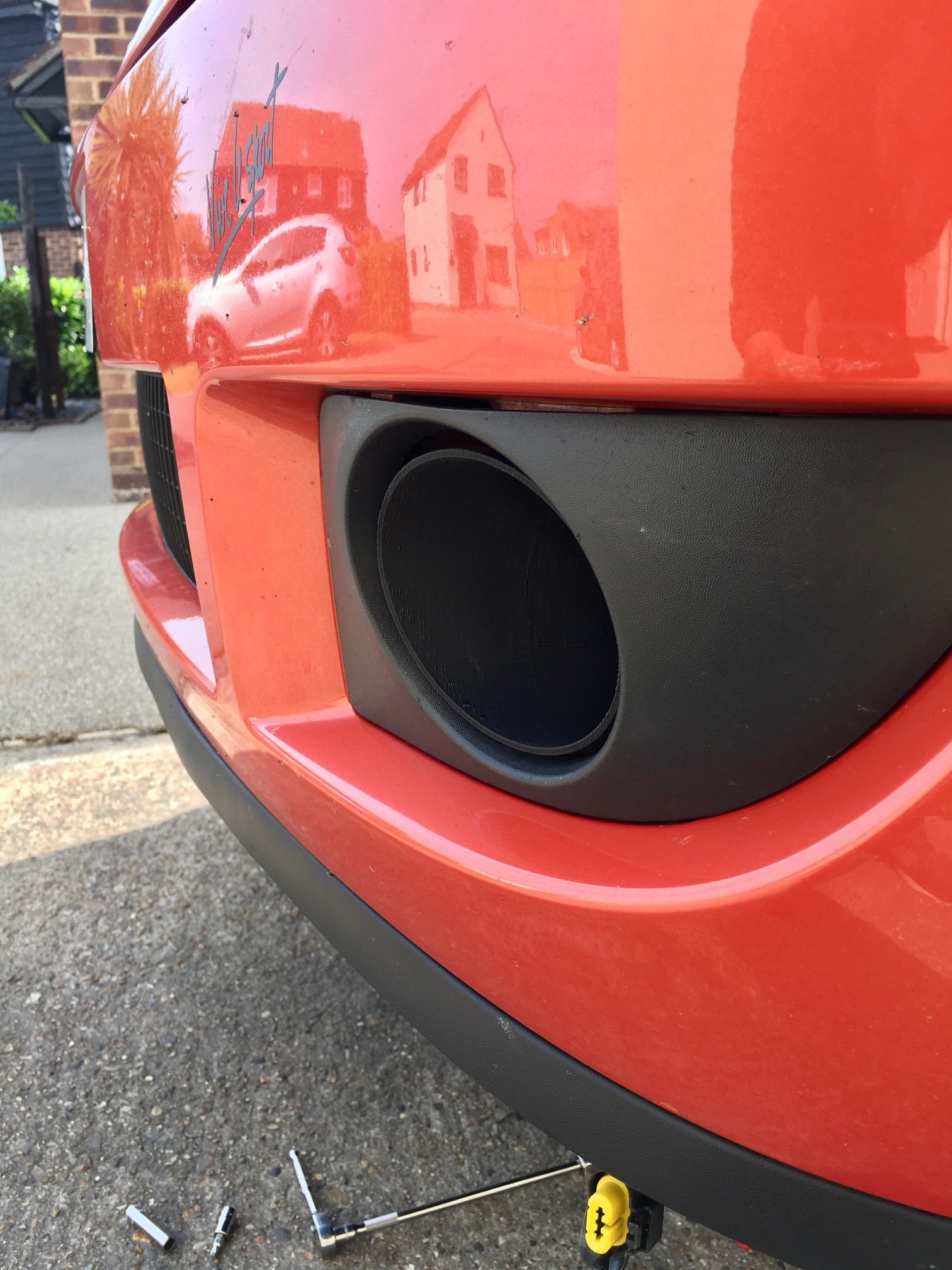

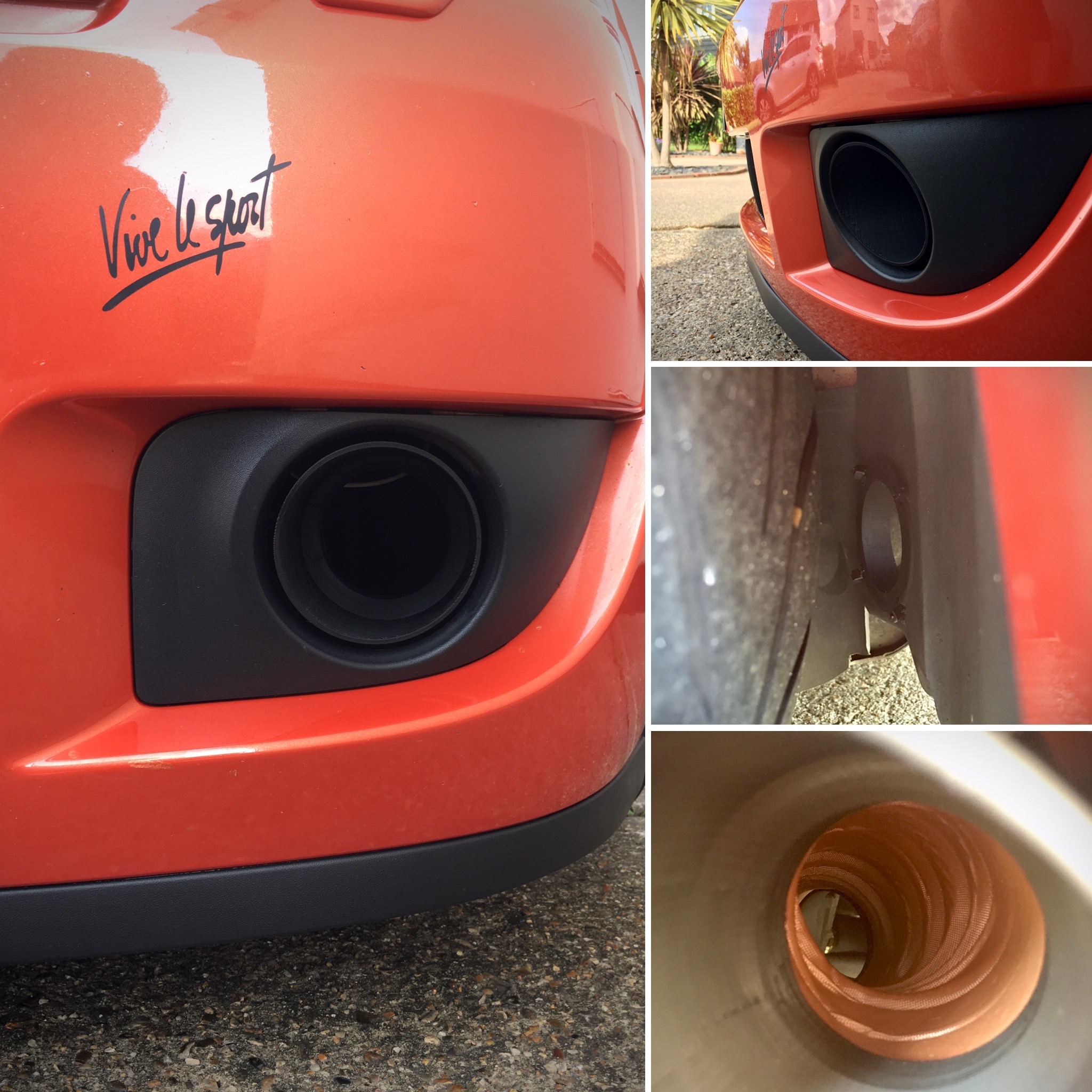

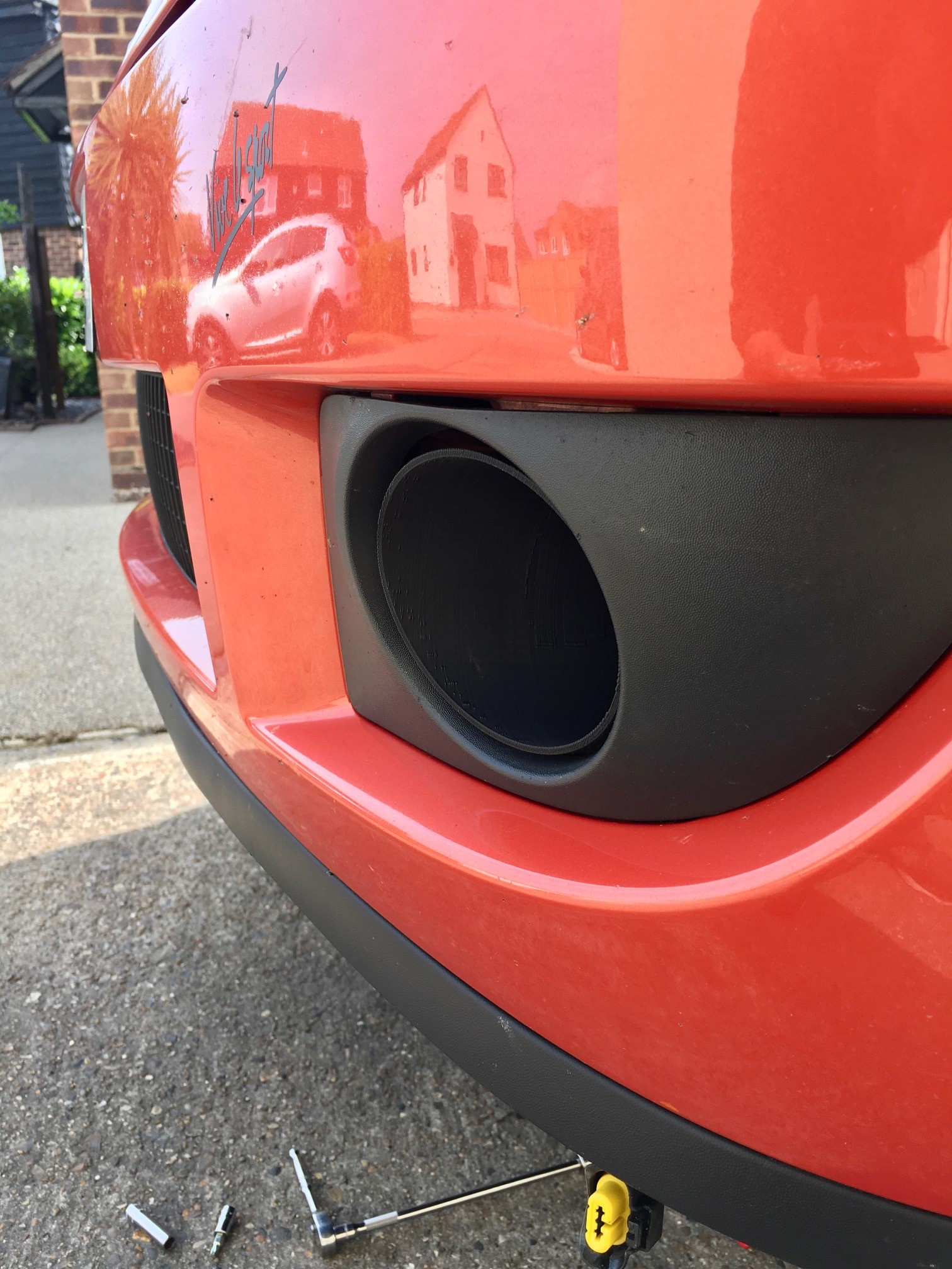

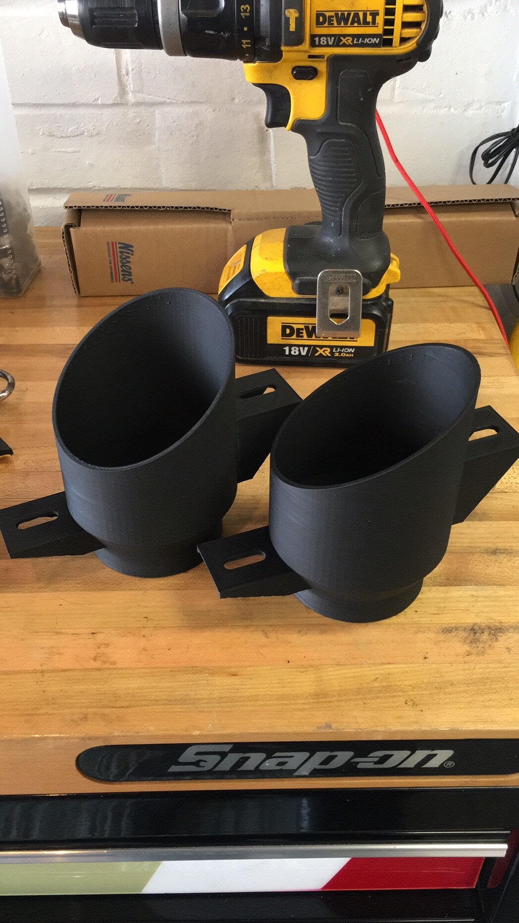

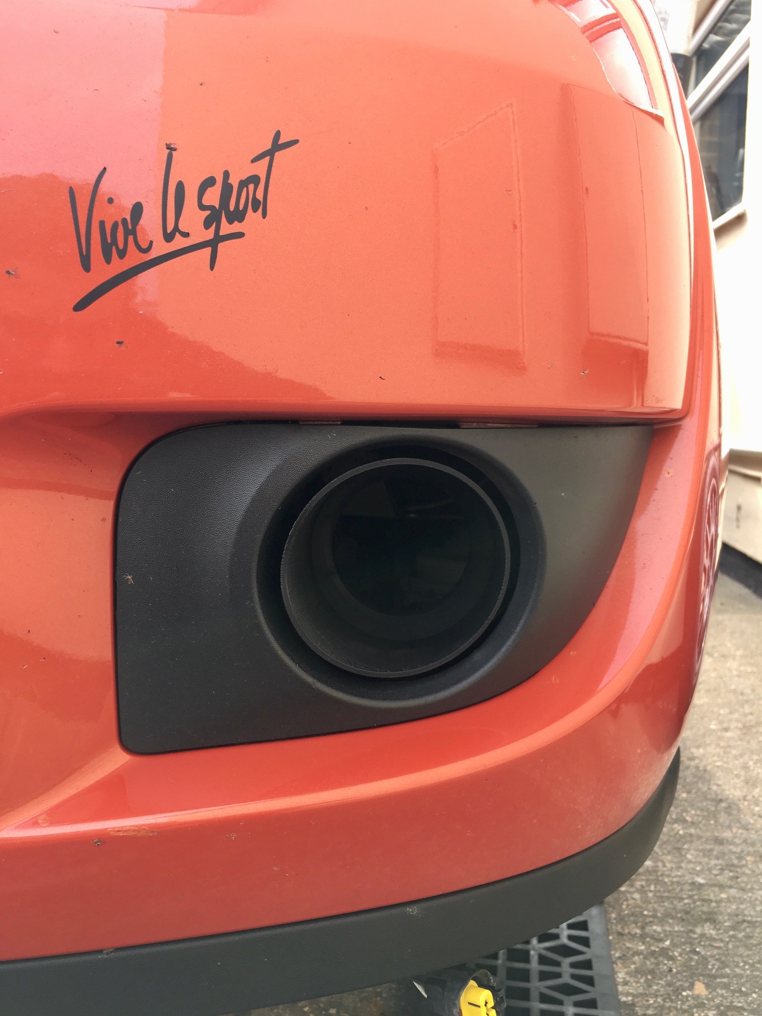

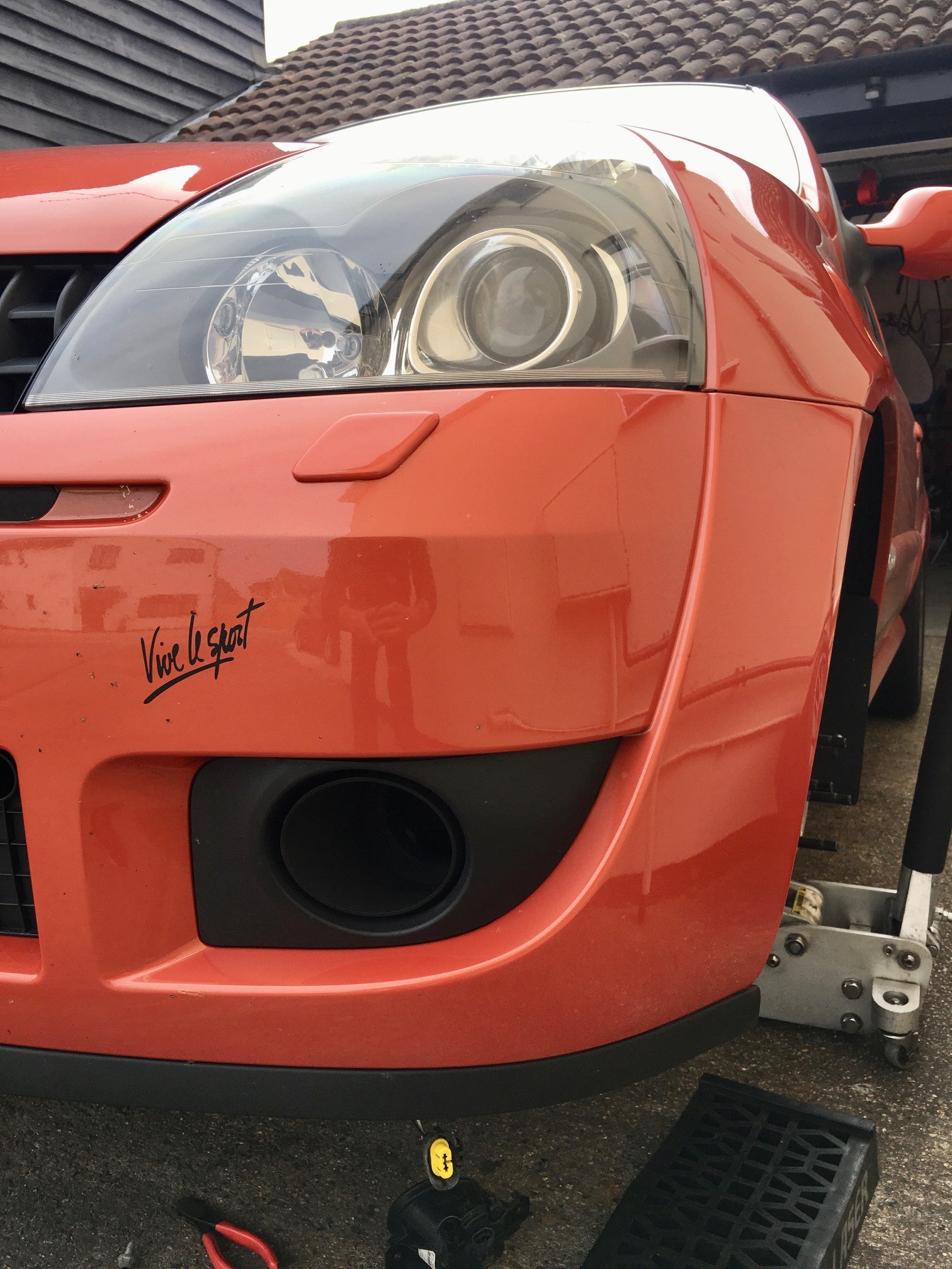

Lastly was something id been wondering about for a bit, brake ducts.
I am yet to see any setup that not only works but looks nice on the front of the car. The ebay offerings look pants IMO and don't follow the lines of the car properly, likewise the bass port idea also doesn't sit at the correct angle. The Cup racers are arguably the most efficient but look ugly and i wasn't prepared to hack up the bumper. I had an idea about rendering an OEM foglamp and 3D printing a duct that bolts into the existing housing exactly as per OEM.
I then found a guy who had done exactly that, but for the Clio 197/200. I had a pretty good idea that the foglamps were a carry-over item from the Mk2 Clio so was pretty confident they would fit.
This is just a trial fit for now. but they fit perfectly as per an OEM foglight and follow the lines of the front of the car perfectly. I'm really pleased with how these look and will soon fit them properly with some ducting and Cup racer deflector plates.
-Simon
  172 Cup, GT2, Meg250
Those ducts look bob on. Like you say the others look like an afterthought but those look very OEM +. Impressive 👌
frayz
Those ducts do look good. How much are they and are you on commission? 😂👍
I wish I was on commission. I did ask him. Haha.
£65 they are. Which normally I would raise an eyebrow at for a bit of 3D printed plastic. Having said that, you can really see he’s put in the time to get them as good as they are and they’re nice and robust too. Development time doesnt come for free so I thought they we’re good enough value seeing as nobody else makes anything as good yet.
I know the boys at Pro-Am Racing have a brake cooling package in the pipeline so ive no doubts that will be a nice bit of engineering if/when it comes to fruition. Until then, I think these are pretty sweet.

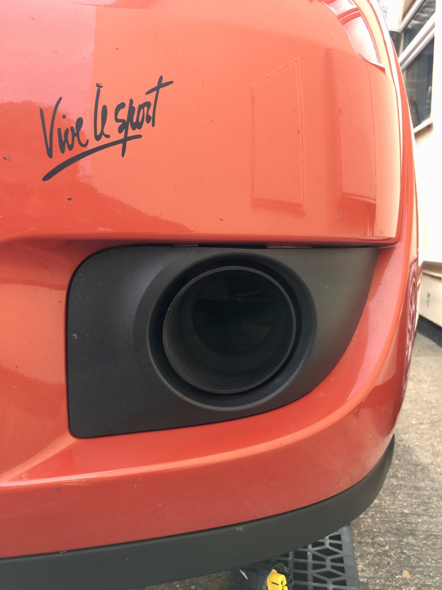

View attachment 1479962View attachment 1479963View attachment 1479961View attachment 1479964View attachment 1479965View attachment 1479966
They do look good!
I cant help but think they need some sort of lip to sit around the edge of the fog surround. Might look into designing a version myself, only problem being I cut out my fog brackets a while ago 😂
frayz
They do look good!
This is what I didn’t want, to have to start hacking bits up. I liked the idea of a totally OEM style fitting item. In the 197, they have the bumper meeting the edge of the duct, but the aperture in the 172/182 is larger even though they use the same lamp unit.
Louis
I Love Ed Sheeran
Yeah, didnt bother me too much as I'll never go back to foglights. Could easily secure bits to the cover itself and have it as a single unit that you clip in.
Clio_fool
I like them, and the fact they bolt straight in is a huge positive. But for £65 I'd rather buy brand new fog lights 😂. Especially since one of my replacement ones has fogged up this week 🙄.

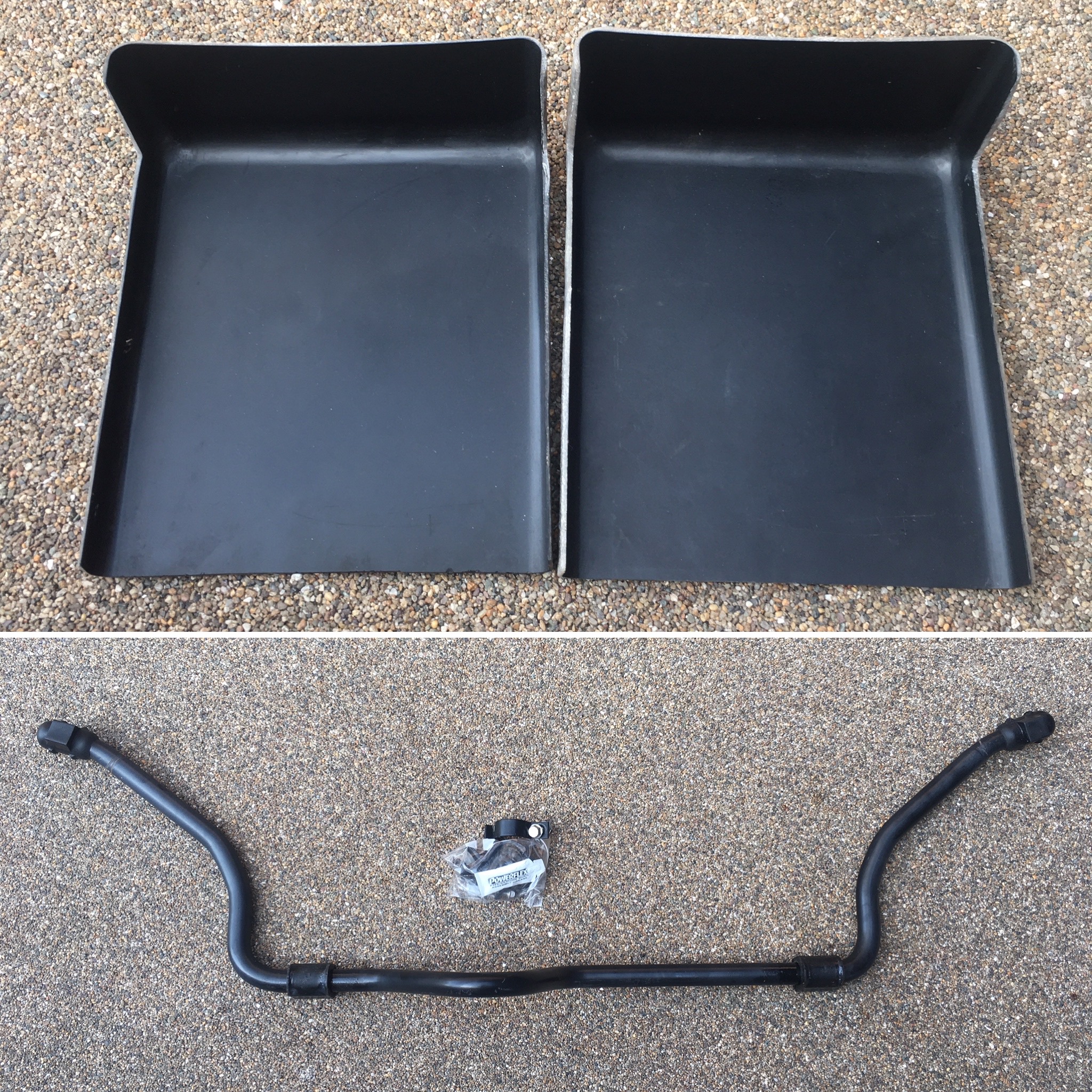

Brake ducts in and plumbed up with some 2 ply 70mm silicone ducting, I’ve also picked up some Cup Racer deflectors which I may fit, I also have some ideas for making some blades to fit on the calipers however I think for fast road at the moment, just getting extra ventilation in there is more than adequate.
I’ve also picked up a couple of other items for WZD. Thanks to @AdamCup for the freshly powdercoated roll bar and Pflex black bushes. Once fitted, these will complete the entire cars refresh for every bush, mount, bearing and ball joint now replaced in the last 6 months.

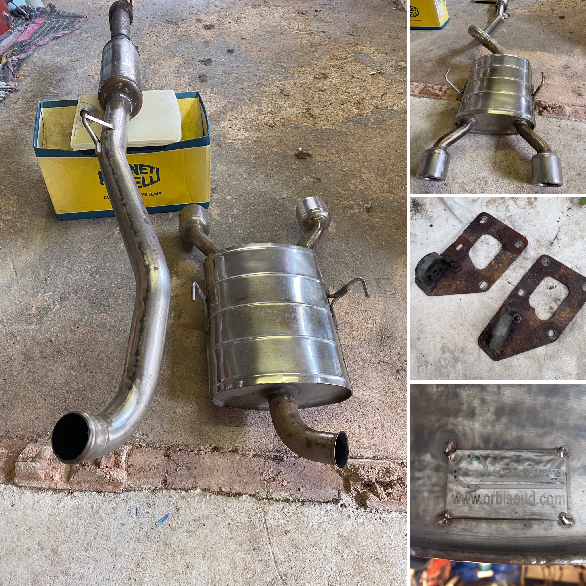

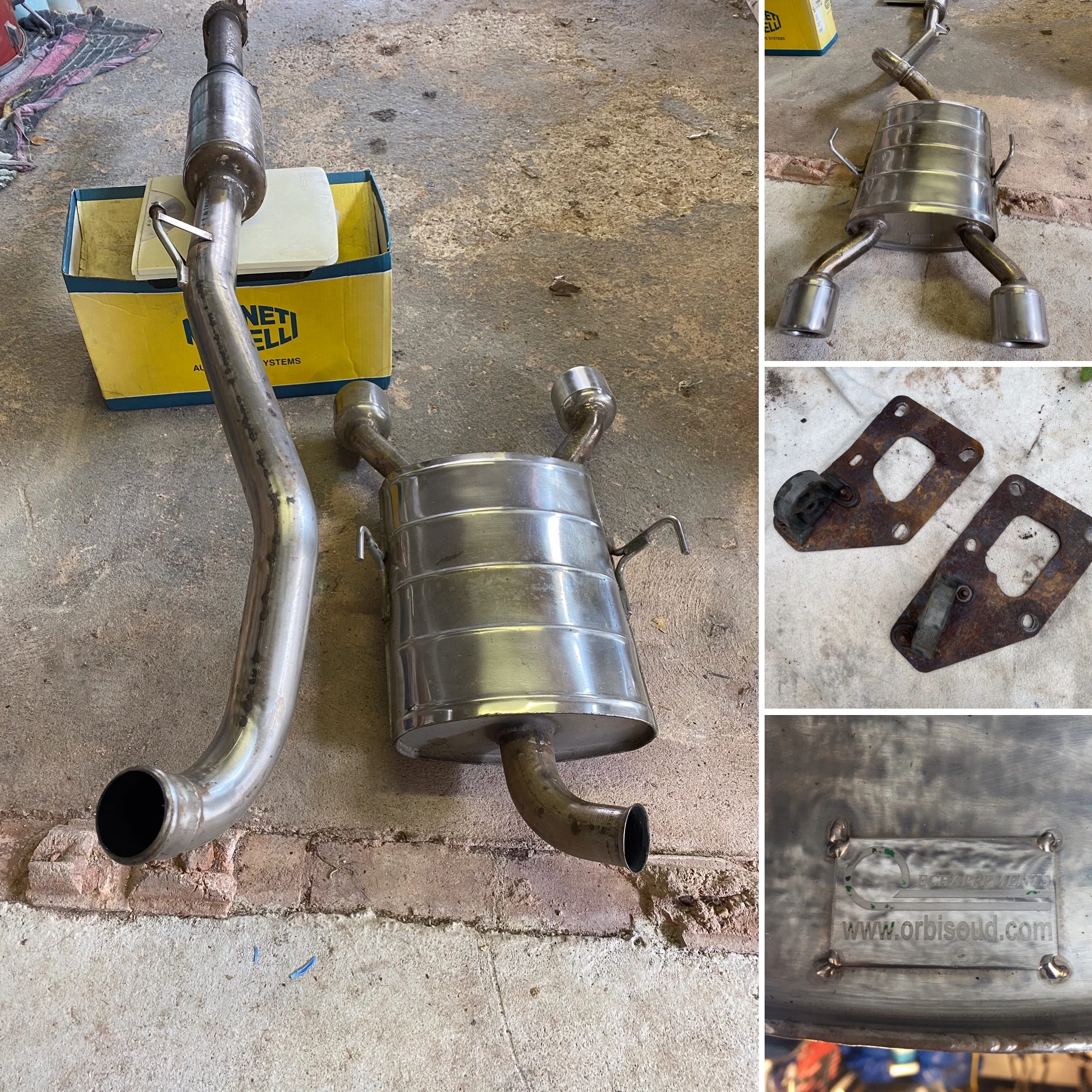

Ive also found myself a new exhaust in the shape of an Orbisoud. This is a silenced decat version although I may cut and fit my OEM cat back in. She needs a bit of TLC, but I’m sure we can get there. Ive already sourced a new clamp, and started the overhaul of the brackets. I looked into buying new mounts but Orbisoud wanted €250 for those. So I told them they can keep them lol.
Quality wise it’s okay, but not sure why so many rave over it, it’s marginally better than my BTM but nowhere near the quality of my Simpson Race system the Impreza used to wear.
Anyway, I’m sure it will come up nice and looking forward to hearing it.
