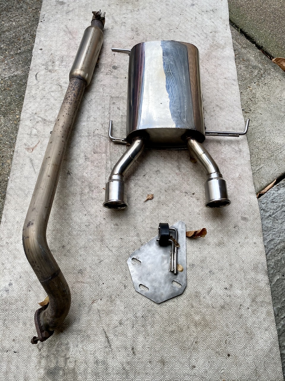

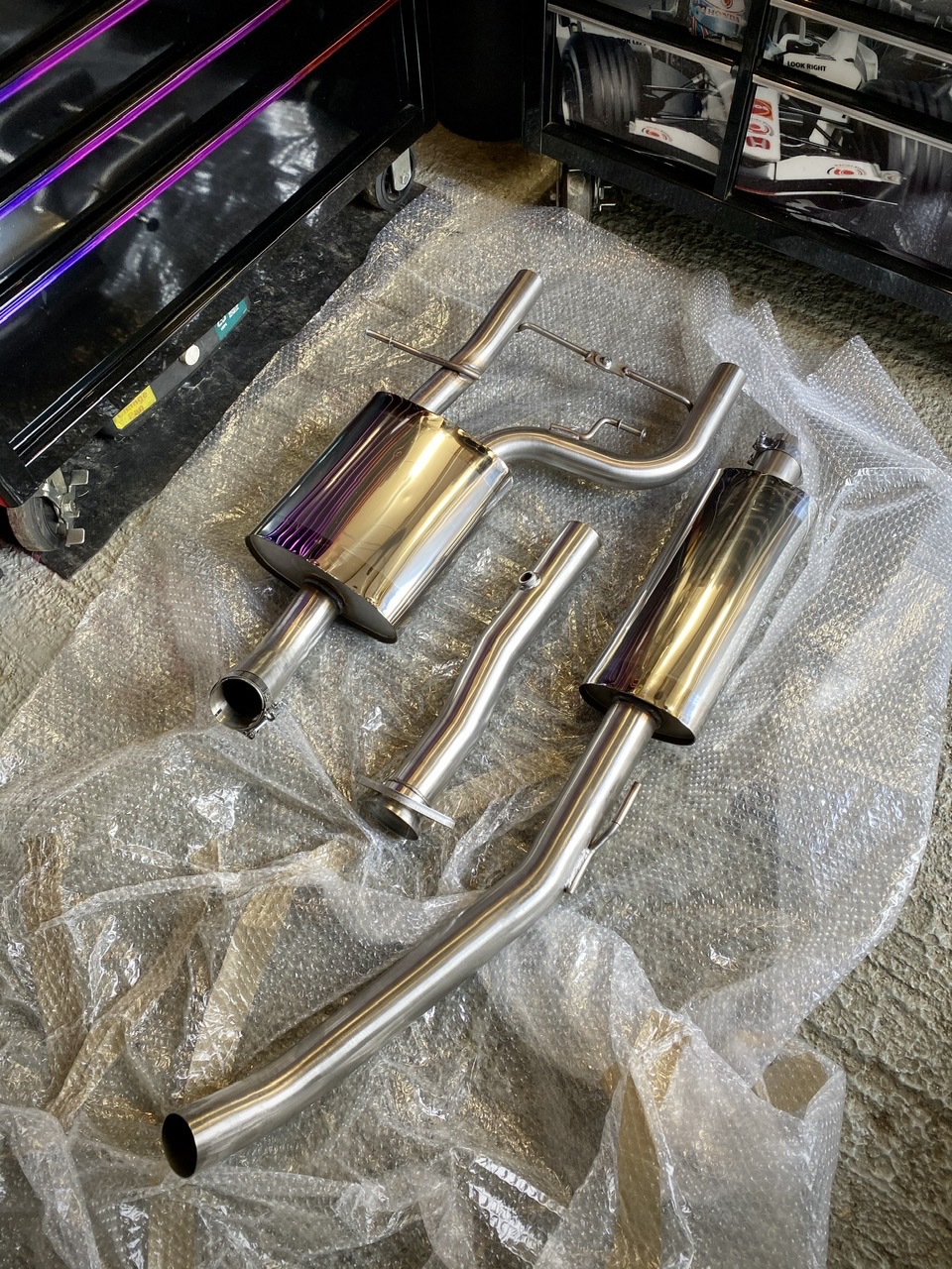

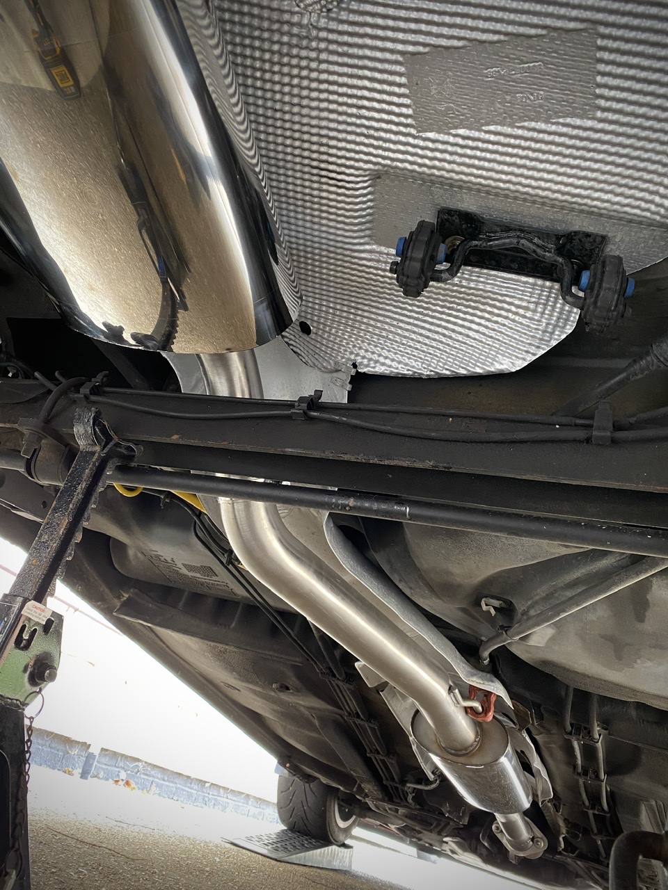

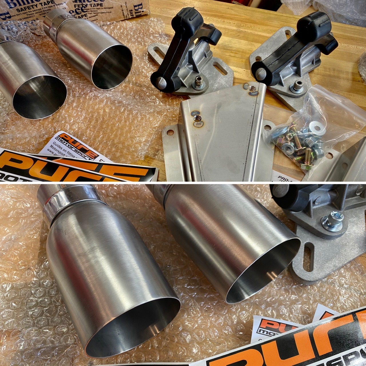

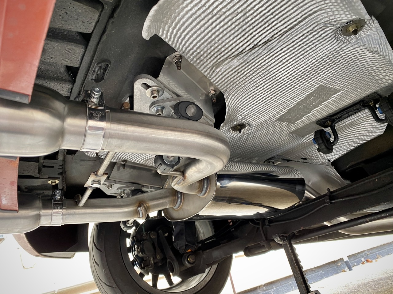

So, finally after a few weeks wait, my new exhaust system arrived. Yes I weighed up my options and seriously considered going back to Matt at Simpson’s. However when I started to really dive into it, I was looking at the thick end of £1300
After numerous conversations and videos sent by some good mates, namely @Ash J and @gambit of their PMS systems. I decided to give Nick @Pms a call and see if he could indeed supply me with one of his systems, but I wanted some custom straight cut 3” tips in a brushed finish. The PMS offered a lightweight design, not too loud, full 2.5” and without argument the best and most adjustable mounting system. All of this at less than half the cost of a Simpson setup.
I much prefer brushed systems over the polished stuff, my impreza was the same, as is my Cayman.
Nick kept me updated along the way and sure enough the new system arrived today. I’m exceptionally fussy when it comes to this sort of stuff and was very pleased with the quality. Lighter than the Orbisoud and BTM. The material quality doesn’t feel quite as good as the other 2, probably 90% but the construction and welds are very good indeed. The more you look at the PMS system the more you can see someone has actually sat down and genuinely thought about it. The hangers are adjustable in all directions except vertically.

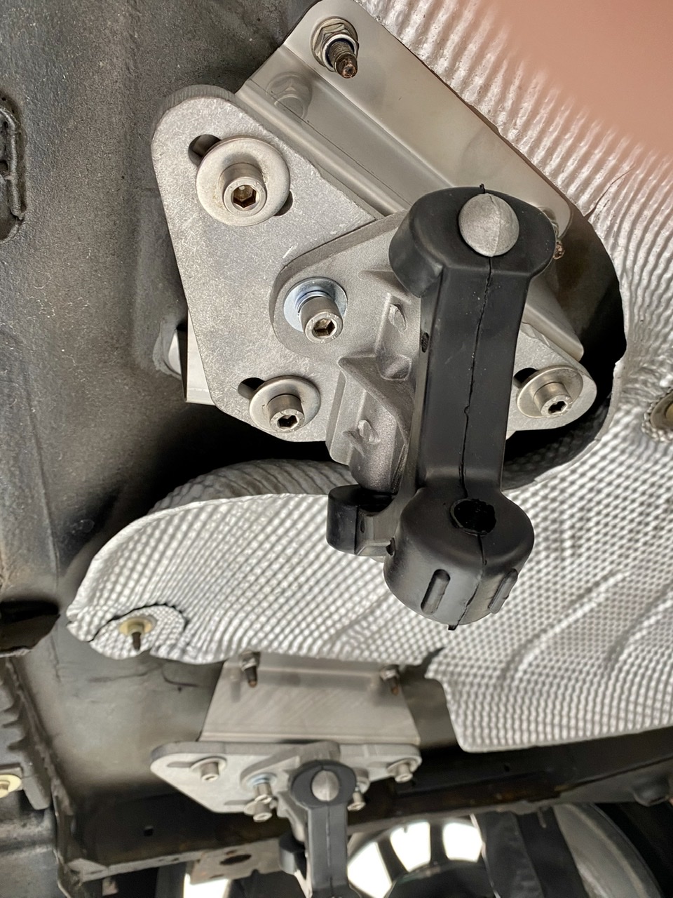

To address the vertical adjustment I purchased some of the beautifully made Pro-Am stainless mounts. These happen to be 10mm shallower than my mounts so raise the exhaust 10mm, thus giving a snugger fit to the bumper.
I’ve gone for the full PMS decat but have also purchased their cat derestriction piece which I will have welded to my OEM cat for ease of swapping come MOT time.
I decided to fit up the system with the tips over protruding, let it heat cycle and then knock them back to where i wanted after. Easier to tap them in that pull them out I thought.
So after all that, photos photos photos.

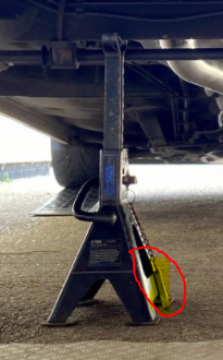

dann2707
Car is looking great.
Little tip - stick those little metal inserts in when using the ratchets. Just means you've got that extra bit of protection should the ratchet mech fail.
