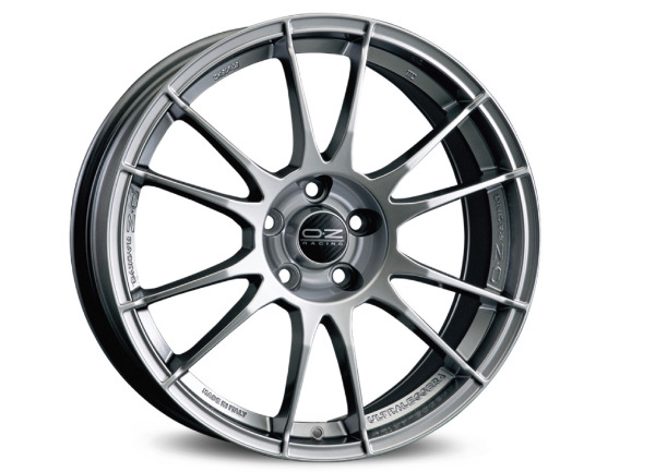

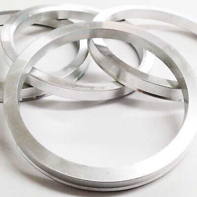

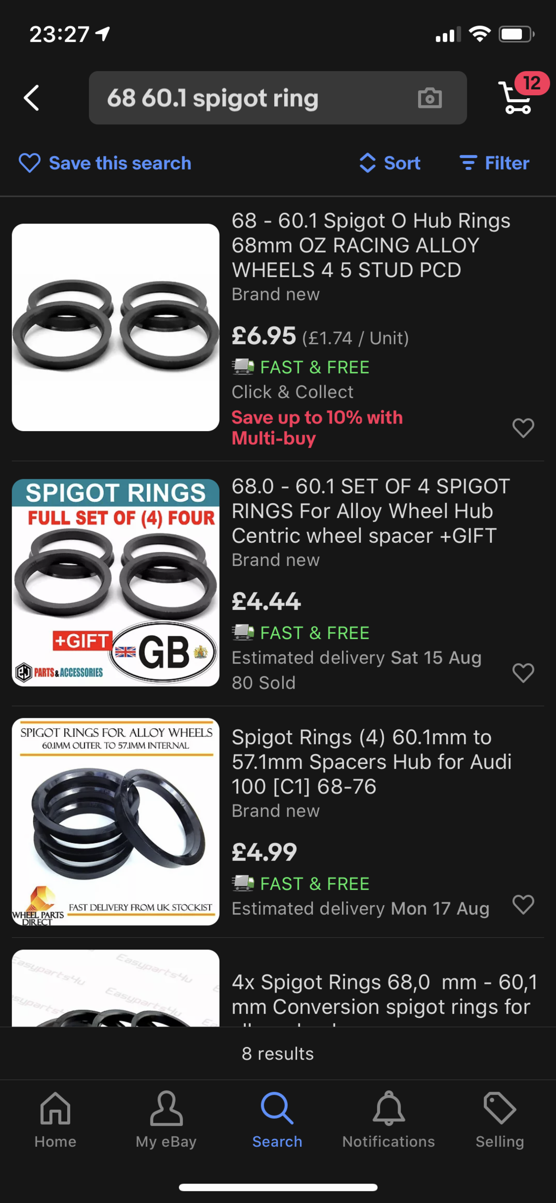

I'm looking to get a set of 15x7 Ultraleggeras as track wheels on my 182 (already use them on the Cayman), but an struggling to find alloy 68.0-60.1 spigot rings. Anyone know where I could find them?
Cheers
Ian
The plastic/polycarbonate ones only have a working temp of up to about 140C. Much above that and they start to melt. As this is a track car, hub temps can get above that quite easily, hence alloy spigot rings needed.
Obviously. 🤦🏽‍♂️
Apologies, my dumb ass wasn’t thinking when I responded. Lol.
Custom set?

So im still digging for wheels which are both lighter than the 2118s (not hard) and that i actually like the look of. I've tried really hard and still am to get a sensible price for a set of forged JDM wheels such as a Volk TE37/CE28N, SSR Type C or Regamaster EVOs. Alas they're all stupidly rare, difficult to source used and either not made anymore or if they are they're knocking on £2500/£3000 a set landed. I'm mad but even i cant justify that money on a set of 15s lol
Pretty much ruled out Ultraleggeras too as im just not a fan of how they look. Cheap wheel and lightweight though.

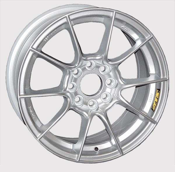

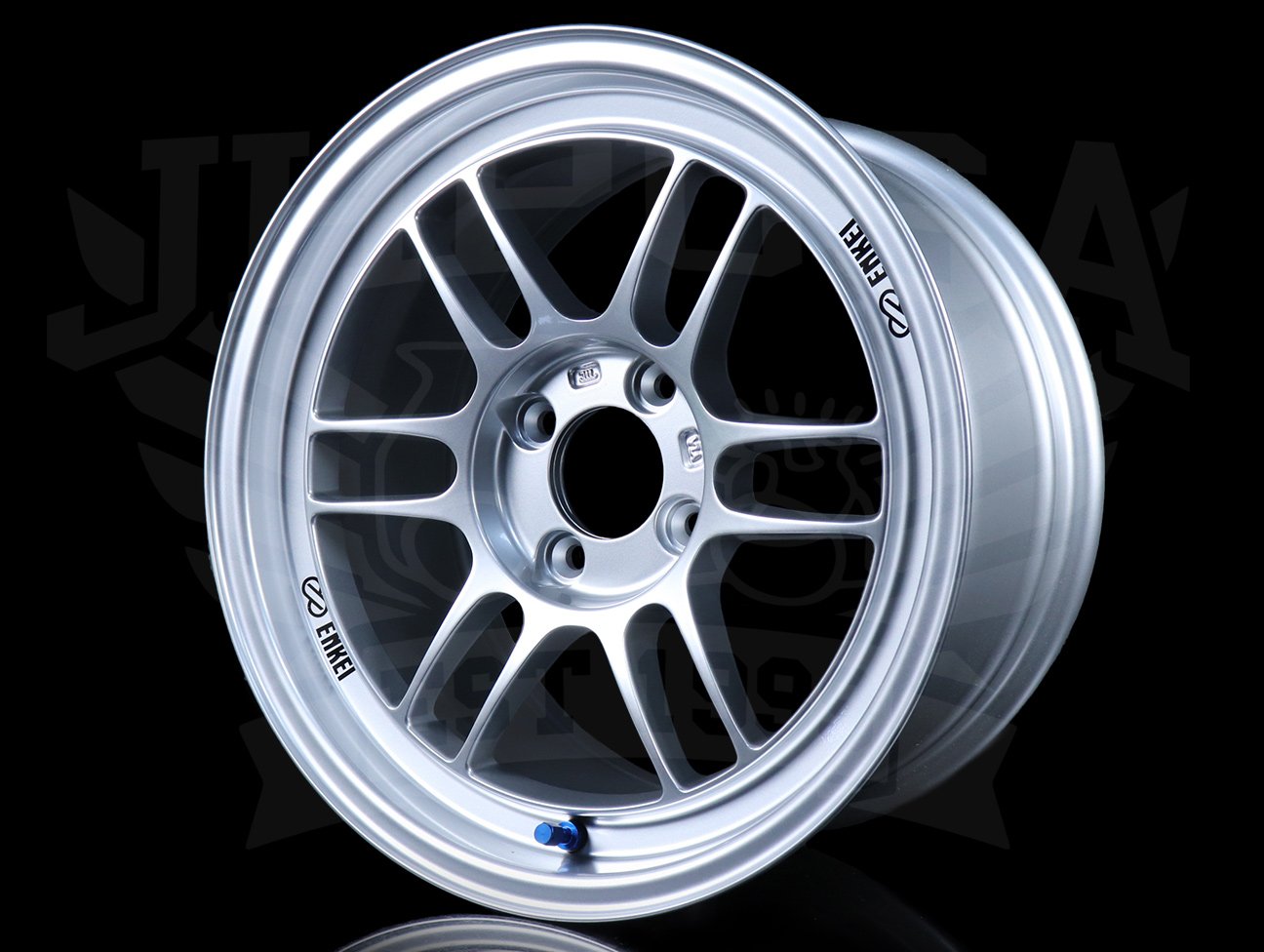

And im down to 2 real options... i think. The Enkei RPF1 and the ATS DTC.
So I’ve done the following sums based on an example Nankang AR1 tyre which is likely to be the heaviest tyre I would ever fit. those that dont know, It’s a road legal cut slick much like an Toyo R888. And thrown in some prices too just to provide some contrast on why many opt for a 15" over a 16" wheel/tyre.
Wheels (Weights provided by manufacturer)
  • ATS DTC 15x7 5.7kg £190 per rim, £760 a set
  • Enkei RPF1 15x7 4.5kg £260 per rim , £1040 a set
  • Enkei RPF1 16x7 4.5kg £286 per rim , £1144 a set

  • 15” DTC 14.4kg
  • 15” RPF1 13.2kg

  • A set of 15” RPF1s = 52.8kg a 20.4kg weight loss
  • A set of 15” DTCs = 57.6kg a 15.6kg weight loss
  • A set of 16” RPF1s = 61.6kg a 11.6kg weight loss
So DTCs allow 15.6kg and RPF1s allow 20.4kg of rotating mass and unsprung weight to be dumped.

Enkei RPF115x74.52601040Nangkang AR1195/50/158.713.252.820.4

ATS DTC15x75.7190760Nangkang AR1195/50/158.714.457.615.6

Enkei RPF116x76.22861144Nangkang AR1205/45/169.215.461.611.6

RPF1s i think i prefer in a 16" visually, but maybe doesnt make sense from a cost perspective. Alternatively the DTC is pretty but a good chunk heavier. All be it they will still be significantly lighter than the 2118s fitted.
