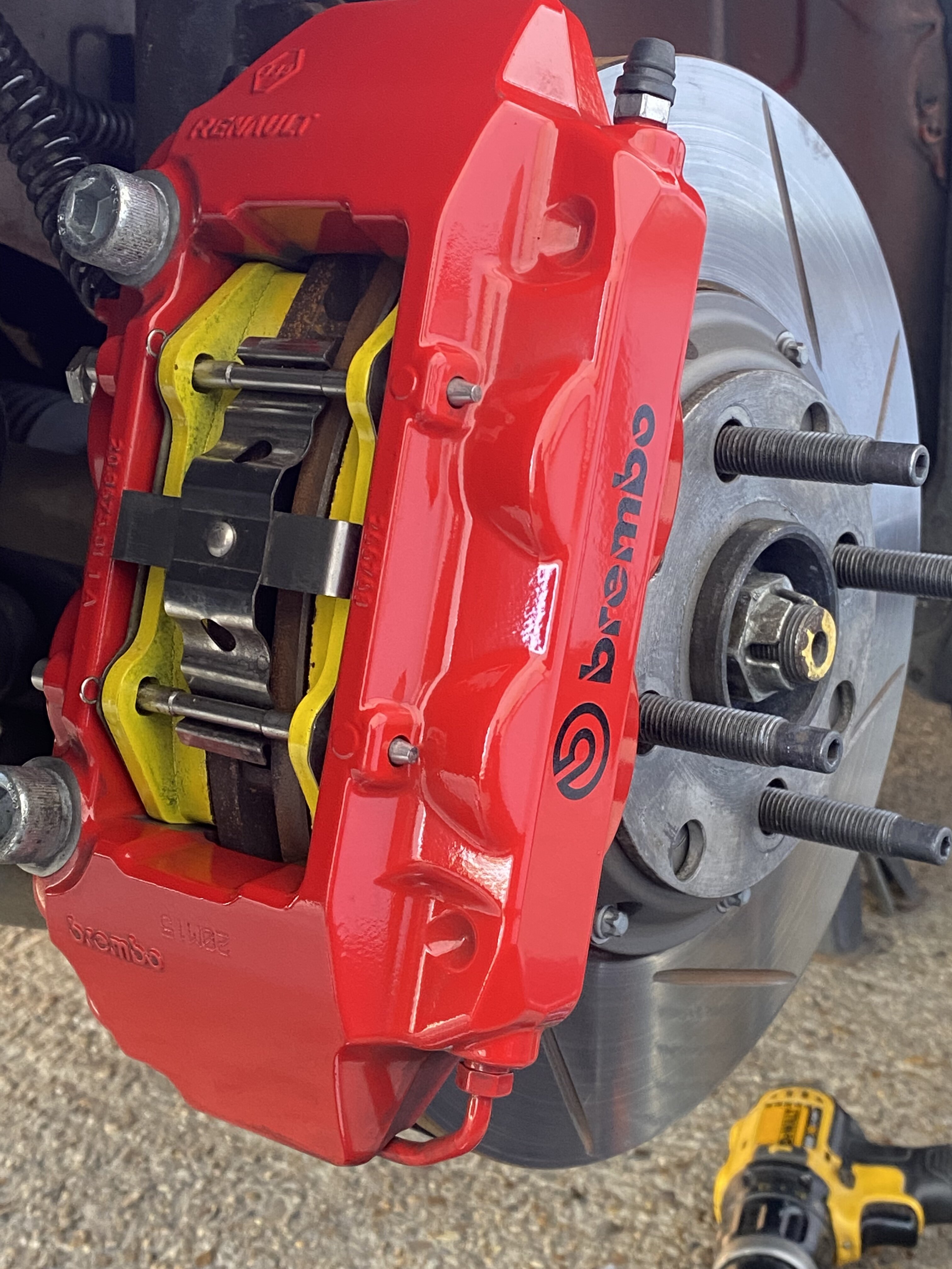

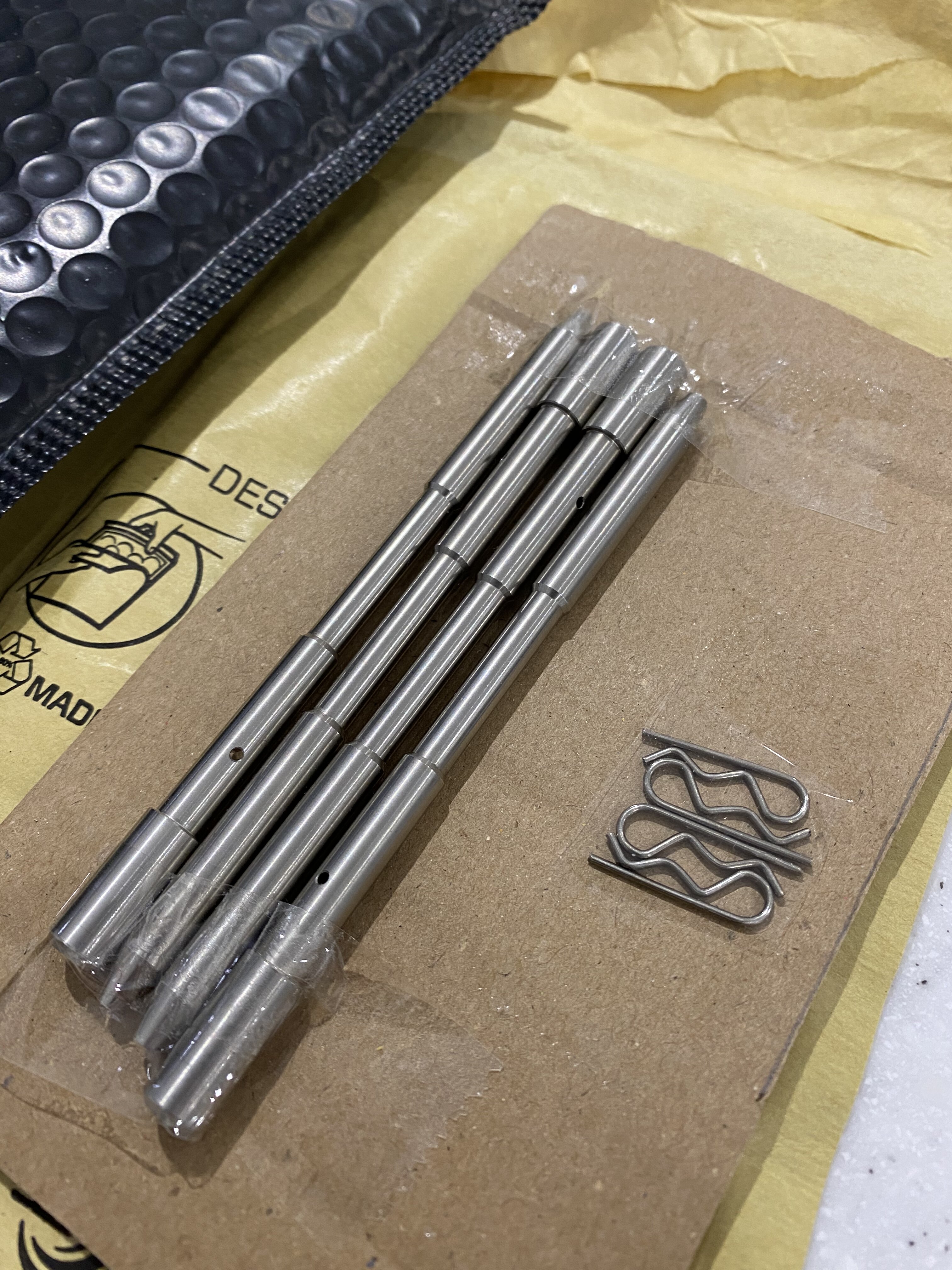

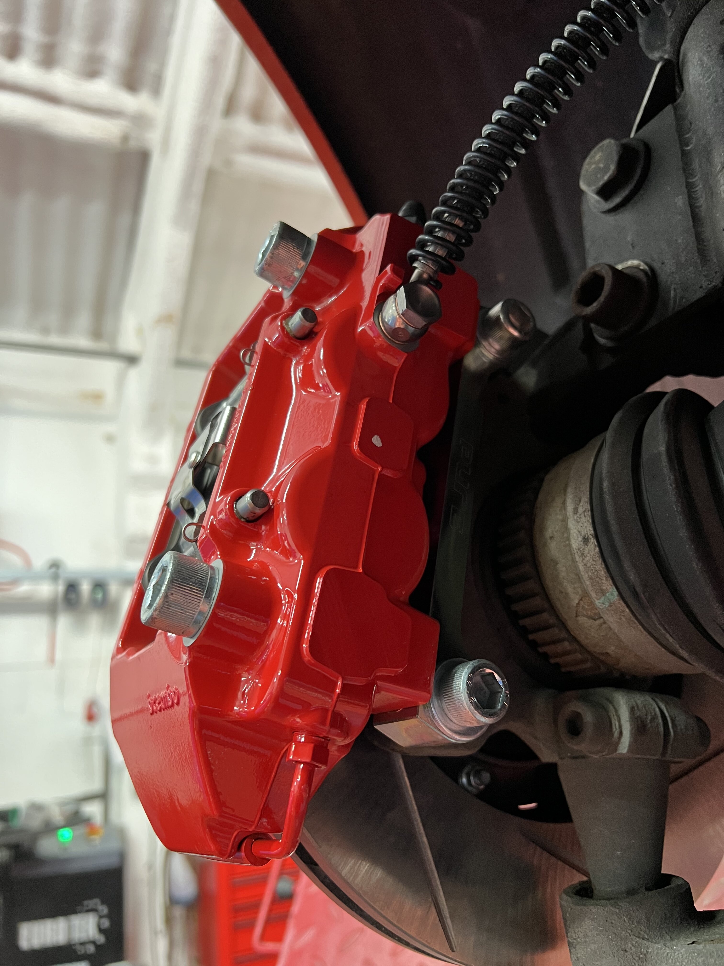

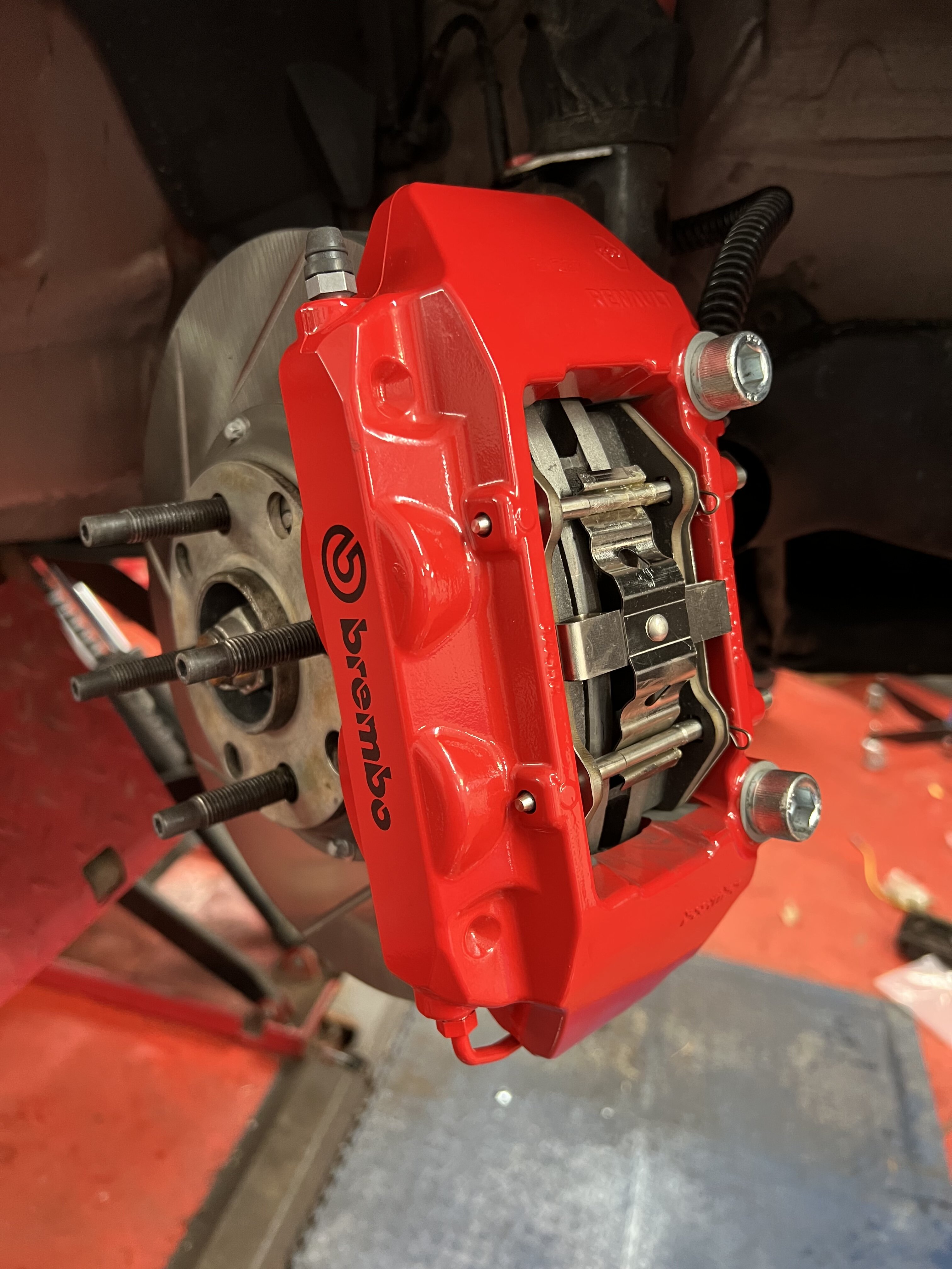

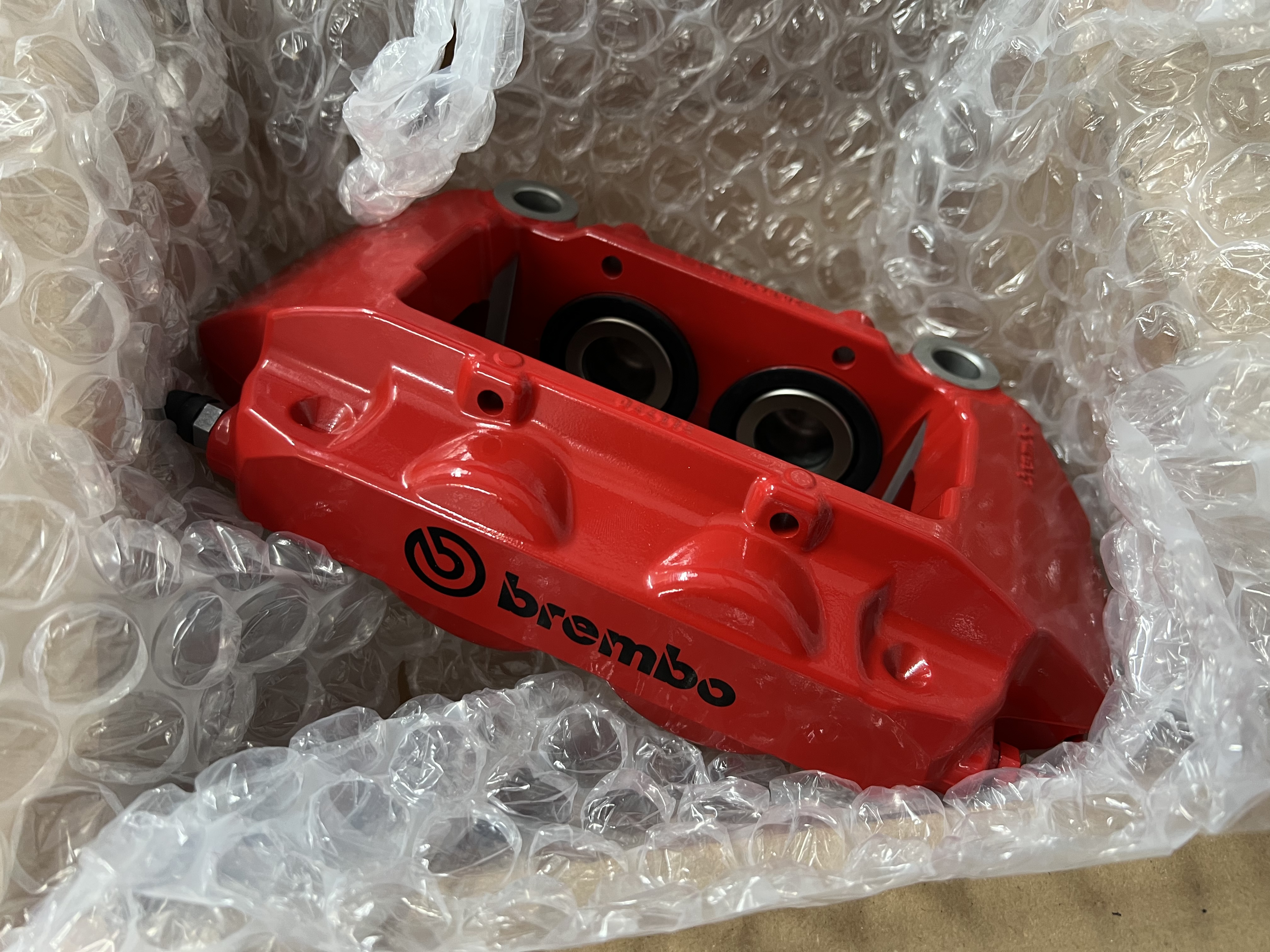

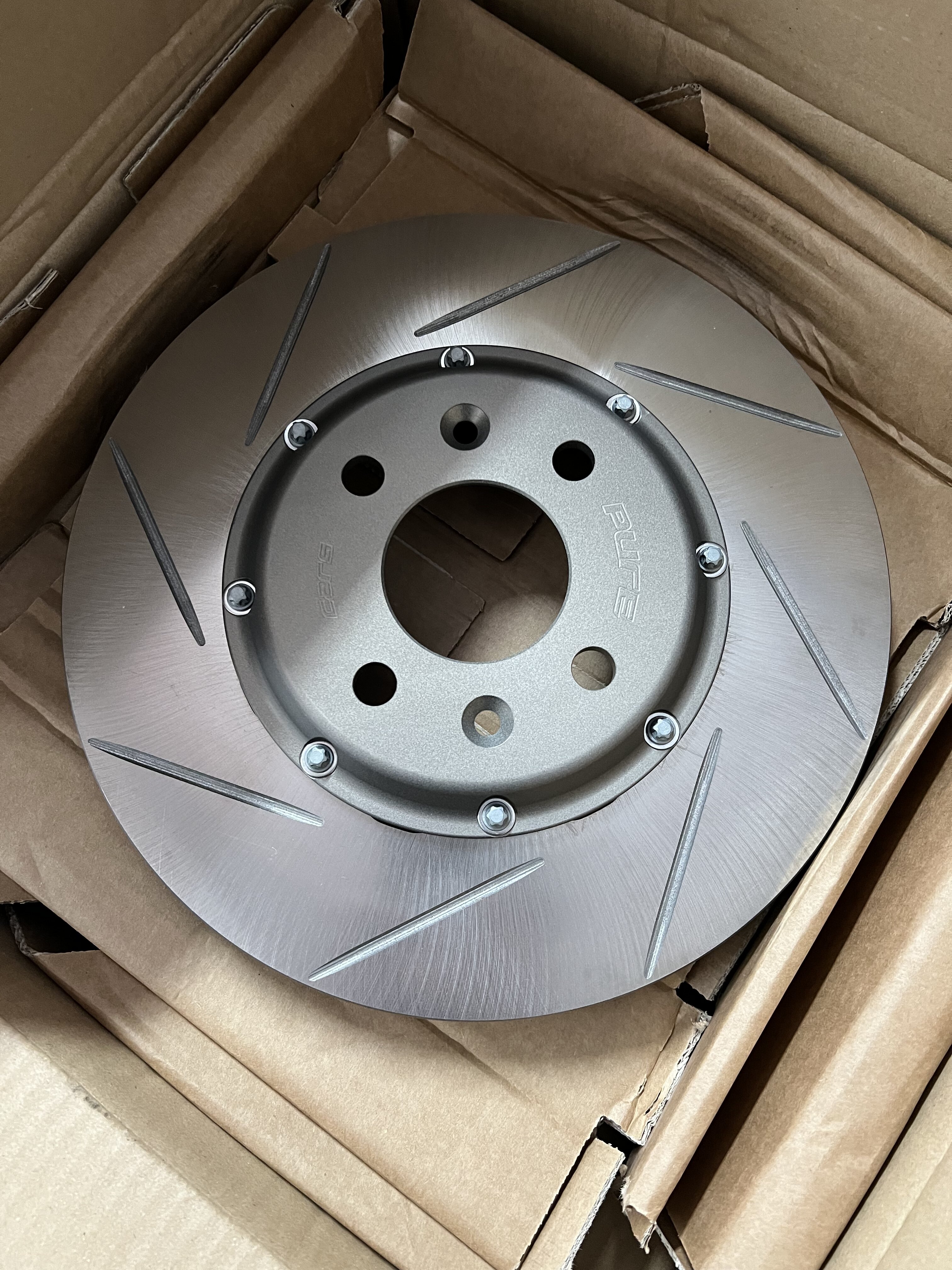

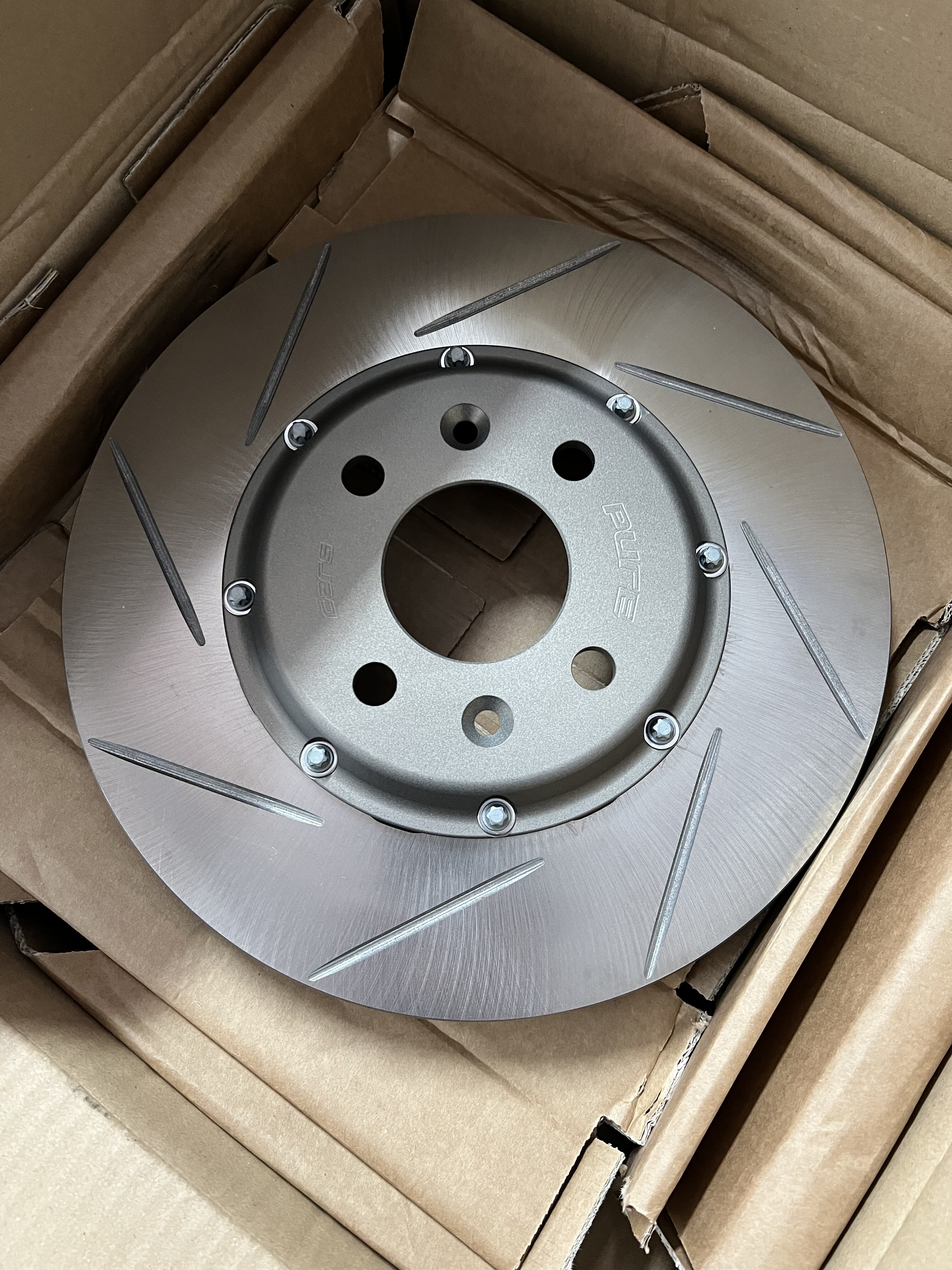

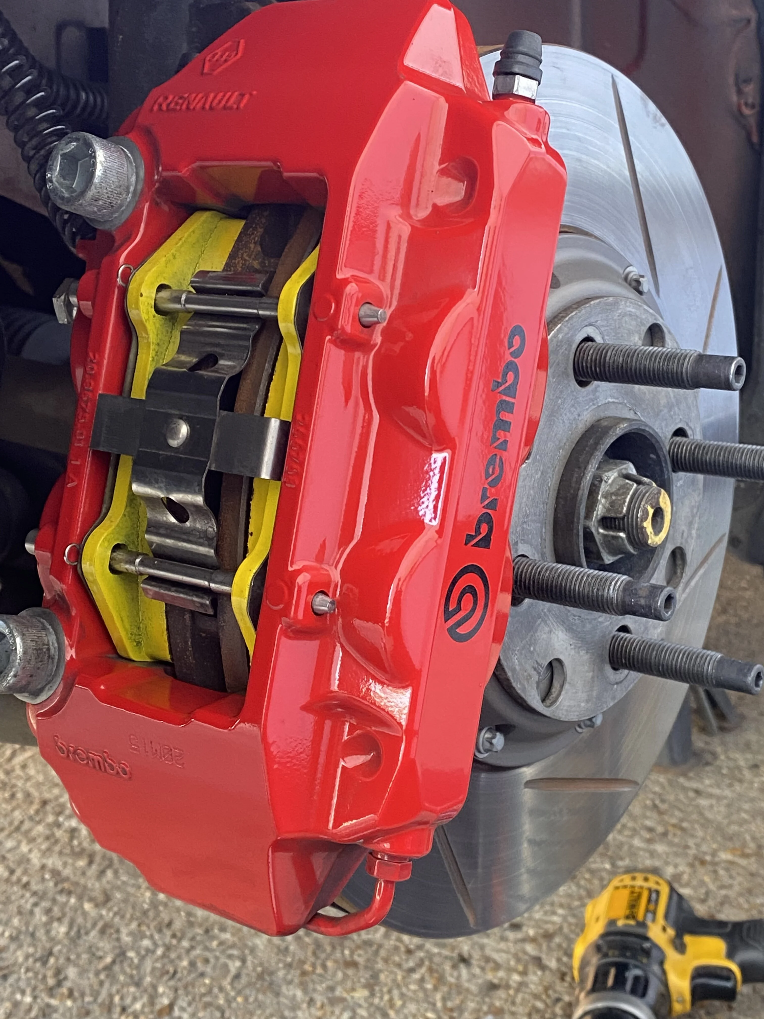

Been collecting some upgrades for WZD over the winter. One of which was an improved brake package in the form of the following:

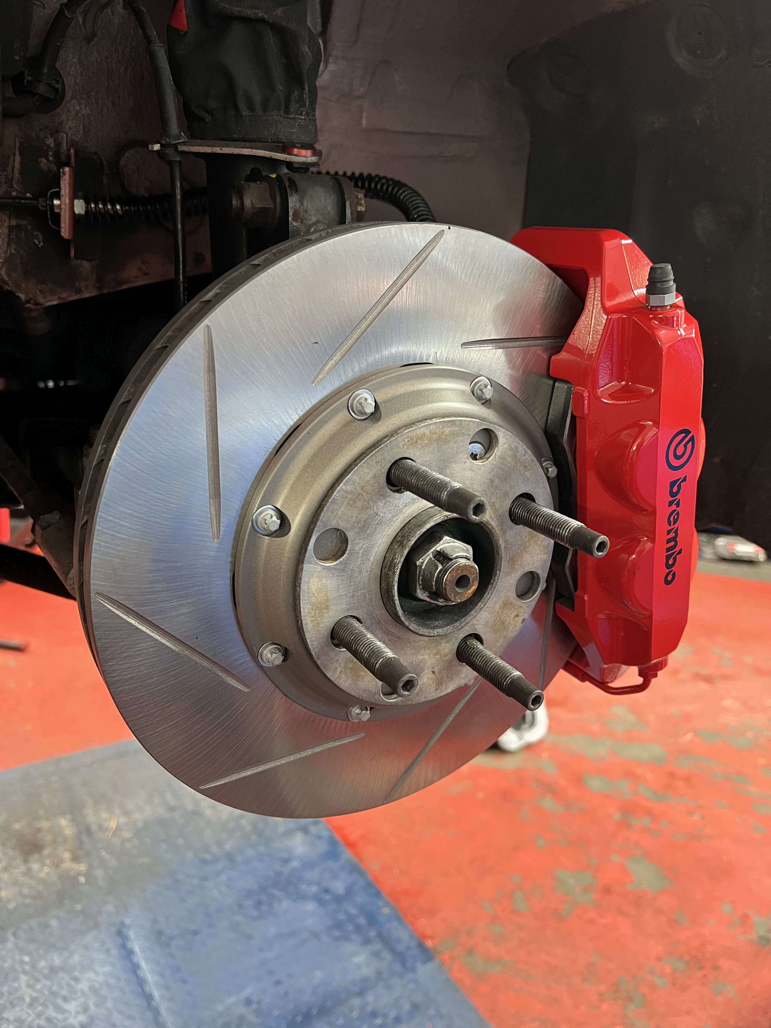

  • PMS 285mm Brembo 4 pot caliper package.
  • PMS 285mm x 28mm 2 piece rotors

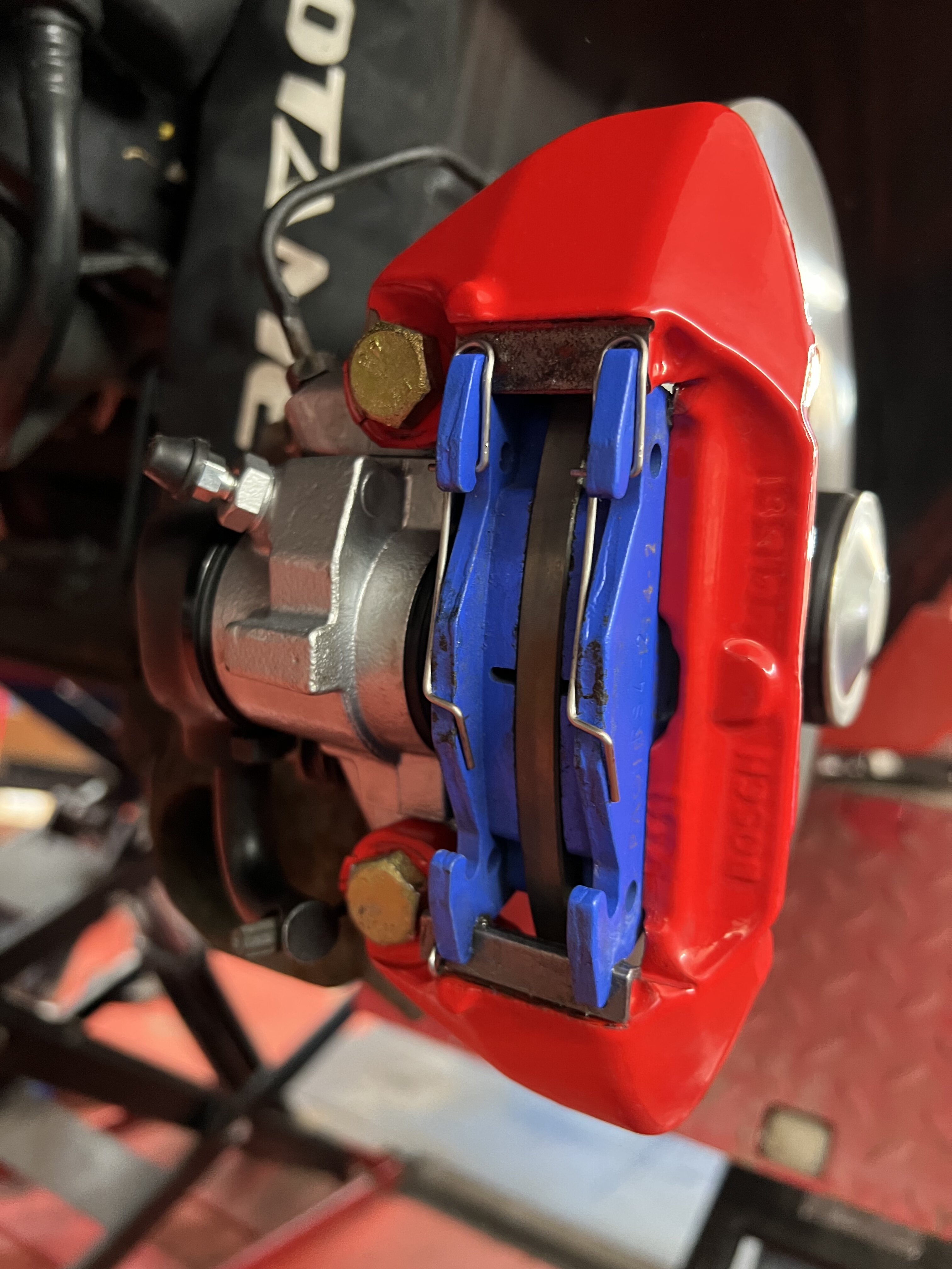

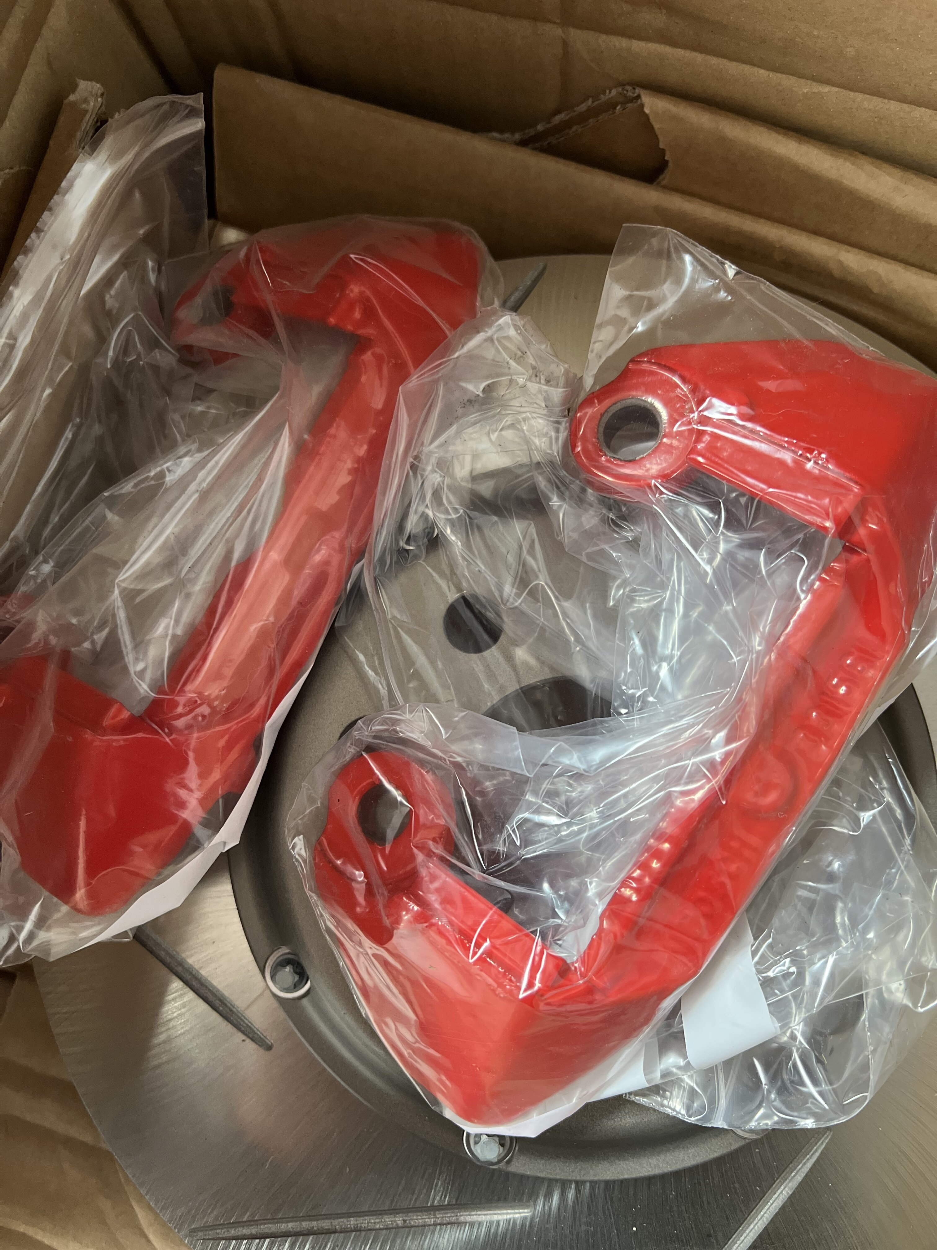

  • New rear brake calipers with red powder coated carriers.
  • EBC Racing RP1 front pads (Interested to try these before going back to Pagid RSL29s)
  • Pagid RS4-2 rear pads.

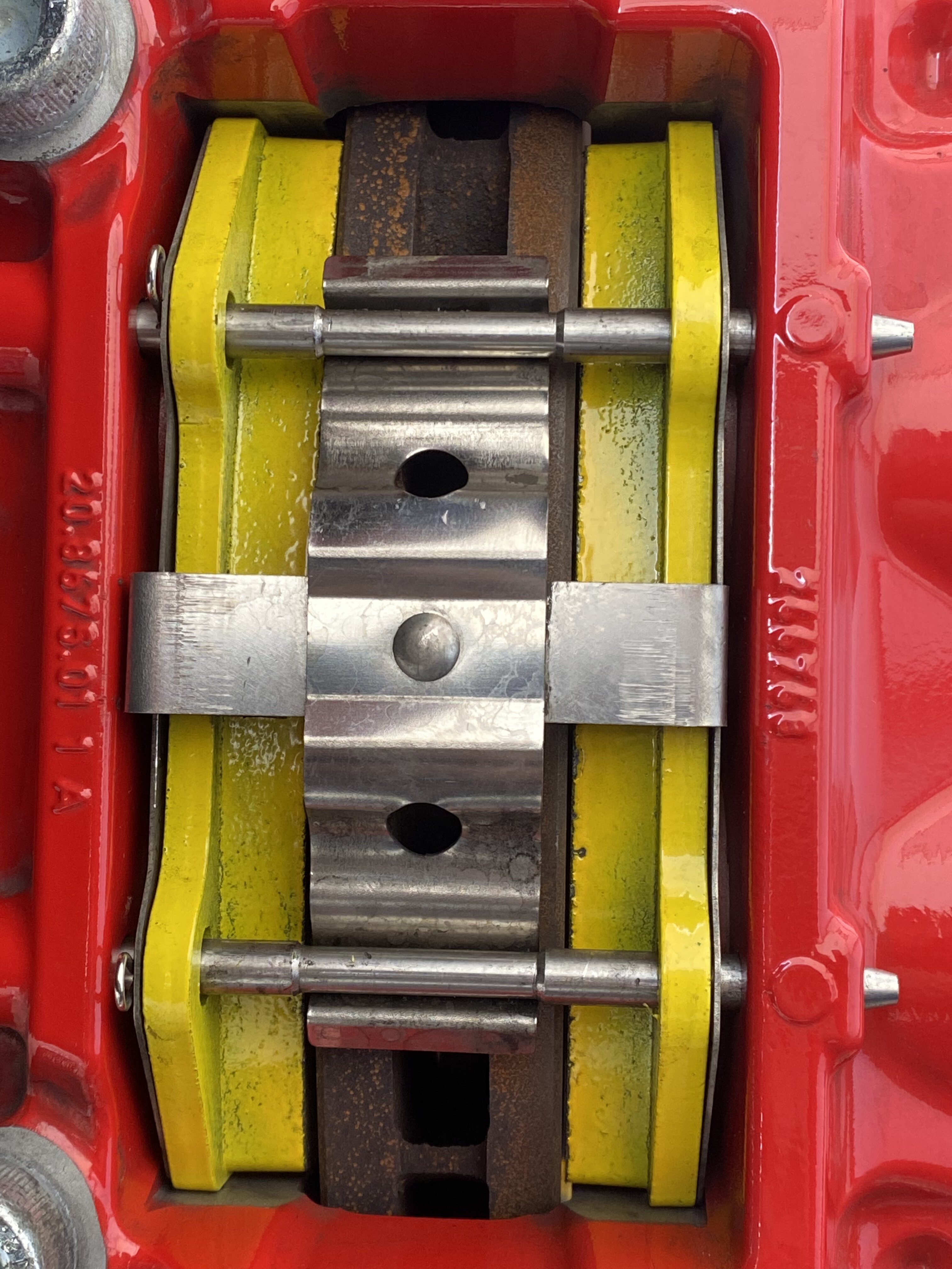

  • Mr Pink stainless steel pin kit.
  • PureTrack titanium shim kit.
  • Castrol SRF Racing fluid.
  • Genuine Renault Clio 197/200 Master Cylinder.
All fitted up perfectly as always by Alex @ AW Motorworks.

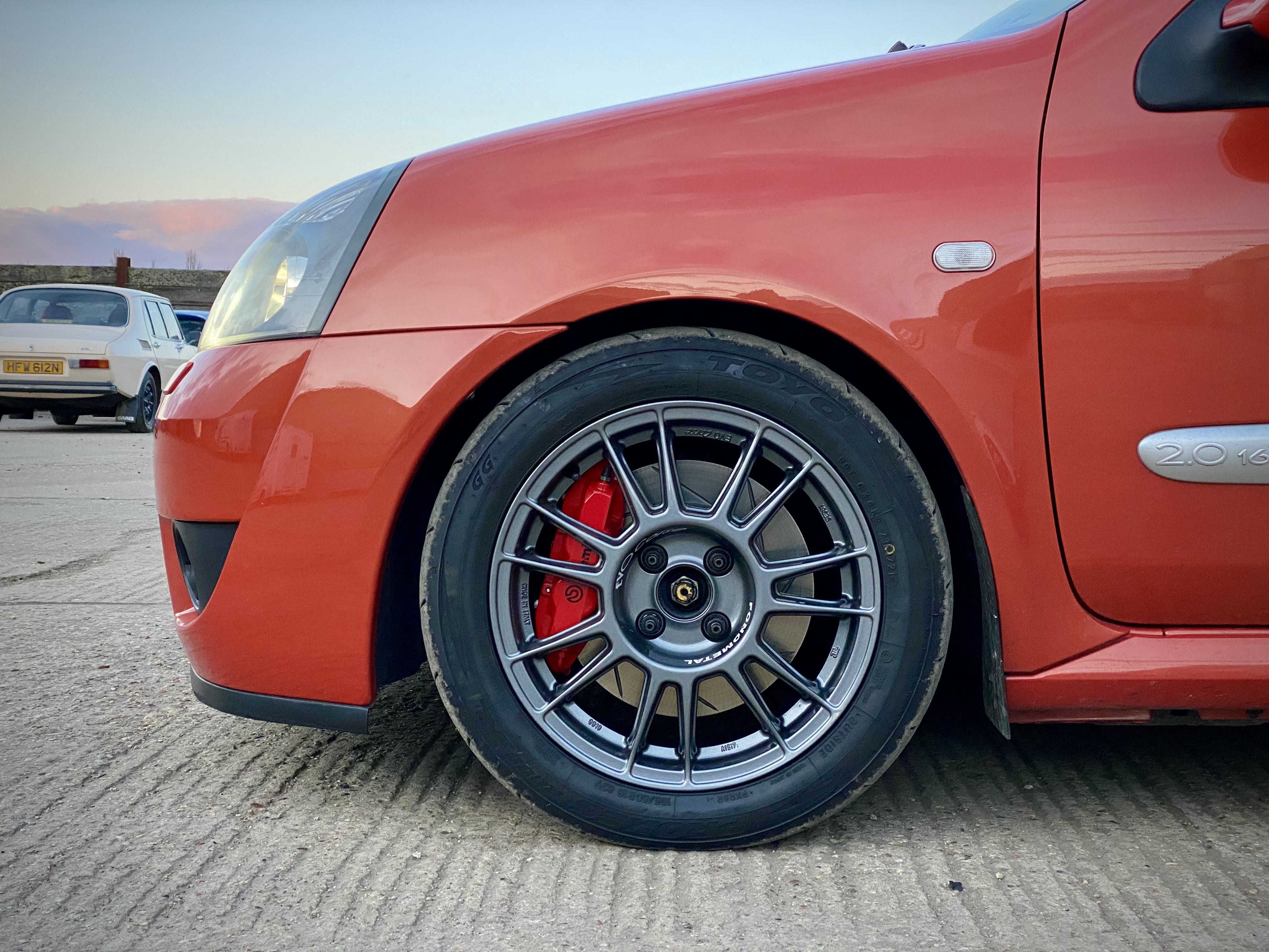

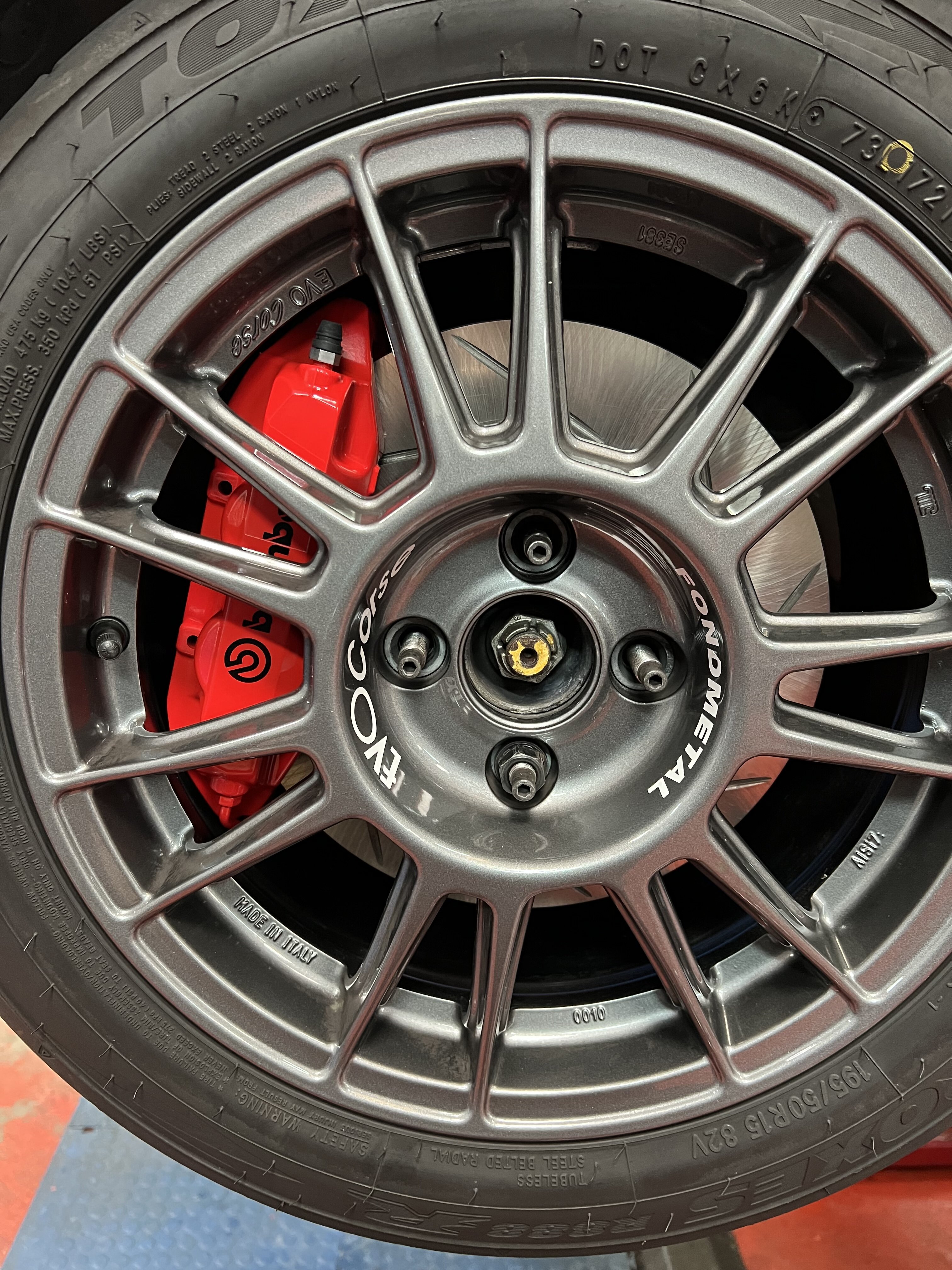

To anyone interested the Evo Corse X3MAs fit without the need for spacers (My 5mm spacers were left in place in the photos)
Big brakes and Toyo R888Rs in time for the snow. haha :DView attachment 1586537View attachment 1586538View attachment 1586539View attachment 1586540View attachment 1586541View attachment 1586542View attachment 1586543View attachment 1586544View attachment 1586545View attachment 1586546

Ive not seen them on yet but the thicker discs are significantly larger than OEM and should make a huge improvement to cooling when pushed hard.
Im certainly looking forward to seeing how they feel with the correct master cylinder in place too.

Well I’ve driven it home and initial impression which I was fully prepared for was they are initially far from earth shattering, as you would expect from an all new setup.
The whole system has been off including a master cylinder swap so I’m well aware that they will want a good bedding in and another bleed, probably a few bleeds to get them 100%.
i know Alex bled them multiple times and with clip and we both knew it would take a while to get them fully bled out.
The pedal travel is at the moment slightly long as you can feel some squish in the system. However, after about 10 miles of steady medium breaking you could feel the whole lot biting up very very hard. The new rears have made a huge improvement to how planted and stable the car feels now. The biggest change is how stable the car is, you can brake from big numbers and the car is arrow straight and the feel you get back from the pedal now is very impressive. Even with the fresh setup and the need for further bleeding, the difference is significant.
So I’ll drive her for a few days and do another bleed of which hopefully will remove the squish I have at the moment.
I was worried about the colour clash of the new red calipers (only available in red when new) with the inferno paint. But now they’re on, I think they look okay.

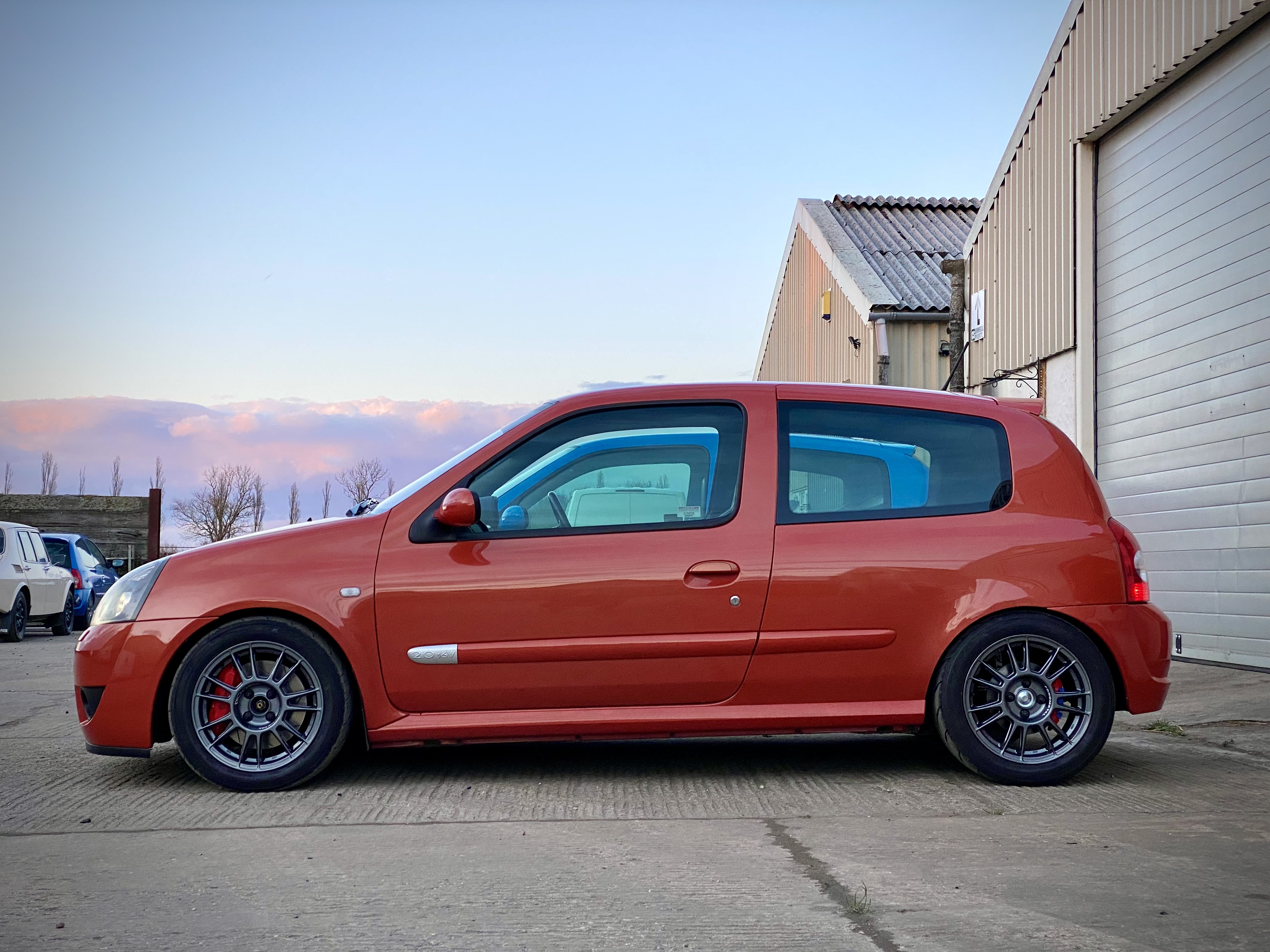

  Clio 182 Cup/Meg R26

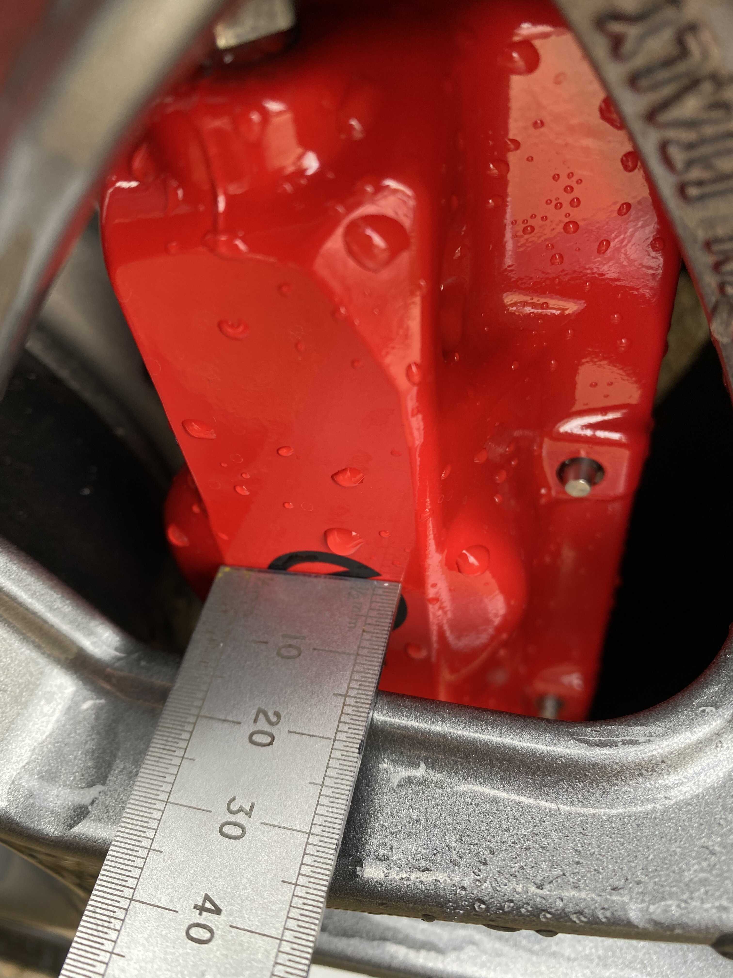

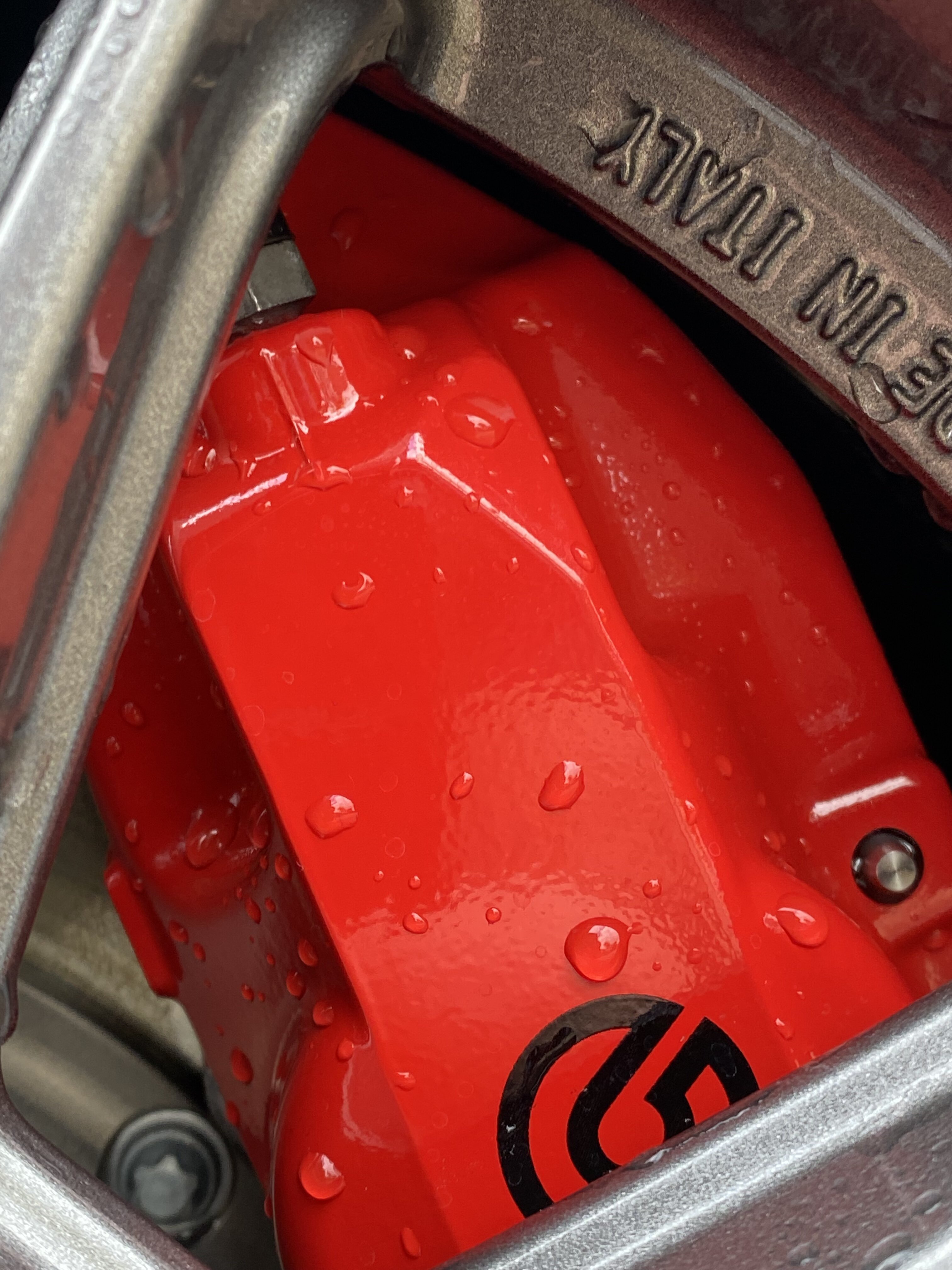

Just been told my pro race won't fit over these brakes which means it's going to a expensive conversion as would need 2 sets of wheels as well. Not looking like I'll be able to do it. Really don't want to go down spaces route on track car
frayz
Indeed there aren’t many wheels that drop over big calipers without spacers. The X3MA that I have here and the Braid Fullrace and Fullrace C are 3 I know of that go straight on in a 15” fitment.
frayz
Driven it to work today and now covered about 50 miles all in. Still some squish at the top of the pedal due to needing another bleed (I've not re bled them yet) but Christ they feel mighty.
The rate at which it scrubs speed and the stability in doing so, and the pedal feedback is impressive. The whole car has that feeling of sucking itself to the road under braking now is very confidence inspiring.
I had my reservations about how much difference they would actually make on essentially the stock sized discs, but the difference in feel and confidence on the road is already worth the outlay. I'm not sure if this is due to the callipers alone or the fact they're now on a much thicker and more rigid disc. However, If they can maintain this level of feel and control on track then I'll be a very happy boy.
frayz
Plenty of clearance there!
Yup, i guess they were designed as a genuine competition wheel so i was quite relieved when they fitted as id hoped.
Id really like to try a set of the Braid Fullrace on there too to see if they allow even greater clearance than what i have, just to have a different set of wheels to play with. I keep flirting with the idea of flogging the Turinis and just running 15s all the time.

Popped back to Alex last night after work to give the brakes another bleed after a week of driving. Hooked up to Clip with the ABS module priming and another healthy dose of Castrol SRF, he proceeded to bleed the whole system again twice.
I'd have to drive a drive a stock car back to back but i think the dead zone is now near as dammit the same as stock but with significantly improved power and feedback through the pedal. The pedal was significantly improved and now we are back to almost OEM levels of travel. I don't think it will get any better from further bleeding either.
I would like to see if possible to re drill a pedal to move the leverage point on the pedal to reduce the travel even further but I'm not sure yet if this can be done.
All in, very pleased with the overall improvement, lets just hope they hold up on track :)

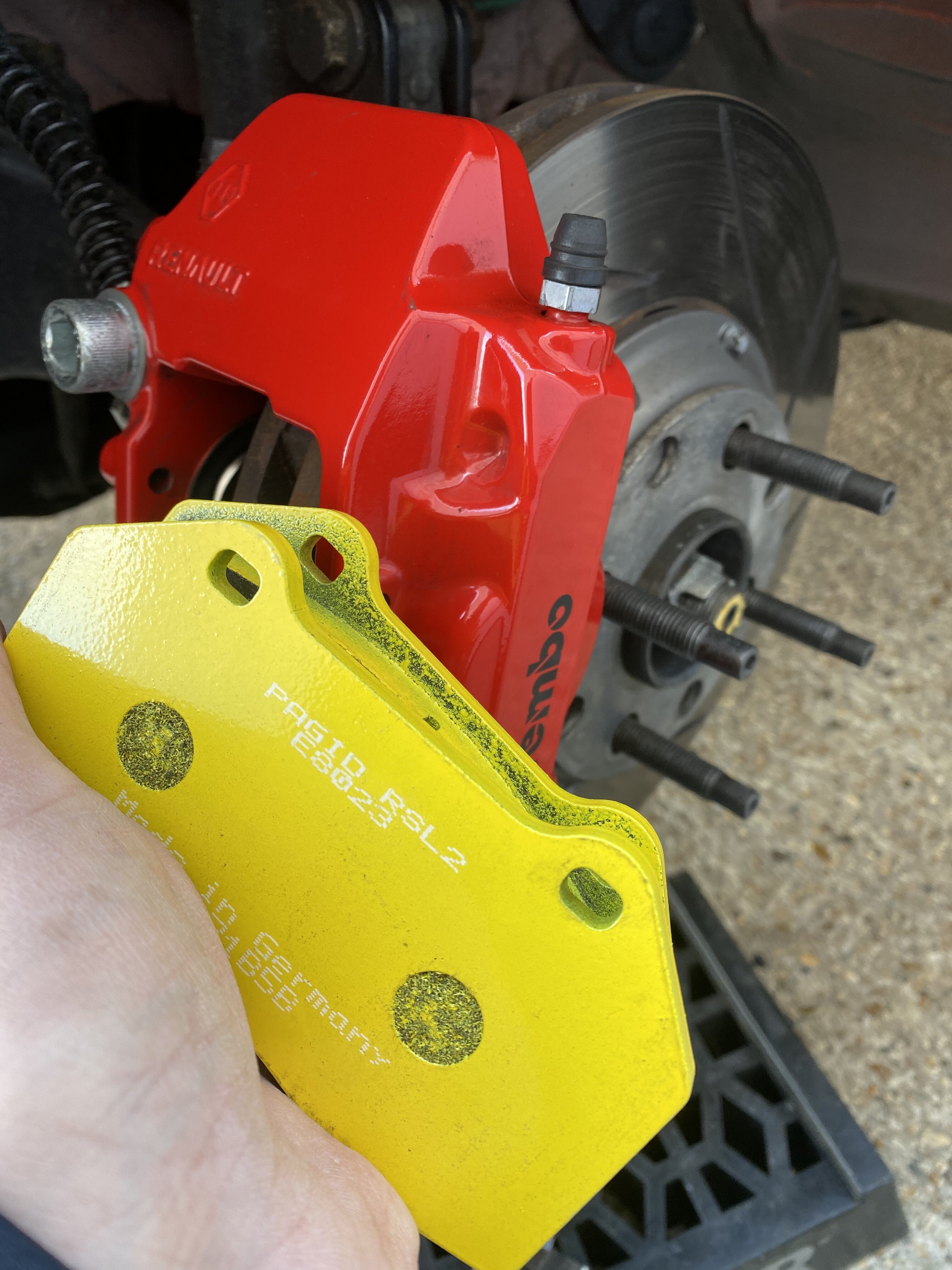

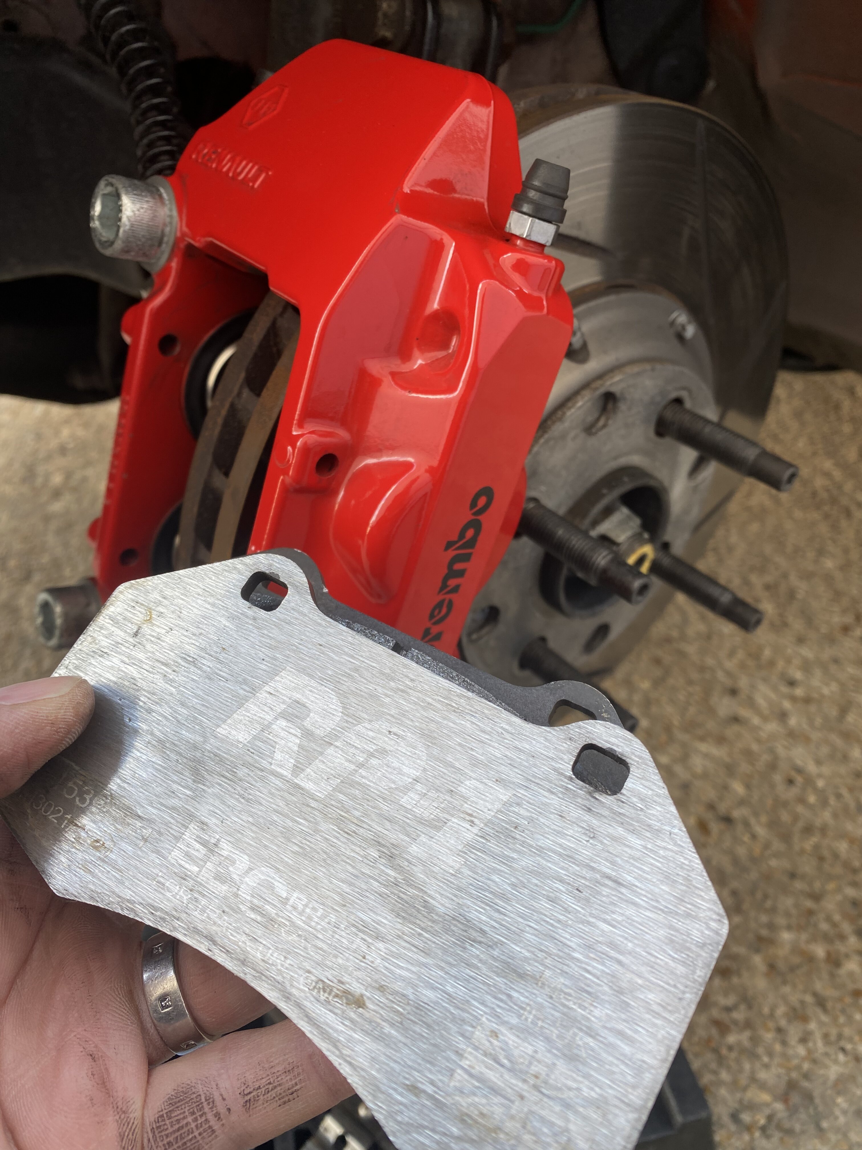

Small update tonight.
After 2 weeks driving on the RP1s I’d decided they just weren’t feeling the way I wanted the car to feel. I used Pagid RSL 29s in the OEM calipers and I’ve used 29s in all my cars. I just like the way the Pagids feel so I’ve opted to just pull the trigger on a new set. The RSL range has been developed into improved compounds now with the addition of the RSL 2 and 2E so opted for a set of RSL 2s.
Cost the same as a Clio but the pad and rotor life is amazing so I’m happy with that.
RP1s out after just over 2 weeks lol, RSL 2s in and all was right with the world again. 😅
