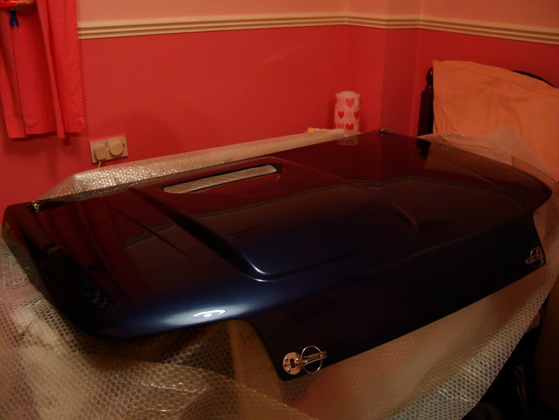

right ive just had my fiberglass bonnet sprayed. is it ok to fit it tomorrow or should i leave it inside for a week to let the paint cure/dry properly ( or will this be done allready lol ) what about washing it as it quite dusty at the min and what about waxing it???
what paint has gone on it?. assuming it is 2pack paint that has gone on it and it has been baked in a low bake oven you should be ok to fit it but i would leave washing it or waxing it for a few days as the wet can still mark fresh paint.
no idea what paint, it has lots of metal flake in tho:D u reckon i should leave it off for a week ( got my std bonnet on at the min )
its probly best if you do just to be on the safe side. you dont want to spend all your hard erned cash on it then fcuk it up so its probly best
