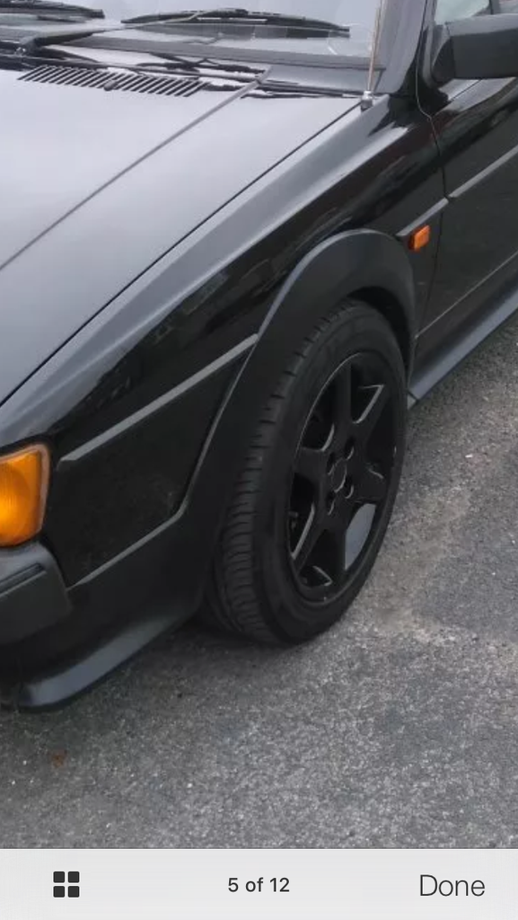

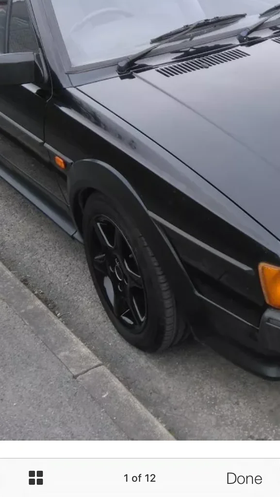

Took it to my mate for a bit more work today and to inspect the wheel. He can't find anything. No spacer, nothing broke, nothing where it shouldn't be. It's definitely out further than the rest, I'll try find a picture....
Had to use the pictures off the ad when I bought it.

You sure this hasn't got camber bolts fitted .
Plus, at least have the wheels straight when taking a picture, oh you didn't take them did you.
Take a pic from ground level from the front.
But basically your wasting everybody's time .
Pretty sure when working on these back in the day ,the camber was slightly adjustable on the standard bolts . So if an un knowledgable person put it back together . There's an issue right there with the camber.

By the looks from the above pics it does seem to be something mentioned above. My advice would be to get it tracked and you will know the issue, hopefully. Look forward to pics of the car, we had one when i was a lad, lol. In blue :)
Don't need to be perfect, but do need to see both wheels.
And, do you know of you have camber bolts on there?
