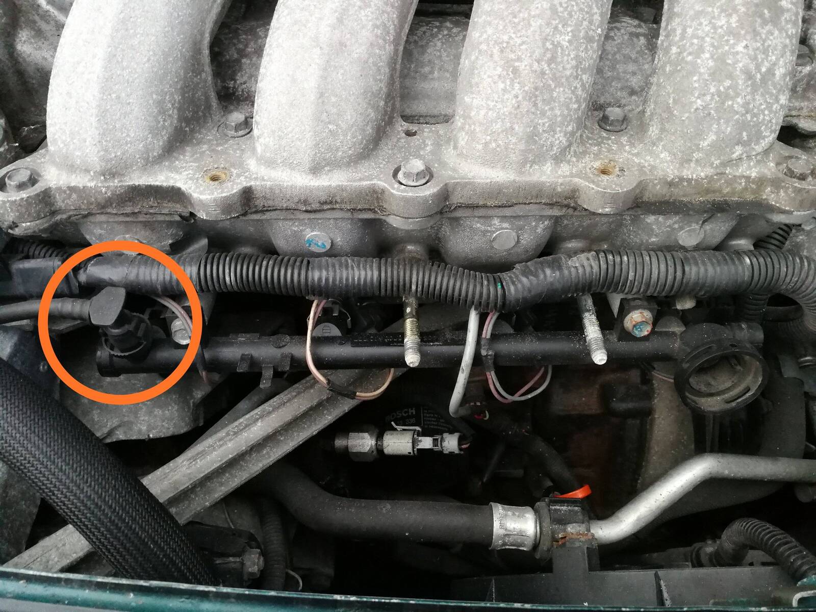

Hi all, had an issue over the weekend...
I seem to have caught the fuel rail on the cambelt and it's rubbed away on it so now it's spraying all over the engine bay so I clearly need a new pipe.

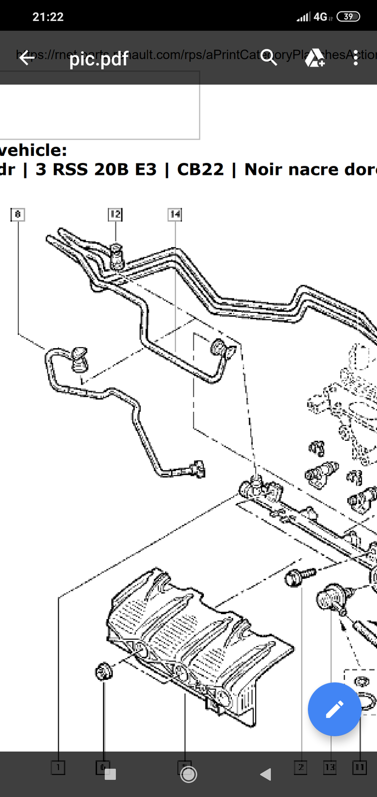

So Ive made progress and here is what I'm after
This is the diagram sent across from a supplier
Can someone let me know if it's number 8 I'm after as for some reason it looks like number 12 is also a connector??
Thanks!

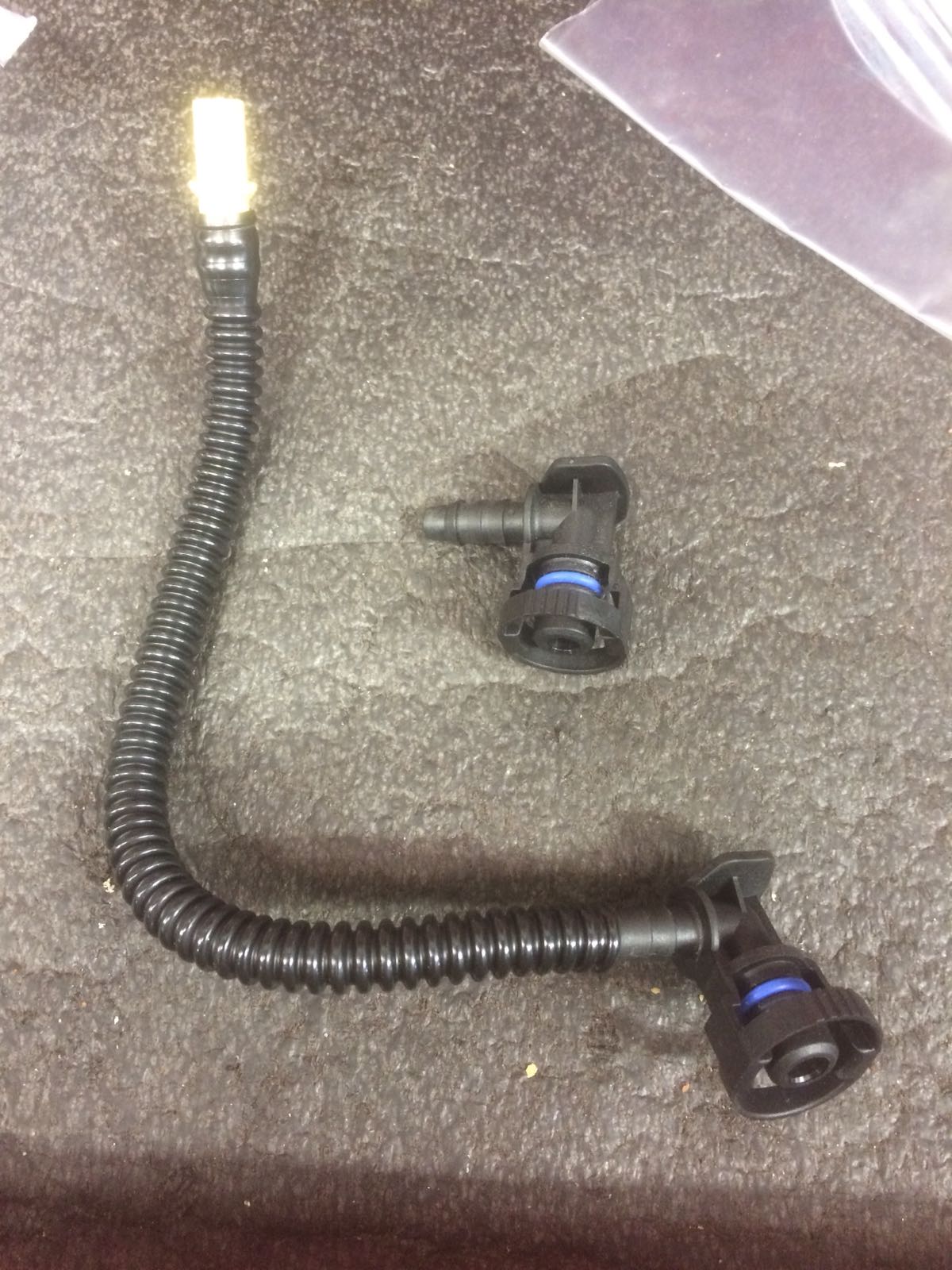

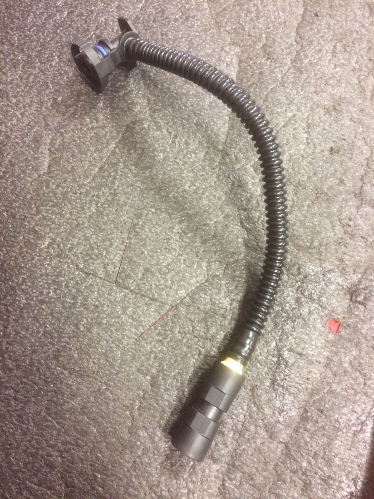

SOLVED
part arrived and it was the right one.
Fit great and even has a bit of a braided coating over the part that goes over the cambelt.
I have put a little cable tie on the top to stop it happening again. I doubt the heat will melt that and I won't need to do this again.
Underneath chasing that connector over was a right pain, it the push tabs didn't help too much. Some proper Welly is needed and I didn't feel comfortable doing it as I was concerned id mess up the rubber seals inside but all seems good now.
Only did a quick jaunt up and down the road but 3 miles in and no more petrol stench or the pipe touching the cambelt.
I will add though that no replacement clips that run along the chassis leg were provided. Need to reuse the old ones.

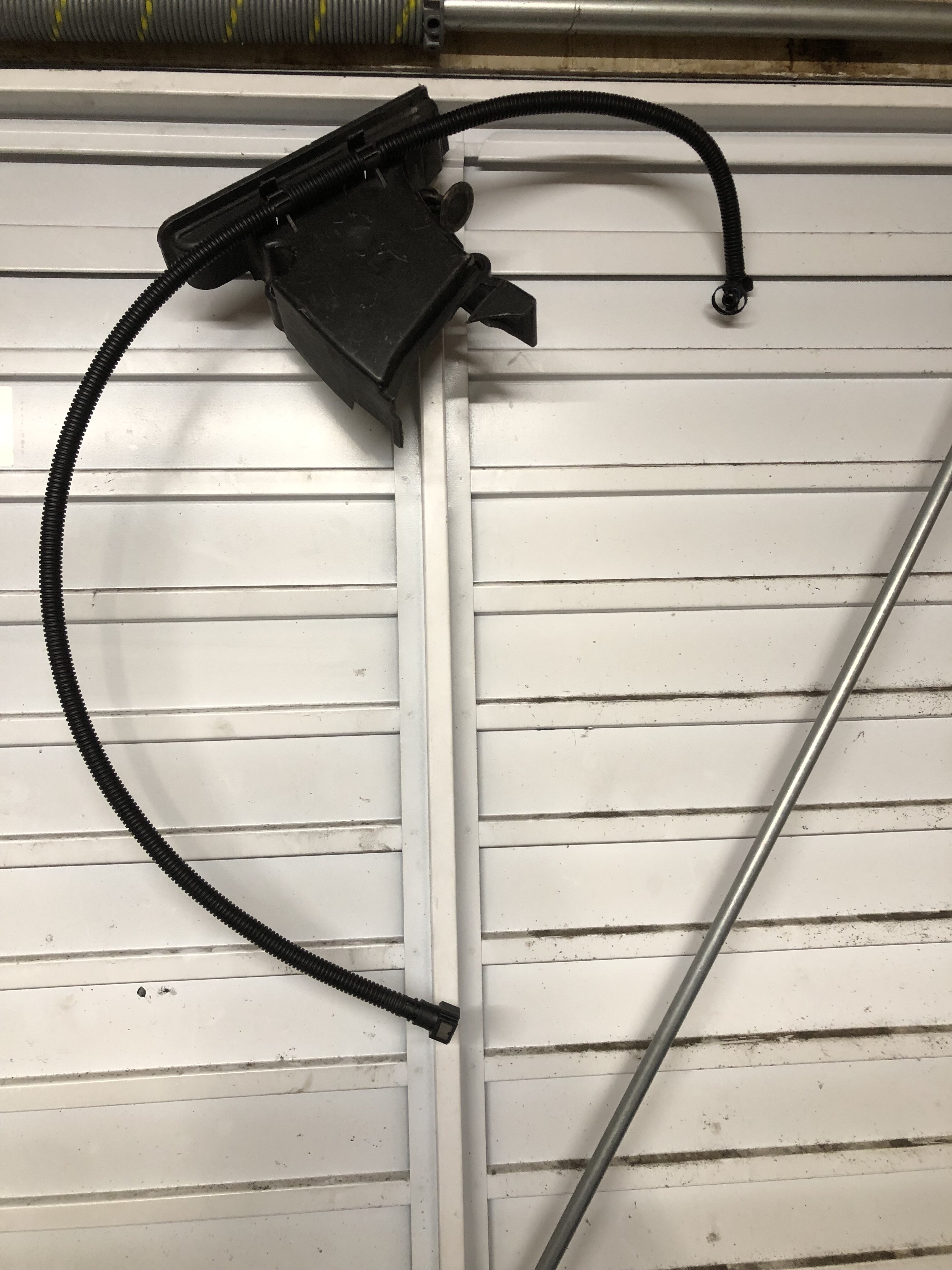

How much did the pipe cost ?
As I took it soon myself to come up with an alternative fix on mine .
I make these .
Been working on a full length version of the fuel line , testing it begins this week . See how it goes .
