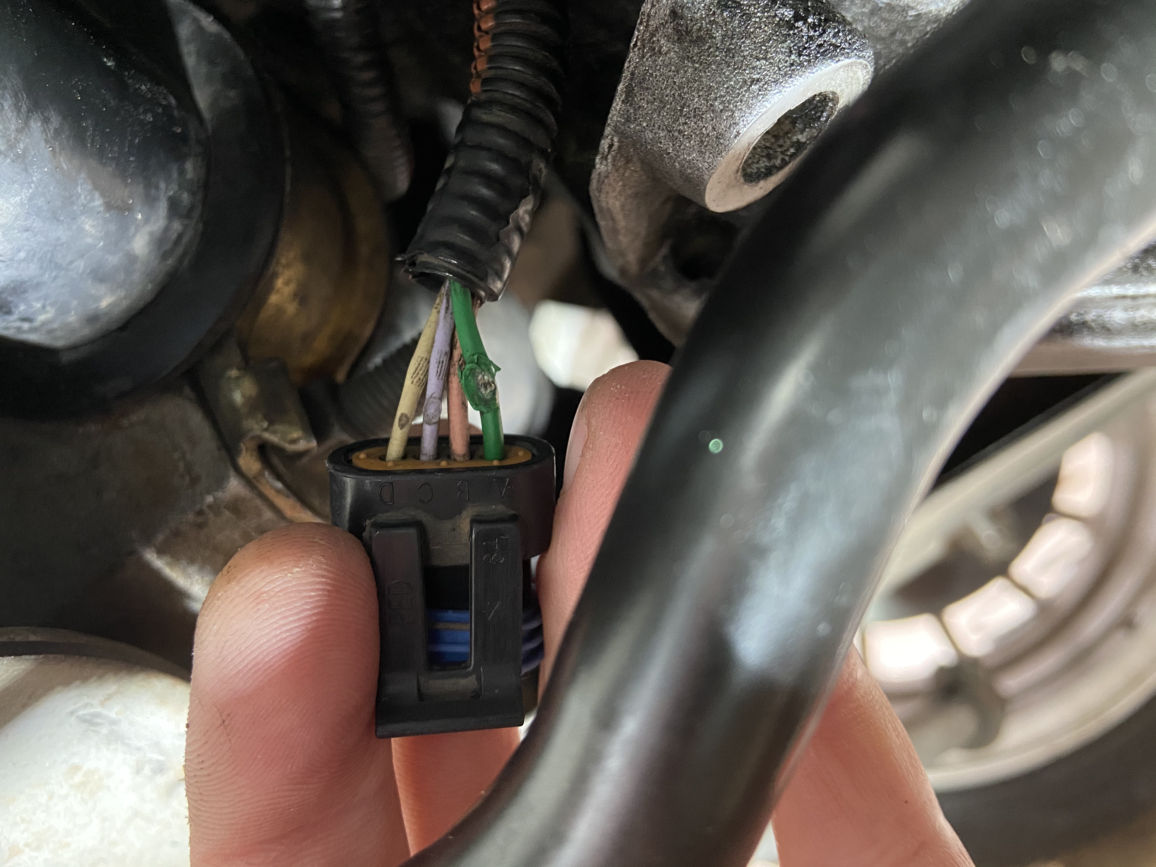

I’ve just had the same issue. Wires melted on the wiring loom side of the connector to the lambda / oxygen sensor and randomly blowing the 30 amp fuse.
