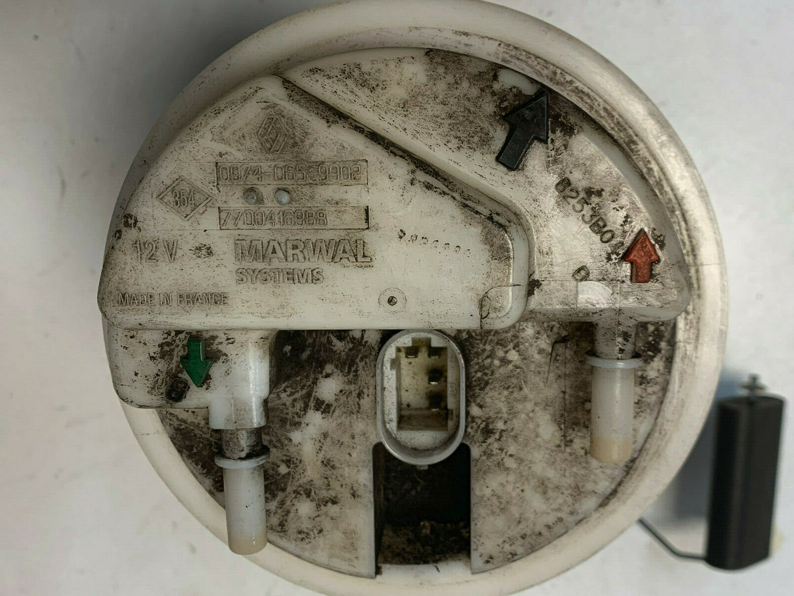

I've fitted a PH1 1.6 unit with an uprated pump (i did clean it first) The dimensions are all the same but it's just wont line up.

When I start the arrow is about 90deg before the tank arrow, and finally stops maybe 20deg before they line up.
